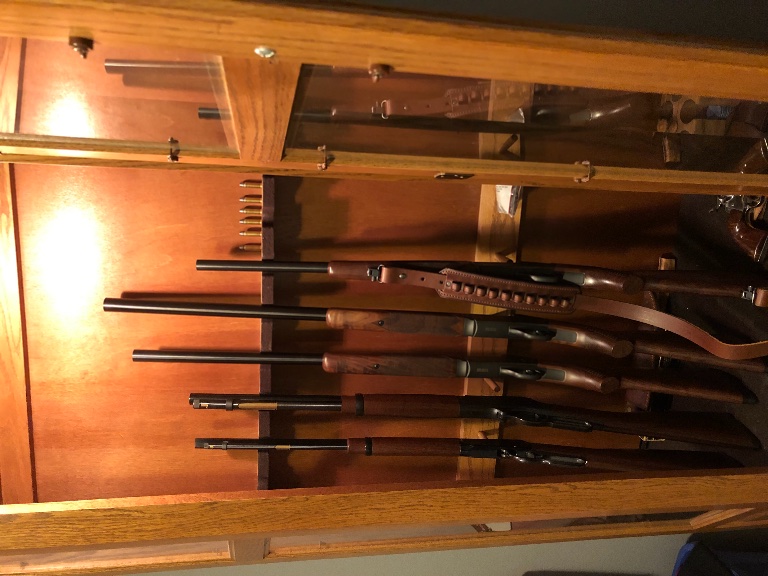

Nickel cases don’t tarnish leather on my single shot.
- 3BBCFEE8-6C1E-4445-907F-EB730AD5DB3C.jpeg (157.58 KiB) Viewed 2190 times
