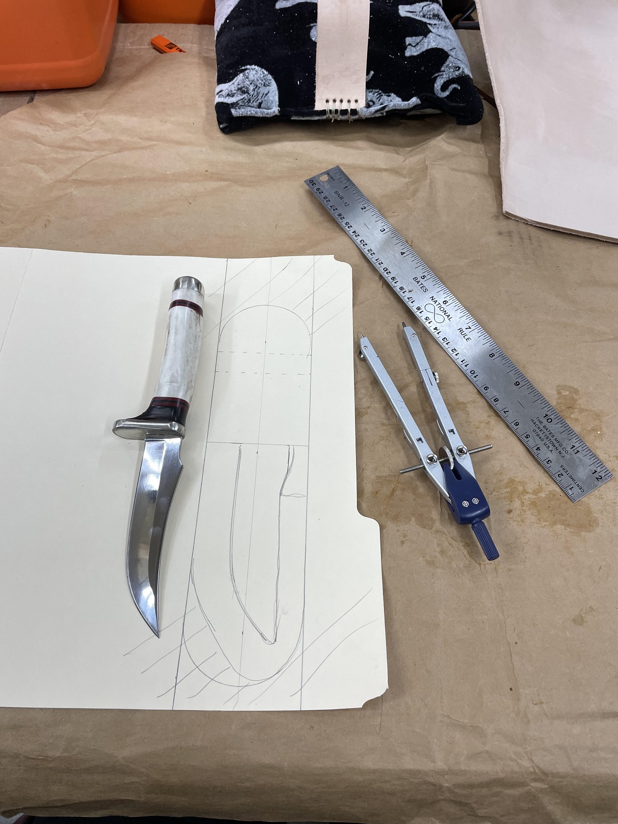

First step on laying out the pattern is to draw the knife itself on the material used for the pattern. In this case, an old file folder. Then you play with the layout and design. I went with a two piece rather than a rolled over, so I could insure I'd have room for the concho, the tying piece for each aspect of the Gunbelt. As you can see, I added each component to stabilize the knife when sheathed.
- 46 Sheath Pattern.jpg (496.89 KiB) Viewed 6606 times

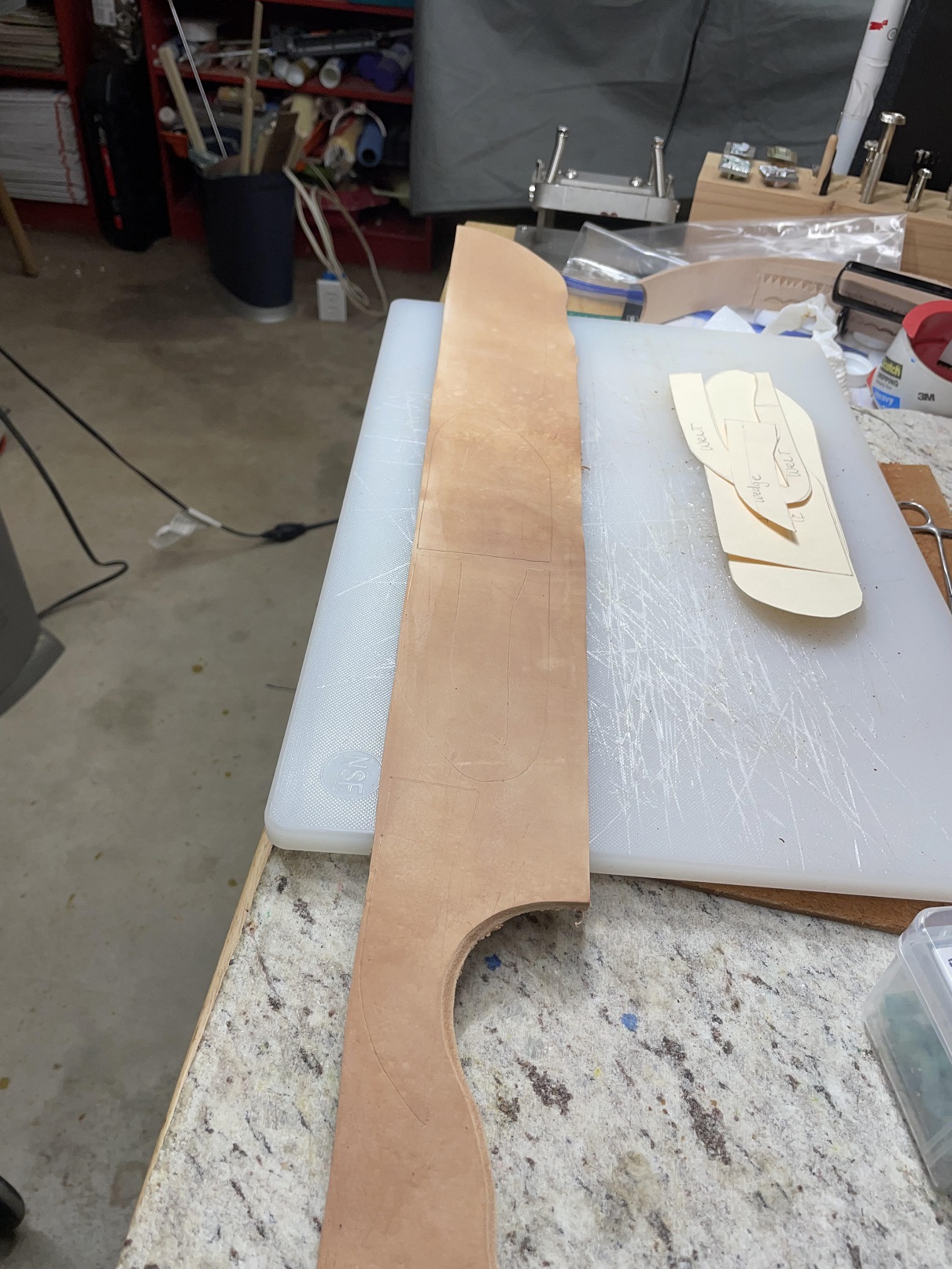

Once the layout was done, I cut out the main pattern, and redrew that on the folder. Then cut out the front section, redrew it. Cut out the welt, from the front piece, and redrew it on the file folder. Lastly I used that center I had cut out to make the welt as the pattern for the wedge. Then, using each pattern piece, I prepped the leather for cutting by transferring the pattern to the leather.
- 47 prepare to cut.jpg (553.47 KiB) Viewed 6606 times

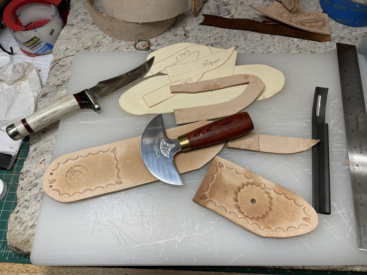

Next I went to work. I cut out each piece, then cut out two pieces of the wedge shape when test fitting showed I'd need extra. Test fitting let me mark where adjustments would be needed to the parts I had cut out. I marked and then tooled the front and back panels, while they dried, I skived the wedges so they would work. Got a lot done, but still plenty to go.
Tomorrow I will recheck my work, and I'll also cut out the belt loop for the back of the back panel, as well as the front strap that will secure the knife to the sheath, and tool that. I am in no rush as I can't glue up the project until AFTER the concho is installed and I am waiting for those to arrive from Tandy, they should be finished with end of the year inventory and beginning to ship soon. NO rush...
- 48 Lots done.jpg (448.76 KiB) Viewed 6606 times
I can dye the pieces once they are done, taking care NOT to dye the areas that will be taking glue.
