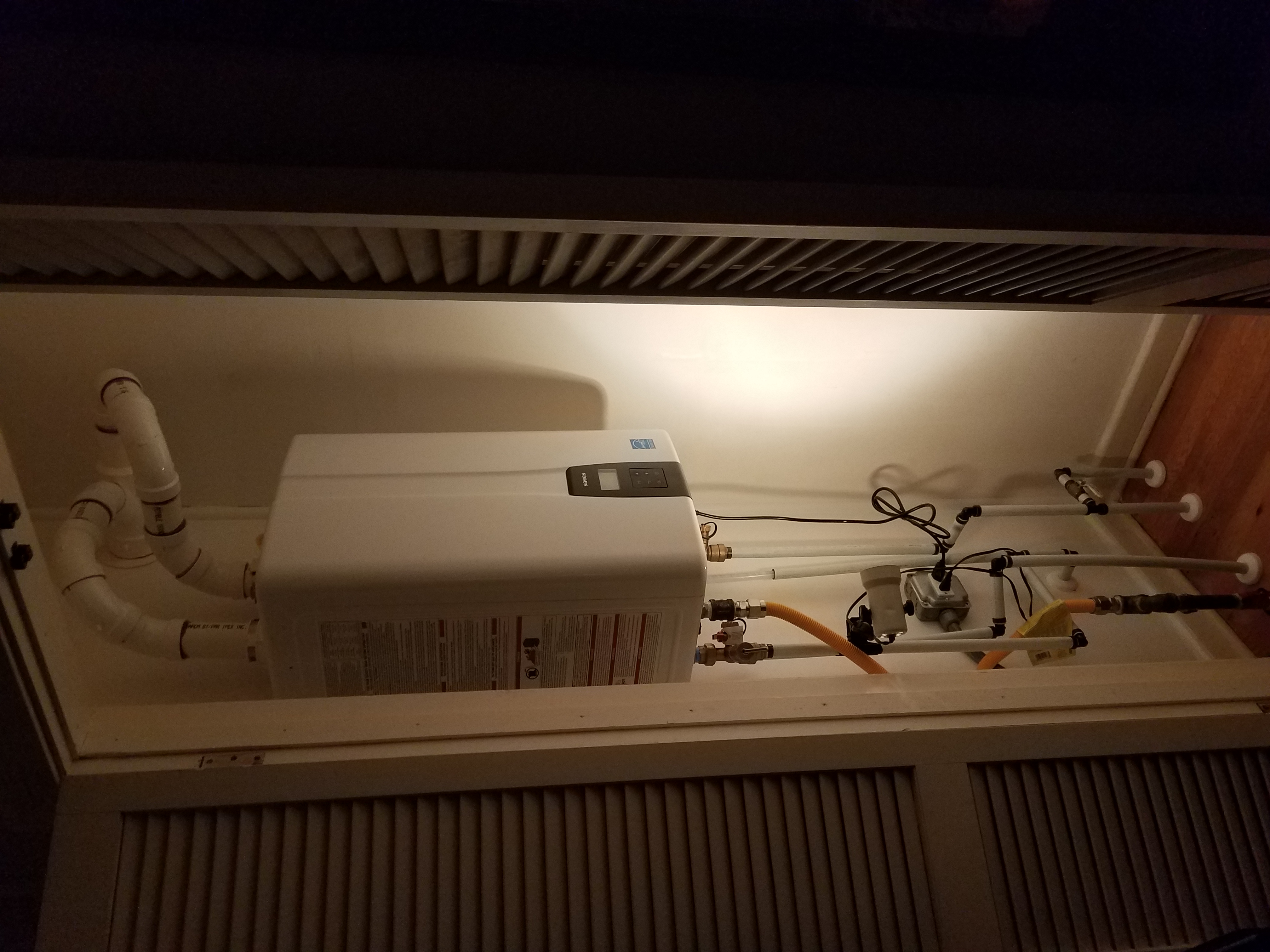

Posts: 11153
Re: Water heaters
Post by markiver54 » Wed Dec 06, 2023 7:38 pm
Installed Navien 240A tankless water heater.
It will take some time to realize the pros and cons.
At least I got that BOX! out of my breezeway!
