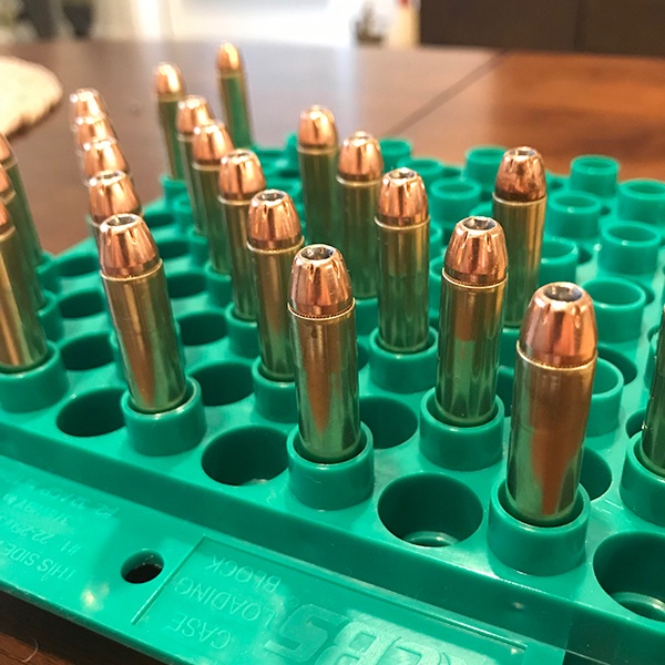

Post by Kissmybrass » Mon Aug 23, 2021 10:58 pm
Loaded up my very first .357 magnums for my brassie rifle :-)
158 grain Hornady XTP and Hodgdon HS-6 powder

Post by Vaquero » Tue Aug 24, 2021 8:53 am
KMB, those look more like an XTP's than FTX's.

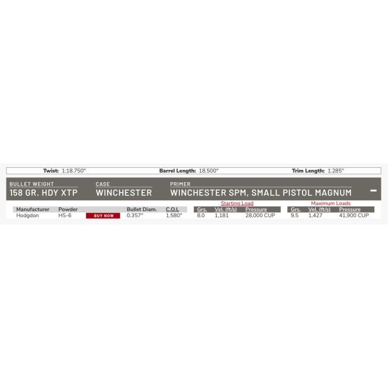

Post by Kissmybrass » Tue Aug 24, 2021 10:41 am
Tue Aug 24, 2021 10:33 am
158 grain Hornady FTX and Hodgdon HS-6 powder
How much HS-6 are you using under those?
I went on the high end of this since it's for the rifle. So 9.5

Post by Kissmybrass » Tue Aug 24, 2021 11:00 am
Your'e right, I edited. Mixed up with my 45-70 bulls

Post by BigAl52 » Tue Aug 24, 2021 11:01 am
I will be interested to see how it shoots for you. I have a 7 or 8 lbs of HS-6 and have been using it in 40 S&W and 357. I came up with 9.2 grains for my loads under a Roze Dist. Zero bullet 158 gr HP.

Post by Kissmybrass » Tue Aug 24, 2021 11:21 am
I'm curious myself. I wrote Henry about the CUP and pressure (since the max seemed high) allowances on the Big Boy Classic and they wrote me a nice note back ....
FROM HENRY
We do not rate our guns by chamber pressures; however, in general Big Boys chambered for .357 Magnum can use any reputable, good-quality brands of factory standard or +P loads of .357 Magnum, or .38 Special 158 gr., with standard profile bullets (lead or semi-jacketed round-nose, semi-jacketed or jacketed flat-nose and hollow-point).
FMJ bullets are ok if they have flat tips or noses, or hollow points. Round noses are OK with soft-point bullets (non-FMJ).
If the ammunition you are considering meets these criteria, you may use it in your Henry rifle, with either the brass or the steel receiver. If you have any doubt, contact the ammunition manufacturer to verify if it meets the proper criteria.
Hogdon's data is for hand loading, and we do not recommend hand-loaded ammo due to greater risk of possible variations/errors and safety issues, in the case of improper reloading resulting in out-of-spec ammunition. If you choose to use hand-loaded ammunition anyway, make sure the resulting ammunition conforms to SAAMI specs for that type.
Regards,
Jeffrey Post
Technical Customer Service
