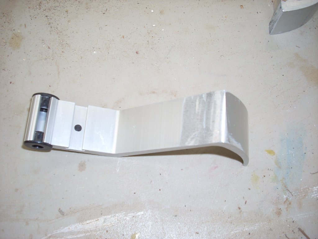

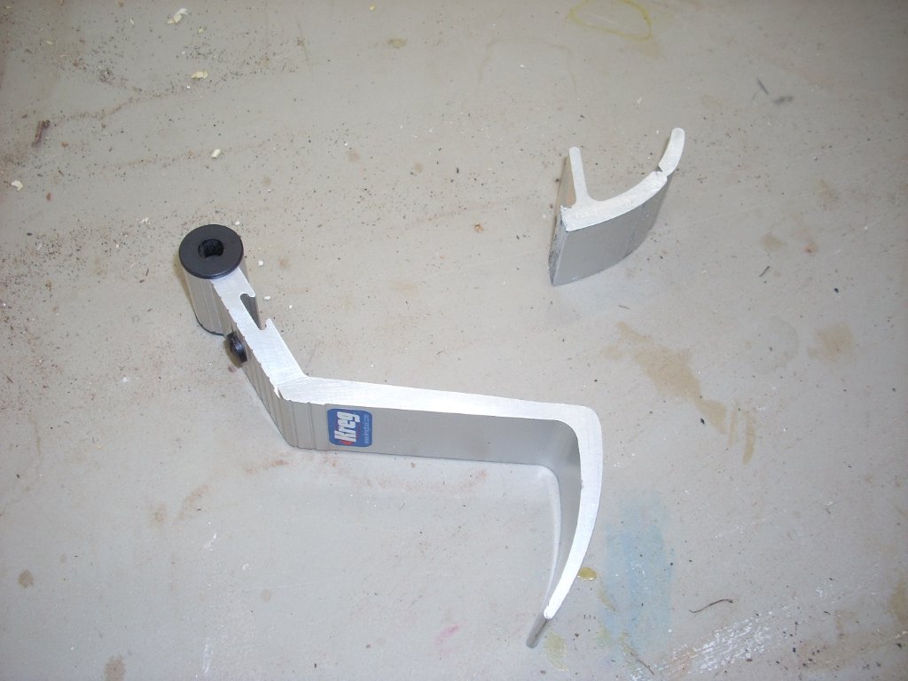

My plan was to use the old stop block off the miter for the table saw that I had removed and tossed as it got in the way on the miter. I had tested it and it worked in theory. I installed the track on the face of the rail even with the top edge. Testing the stop block, it would work with wide boards but nothing 1" or less. Fail... :roll: Hmmm? Maybe if I trim it.
10 Stop block fail.jpg (125.44 KiB) Viewed 5250 times
So I trimmed off the foot of the back edge of the stop block then polished off the roughness. If it worked well I would use the 220, 320, and 400 grit to make is shine. Nope, still didn't work at all.

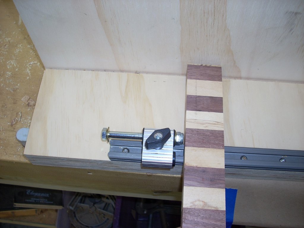

Got the Glued Up center pieces out of the clamps and test fitted them after trimming, between the walnut rabbited edge pieces. Test fit, trim, test fit, trim, test fit, trim. Bingo.
16 test fit.jpg (135.4 KiB) Viewed 4227 times
Once I was sure I had them where I needed the three pieces to be, they got glue applied, placed back in position to assure proper alignment, and clamped. They were allowed to dry for several hours.
17 glue up.jpg (167.68 KiB) Viewed 4227 times
I used a pull saw to trim everything flush as trying to do so on the table saw just seemed too risky, even holding the piece in a clamp. ;) Yup, I tried to find a safe way to do so. My rule there is if you have to stop and think if it's safe to do it ... just stop.
Once the piece was trimmed flush, there was a bit of fine tuning to be done. The width needed to be adjusted to fit the bolt, I took just over a 1/4" off each side. Then shaved an 1/8" off the inside of each leg to fit around the carrier with the washers installed for smooth operation. Assembled the block and tested and discovered that AS built it work really well except it wouldn't tilt for two reasons. The squared top hit the track and the locking knob hit the body.
- Rounded the top even with the washers.
- cut a half moon clearance into the body with a forstner bit.
Tested the stop block again, and we were golden. I sanded the rough edges and rolled the inside edge of the foot to ease the movement, the applied a coat of danish oil. Done.
18 stop block.jpg (108.31 KiB) Viewed 4227 times
