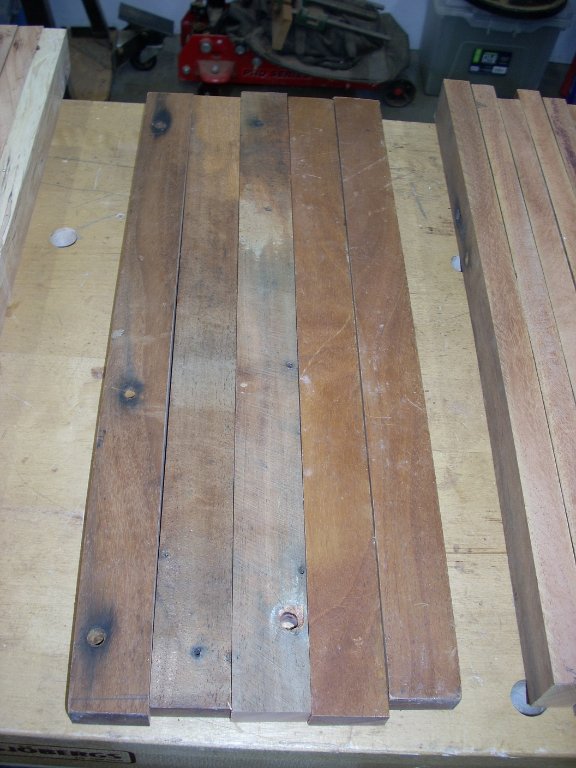

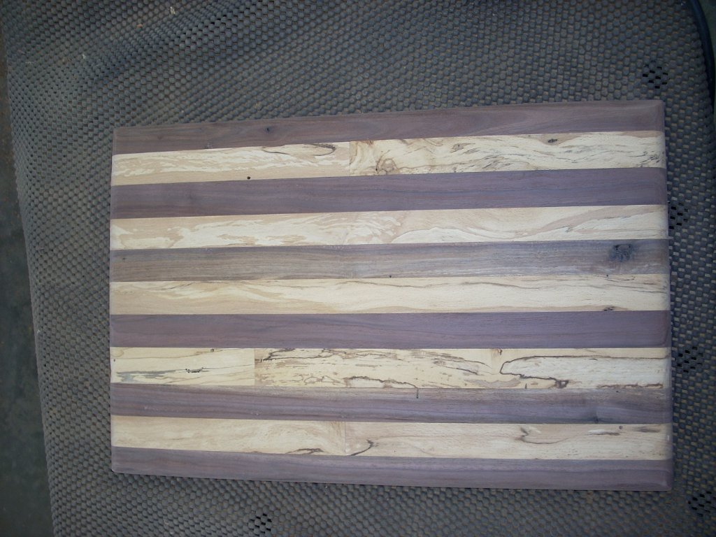

I got out in the shop today, and took the first two out of the clamps to clear the bench. Then worked on the layout of number three. Wanted to solve that puzzle and get it clamped before beginning the work on the first two. I had fueled up with a mug of coffee and was ready to go. I used the square and began the layout. Many of the last group's pieces had flaws, which I cut out, and I used pieces from the "Extra" group to fill in. I'm not slow, I knew I would need some. :roll: Been there before. (The rule is, when you prepare wood from rough stock, ALWAYS prep extra.) If you look at the initial layout, you'll see that there are some gaps as the pieces aren't all the same width. This can be fixed so it doesn't cause problems later.
13 layout number 3.jpg (152.95 KiB) Viewed 5640 times

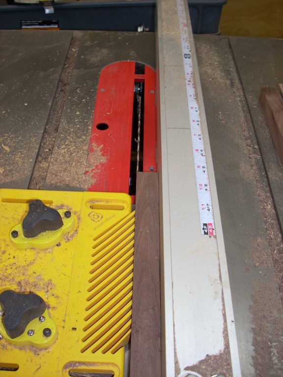

Set up the table saw, to the width of the narrowest piece, then made it 1/32nd smaller. Ran all the pieces thru ... :) Better safe than sorry. This was for width only, the height was set by the planer. 8-)
14 trim to match.jpg (128.2 KiB) Viewed 5640 times

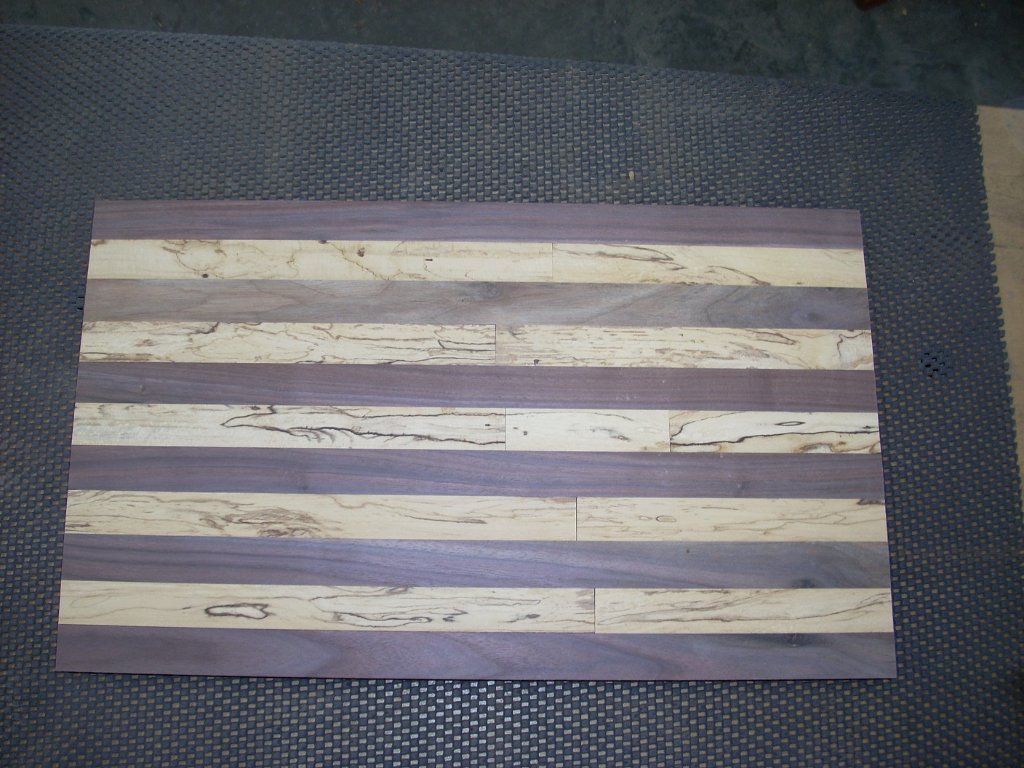

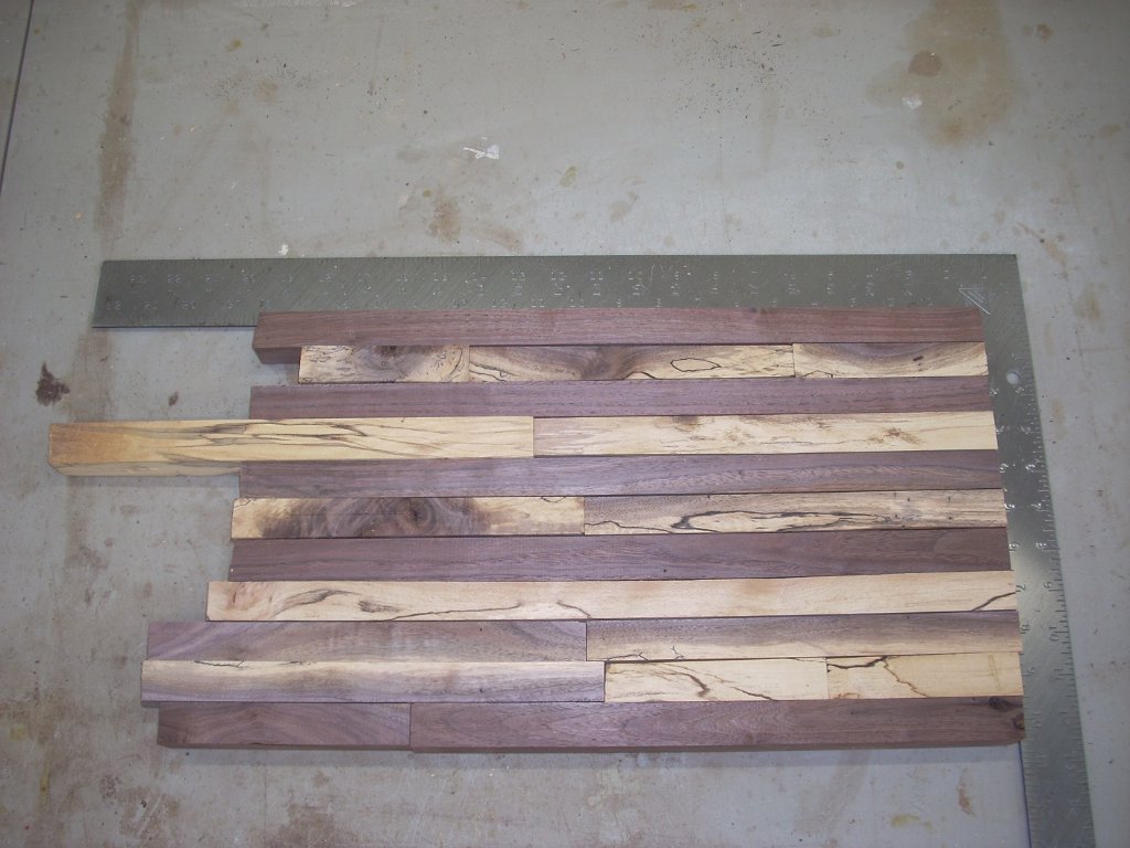

Now, went back to the layout, and with the newly trimmed pieces, including a couple extras, I was able to get a nicely fitted layout. No gaps. You'll note the reference edge is butted, but the left edge is left over long.
15 no gaps.jpg (155.18 KiB) Viewed 5640 times

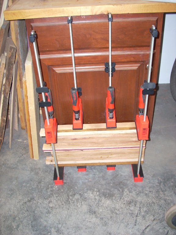

Number three is glued up and clamped.
16 glue up three.jpg (129.41 KiB) Viewed 5640 times

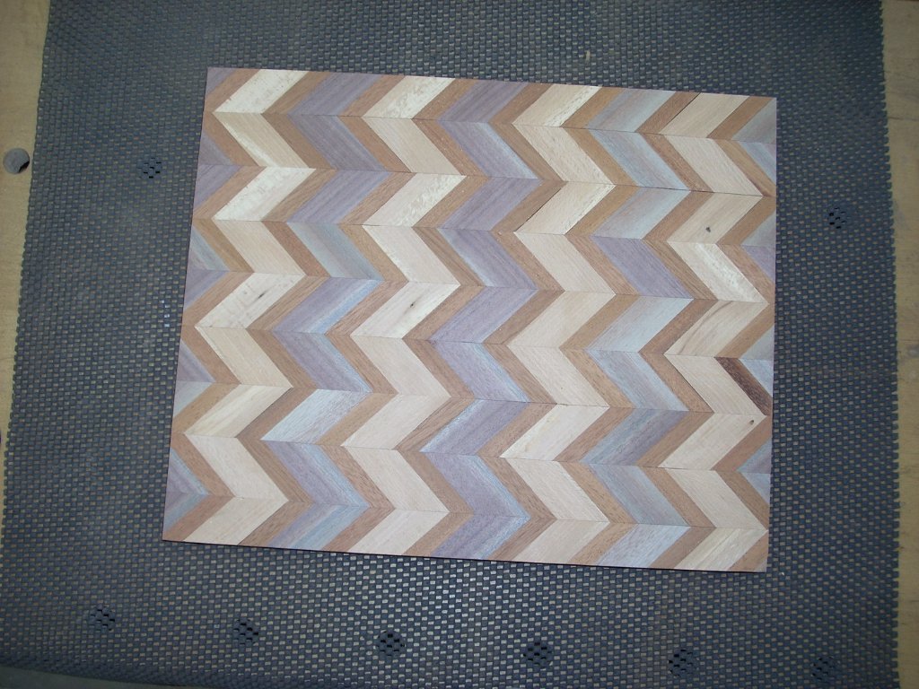

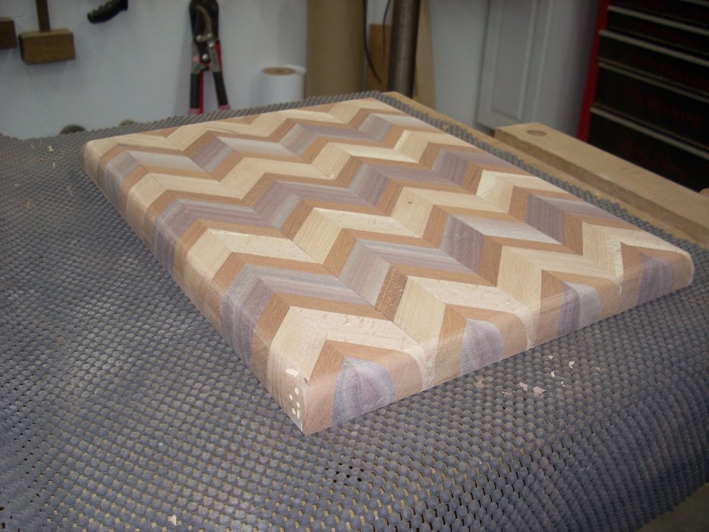

Time to start the Chevron Board. I watched several different videos on YouTube on the process and pulled techniques from several. It will be an involved process, and you end up gluing up the cutting board at least twice, but the result will be worth it, if I don't blow it. ;) I am using the walnut, maple and adding mahogany as a trim/accent. Prior to starting I ran all the stock thru the planer to insure that all four sides were smooth and clean. The mahogany was already crisp and clean from the prep work during recovery. (It's reclaimed, but that's a long story.) I ripped it to Height to match the other two woods.

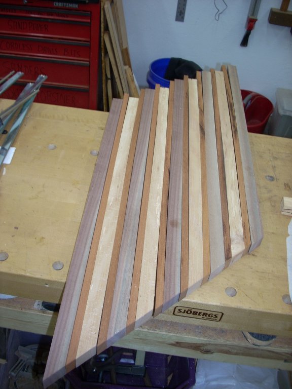

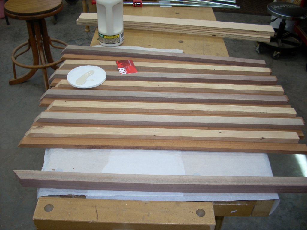

Let's get rolling. The first step is to cut one end at 45 degrees and all the pieces will reference off that end. Once that was done, it was a matter of starting the layout, then the glue up.
18 starting chevron pattern.jpg (107.94 KiB) Viewed 5640 times

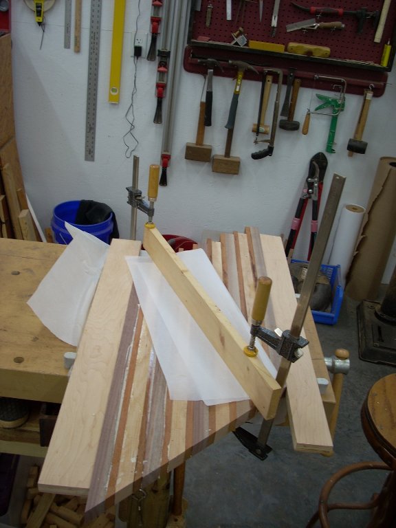

Once I was happy with the layout, I put down the parchment paper and got busy with the glue up. This was the longest by far as the thin mahogany accents added eight boards to the mix.
19 glue up chevron.jpg (147.98 KiB) Viewed 5640 times

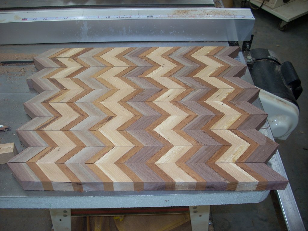

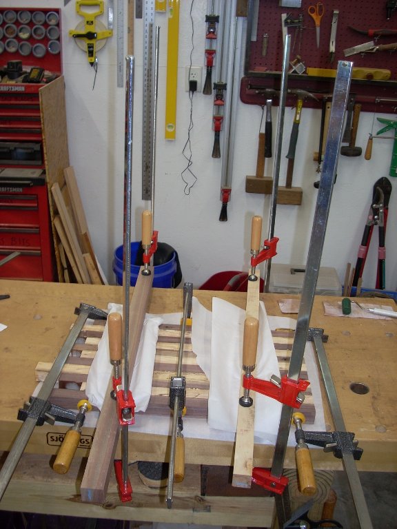

Once they were all glued up, I put them in the clamps and added the cross member for downward pressure to keep them flat.
20 chevron in the clamps.jpg (108.84 KiB) Viewed 5640 times
Hours later I was able to remove them from the clamps, true up the 45 degree edge and then cut one and a half inch strips using the 45 degree edge along the fence as a guide. Turning alternating pieces the opposite direction gives you the chevron pattern. Too tired to do the second glue up this evening, but you get the idea.
21 ripped at 1 and a half inches.jpg (173.14 KiB) Viewed 5640 times
I REALLY like this pattern, and I think THIS will be Miss Tina's board. :P Unless I blow it and it becomes kindling. :twisted:

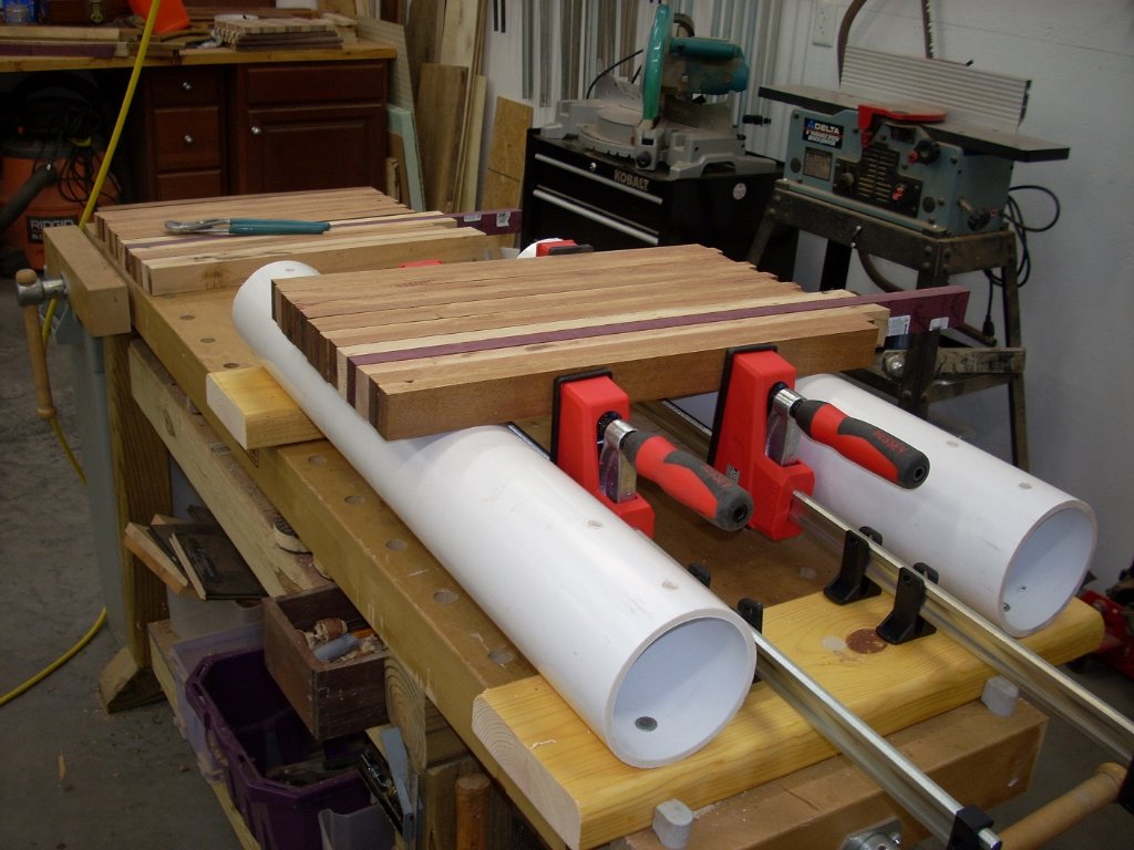

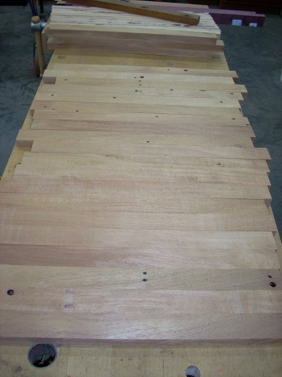

Got back to work on the Christmas Cutting Boards. I sliced that Table Top from my friend into 1-1/2 inch slices, AFTER removing the four metal screws I found buried in the wood. I used a hollow 3/8 bit to cut AROUND the screws all the way thru and drop them out the bottom of the boards, and I'll cut a 3/8 plug from leftover material and put in the sections before the glue up. I cut the sections so the holes left behind will be buried IN the cutting boards but for grins, I'll fill the holes with matching material, YOU never know. ;)

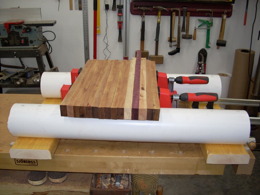

In case, dear reader, you didn't see the "Small Projects" post, I will be using the PVC work stand in this project. It was made especially for glue up of the cutting boards. Here is a mock up of the stand in use. It allows for smooth glue up and then clamping...
34 pvc rack.jpg (166.93 KiB) Viewed 5706 times
35 side view.jpg (153.7 KiB) Viewed 5706 times
The board components on the stand are the ones I intend to use, but they had not yet been planed. The main component show is the exotic from the Caribbean. The name escapes me, but I will make the two boards from these slices from the table top and present them to my Friend and his son as a memorial of the Father and Grandfather, pilot of a bomber in WWII and a good role model all their lives. He is living in a home these days, but still sharp as a tack and recently interviewed and video taped so his memories of a critical mission during the war could be forever kept and used at the WWII Museum. If you visit, Dave's Dad narrates the harrowing mission where is gunner had his foot shot off and still completed the mission. As Pilot in Command he recommended the Gunner for the Silver Star, which he received.
I wandered off topic, which I am prone to do... Sorry.
The table component, prior to planing.... kinda shows it's age.
36 table slices.jpg (119.08 KiB) Viewed 5706 times
All those slices after planing.... beautiful.
37 after planing.jpg (98.17 KiB) Viewed 5706 times
If you look at the upper picture, note the maple and purple heart accent. As stated in another post elsewhere, I intend to rip those in half, thinning those from 3/4 to 3/8 thickness. They are intended only as accent pieces and I think at the 3/4 thickness they do more than accent. I may split them and put an accent at the top and bottom, or just the single accent stripe. Thoughts?

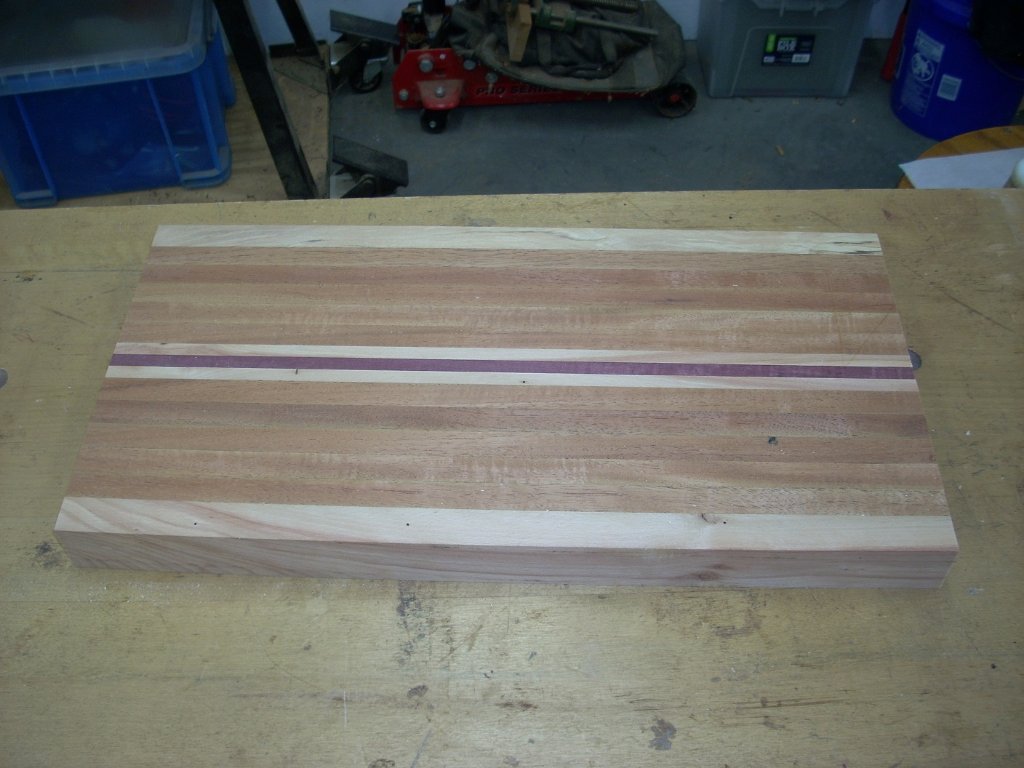

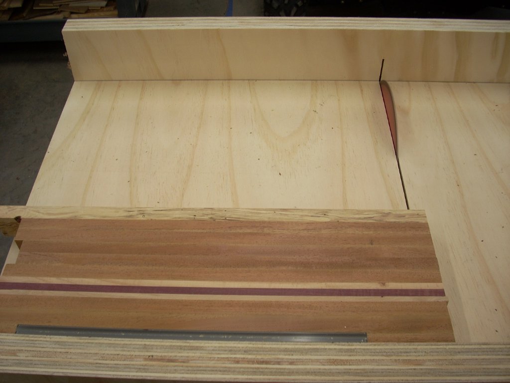

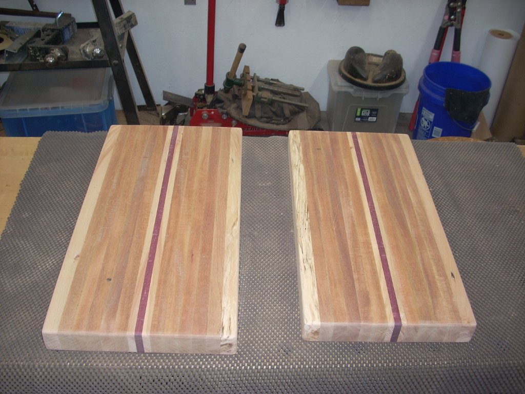

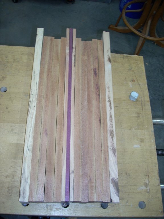

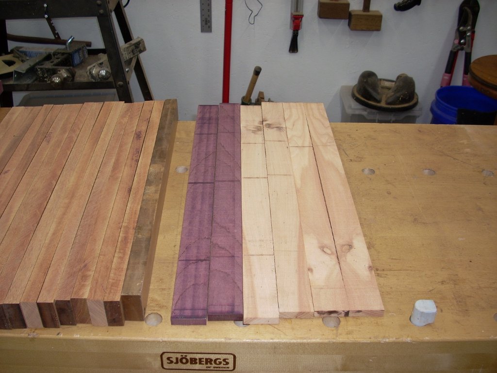

Worked on the new boards yesterday and this morning. Yesterday I marked the accent pieces and ripped them to 3/8ths, then ran them thru the planer. A slow steady pass thru the band saw nearly got them to the same size... :roll: ... nearly. :)
38 ripping the accents.jpg (195.85 KiB) Viewed 5693 times

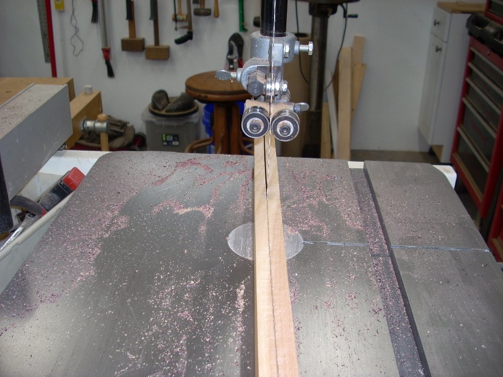

After ripping you can see they are pretty close, but there are still waves and ripples and some burn marks, they will take a few passes thru the planer. That purple heart sure is a beautiful deep color huh?
39 after ripping.jpg (156.51 KiB) Viewed 5693 times

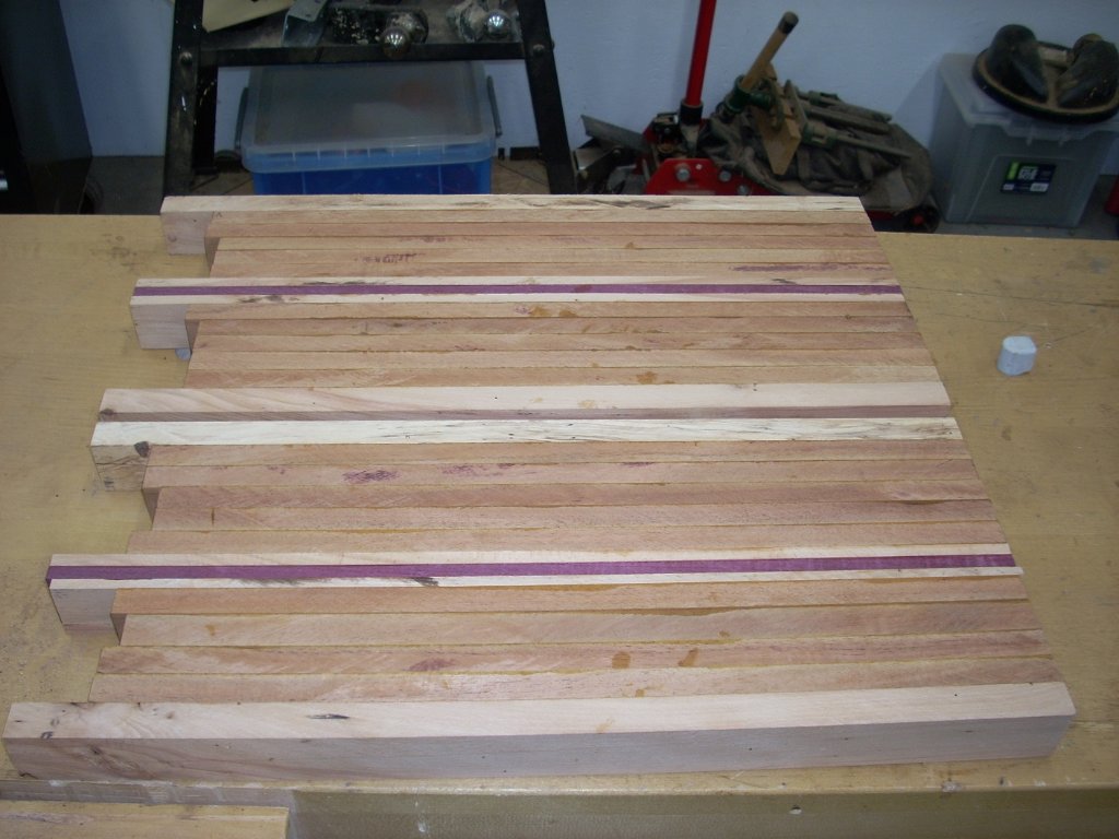

Rolled out the planer and ran them all thru, until they were a consistent size and smooth so they would glue up tight and without gaps. Then test fitted them loosely, with just hand pressure looking for gaps, didn't see any. If you don't see any with hand pressure, there certainly won't be any with the pressure applied by the clamps. (2200 pounds.) ;)
Here is the new pattern, I certainly like it a lot better. I left the glue up for the next day.
40 better size.jpg (105.2 KiB) Viewed 5693 times

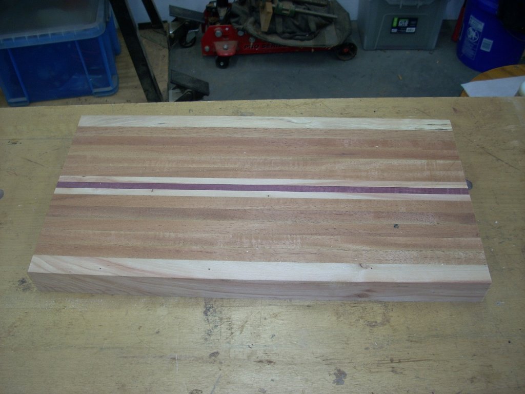

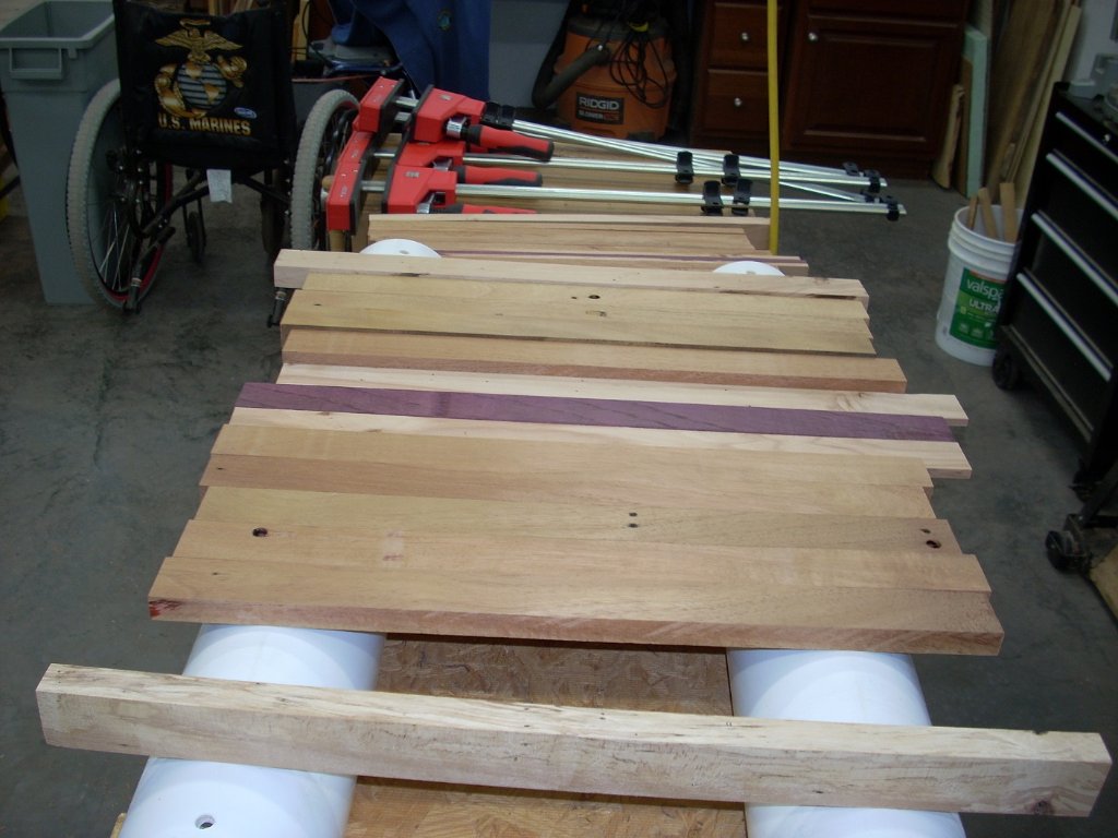

This morning I headed out to do the glue up. A chance to try the new jig and see if it was worth the effort. Clamped it on the bench and laid out the first cutting board. You leave the nearest piece standing and lay each of the others flat turning them back away from you. Then you glue the side facing up and turn each one to the board in front, rebuilding your cutting board.
41 laid out for glue up.jpg (154.03 KiB) Viewed 5693 times

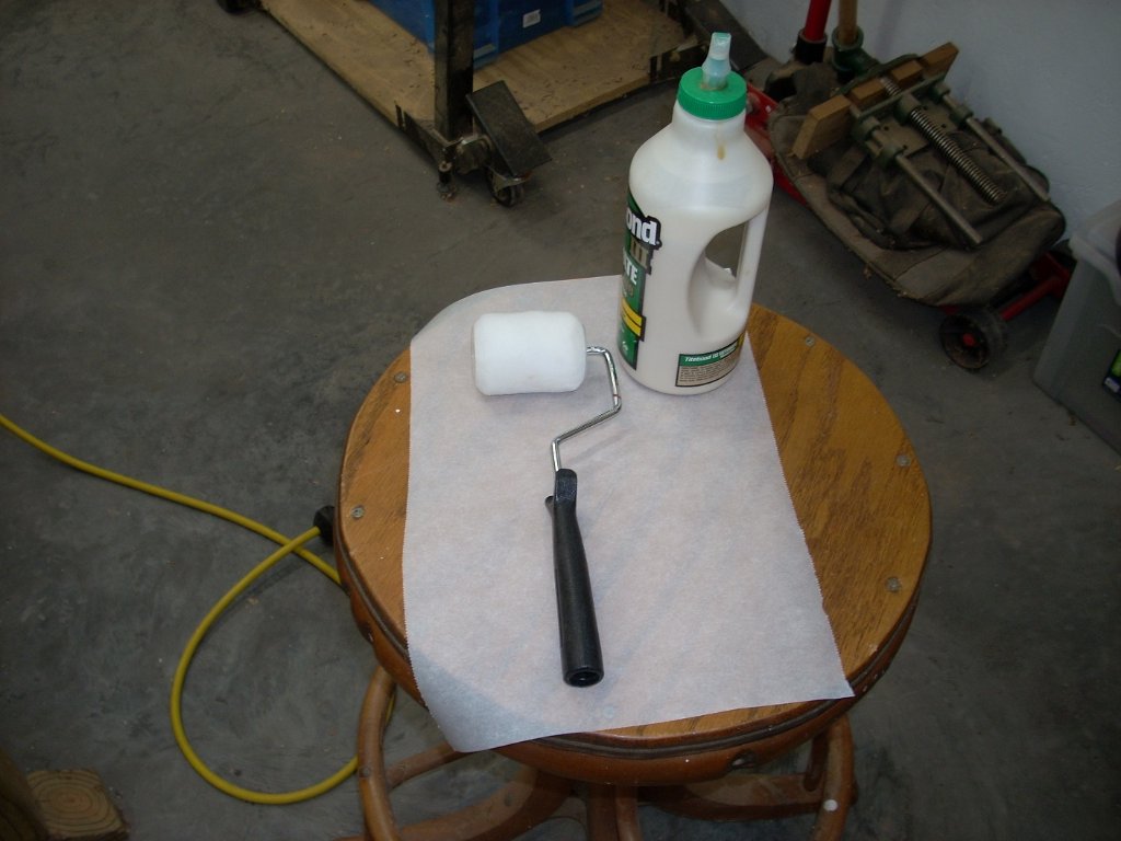

There are a number of ways to apply the glue, and I have tried several, seeing many options in the video. I finally found the one that works the best and would you believe it is a properly sized paint roller. Once it soaks up enough glue that it doesn't suck up anymore, it's a dream for application. Even and smooth and quick. You squirt the glue directly on the board and then spread it evenly with the roller. Place the board then repeat.
42 would you believe a paint roller.jpg (131.87 KiB) Viewed 5693 times

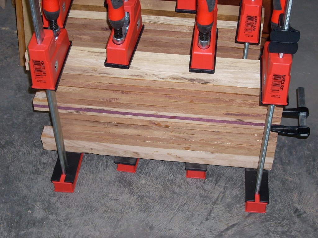

Careful application of the glue reduces the mess, and makes for a smooth even job. Once all the glue is applied you clamp up the project and set is aside to dry.
43 clamped and set aside.jpg (133.39 KiB) Viewed 5693 times
Here is a closer look at the pattern as clamped. Once the board is set up, it will have the edges trimmed and then be scraped to remove excess glue and run thru the planer and sanded to 320 or 400.
44 closer look.jpg (209.01 KiB) Viewed 5693 times

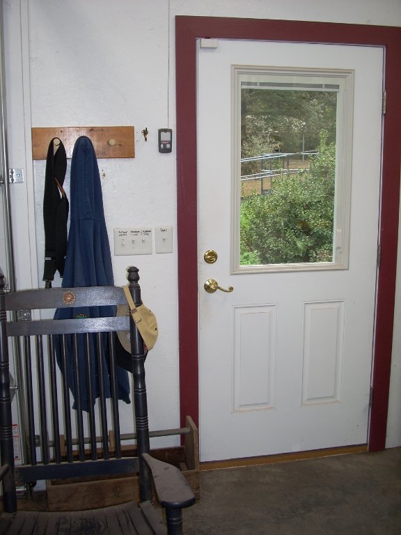

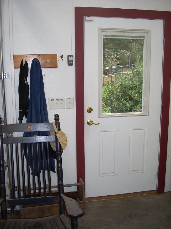

So today, before I got started, I figured I would put up more hooks. I knew I had a half dozen of the brass coat hooks somewhere, I had remembered seeing them. I hung my jacket over the back of the walker and started looking. In the drawers and cabinets. I knew I had seen them in the last few months. :roll: I had laid them all out on the bench for something. I know I had seen them and .... I looked in the different cans on the shelf. Where did I put them... :| Oh... I remember why I laid them all out. Tina wanted a rack made for the dog leashes and collars.. :evil: :oops: There are now eight brass hooks mounted on a pine board in the laundry room. (Gibbs Slap.) Half Hour Wasted.
So, I took a pine board and cut it to 18", marked three equally spaced locations and drilled a one inch hole with a Forstner bit... then... Boom, four inch long 1" dowel. Coat rack. Now where to put it. Needs to be near the door, but... ;) Oh... I have been thinking I need to move the pencil sharpener nearer the workbench, WHY walk all the way back to the door to sharpen a pencil? Duh. Disassembled the sharpener... (AND discovered it was packed full... I MEAN packed full of two years of shavings.) :twisted: unscrewed the sharpener from the wall and shavings went everywhere.
Installed the sharpener to the left of the tool cabinet near the work bench after spending a few minutes cleaning it out. Then Installed the coat rack beside the door. Place to hang the coat and the apron. Extra hook for Miss T when she comes in. (Half hour now gone.)

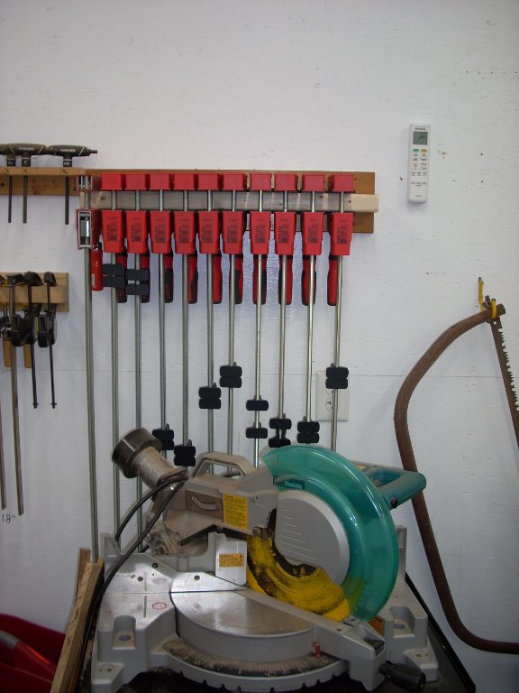

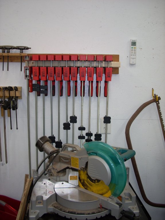

Back out to the shop after lunch.... took the clamps off the cutting boards, and put them back on the rack.
46 clamps put away.jpg (108.4 KiB) Viewed 5667 times

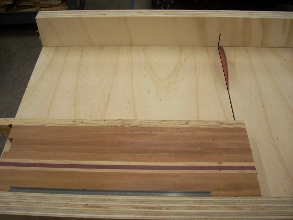

After they were planed smooth, I put them in the SLED I built to allow for this operation and trimmed both ends square. This would not have been possible without the sled. The miter bar would not have been deep enough to allow the width of the cutting board to fit nor strong enough to handle the weight.
48 Sled ride.jpg (125.45 KiB) Viewed 5667 times

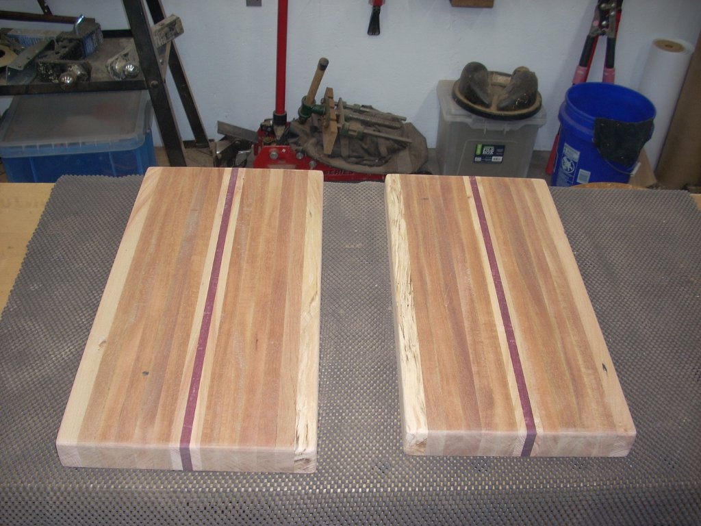

Once both were trimmed, I used the 1/4" roundover bit in the hand held router to round the top edge of both cutting boards then switched to the orbital sander and smoothed the tops, sides and the bottom to 120 grit, rolling the edges and the corners at this grit. I took my time and made sure it all looked good. Next I upped to 220 and worked the edges and top again and the result was a surface like high quality glass. I wish you could feel it.
51 sanded to 220.jpg (183.24 KiB) Viewed 5667 times

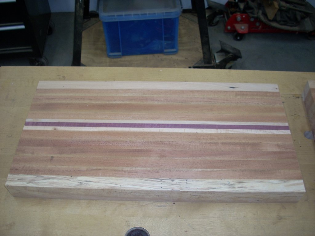

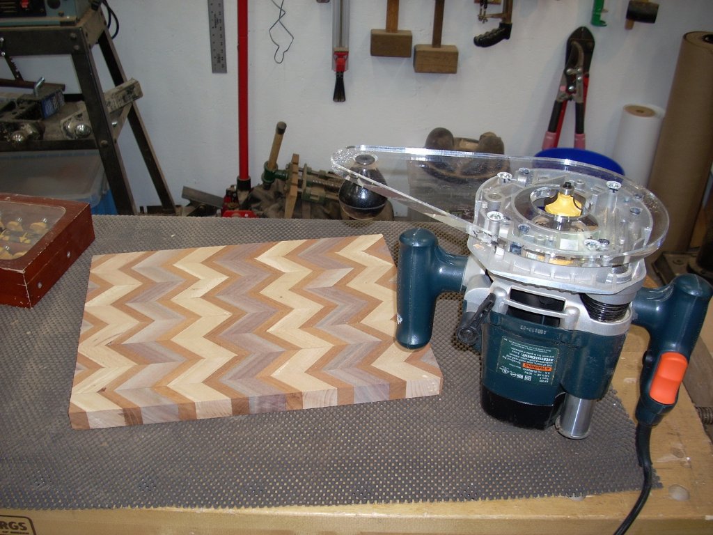

Got back out to work in the shop, and went to work on the first four boards to see if I could salvage them. I put a clear base on the router for better control, but THAT became a task since it didn't fit the Porter Cable router. Careful measuring and three step drilling and it was installed.
52 router base.jpg (193.81 KiB) Viewed 5651 times
Note the clear base is wide, and has a handle for the left hand for excellent control. I had "Forgetten" I had this, but it is a great asset to aide in both control of the router and stability. Look at the clean cut of the passes on the Chevron cutting board. Nice, except for the beading caused by the thickness of the board and the edge of the router being wider than the bearing. My fault.
53 bead line.jpg (139.94 KiB) Viewed 5651 times
Some time with 120 grit sandpaper smoothed the transitions and took away the bead line.
54 removed.jpg (128.62 KiB) Viewed 5651 times
Then, I worked the top and sides again with 220 and got a nice smooth finish on this puppy. Awaiting the CA glue to arrive and we will be golden.
55 better view.jpg (175.32 KiB) Viewed 5651 times

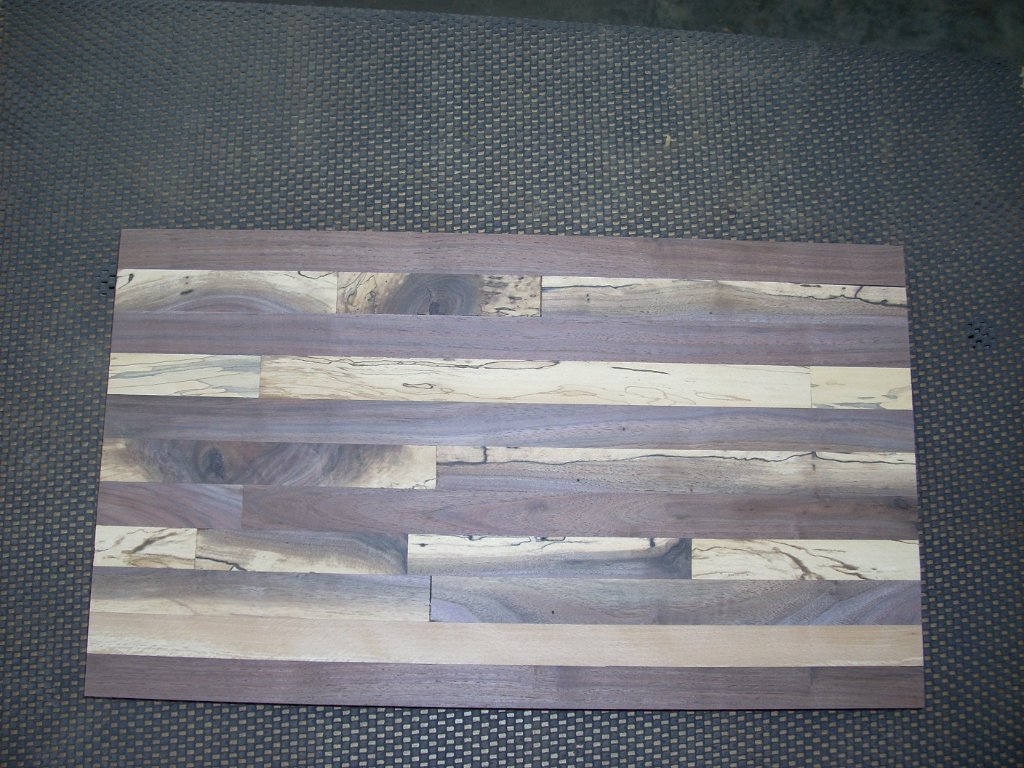

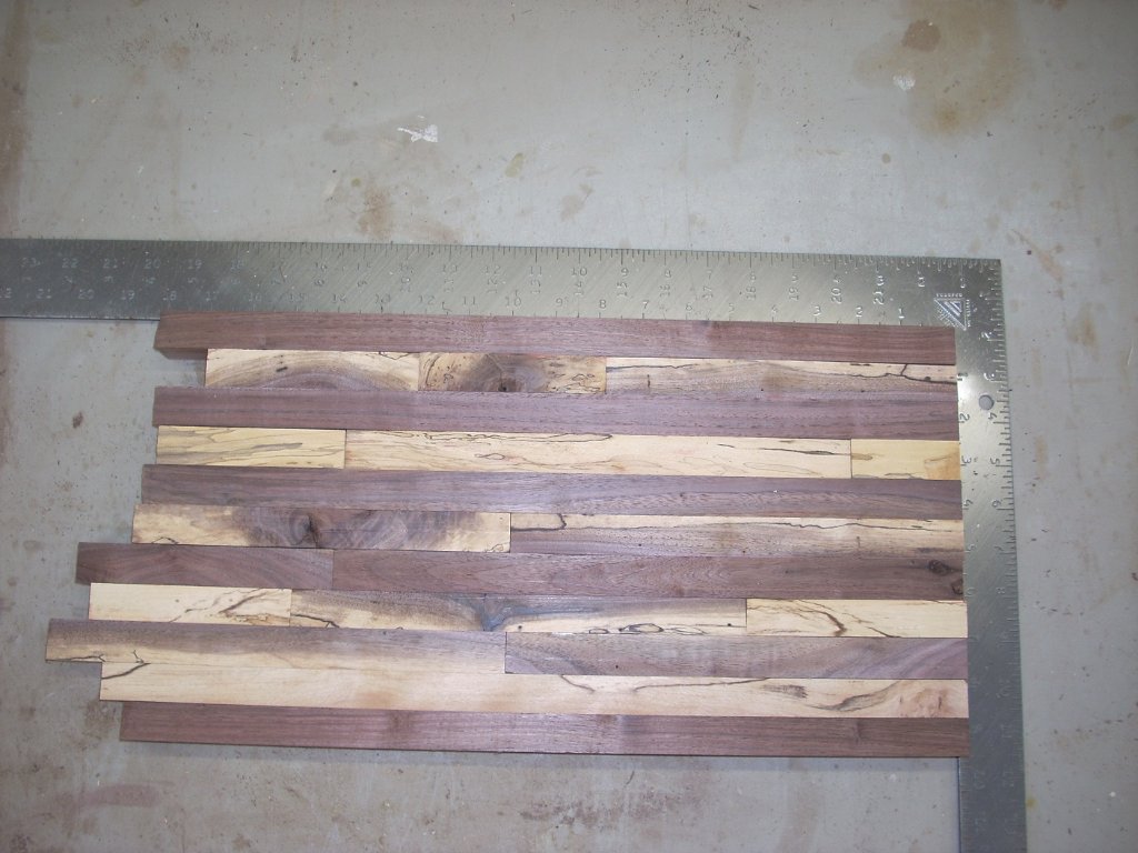

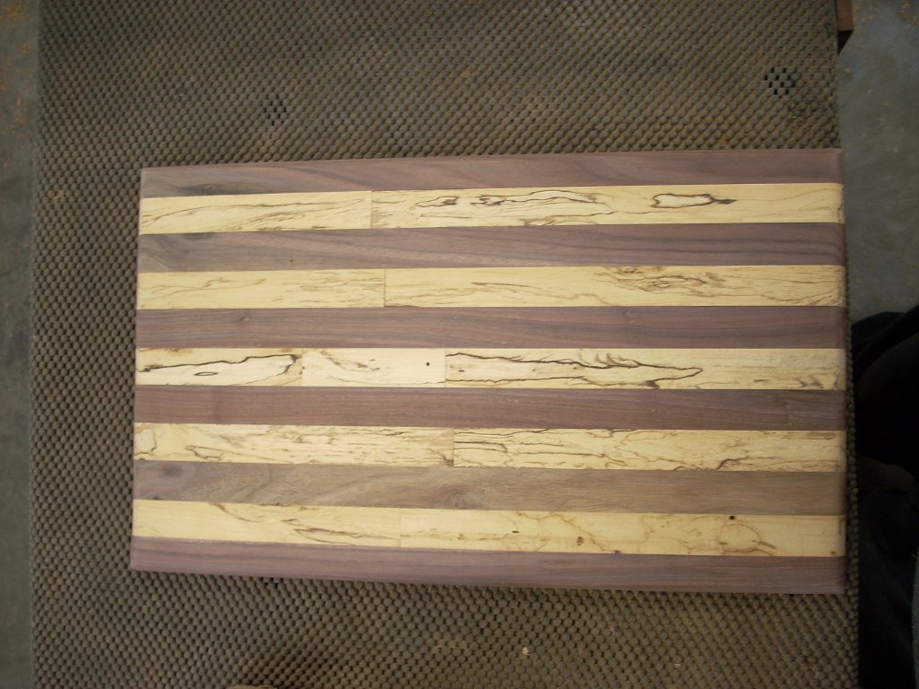

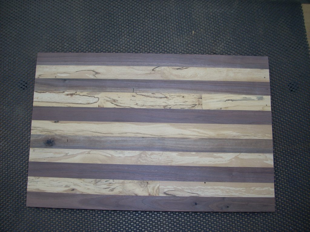

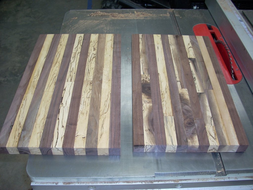

Worked on the walnut cutting boards as well. They had their edges dressed up and the scratches from that old nasty router table removed. The edge beading was removed with a plane, and I ran them thru the planer a and shaved just enough off the top to remove the scratches. Then 120/220 for these as well. Boards one and two are done, three is clamped regluing a loose joint.
56 walnut one.jpg (184.14 KiB) Viewed 5651 times
57 walnut two.jpg (179.41 KiB) Viewed 5651 times

I didn't have the purple heart when I made those first four. Woodcraft put it on sale after they were done. Believe me, it was bought for accents. :D I bought a good bit. I have a good supply of lacewood, but I make nice boxes from that. :D
