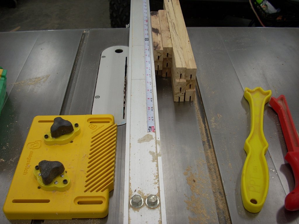

Okay, next up, began to cut the cross pieces, (Rails) There are four braces, and six pieces that will become part of the Doors to the Bins. I measure them against the back panel, which will insure that the case stays square. Before beginning to measure, I cut the first end on the table saw to insure it's square, and check it with the pocket square. Then place the 17 inch bar across the back panel, which is 14-5/8" wide. Mark it, then trim it EXACT with the miter on the table saw. Creep up on the cut to insure it's not under cut.

Once I get all the rails and stiles cut, I will have to mark all the dowel holes, and then drill them. Before I drill holes, I will make a JIG to insure the holes are uniform and straight.
Then cut the dowels to length so about 3/8" is exposed. The dowels will insure proper alignment. (If I did everything right.) If not, time for the planes to come into play. ;)

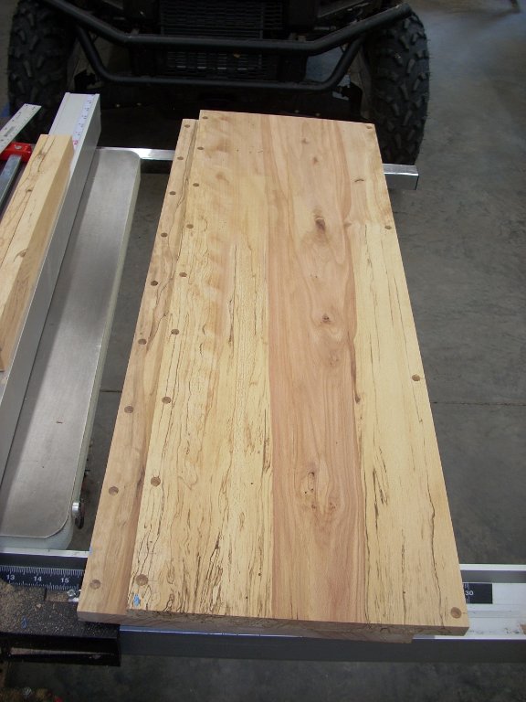

This morning, I remarked the GOOD/Face side and drilled 3/8" countersunk holes 3/8" deep with the forstner bit. Then thru holes with a smaller bit just the size of the threads on the torx screw I planned to use. I then switched to the bit that was the shaft size of the threaded section of the screw, but smaller than the threads. I flipped the panel and countersunk the back side to allow for the little glue bleed out when you glue the panel together. This could hold the panels apart.
I painted the edge of the plywood back, and clamped both ends in alignment with the side, and screwed both ends in place. Then I used clamps to bring the side into alignment down the length as I screwed each countersunk anchor point. When both sides were attached, it was rock solid. :P More than one way to attach a skinned cat. 8-)
The countersunk panels:
35 countersunk.jpg (109.84 KiB) Viewed 5554 times

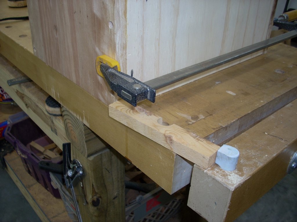

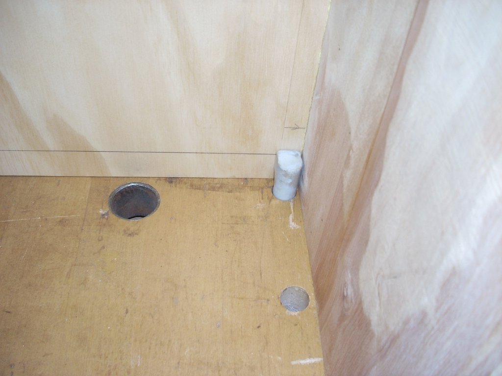

When assembling the right side, I had to use a cheat to get the bottom panel to line up. I put a bench dog inside, and then used the bench vise to push against the case to force alignment and screwed it in place.
37 tweek right.jpg (148.66 KiB) Viewed 5554 times
38 tweek right 2.jpg (115.62 KiB) Viewed 5554 times

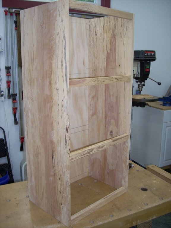

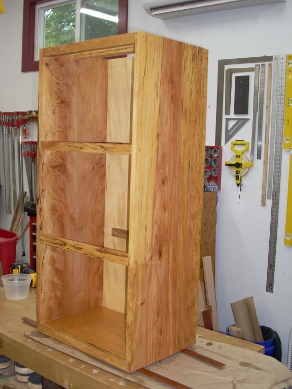

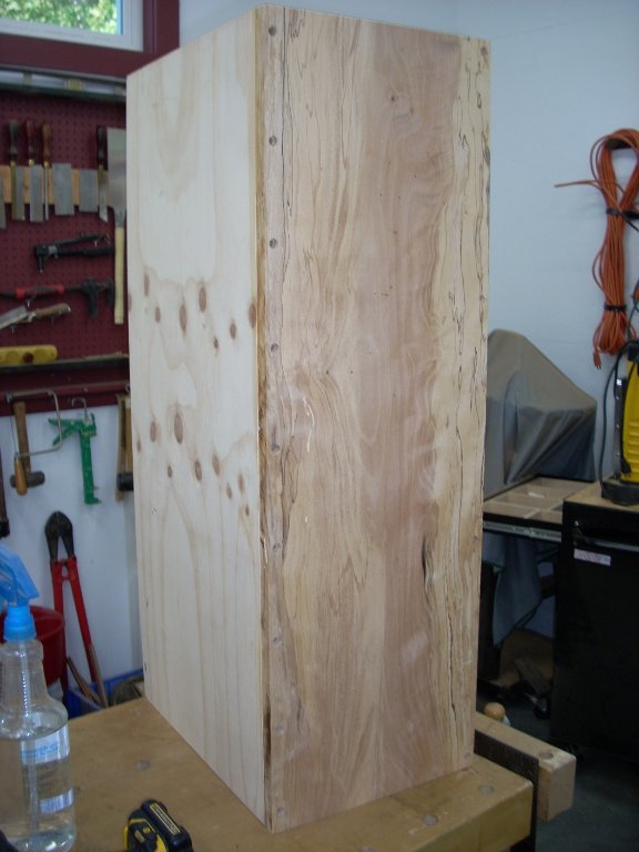

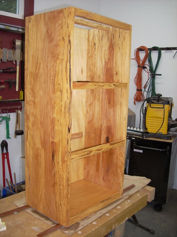

After both sides were screwed in place, I carefully measured and marked the cross braces and screwed them in place. The basic case was then complete... sorta.
39 case assembled.jpg (112.57 KiB) Viewed 5554 times

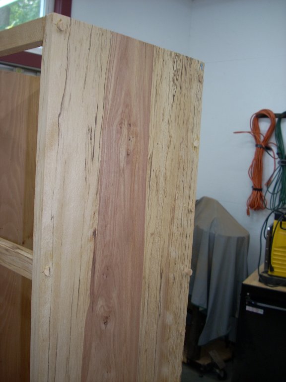

Using the 3/8 plug cutter and maple scraps, I cut the maple plugs and glued and seated them. Then, I took a nap while they set.
40 maple plugs.jpg (94.39 KiB) Viewed 5554 times
After a nice nap, I used a flush cut saw, and a chisel to flush cut the plugs then sand them. They disappeared.
41 what plugs.jpg (102.07 KiB) Viewed 5554 times

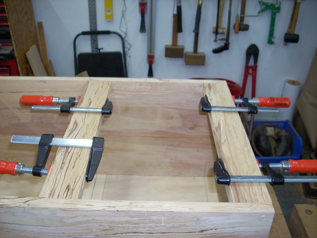

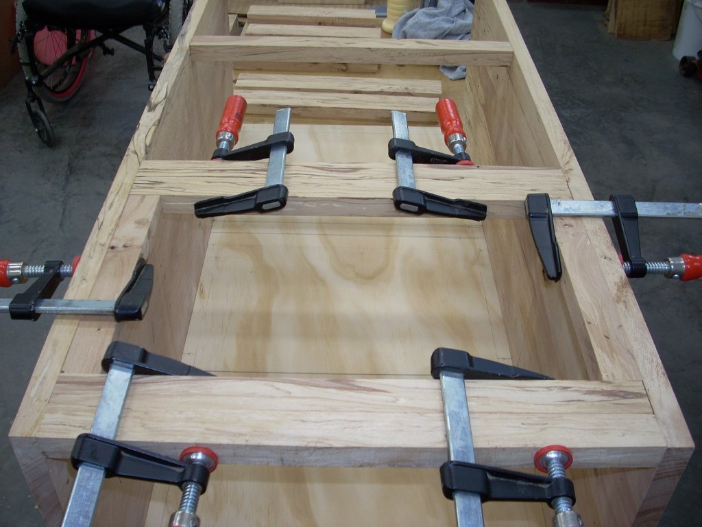

So... with the case laying on it's back, I fitted the Rails, (Cross Bars) for each door section and clamped them in place.
42 fitting door rails.jpg (141.89 KiB) Viewed 5522 times
With them clamped into place, I could fit the Stiles, (The Vertical Sections).

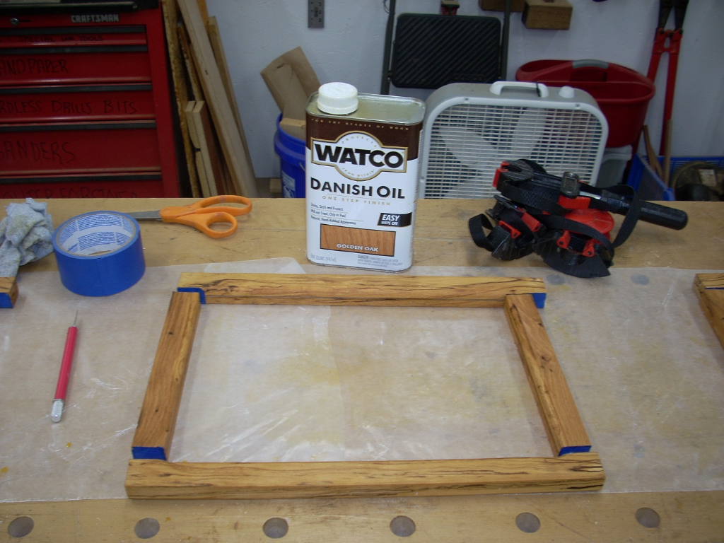

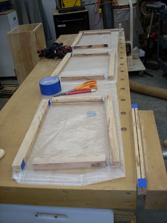

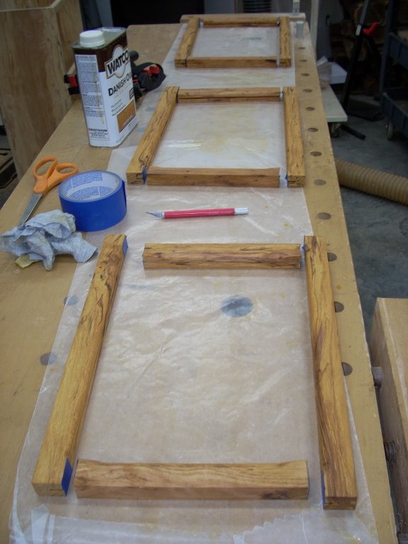

I usually pre-stain some of the components when there will be glass or wire installed. Before staining, I tape the contact points that will take glue, or the glue won't hold. Especially with Watco oil.
46 pre stain taping.jpg (107.5 KiB) Viewed 5522 times
Now that the taping is done, time to pop that grain.
47 stained em.jpg (105.89 KiB) Viewed 5522 times
They are all stained with two coats of watco. I'll let them dry for a bit, then cut the wire and glue them up.

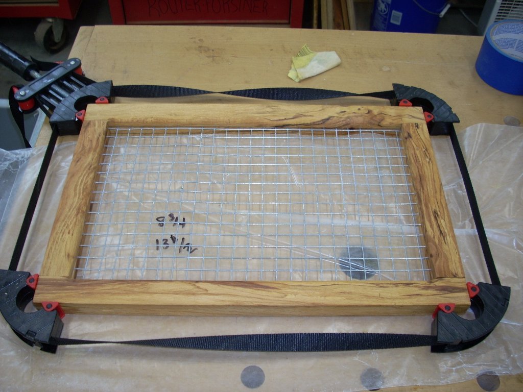

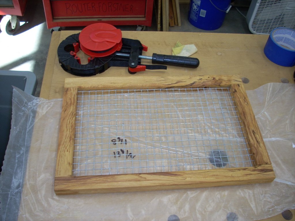

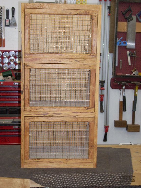

Got back out in the shop for a couple days work. Once the doors had been stained, it was time to peel off the tape and carefully measure each door, write down the measurements and cut the wire to insert into the dadoes. Using band clamps, I test fitted each wired front and trimmed as needed for a tight fit, but one that still allowed a little movement. Once I was sure there was a match up, the glue was applied, the band clamps were tightened and then I checked the assembly was square and set it aside to dry. This step was repeated for all three door assemblies.

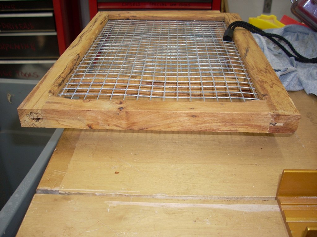

50 fitted the wire.jpg (178.05 KiB) Viewed 5487 times
Once the doors had set up the band clamps were removed and any glue squeeze out was carefully pared away with the one inch chisel. Razor sharp, so extreme care was needed to only peel away the glue and not cut the assembly. The oil finish that was applied, allowed the glue to peel off with a careful application of the sharp chisel. ;)

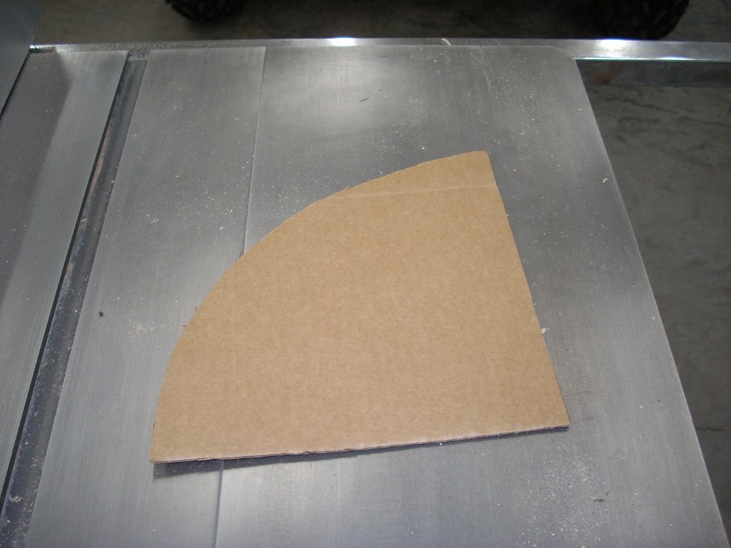

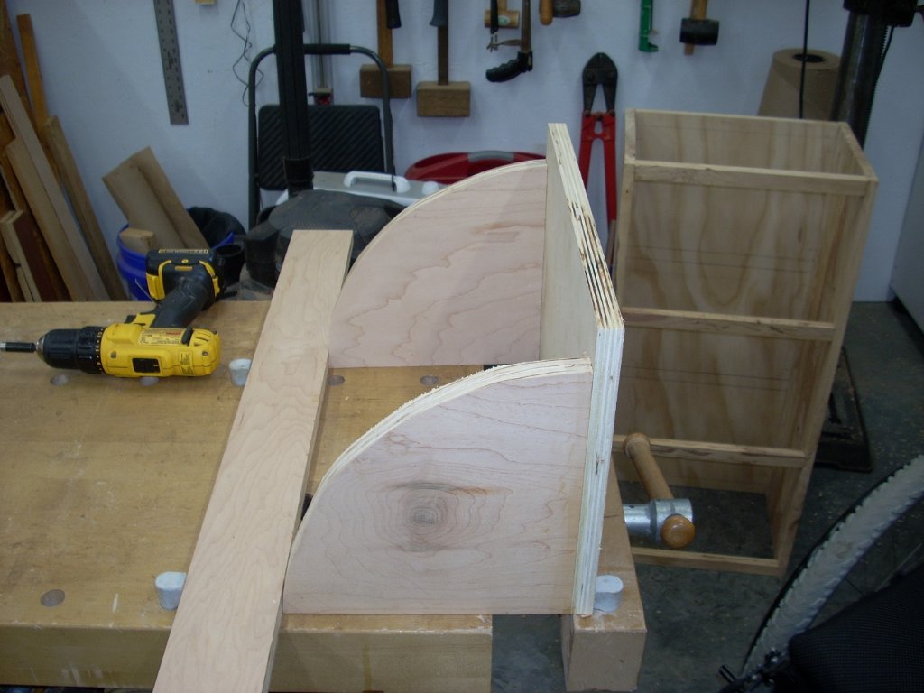

Next up, assembling the sides. First I mock up the side using cardboard and play with opening the door, trying to find a correct angle. Once I have it, I cut out a cardboard template and then cut the sides on the bandsaw.
54 trial and error template.jpg (131.16 KiB) Viewed 5487 times

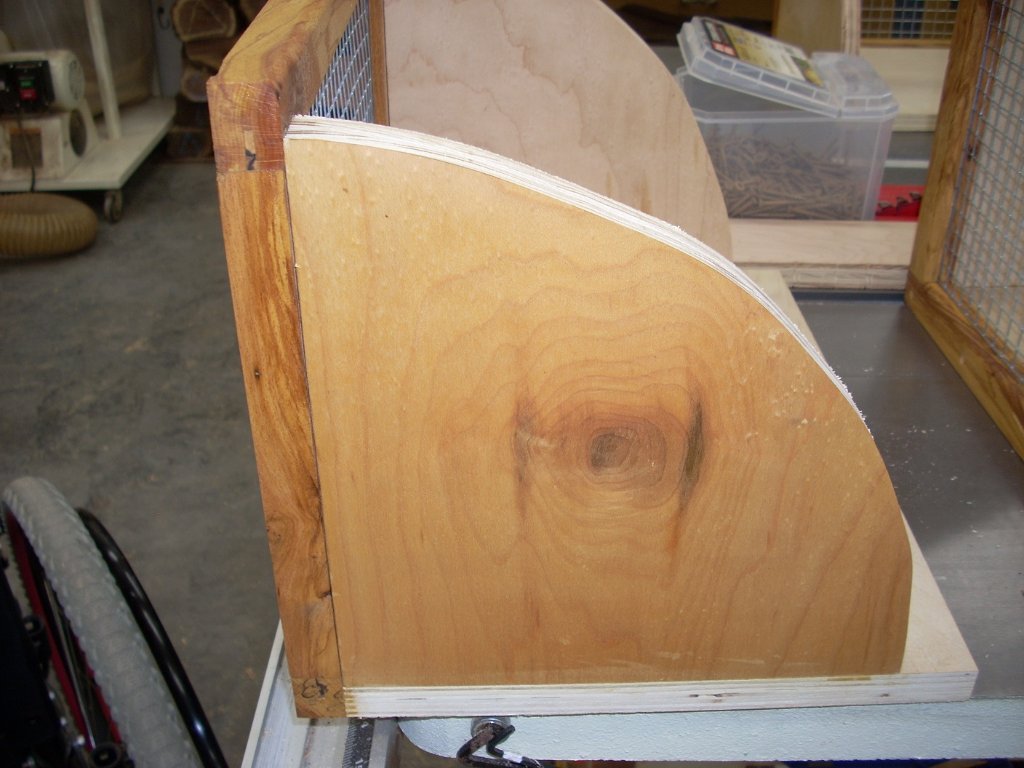

The bottoms and the sides are cut, matching the bottoms to the exact width of each door. The sides are all cut the same.
55 bases and sides.jpg (174.98 KiB) Viewed 5487 times

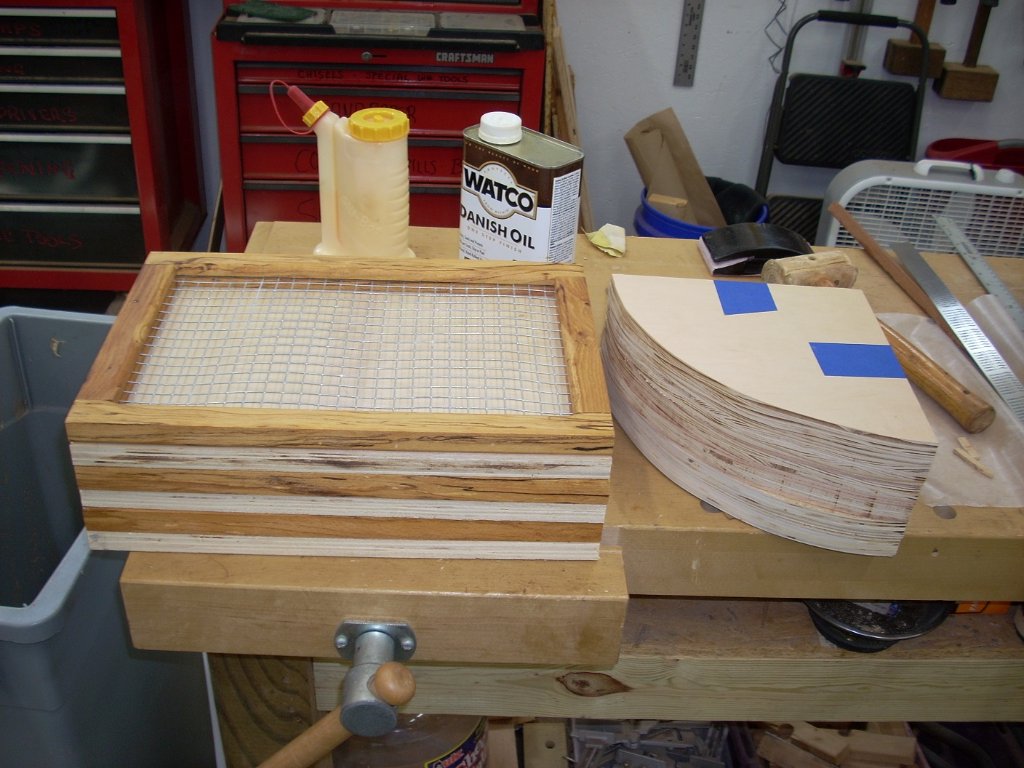

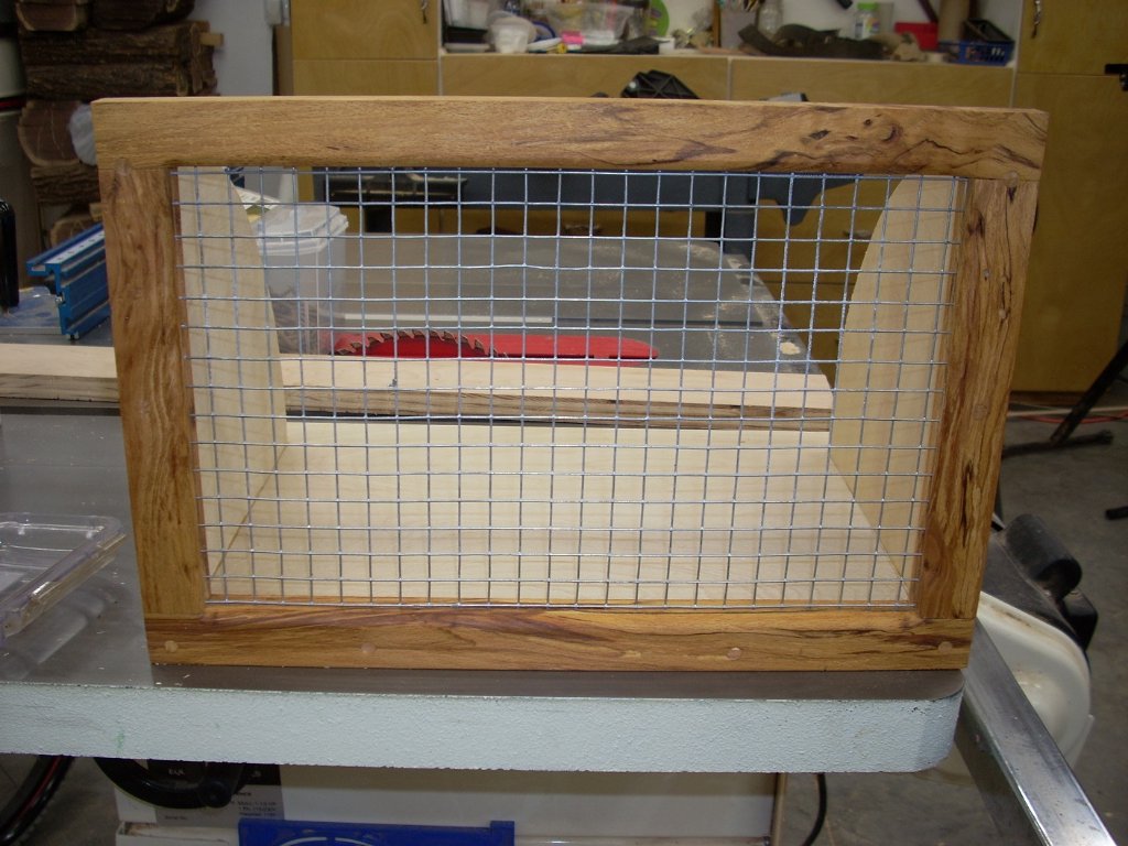

I carefully assemble the bin bodies, using the bench to hold everything in place as I glue and screw the assembly together. Care must be taken for alignment. measurements are marked out on the base, and the assembly requires multistep drilling. The first hole is a small drill bit to mark thru for reference. The second is a countersink on the underside drilled with a 3/8 forstner bit. A third hole is drilled thru the base at that point the same size as the shank of the screw. After the glue is applied to the sides, and everything clampled in place, a pilot hole is drilled thru the plywood, just under the size of the threads, to prevent splitting, and the threads are dipped in glue.
56 assembling the bin body.jpg (138.06 KiB) Viewed 5487 times
Left to dry overnight, I come out in the morning and work on attaching the doors. The multi-step drilling process is used again, this time the countersink is drilled on the face of the door with 1/4 inch forstner bit. This will be plugged and stained once the process is completed.
57 doors attached.jpg (156.3 KiB) Viewed 5487 times

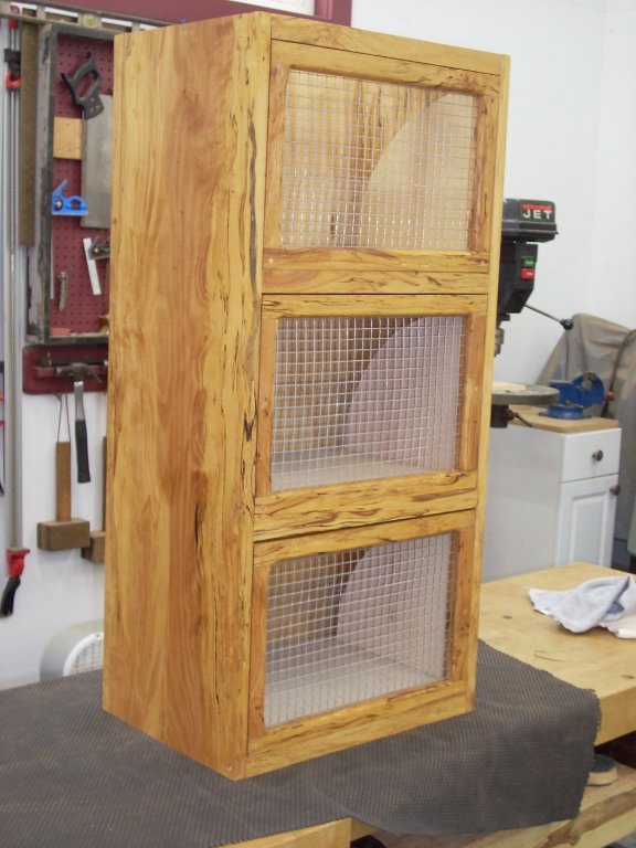

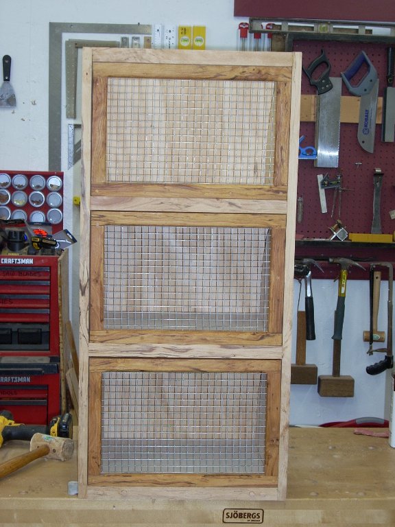

Back out in the shop this evening for late night session. I got interrupted while the glue was drying and I was doing a mid project cleanup and wanted to finish that, then... too much pain to sleep so... wanted to knock out another step or two.

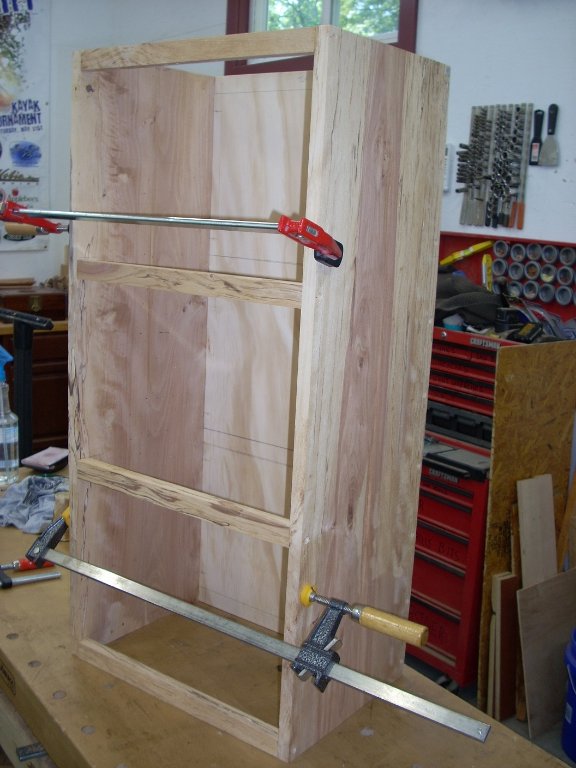

The bins were nearly complete so I thought I would fit the braces in the back of the cabinet. This entailed test fitting the bins, and then making sure they were level and fitting the cross brace at the back of the cabinet that would insure they didn't tilt back and supporting the weight of the bin when it was full. I also shot a couple close ups of the plugs after they were all trimmed and stained... :)

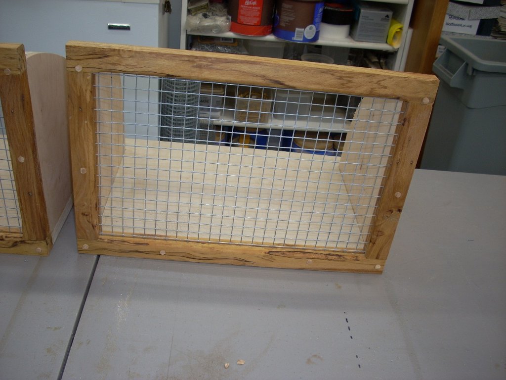

Here is a close up view of one of the doors after the plugs are trimmed and stained. Not that noticeable anymore huh?
60 close up front.jpg (182.27 KiB) Viewed 5465 times
A view of the side of the bin... The dado plugs don't stand out too bad either huh?
61 the side.jpg (147.22 KiB) Viewed 5465 times
Not too worried about the bottom at this point in case trimming was needed. I did end up having to trim the rear edge of all three to flush up the front. Easy enough, measure, set the table saw fence and run the bin thru the blade, shaving a bit off until it fit the way I wanted. The extra at the rear is there to engage the brace at the back and hook the Rails to keep the bin from coming all the way out when you tilt it forward.
We are nearly there now. The bins need the pull handles or knobs.
They need the wire across the back to secure the taters.
The hinges need installed.
The top needs installed.
Some final sanding and the staining of the cabinet.
The base needs put together and installed.
Another day, maybe two.
62 getting close now.jpg (144.28 KiB) Viewed 5465 times

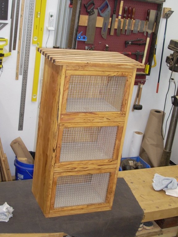

Last bit of work for today, two sessions.
In the first of the two sessions:

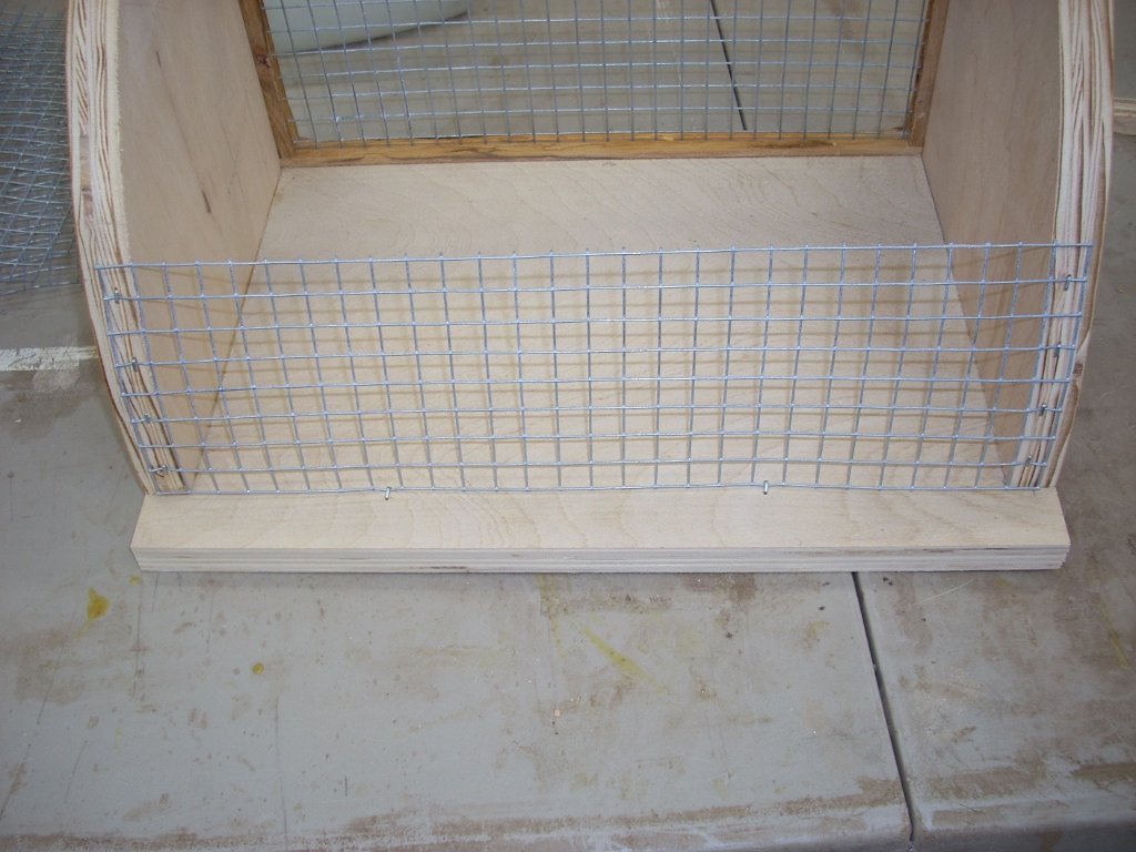

I put the wire back on the three bins.... so the taters and onions don't roll out the backs. ;)
63 wire back.jpg (159.76 KiB) Viewed 5147 times

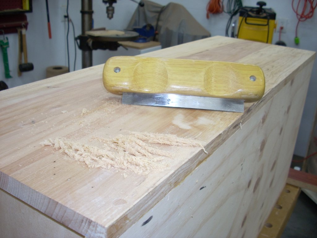

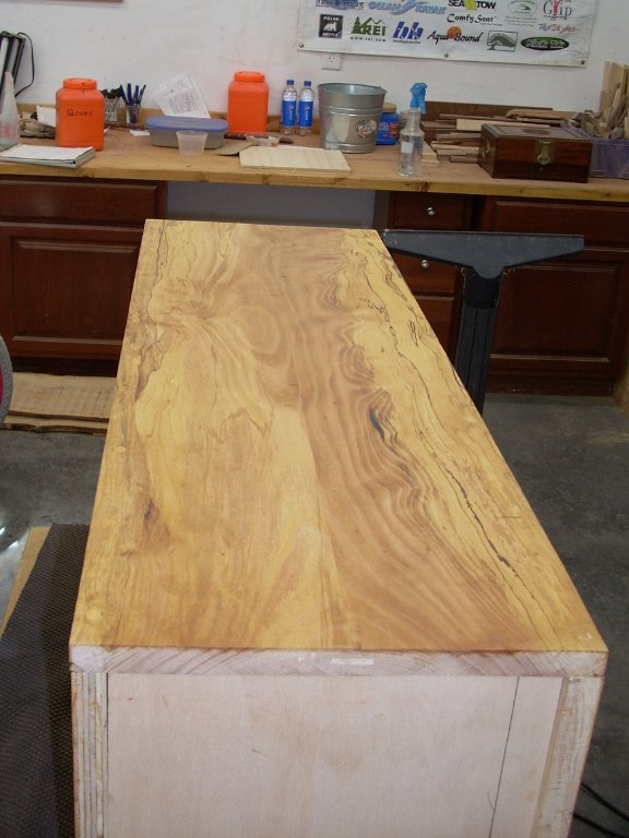

Then I sharpened the card scraper as best I could, I still don't have that down yet. I scraped the sides where there were still some rough spots. Took the bulk of the roughness out. You'd be amazed at how much sanding you save using the card scraper. Finished the job off with a palm sander, but didn't take much.
64 card scraping.jpg (138.38 KiB) Viewed 5147 times
The back and shoulder were yelling at me by then, so I took a break, layed in the floor and the westie told me how much she missed me.
After dinner, headed back out for another session. THIS one was the payoff. Put the finish on the cabinet.
65 finish applied.jpg (123.54 KiB) Viewed 5147 times
66 other side.jpg (130.15 KiB) Viewed 5147 times
If you look inside the cabinet, you can see that I used the floor of the cabinet for the bottom section brace, but the middle bin and top bin have a brace mounted at the back to insure the bin is fully supported at the back and stays level.

Out this morning to wax... and rewaxed the bins. Then waxed the cabinet and buffed them out. Set them in place and they are looking good. Set the cutting board top in place, will attach everything when the handles and all come in. Still haven't gotten a chance to decide on the base.
The wax I use is a British bees wax.
70 the wax.jpg (157.65 KiB) Viewed 5132 times
View of one side of the waxed cabinet.
71 one side.jpg (127.02 KiB) Viewed 5132 times
The cabinet and bins put together... for a test view.
72 put together.jpg (142.37 KiB) Viewed 5132 times
Angled view. The best side of the cabinet. I used this side panel on this side of the cabinet, since it will be seen most.
73 angled view.jpg (116.55 KiB) Viewed 5132 times
