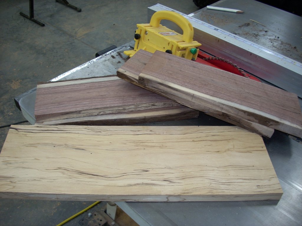

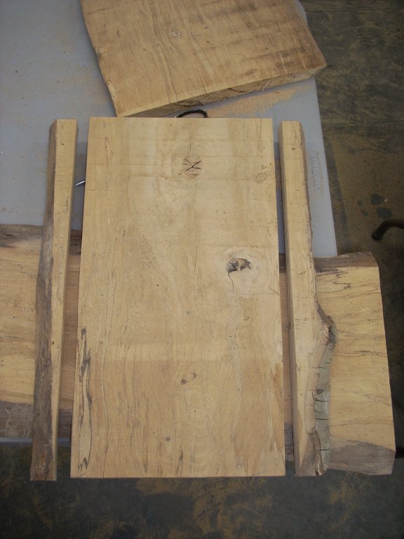

The slab was cut and then the two live edges cut off on the band saw.
Once that was done, I ran it thru the planer and got it nice and smooth. The grain on this piece is really popping.

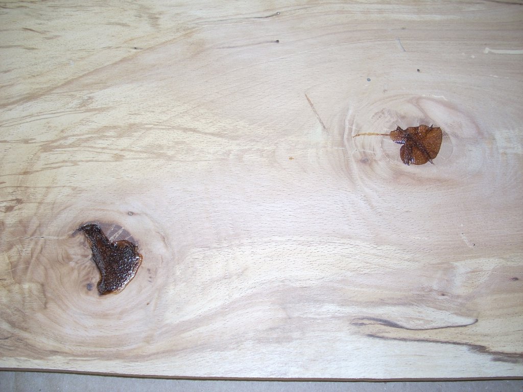

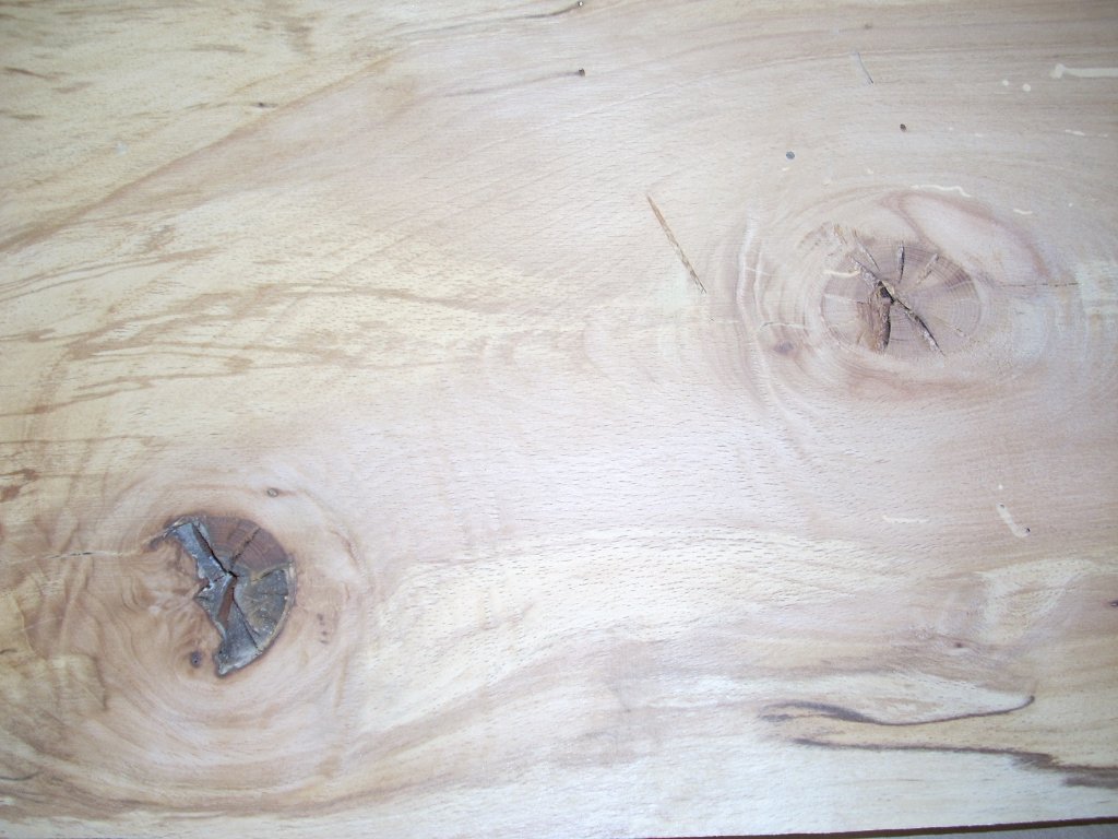

Inspecting the planed piece did reveal a couple knot holes that needed attention.

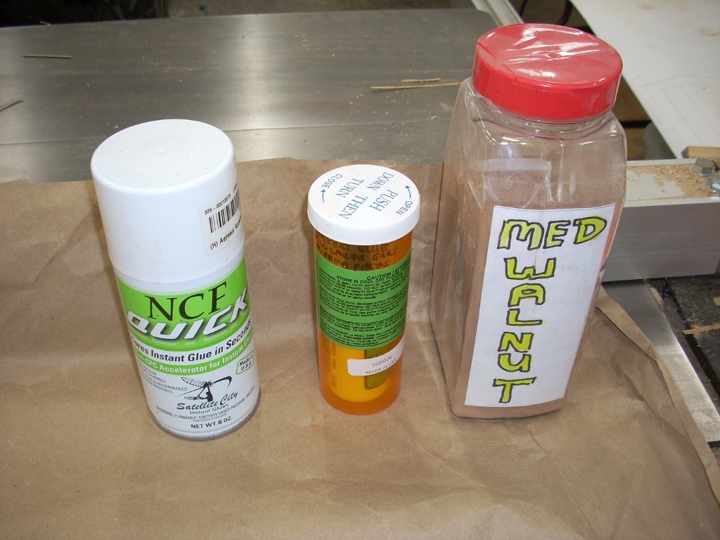

I can repair/stabilize those using a favorite technique I have used for years, using sawdust saved from previous projects, CA glue and spray activator. I also use a square of painter's tape on the back that is not shown in the pic here.
Fill the hole with some sawdust, chosen to match or accent, your choice. Then a layer of CA glue, spritz of activator. (without that, you wait several hours between steps.) Repeat the steps until you have built the hole up proud. Let the repair cure until you are sure it's solid then sand it flush. The CA glue won't stain, but it will appear as smooth as glass, and the knot won't fall out later. I usually let them cure overnight and sand smooth the next day.
For the top, I decided to go with a bit fancy. (Surprise!)

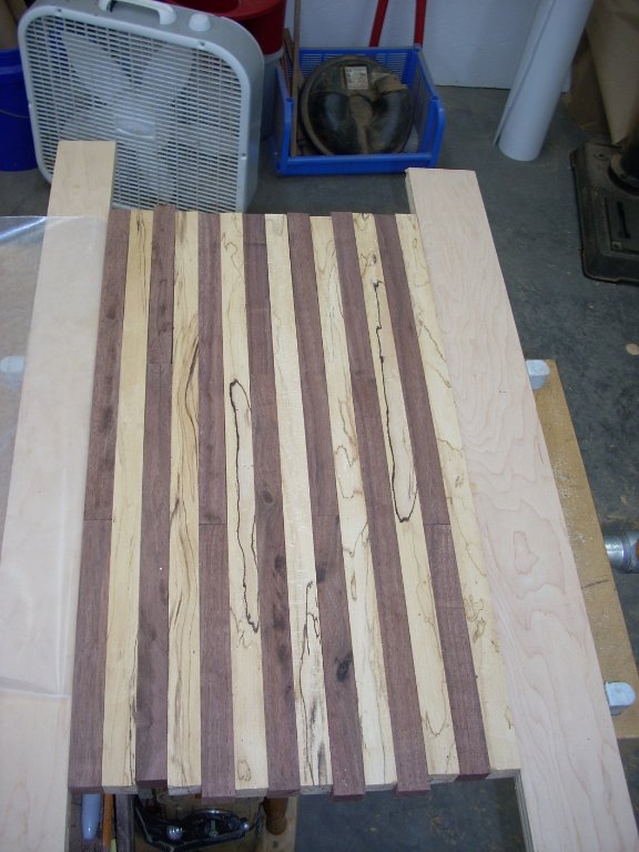

I am going to attempt a cutting board top made with Spalted Maple and Black Walnut, so I cut another slab and trimmed it, then planed that smooth, then several sections of Black Walnut from my stash. (Thanks JStraw for the help.)
Once they were all planed, I ran them across the table saw cutting them at 7/8" widths.

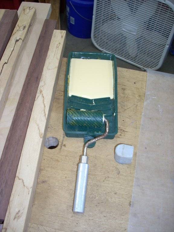

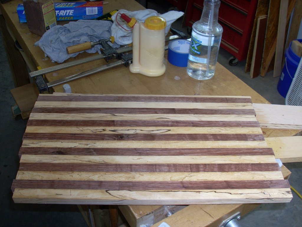

Whew! Lot's done today. I kept wanting to get out in the shop last night and get busy laying out the cutting board, if for no other reason than to see how it would look.
I resisted, as I didn't want to exceed my limit yesterday. I came out this morning after a light breakfast and got started. I laid out the cutting board kit, and started looking at the various grain patterns, and trying to decide what went where... the wood would tell me.
No, really.

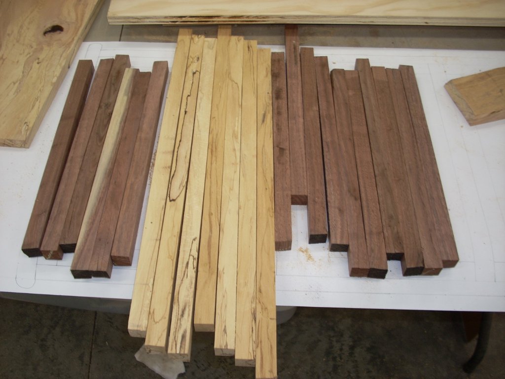

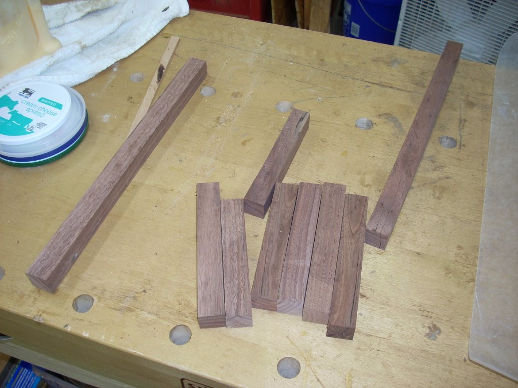

The maple was easy, it was full length, the walnut was a pain. I had to square off both ends, then for every pair, one had to be trimmed to length. The length wasn't critical, as the board coming out of the clamps later will be about 1-1/2 to 2" too long, but... it needs to be close to make clamping easier. after about an hour spent fitting and trimming, the layout was done. I had a test pattern and Miss T gave it a "Nice" of approval.
There were just a few leftovers after the pattern test. Too bad I am not a pen maker, the cutoffs are the perfect size for turning walnut pen bodies. Oh well, I'll find a use for these eventually, if not on this project, on a box project or something down the road.

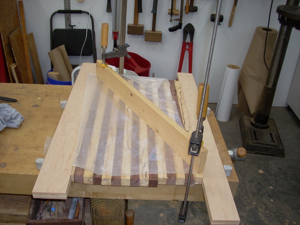

I took everything out of the bench dogs, moved it aside in ORDER, then redid the wax paper underneath. Got ready for the glue up. I set up the glue, got the water bottle and rags handy, and prepared to work...
After about an hour, the Cutting board was in the clamps and ready to rest.

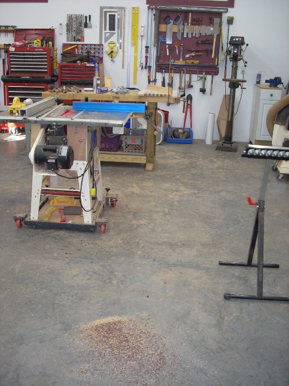

Before going in, I decided the shop needed a mid-project cleanup. I was a bit tired of all the sawdust and the tools and supplies laid out. I put away all the tools, rolled the equipment to one side and prepared to sweep.
A good half hour of attention, not detail cleaning, just put away and a decent sweep, made a big difference.

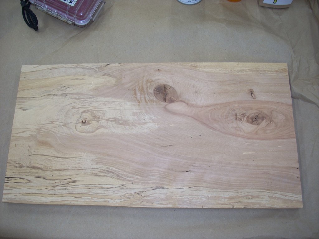

So, back out in the shop this morning, I marked the edges of the Cutting board top, then trimmed them off. Then looked at the gouge in the finished side that the last few passes on the planer had revealed. Bugs cause the spalting, that nice pattern in the wood, but they can also leave hollows.
I doubt you can see the gouge in the picture, but it's as much as a quarter inch deep, and it's an inch and a half wide. Since Tina won't be using it as a cutting board, I could leave it, but it's not my style.
I got busy fixing up some maple paste to repair the gouge. First step was to take up a piece of maple cutoff. (Always save your cuttoffs.) Then sand away the cutoff on a piece of sandpaper glued to a luane panel just for flattening box bottoms. Sand, brush the dust up, sand brush the dust up.
Drop in a couple drops of the watco oil I'll use to stain the cutting board, since it won't be used, and is just for looks. Mix, then add glue and mix until you have custom wood putty. Then fill the gap and let dry.
While that dries, I route the edges of the cutting board. Then I mark and cut the panel I had planed yesterday to make the stock for the base. I cut three boards 2-1/2 inches tall and leave them full length. I route the top edges. When I form the square I'll cut the 45 degree joints. BUT, they will have awesome grain.
I went in and had lunch and let the repair dry hard. Then came back out and sanded the top panel again, and resanded the edges to remove all routing marks. Then... this is the part I love, I applied the first coat of Watco Oil. This is a mixture of Natural and Medium Walnut to make the grain pop. It's popping.
I'll let it dry, lightly sand it then apply another coat, then sand again, a third coat, then wax it. The top is done. I can begin assembly on the case once I get the dowel kit from Woodcraft on Tuesday Evening during my Plane Tuning class. I am chomping at the bit.
