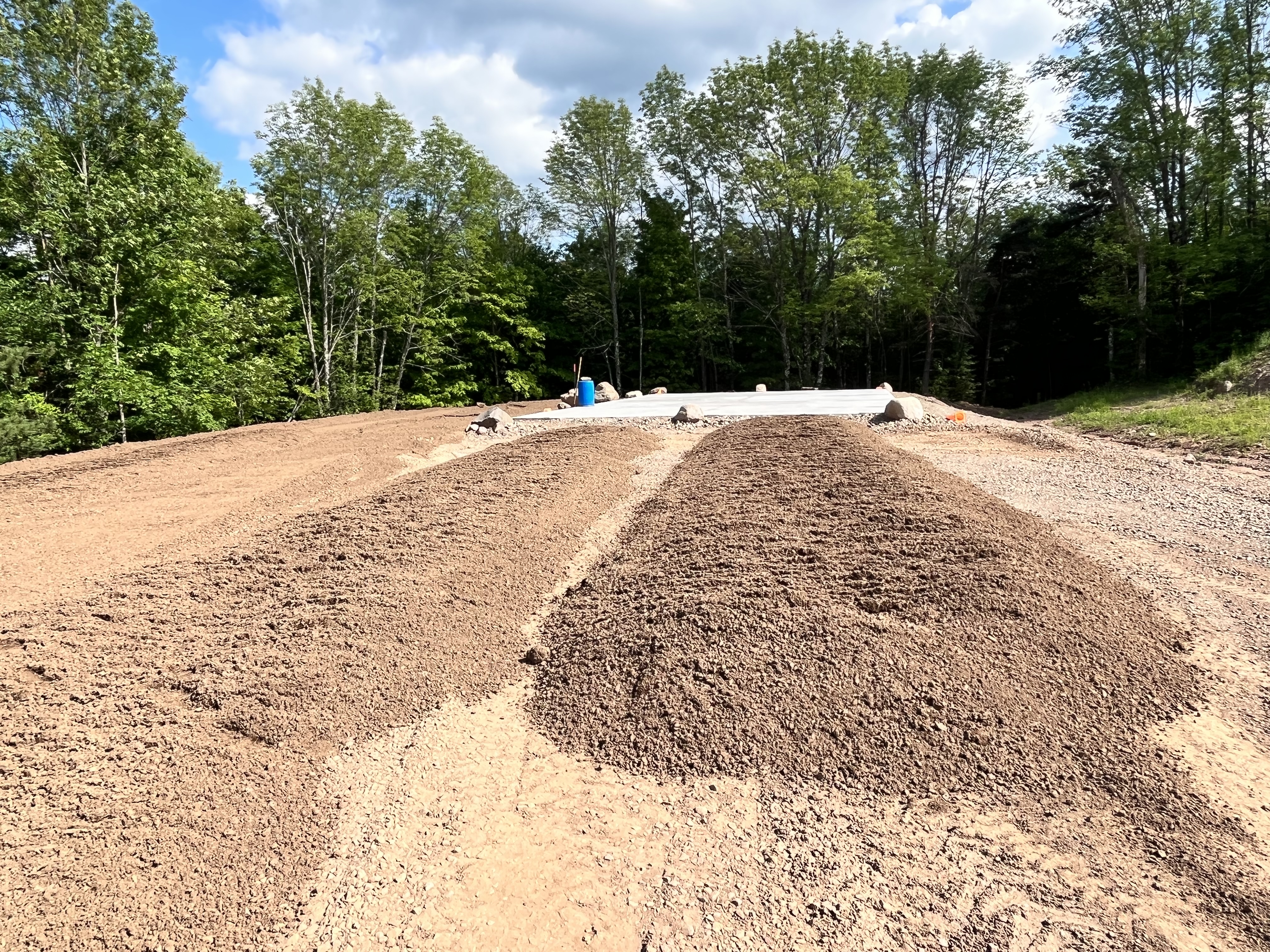

I didn’t get the road building gravel delivered Tuesday like I had planned. It came today and I’ve only had time to give it a rough level. I need to finish it before Monday because that is when the building gets put up.
The last two loads I haven’t even touched.
Since these will be the last of the loads except for maybe two loads of 1” clean I had a final load dumped at the bottom of the driveway.

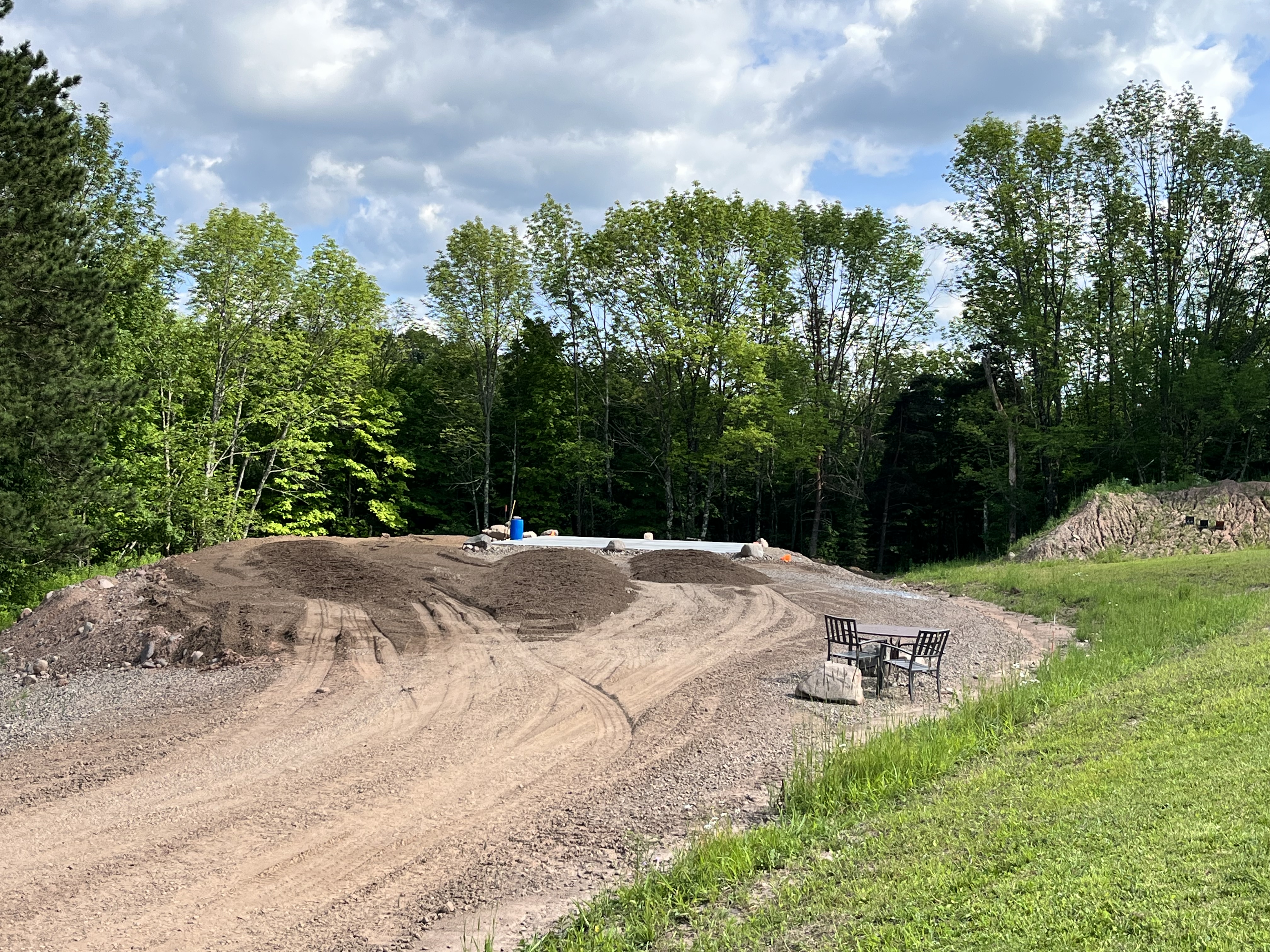

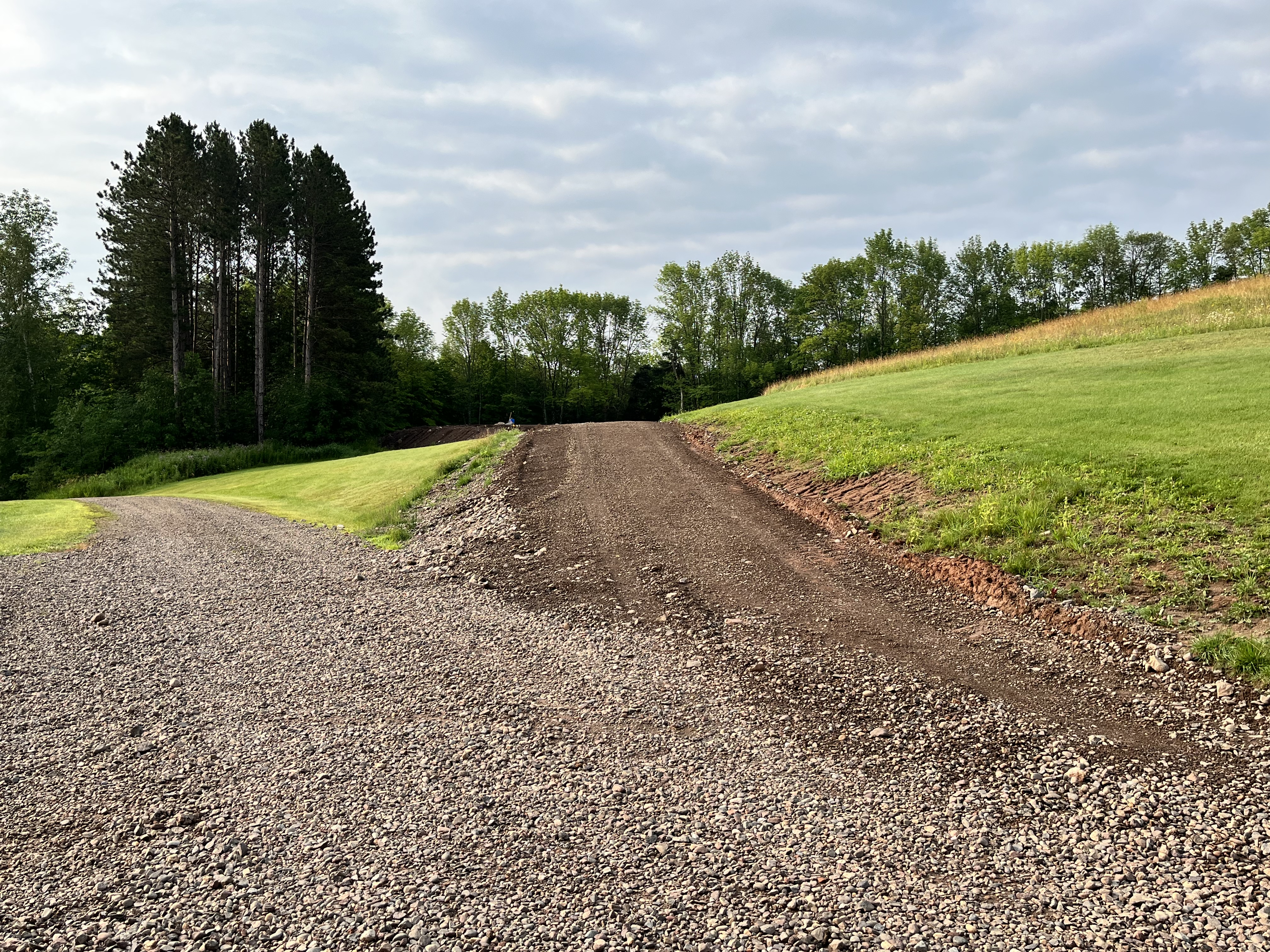

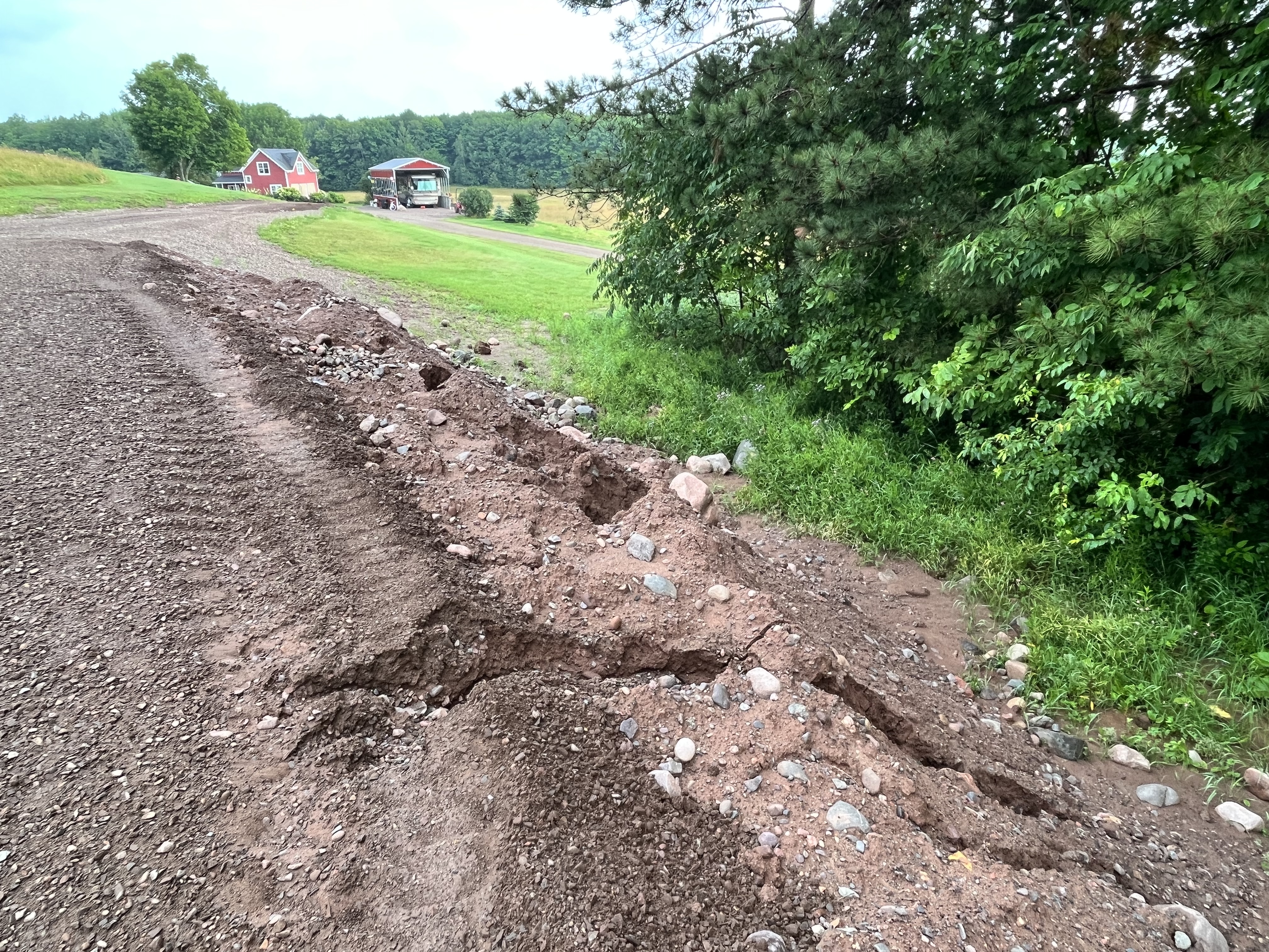

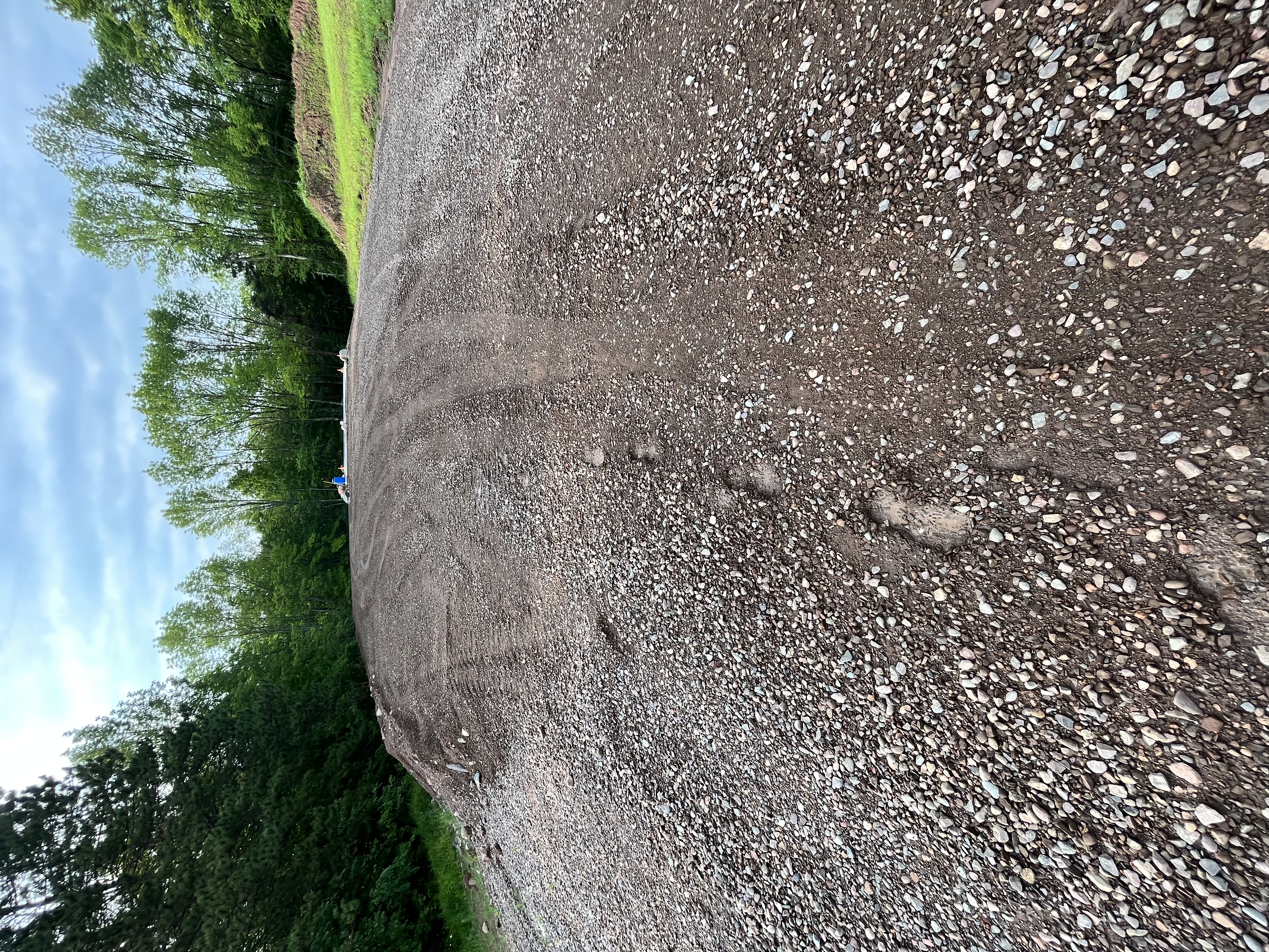

The latest ten loads are spread and I received over an inch of rain last night.
The side erodes at each rain. I have 30 feet of buffer so there is no danger of the building siding. Eventually the fill will become compacted and vegetation will keep it in place. Plus further back where the building is there is only a three foot drop. Here in front it’s a ten foot drop.

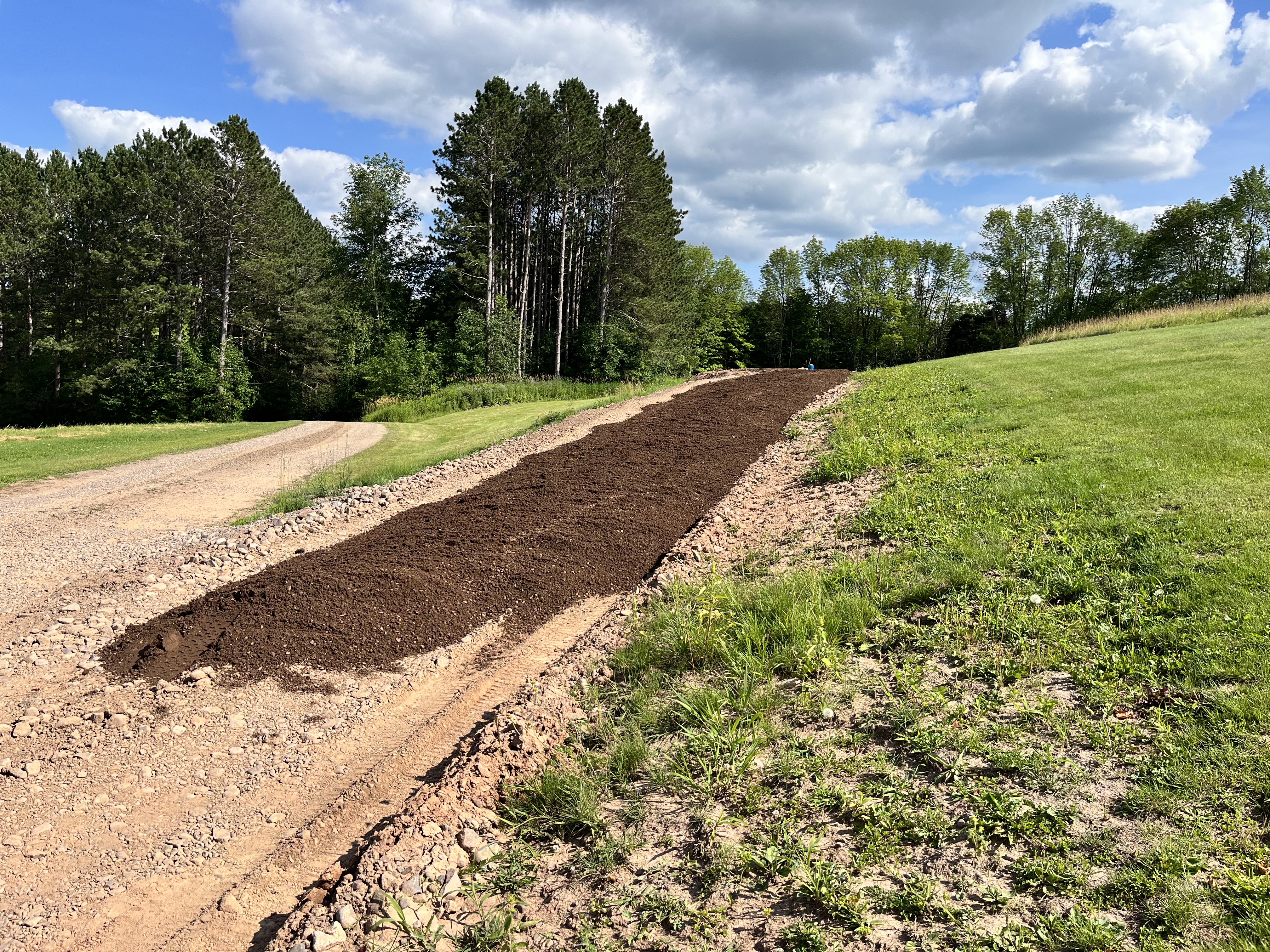

The road cutoff from the driveway also received an extra load of road gravel. Once compacted it turns to concrete.
The building will be erected in about 24 hours. I suspect it will take them two days.

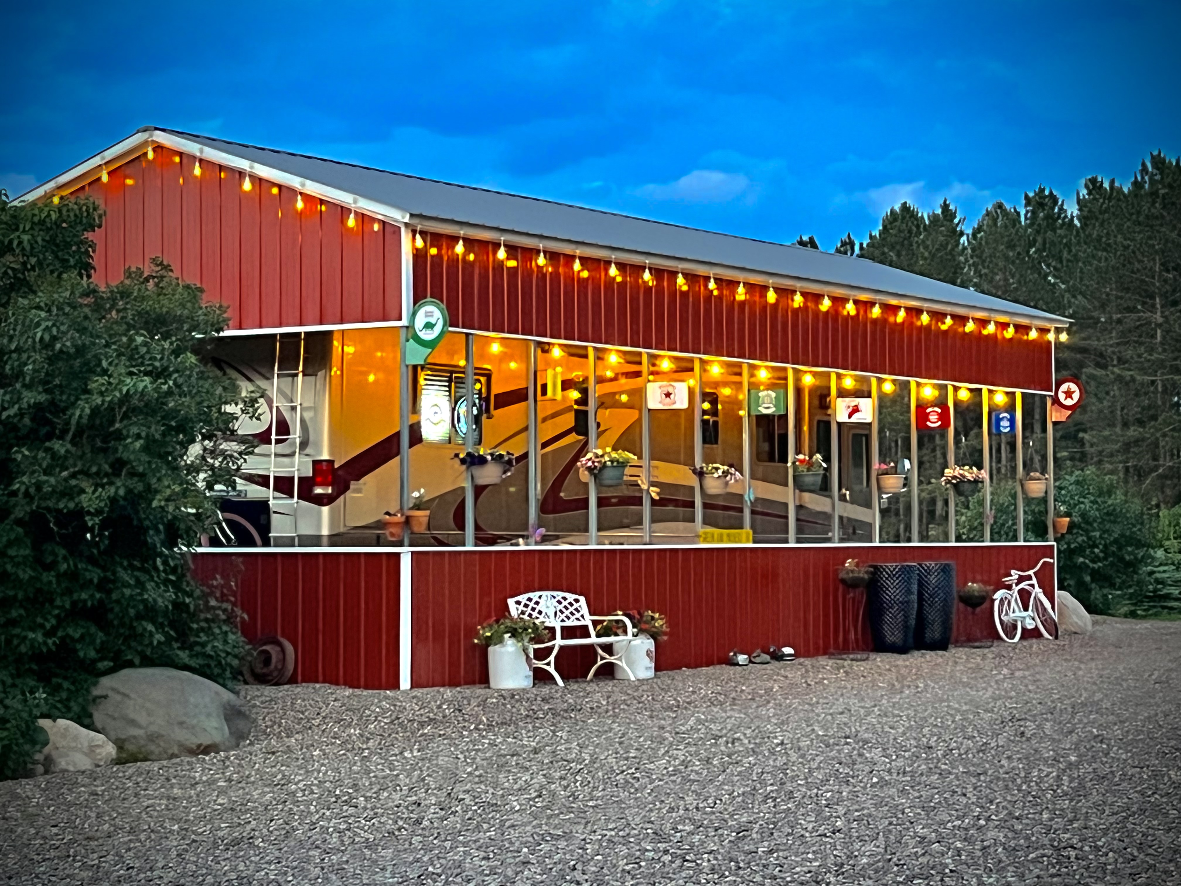

Depends on the crew, not a large building but 3 guys delivered my 18'x24' carport with sides to the ground and they had it completed in less than 2 hours. Was like watching a choreographed dance, each guy knew exactly what to do, no wasted movements or standing around. They told me they were going to deliver and install 2 more carports that day, probably could have done more but were limited to how many they could fit on their trailer.
I enclosed the rear and front later.

It took 40 man hours for them to put up this building last fall. It’s 18x45’ and the new garage will be 30x50’ and will have two 10x10 garage doors, two man doors and a dozen 30x30” windows. I can’t imagine them finishing it in one day unless they work 12 hour days.

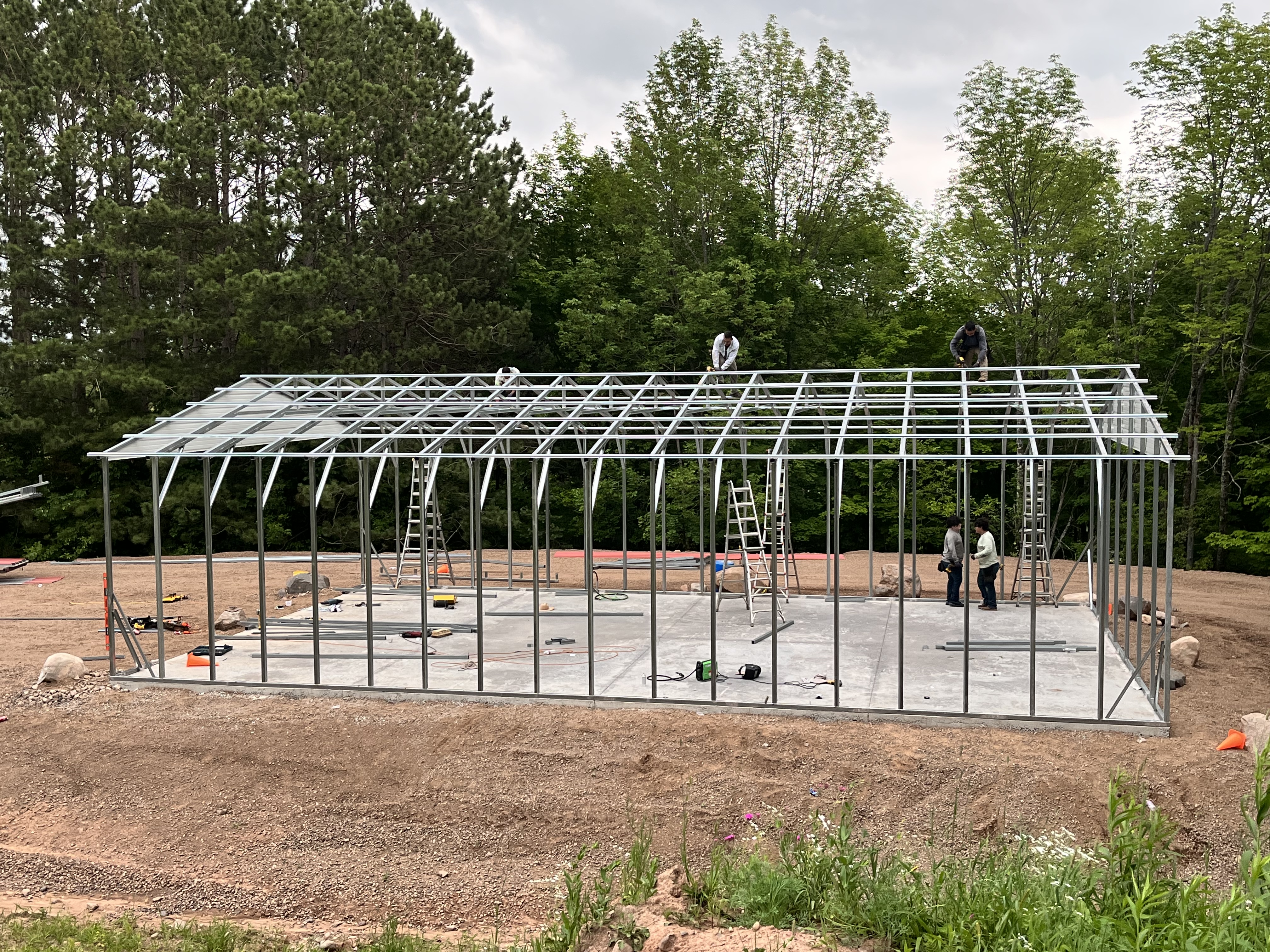

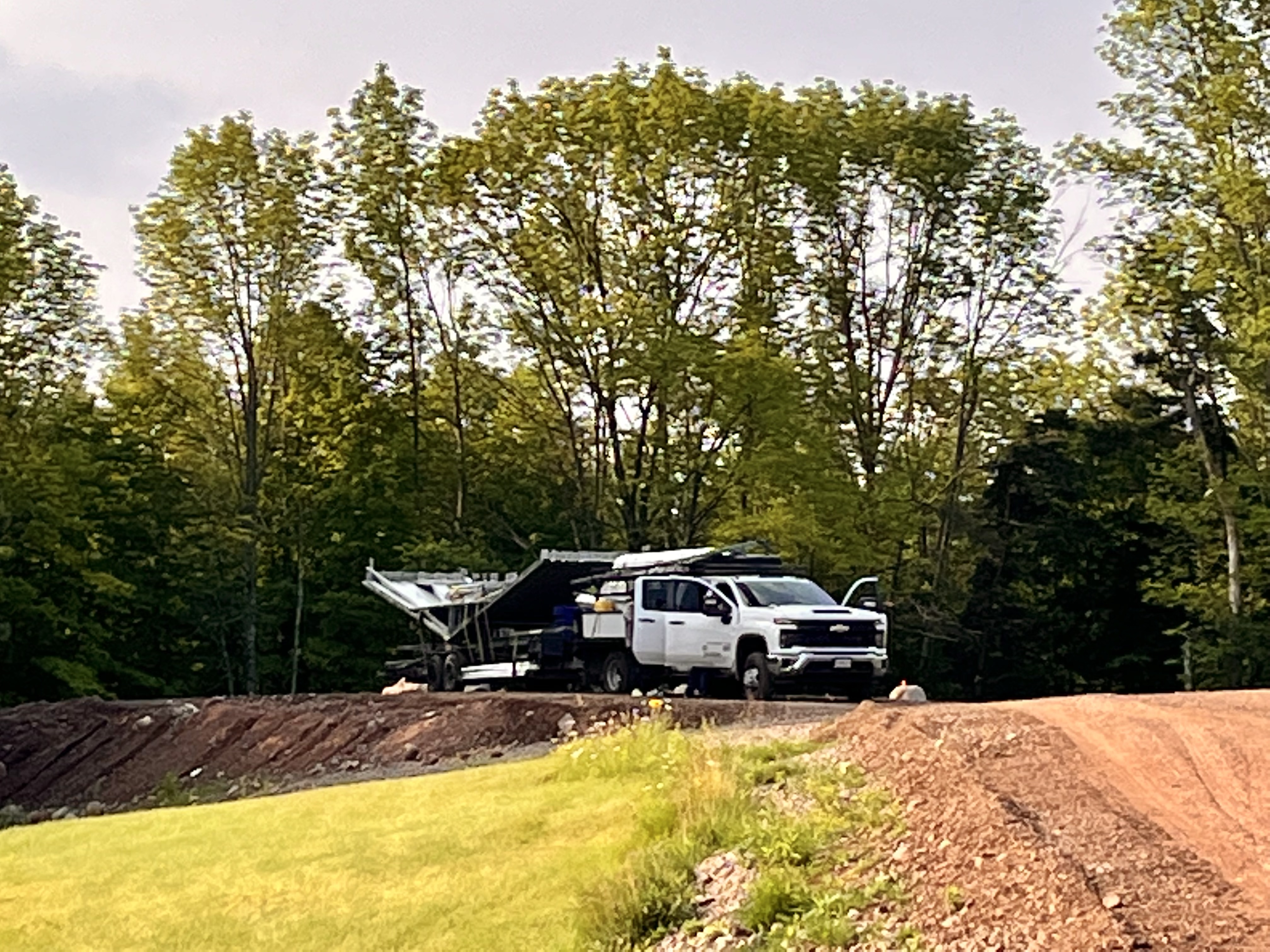

The show has begun.
Posts: 14608
Re: Garage and road project
Post by Sir Henry » Mon Jul 22, 2024 7:03 pm

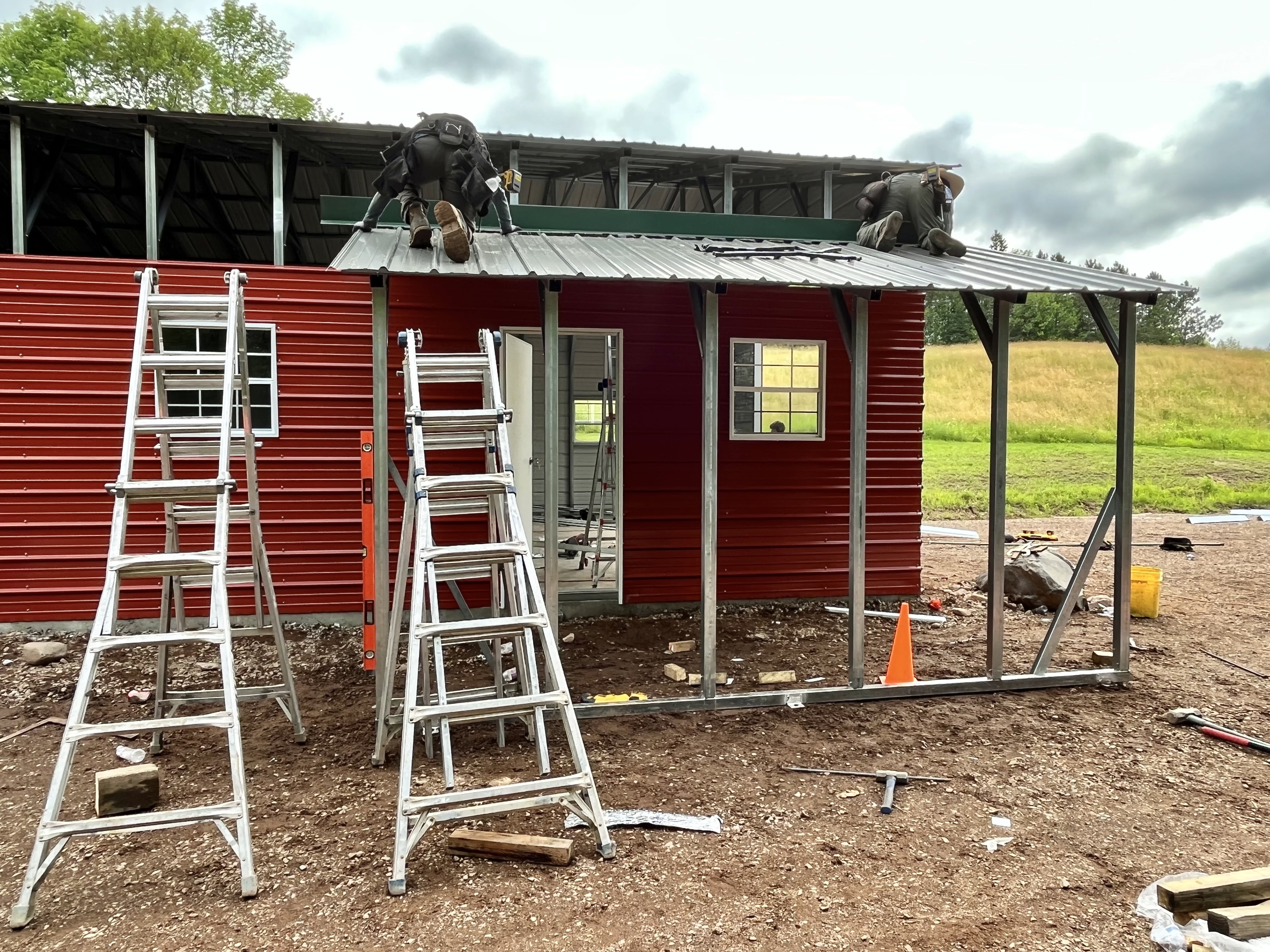

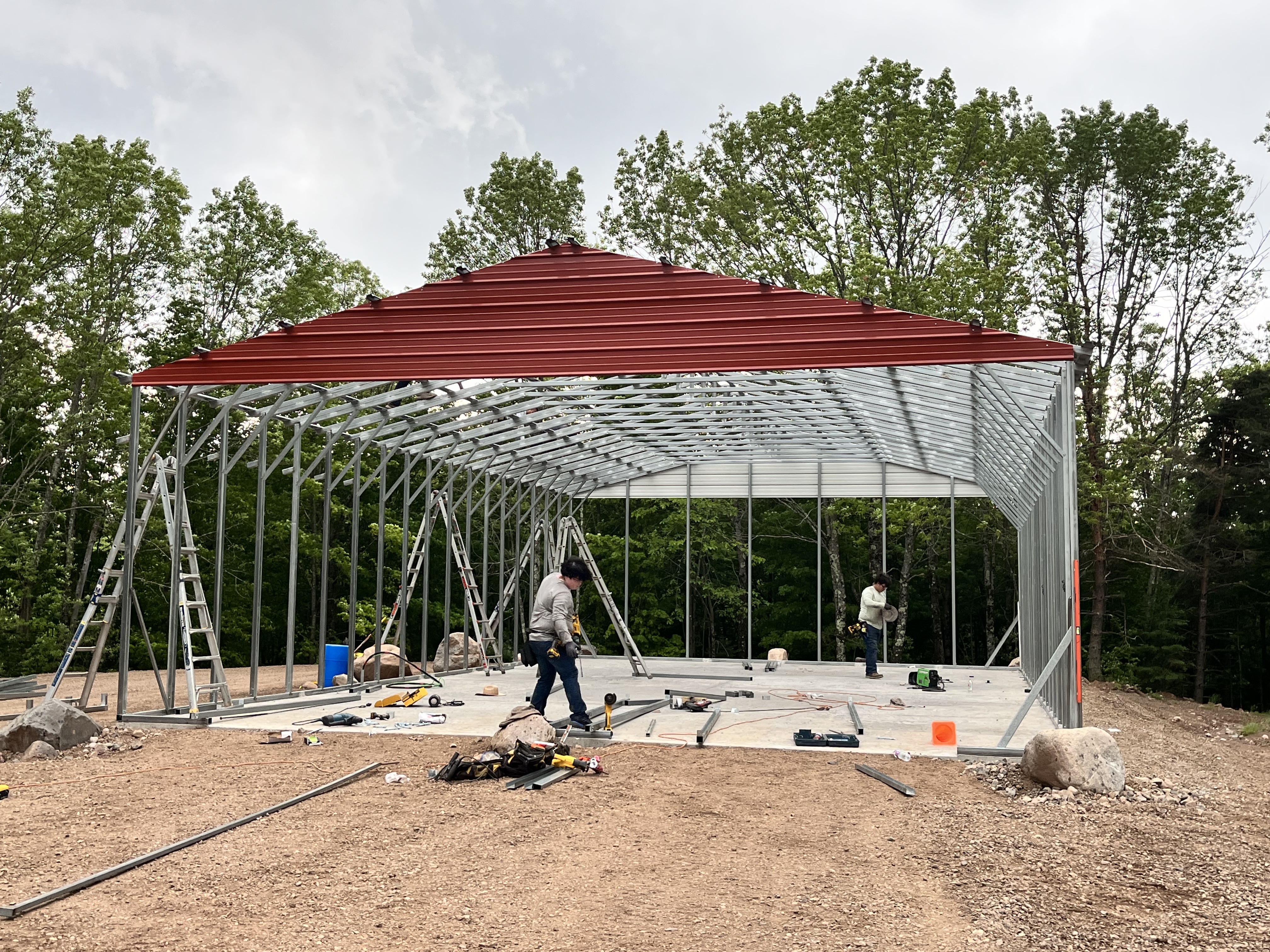

They didn’t get very much done today although they are still here and working at 6 pm. They took a two hour lunch not realizing there wasn’t a close place to buy a taco. Then it started to rain and they sat in the truck for an hour. At least they have most of the frame up.

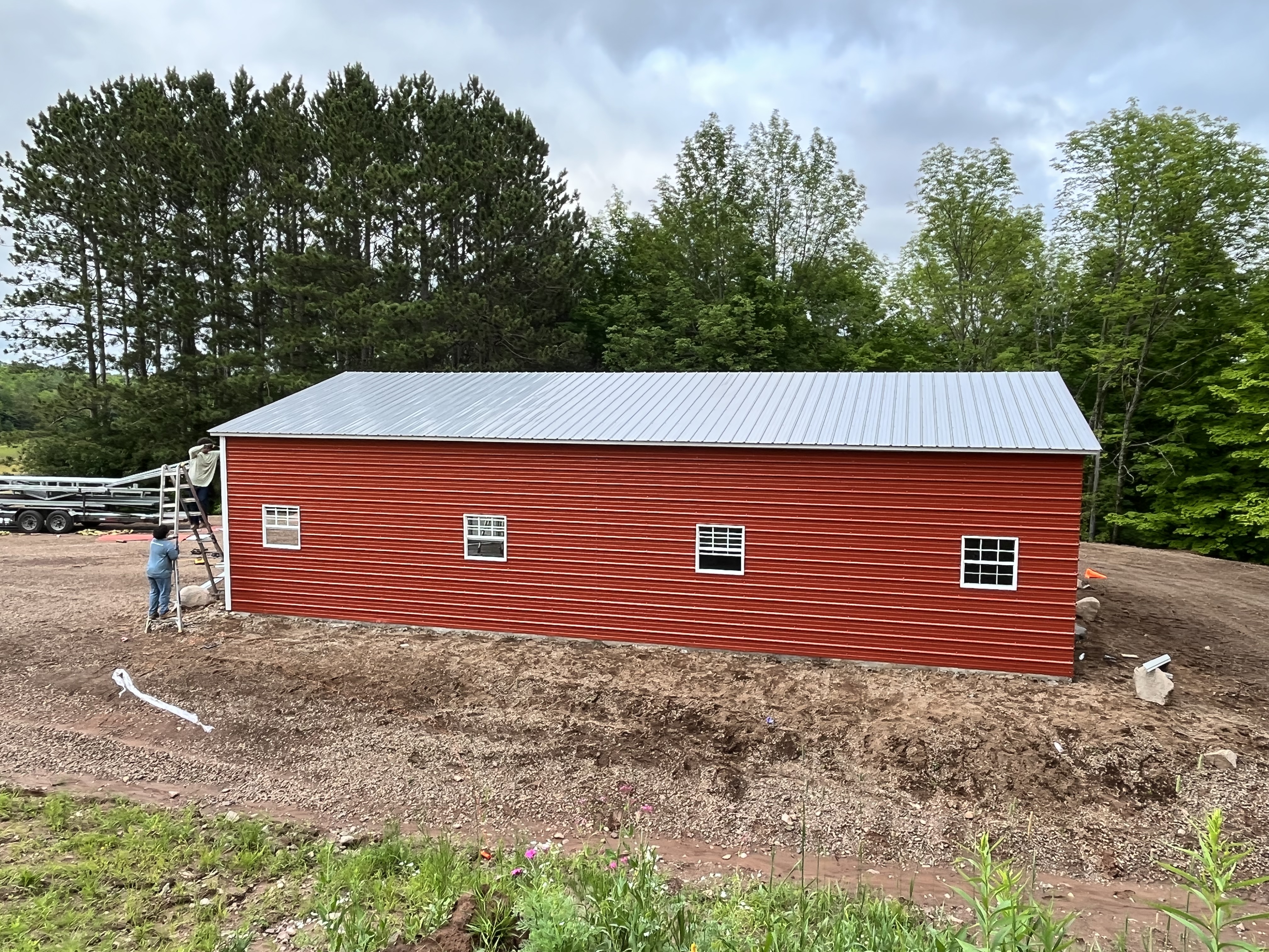

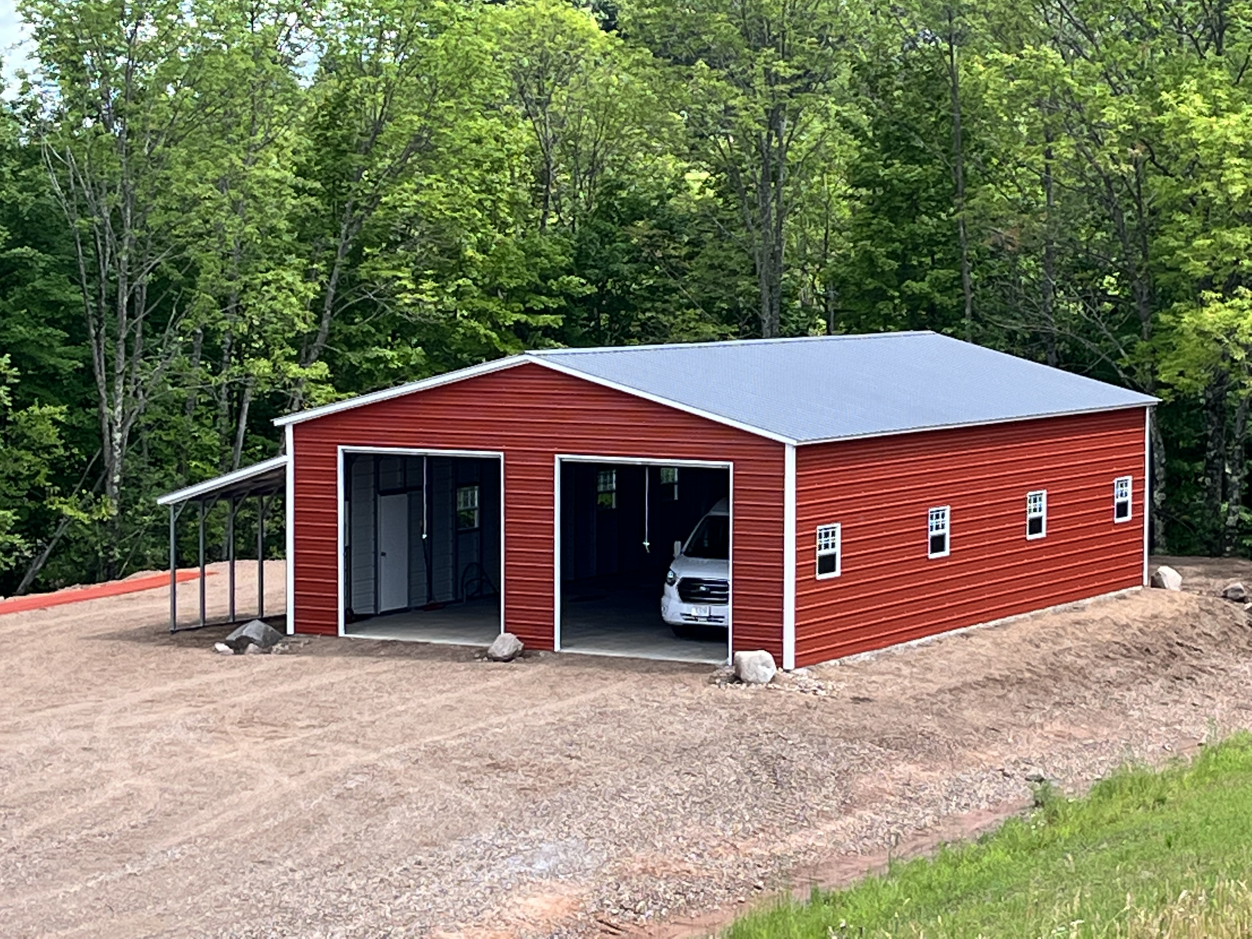

Post by Sir Henry » Tue Jul 23, 2024 6:08 pm

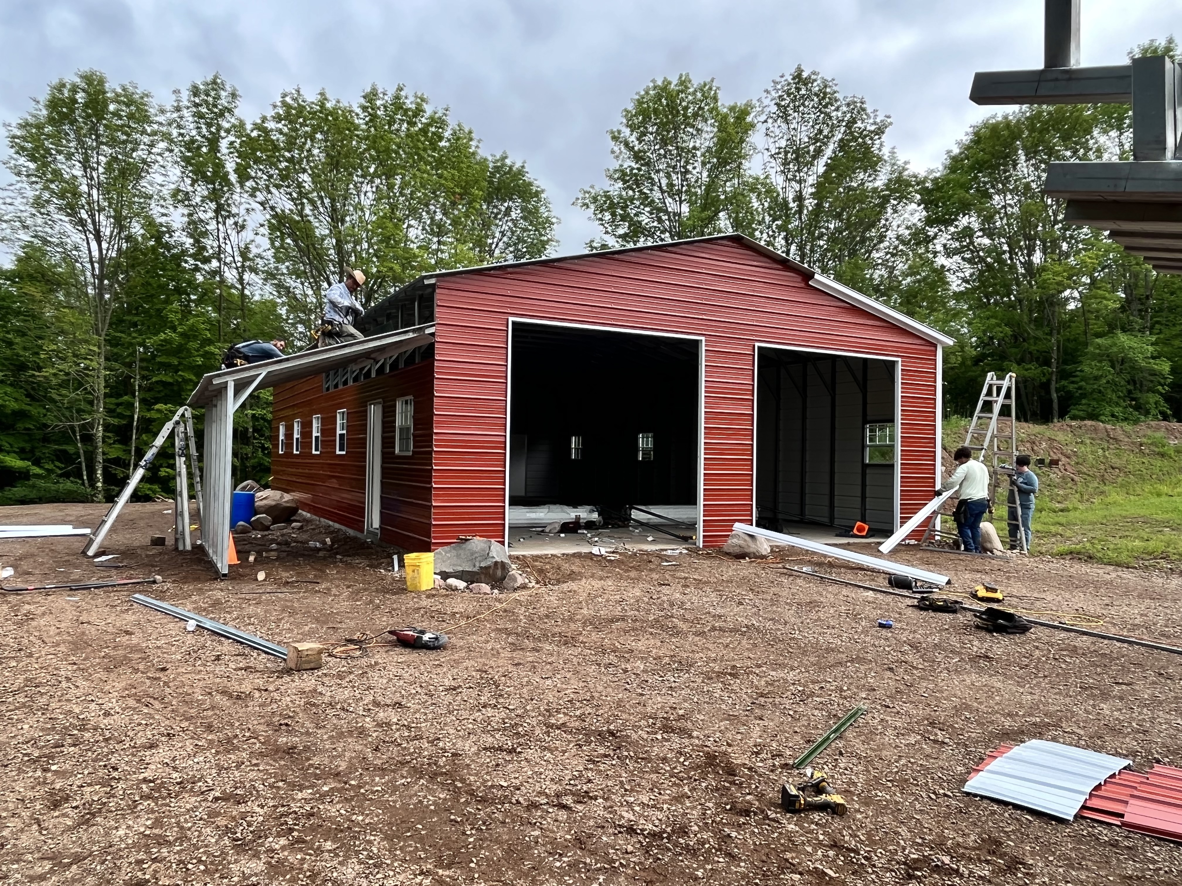

It’s 90% up! They should have it completed in about two hours.
The pad was wet from yesterday’s rain and will take a few days to dry out. And they tracked a lot of dirt inside plus there will be some small bits and pieces laying around.

Post by Ernie » Tue Jul 23, 2024 8:04 pm
Looks very nice. How long do you think it will take you to fill it up?

Post by markiver54 » Tue Jul 23, 2024 8:38 pm
Looks great Gene. Congrats!

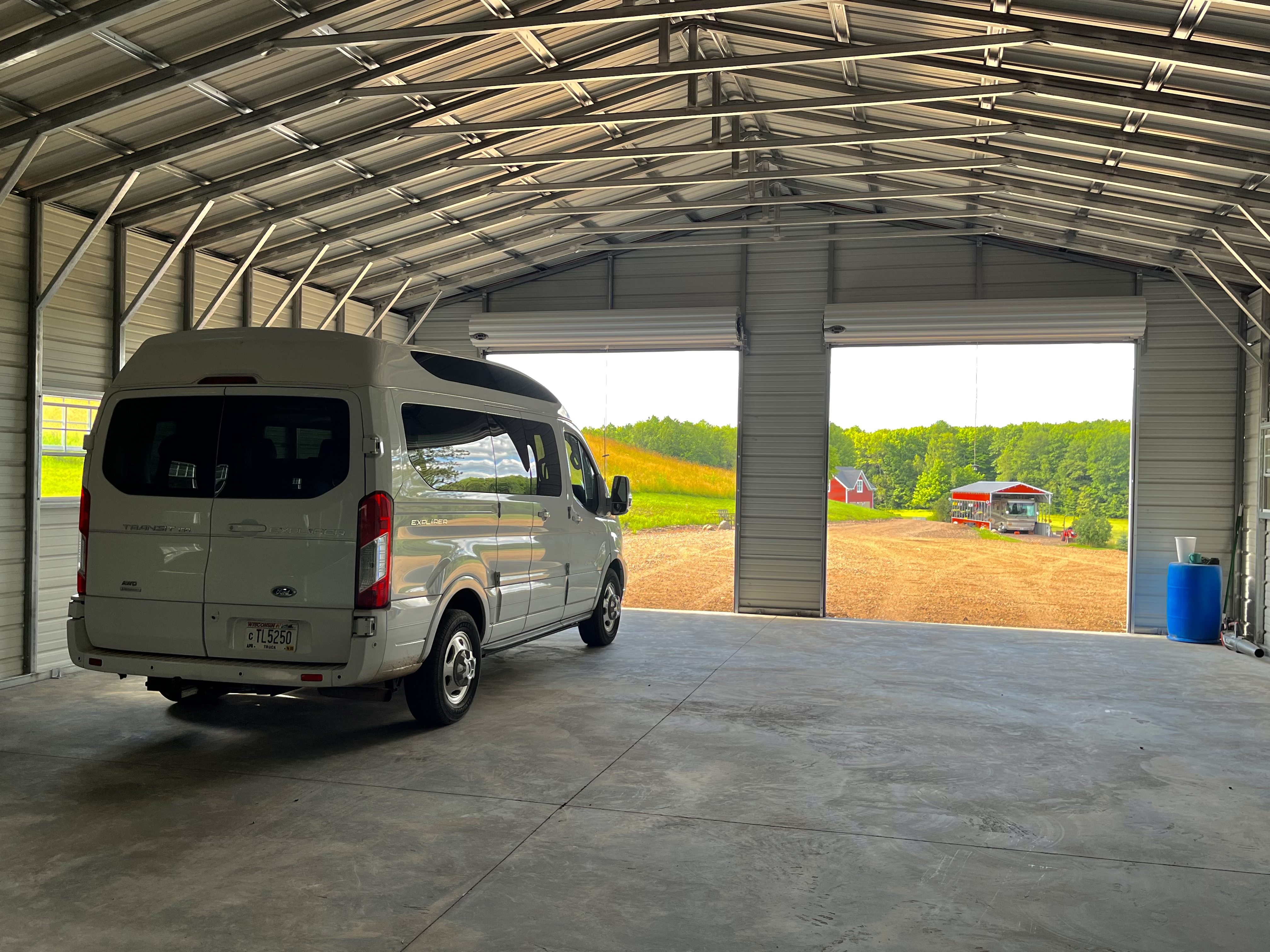

Post by Sir Henry » Tue Jul 23, 2024 10:01 pm

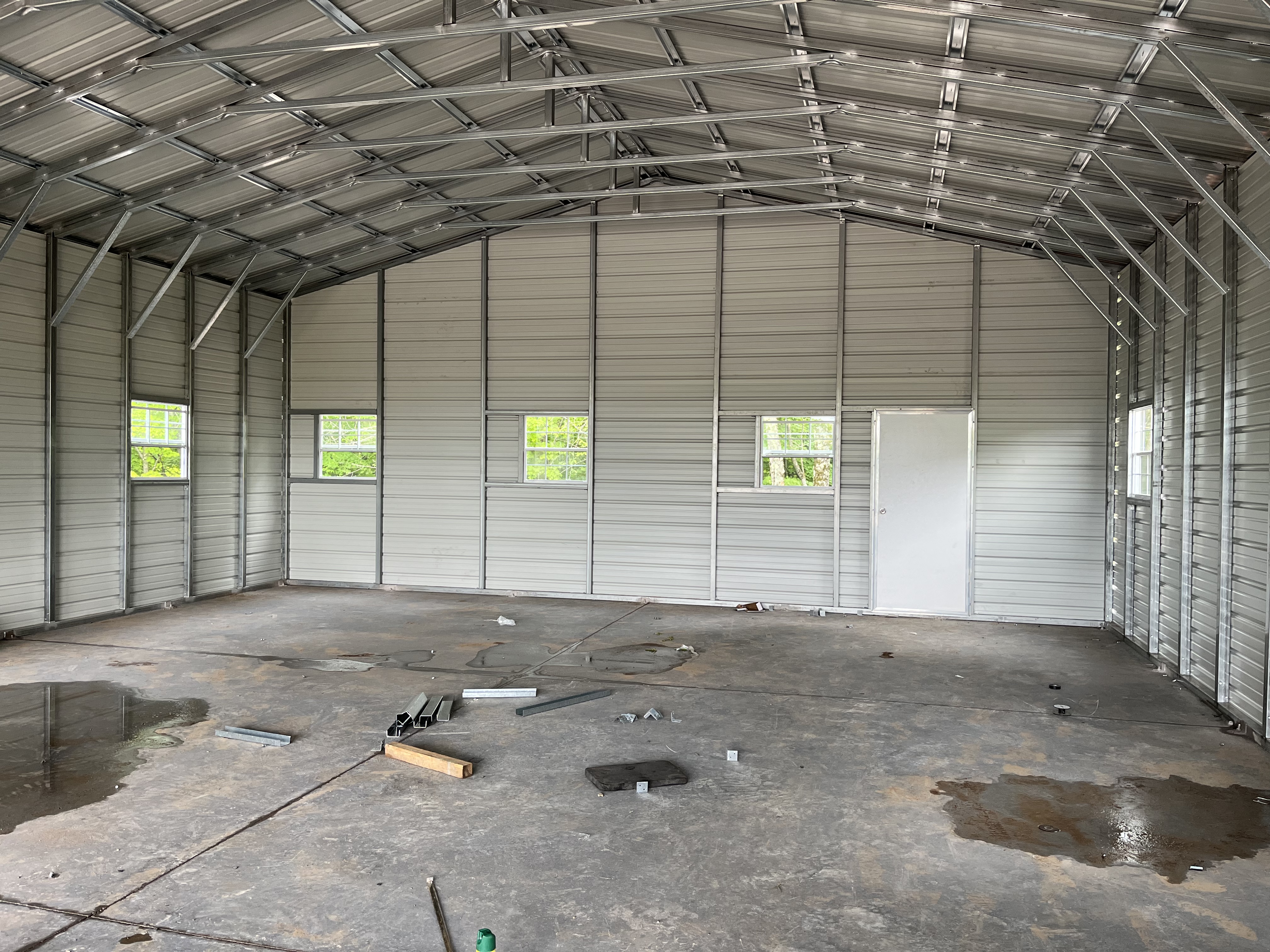

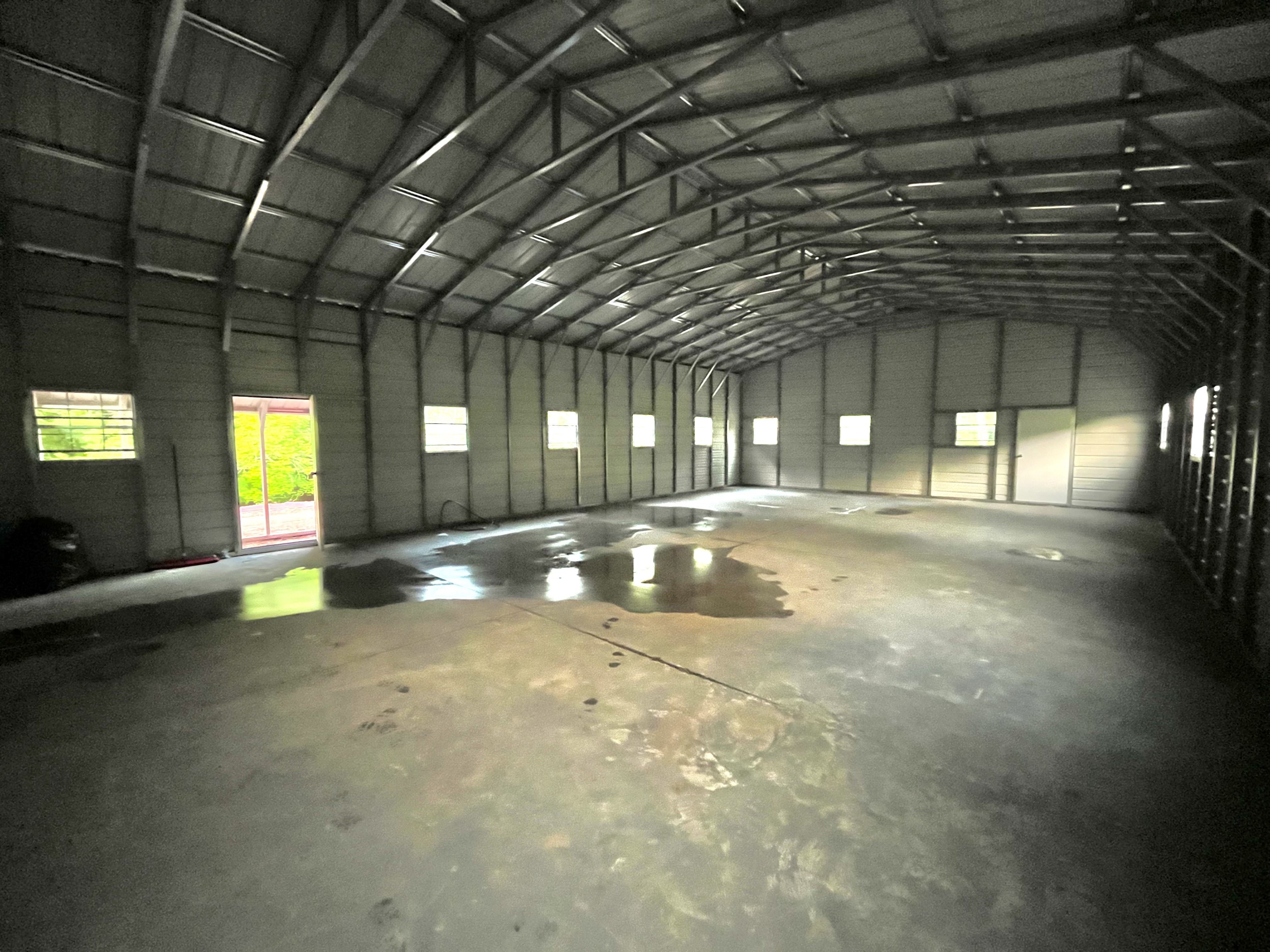

I suspect I’ll never fill it. I could fit eight vans inside and still be able to walk between them.
The ground around it was wet and they really tracked up the floor building it. Plus the floor itself was wet. I’ll open the doors and windows when it’s not threatening to rain again.

Post by BigAl52 » Tue Jul 23, 2024 10:09 pm

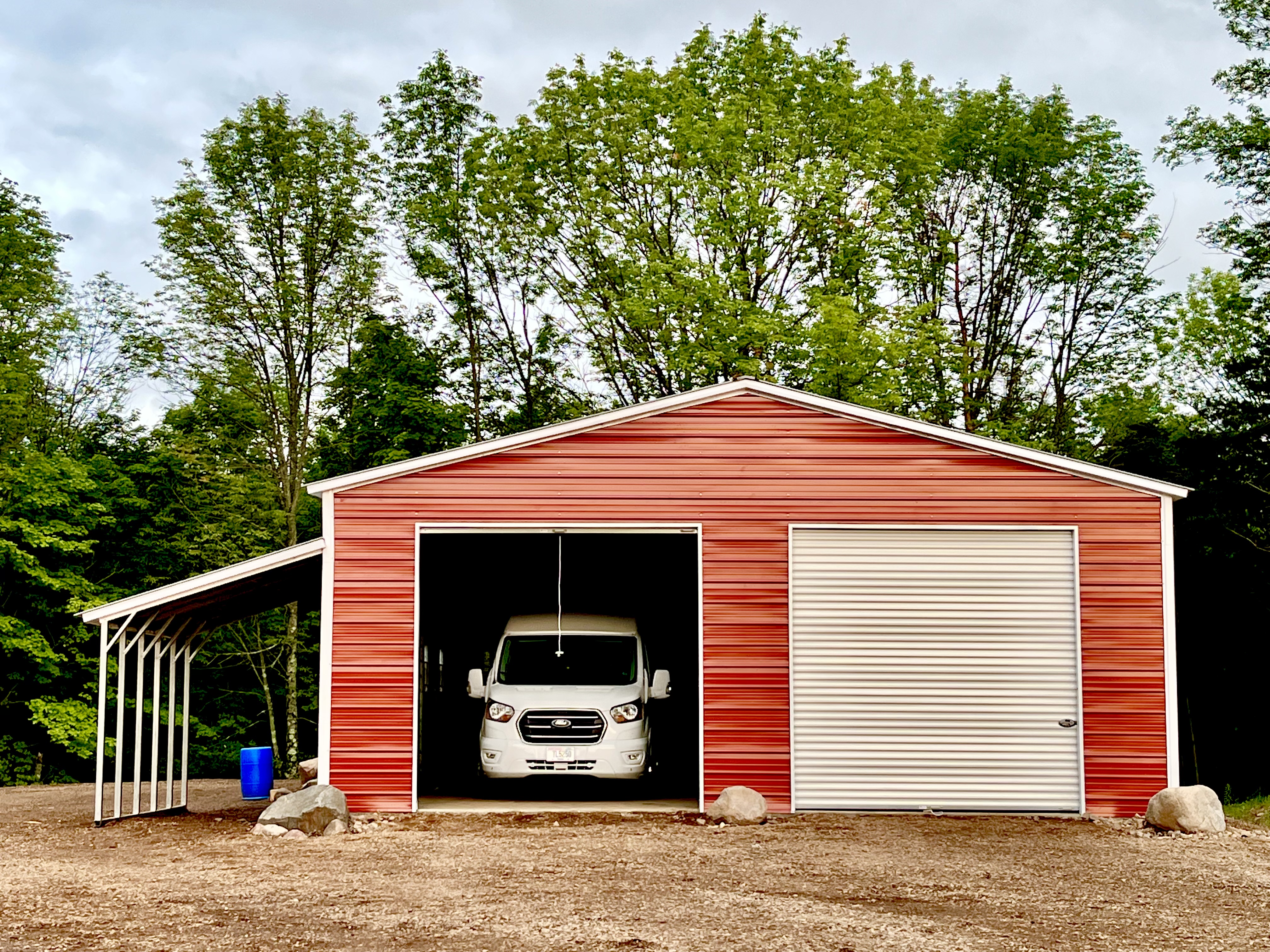

I see a big smile on the face of that van.

Post by Sir Henry » Tue Jul 23, 2024 10:33 pm
I broke ground just over eight months ago so I’m smiling too.

Post by dave77 » Tue Jul 23, 2024 11:44 pm
Looking good. I said you might be surprised at how fast a experienced crew could put it up.
Are you going to finish and insulate the inside walls. I did mine more for the Summer heat than the cold in the Winter. It's small enough that I can take the chill off with a couple of space heaters if I need to. On a very hot Summer day (which we seem to be getting more of, looks like were going to have a solid month or more of high 90's and 100's) before insulation by afternoon it was like walking into a oven, still hot but with the insulation not nearly so bad.
I used a roll insulation that was reasonably inexpensive, been a while but I remember it not being more than a couple hundred dollars. It's pretty thin but since it sits above the tube framing there's a 2" space empty air between it and the wall. I put some OSB over the lower section to protect it.

Post by Hatchdog » Wed Jul 24, 2024 9:55 am
Amazing how quickly your building went up. I’ve never done a steel building before only post frame construction. Other than the trusses post frame are built on site and time consuming. I’m really liking the steel building process and if I ever put up another building (unlikely I hope) I’ll look into it.
Awesome utility trailer. Aluminum trailers look so awesome and stay that way.

Post by Sir Henry » Wed Jul 24, 2024 6:44 pm

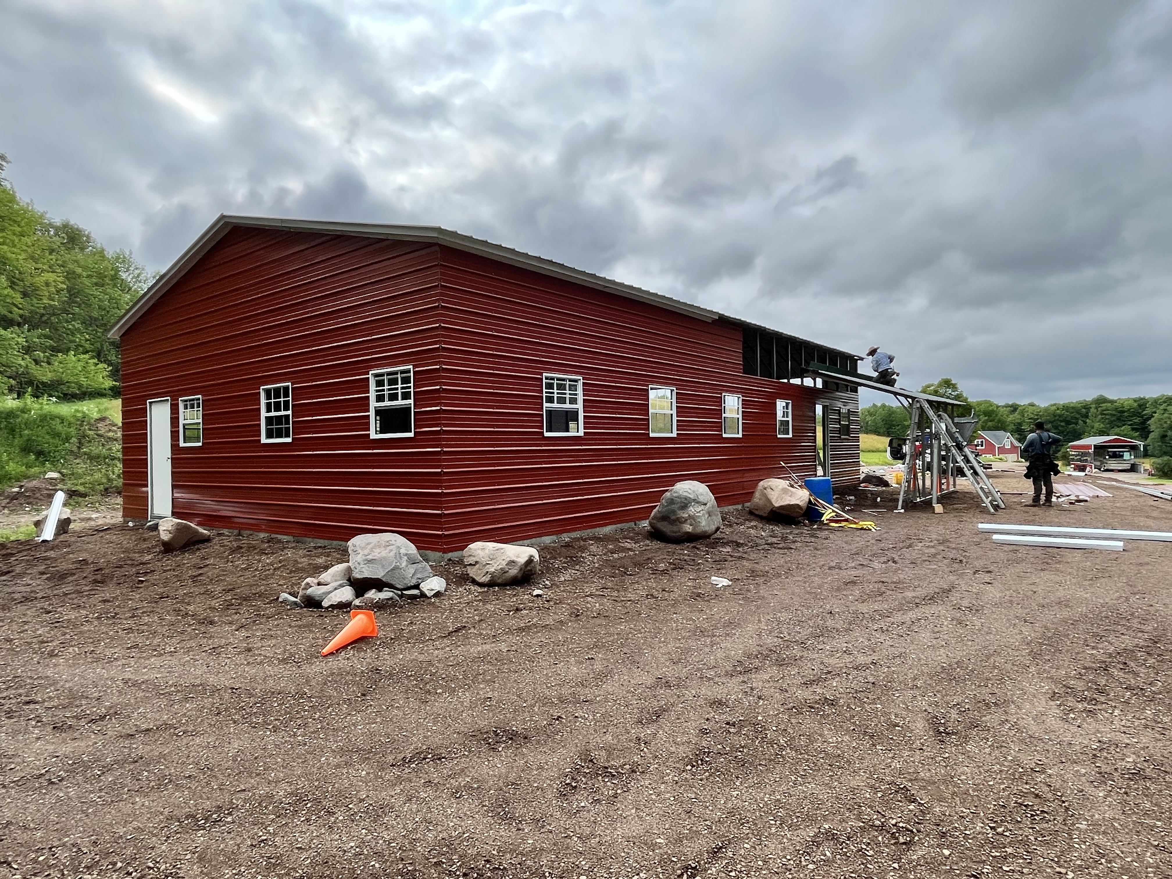

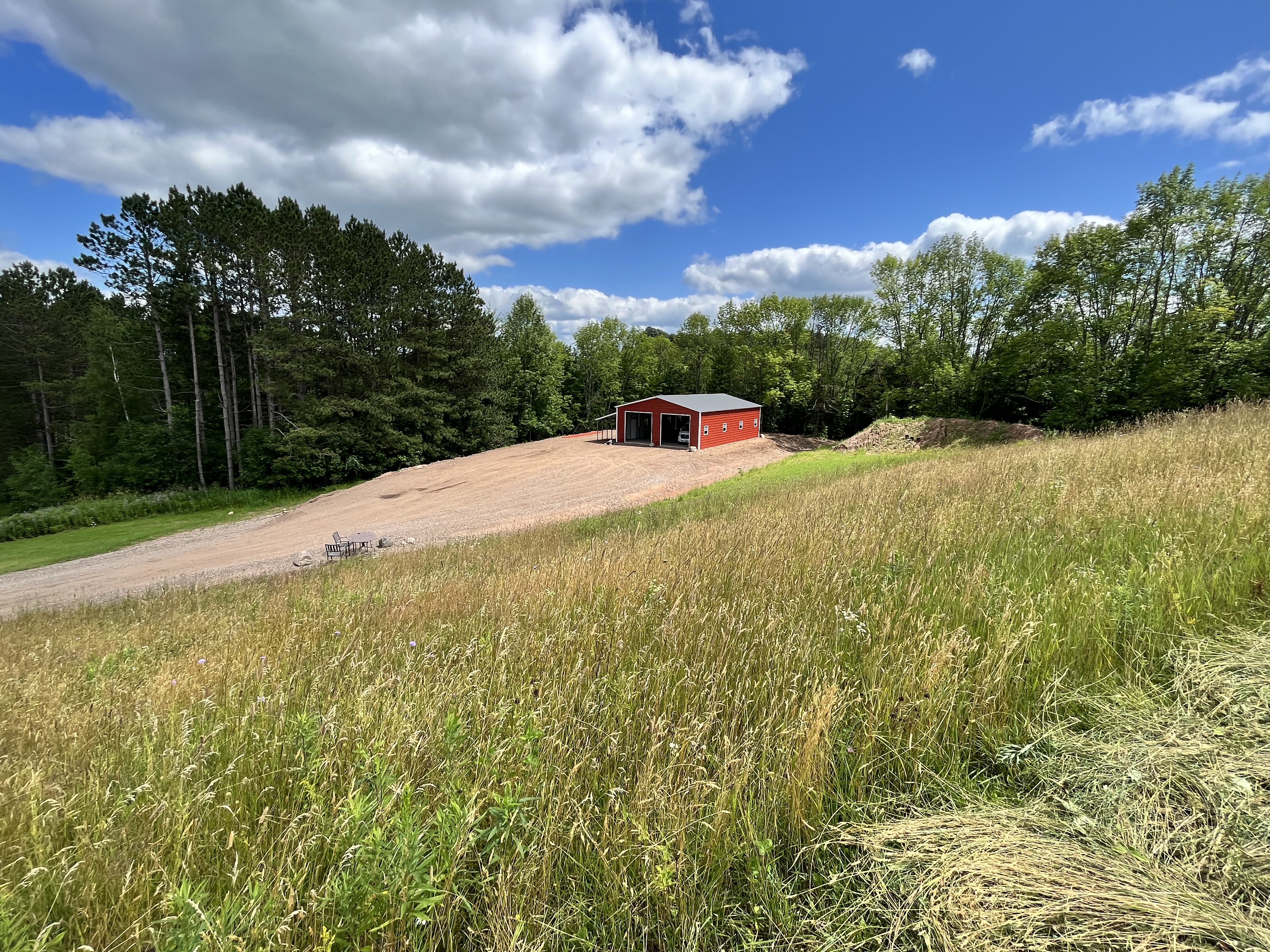

I can’t believe the building is finally up. The electrician is coming next week. The field was hayed today. The garage is at the levelest spot where the tractors would turn around. Now the hayfield ends on a steep slope and they can’t traverse it. The acre of hay given up for the garage is now two acres.

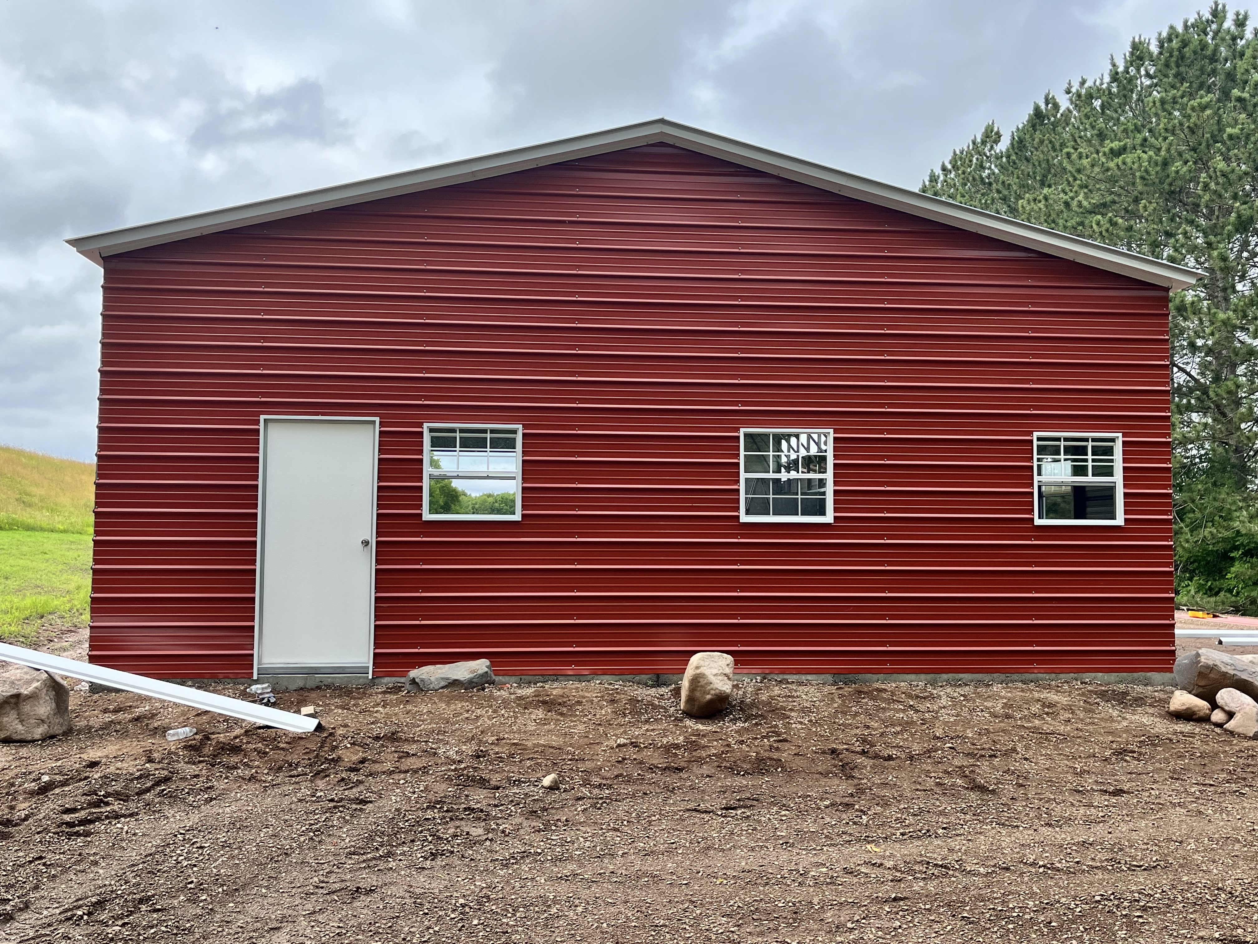

Post by Hatchdog » Thu Jul 25, 2024 9:02 am
Sure do like all those windows, so bright inside.

Post by Sir Henry » Thu Jul 25, 2024 11:00 pm
PJM wrote:
Thu Jul 25, 2024 5:49 am
I am curious what the roof load is on this design. Looks sturdy enough.
The roof load is 60 psf with 90 mph wind. The trusses are 33” center to center. It’s made from American Steel. You see a lot of these in the area especially if they are unfinished on the inside. Finished buildings are usually stick-built. A neighbor has one that was built in 1977 and it’s still structurally sound. He has repainted it once and said he will be repainting it in another year or two.

Post by Sir Henry » Thu Jul 25, 2024 11:02 pm
It came with two windows but I increased it to twelve.

Post by Mags » Fri Jul 26, 2024 12:48 pm
I don't think you'll have to paint the metal siding ever. Most siding now has a 40-50 year film integrity warranty and at least a 30-year prorated chalk and fade warranty.
