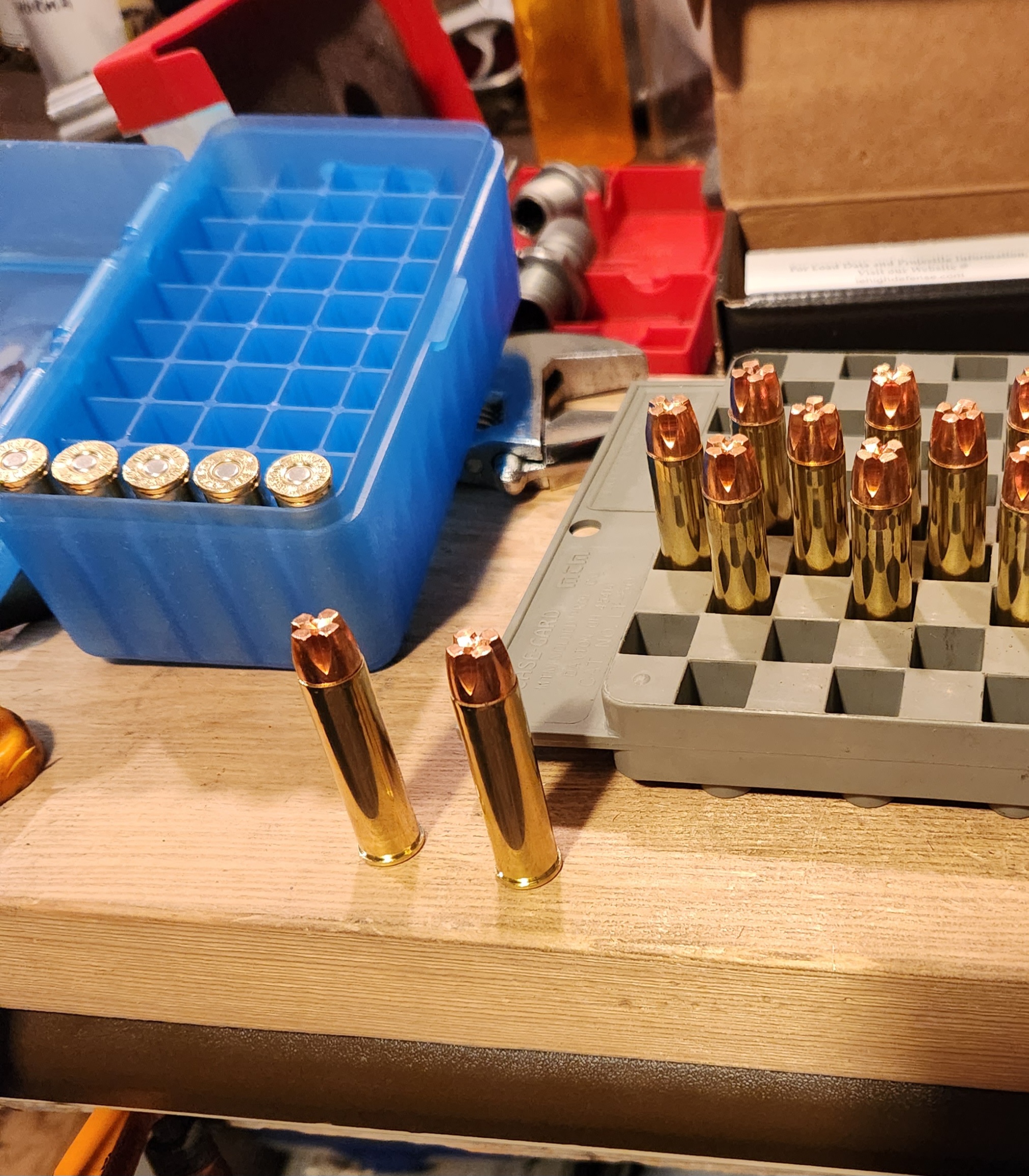

Loaded up 25 of these this evening. Lehigh finally came out with load data for their 300 grain penetraters in the 460 S&W mag. Should run about 1650 fps out of mine with a nice big spoonful of H110. Might have to shoot a couple in the dark just for the light show!

Omphh!^^^ That gonna be a handful. Whew!

20230320_201424.jpgLoaded up 25 of these this evening. Lehigh finally came out with load data for their 300 grain penetraters in the 460 S&W mag. Should run about 1650 fps out of mine with a nice big spoonful of H110. Might have to shoot a couple in the dark just for the light show!
Those are both pretty and pretty deadly. Nicely done.

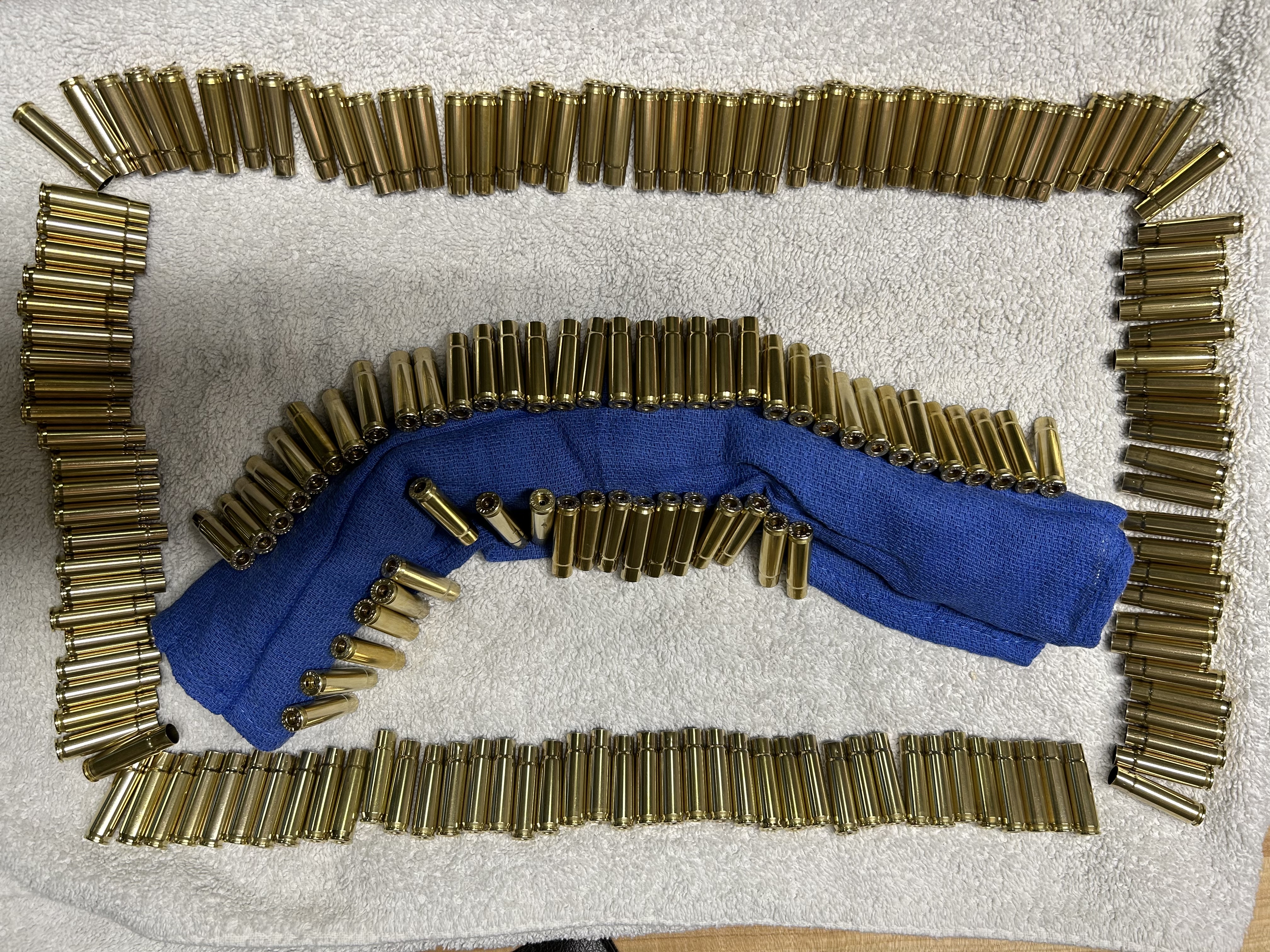

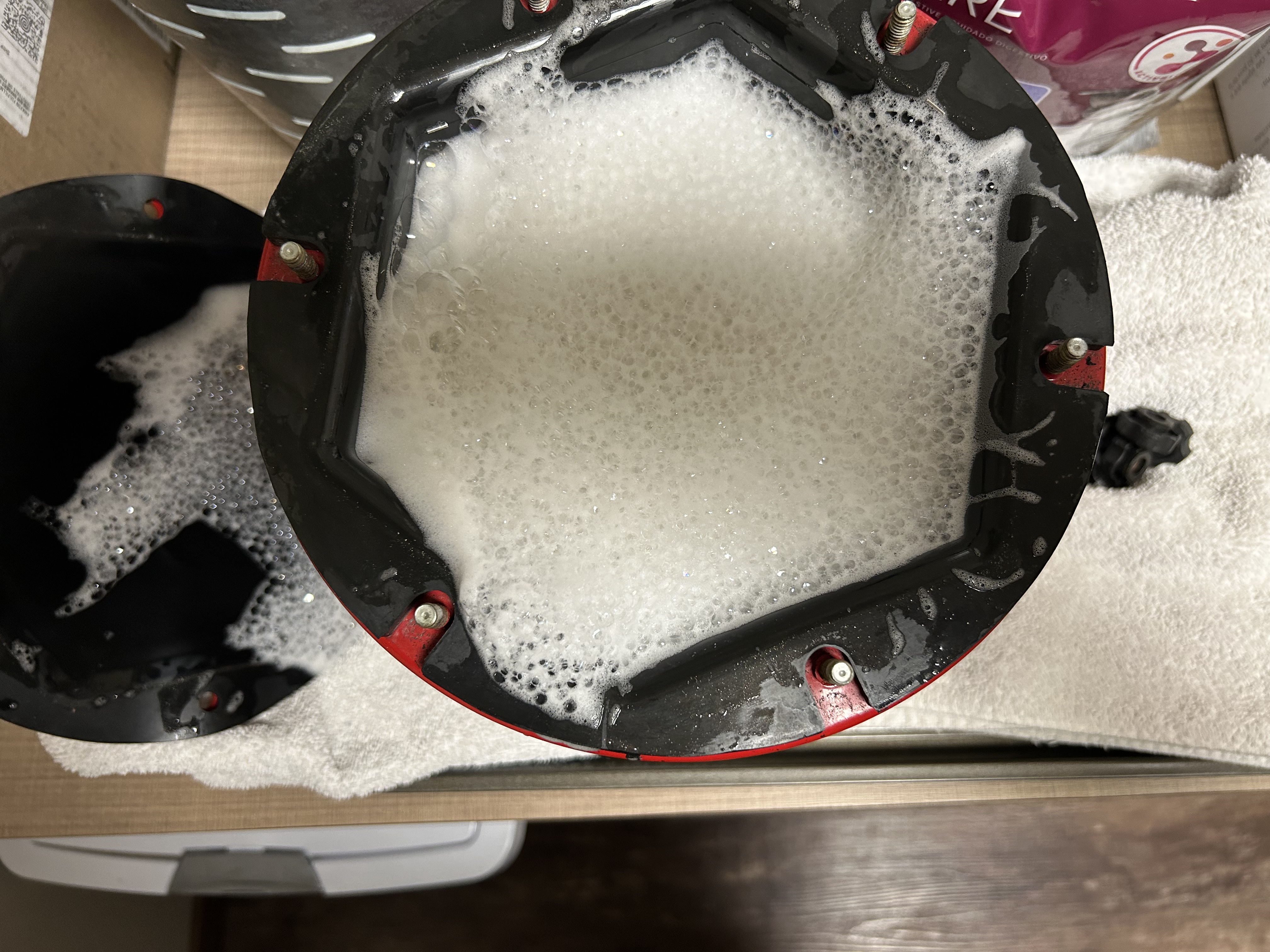

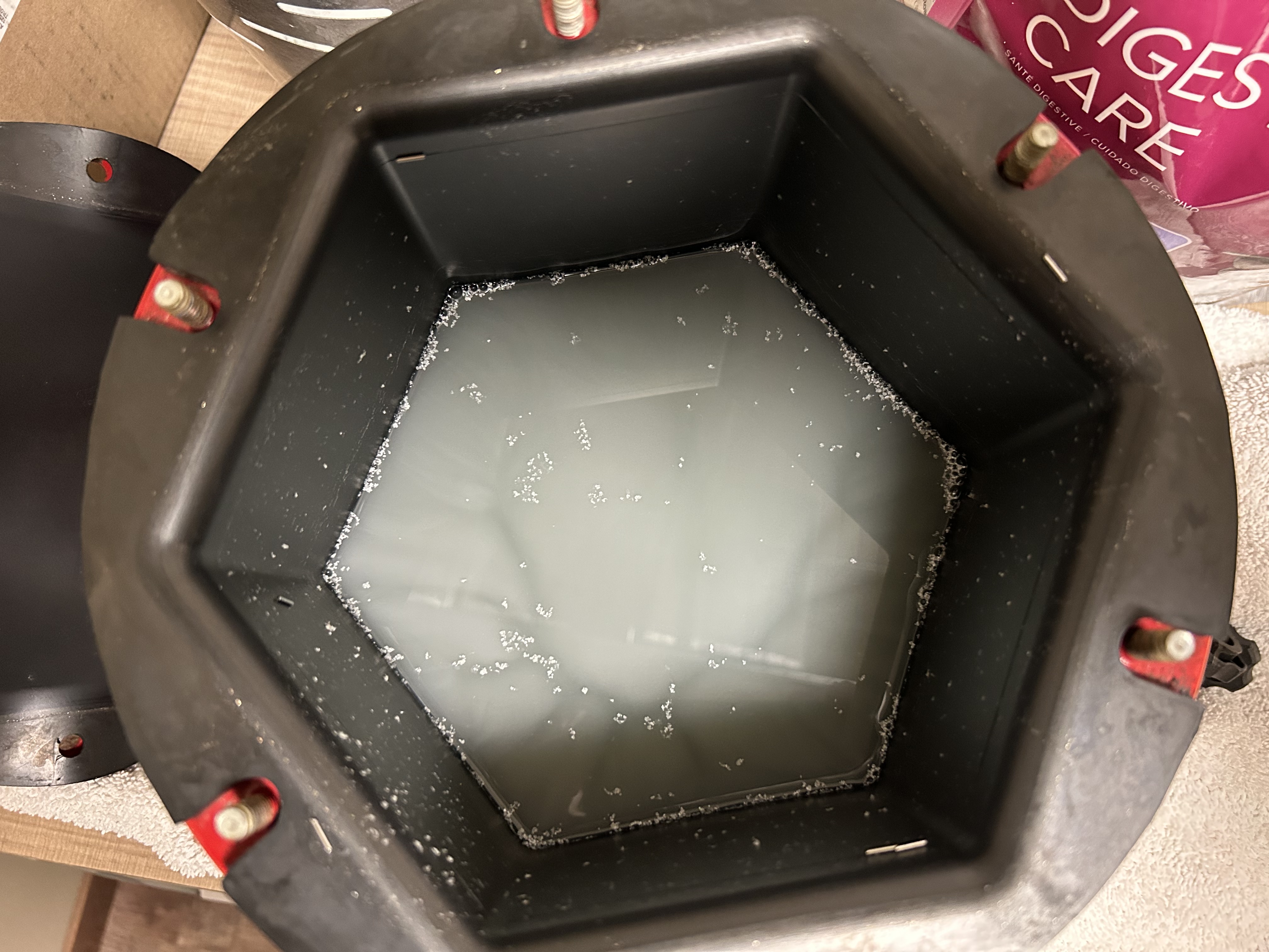

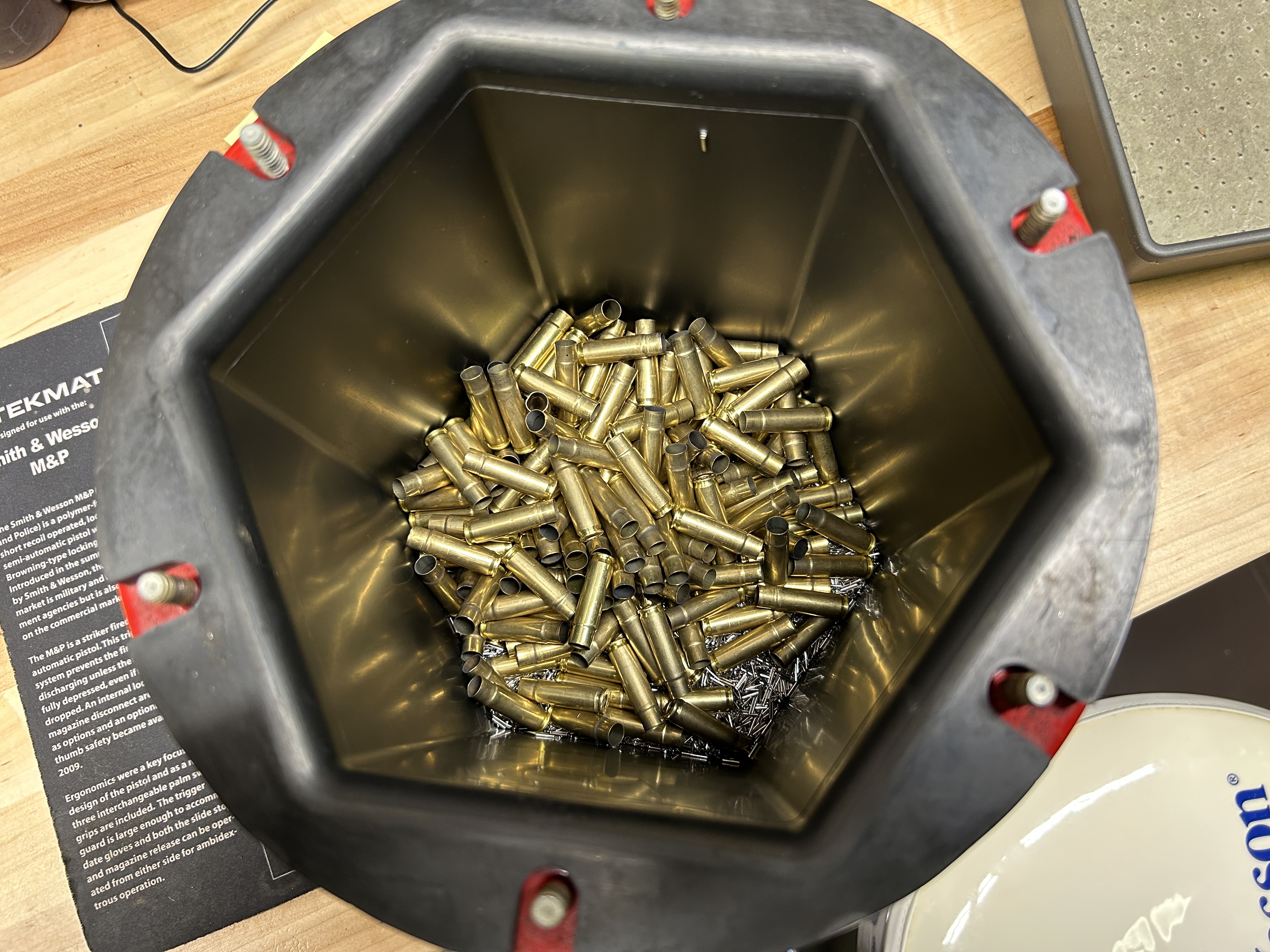

Yesterday I decapped and wet tumbled approximately 180 300 BO cases I recently shot working on a load. Here in a bit I’ll get them out of the water and let them dry for next time. I’m using the stainless pins along with a gallon of hot water, two tablespoons of Dawn dish soap and one teaspoon of Lemi-Shine dishwasher dish polish. Well, I pour water in until it looks right, squirt some soap in and pour some Lemi-Shine in. The measurements are what are called out but really I don’t need to be that specific. You just don’t want to make the drum too heavy or it will overwork the motor. The water sure is scummy when done and this brass wasn’t too dirty to begin with.
Posts: 12158
Post by Vaquero » Wed Mar 22, 2023 11:02 am
Yep, been using that method for a couple years now.
In that pic. those look like 35 Rem brass, with that slight neck. ;)
What is the parent case of the BO's?
Posts: 8056
Post by Hatchdog » Wed Mar 22, 2023 1:21 pm

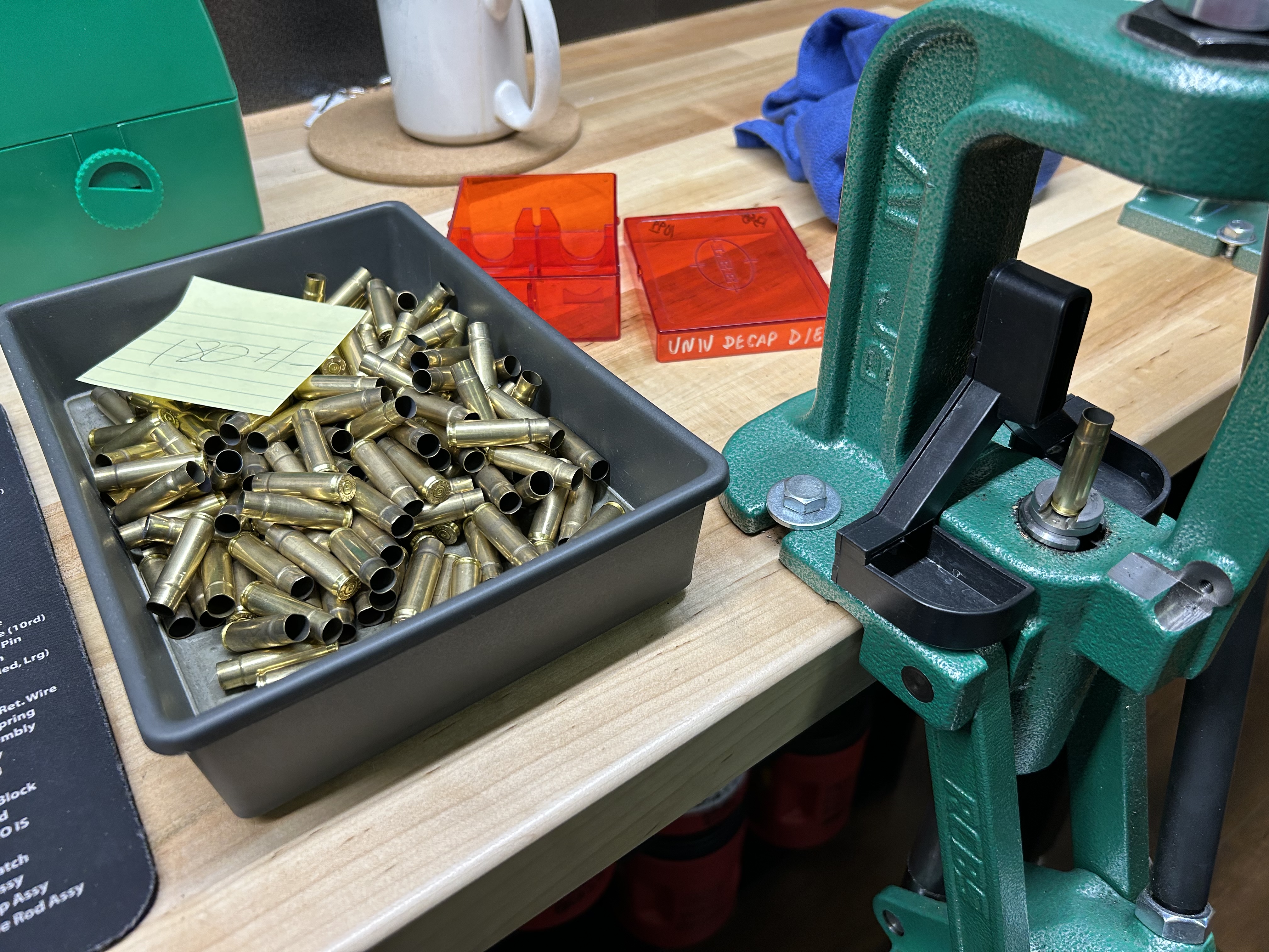

The parent case is the .223 and it is expanded to 30 cal and shortened. Folks shooting suppressed load up to 220 gr bullets and that’s a long bullet in this short case. Interestingly it uses standard AR magazines so the shortened case makes sense. I bought my brass new but many will reform .223 brass. Sounds like a lot of work, not just forming but using a saw to shorten it.

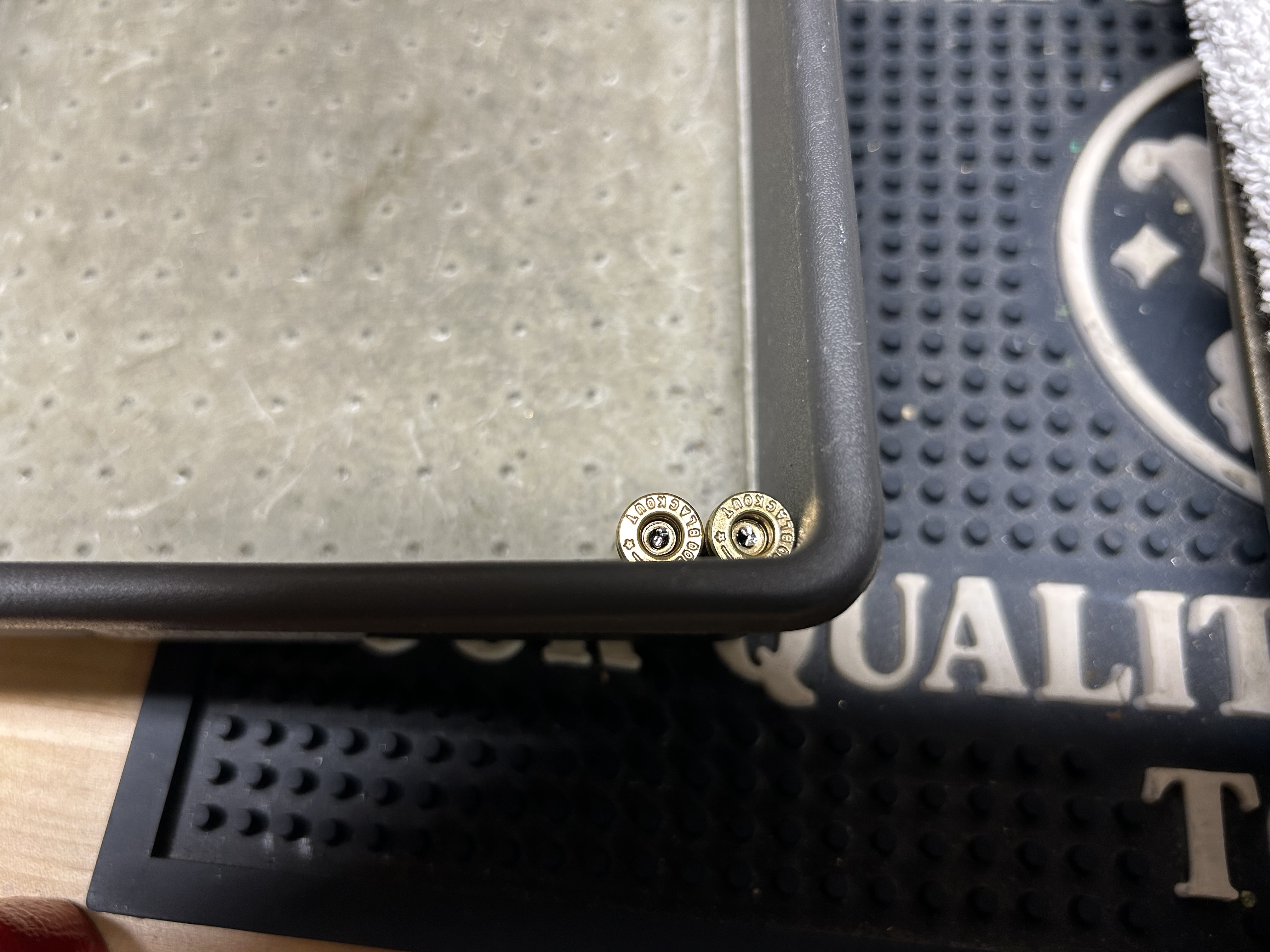

Here they are all cleaned up and ready to dance again. Note the two cases with pins stuck in the flash holes. I find this to be common in small primer pocket brass and usually there are more than just two even when I clean less brass. I’ve never paid attention to whether the large primer pockets have a larger flash hone. Hum?

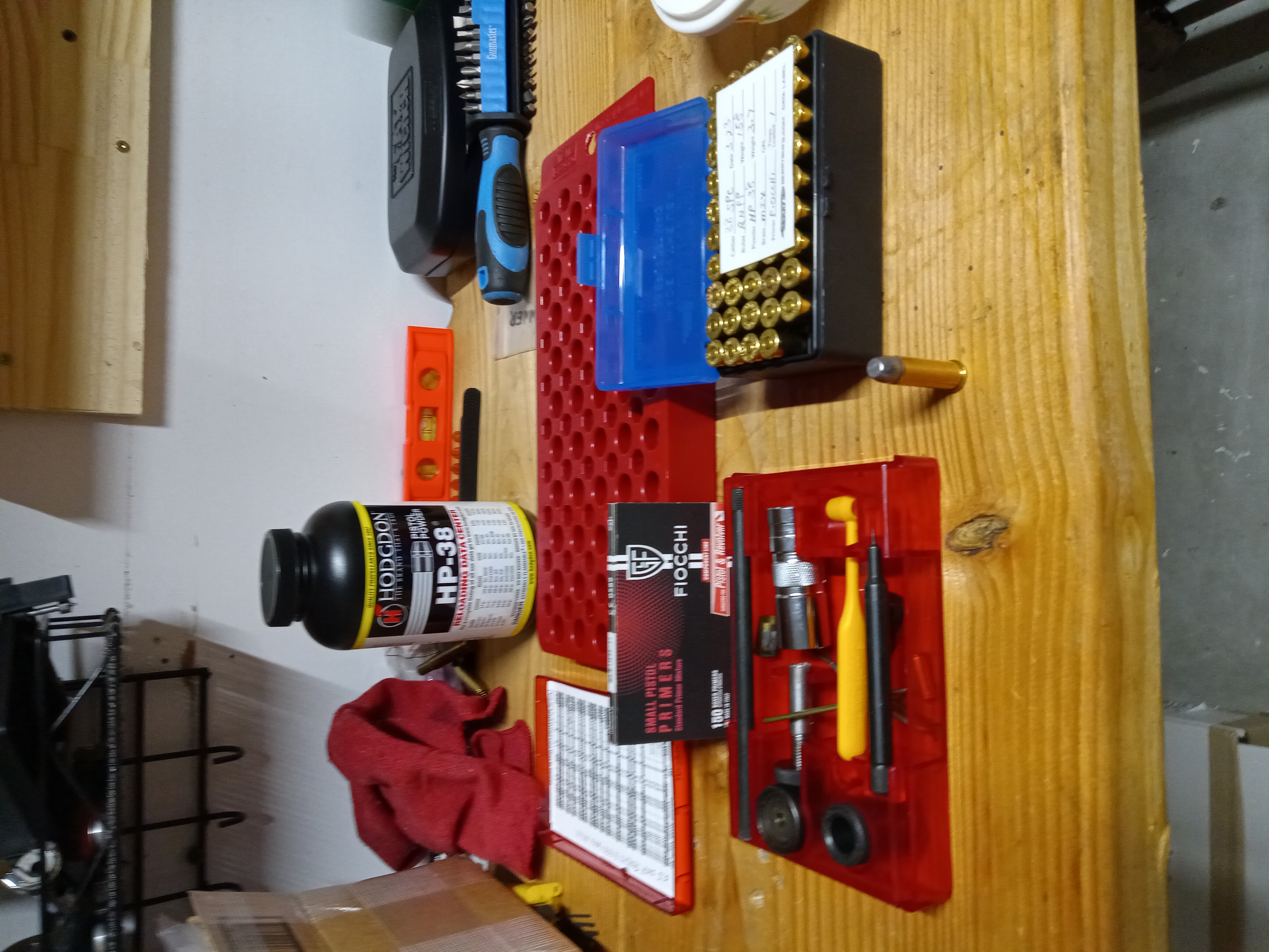

Loaded a box of 38 special. 158 RNFP / 3.7gr HP-38.. Relaxing afternoon with the LEE loader listening to the radio
