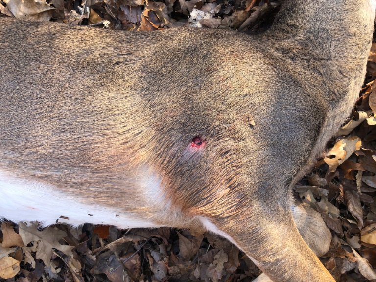

1,800 is a great MV for 300gr on deer at 75 yards and under. Unless you are shooting stem to stern, they will exit.
Here is a buck from last year, shot by my SIL with his Henry 45-70 and a 300gr Hornady at 40 yards (impact velocity about 1,650fps). It was a pass-through.

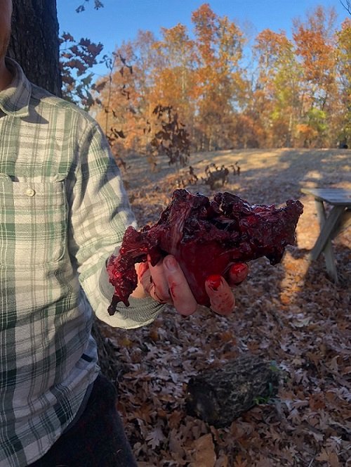

Here is the heart;
The deer was walking when he shot and it went straight down!

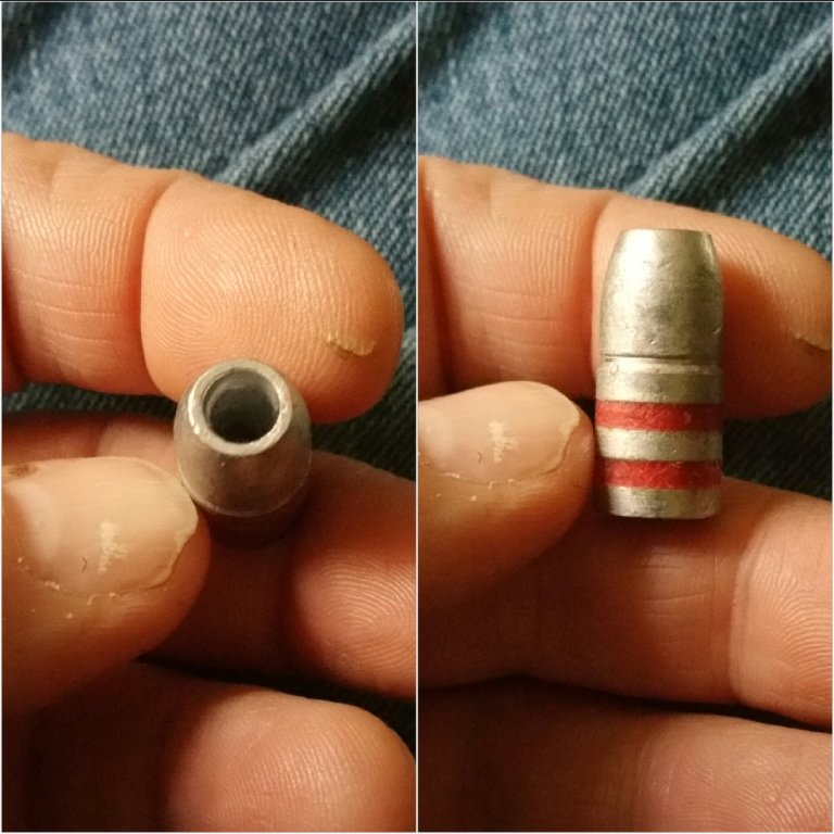

Also why 405 Gr bullet never founded in hollow point , example lyman mold #457193 , while a 330gr bullet like the lyman 457422 is hollow point ?
to heavy to expand ?

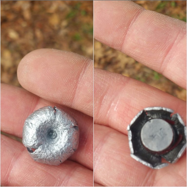

A 405 gr ends up around 385gr as a hollow-point. They will definitely expand if the alloy is correct.

Nice boolit!
What is the Bhn and what was the impact velocity and impact medium?

Sorry, Tim, didn't mean to hijack your post. I was responding to Brunix about heavy cast hollow-points.
I think it's around 12 bhn. It's a 2-2-96 alloy. That one was only running 900fps. Shot into water jugs and caught I the second jug.
