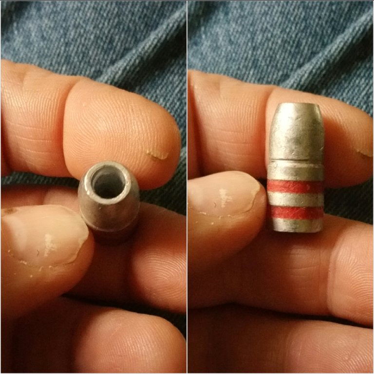

A 405 gr ends up around 385gr as a hollow-point. They will definitely expand if the alloy is correct.BruniX wrote: ↑Thu Oct 03, 2019 2:04 amhello,

GaHenryFan
Nice boolit!
What is the Bhn and what was the impact velocity and impact medium?
Tim
Nice boolit!
Tim

Sorry, Tim, didn't mean to hijack your post. I was responding to Brunix about heavy cast hollow-points.
I think it's around 12 bhn. It's a 2-2-96 alloy. That one was only running 900fps. Shot into water jugs and caught I the second jug.

I hand load all my rifle ammo. In .45-70, my most accurate loads are Hornady 325 gr FTX bullets atop 38 grs of IMR 4198. Velocity is 1,700 FPS and the felt recoil isn't too bad on my 76 year old shoulder. From the bench, I consistently get 2.5" groups at 100 yards. In spite of its accuracy, I have shied away from this round for deer and black bear because over the last 10 years I have read a few articles which contend the 325 FTX does penetrate deeply enough because it expands too quickly upon impact. As such, for deer and black bear I use Oregon Trail 405 grain hard cast lead laser bullets, on which I install gas checks. The powder is 33 grs of IMR 4198. The velocity is about 1,500 FPS with only a mild recoil. I give up some accuracy with these vs. the 325 FTXers with the 100 yard groups increasing to 3 - 4".
Re: Deer Hunting, Bullet and FPS Suggestions for .45-70
I shot two deer last year using 300 grain HP Hornady's and 44 grains of H4198. I'll tell you, it's an accurate load in my rifle and it smacked them right down. Neither deer ran very far (20 yards) and both left a blood trail like I have never seen before.Cooper wrote: ↑Wed Oct 02, 2019 8:22 pmThis deer season I am switching from a .30-06 bolt action to the Henry single shot H015, .45-70. I do not expect any shots to be greater than 75 yards and will hunting from a tree stand and expect the deer to be in and out of brush. I have mounted a Leupold 1-4x scope on the rifle.
