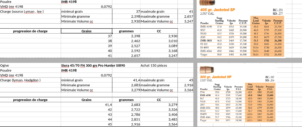

as I am careful and meticulous, I bought bullets for which I was sure to find reloading information:
- SI8900 Cal 45/70 FN 300 grs Pro Hunter SI8900
- Remington 45/70 405GR SP
Then, according to the information found in the lyman 50th edition,
I acquired the powder that could be suitable for a maximum of cases: imr 4198
I still have to buy the primers: cci 200 and starline 45-70 cases.
and I made two tables, one for each bullet for progressive charge :
Capture d’écran de 2019-01-09 19-13-01.png (175.07 KiB) Viewed 3344 times

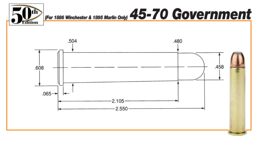

Finally I will be very careful to respect
  the dimensions of the ammunition :
Capture d’écran de 2019-01-09 20-18-47.png (164.11 KiB) Viewed 3344 times
i wil inspect case after every shooting to check for signs of overpressure...
and with all that, I hope it will be fine!
if you see a stupidity in what I propose to do, do not hesitate to tell me! :?

sounds to me like you are following a well thought-out process .... IMR 4198 is considered by many folks I know to be the consummate 45-70 powder .... follow the charges given in your reloading manual and you will do fine
