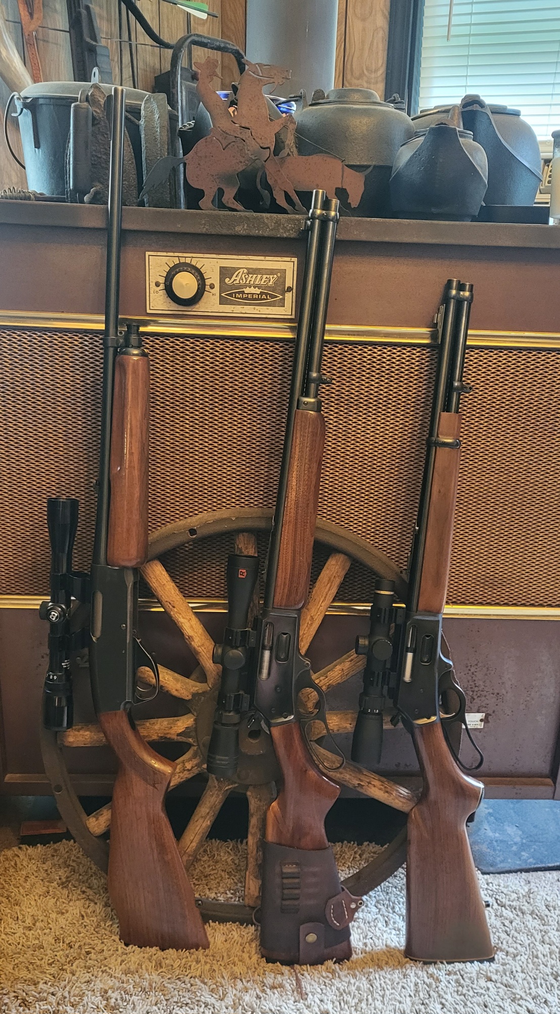

The two Marlins are sighted in to a 200 gr cast load that mostly shoot and hunt with.
The Savage was sighted for some factory 200 gr ftx ammo.
The three have accounted for quite a few deer in the past.
As a side note, that's the first jacketed rounds that I've ever put through the shorty.
I picked it up like new condition in the spring of '17.
