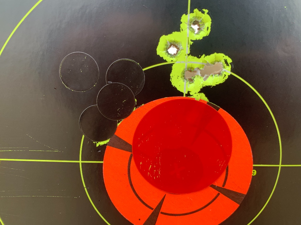

Ive used them for hunting in my 338 Win mag. I have also bought just the bullet and reloaded them. I can tell you nothing from personal experience about getting an animal with them. But accuracy wise in my gun you need to work real hard to get a load put together that shoots better than the factory loads do. They also do not like to be seated close to the lands like other bullets do. Some bullet jump is better for accuracy.
Here is a 5 shot group shot with reloads at a 100 yards Gun is a Savage Bear Hunter 338. The bullets I used here were the blue tipped ones.

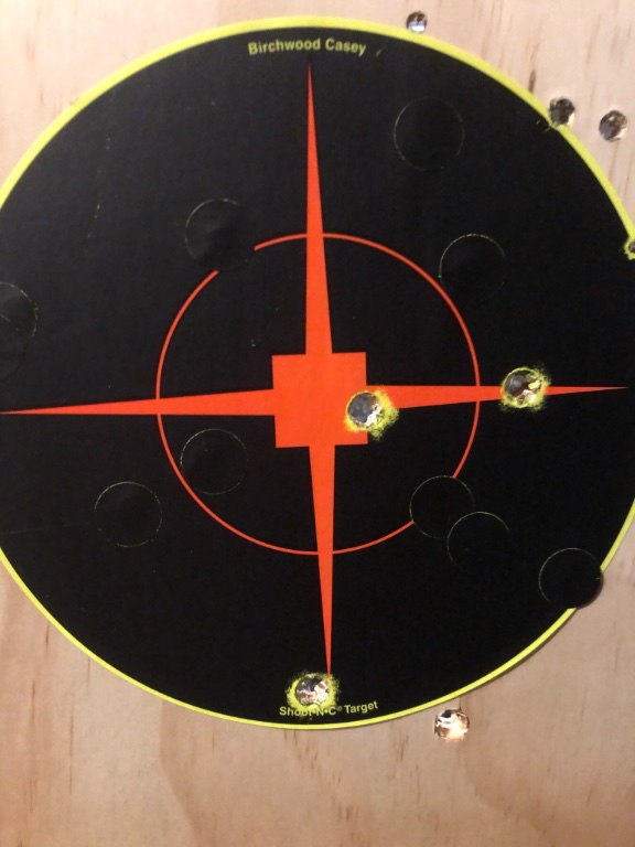

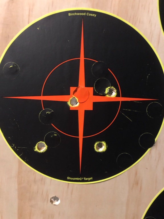

Well, we got out and burned some powder and learned a few things. My Marlin hates 160 grain FTXs (LeverEvolution), Which is too bad as I have a ton of boxes of that, but it does like the Barnes copper rounds! Top two targets are both from 100 yards with 4x Nikon. Two shots, and then one. Patches are covering shots from Hornady. Used the headache rack on the pickup as a shooting bench. Hi-tech red-neck!

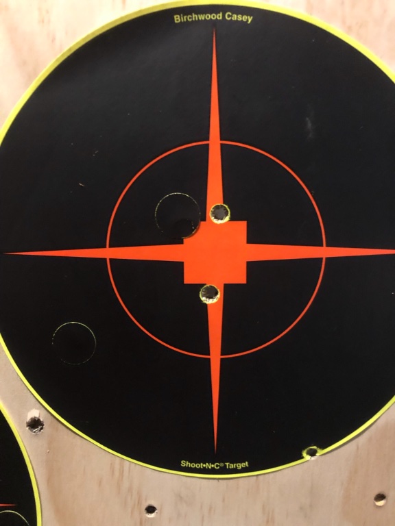

.44 Mag BBSC from 50 yards with elevation off by 8” or so. Kind of guessing really, So I’ll have to go out again after I shorten the front sight a bit. Top photo is 225 grain FTX LeverEvolution with one off paper, and lower photo is 240 grain cast HPs relaoded by the guy I bought the carbine from. They definitely had less recoil than the Hornady or Federal 240 JHPs I shot, so loaded light I’d guess, but it shot them the best.

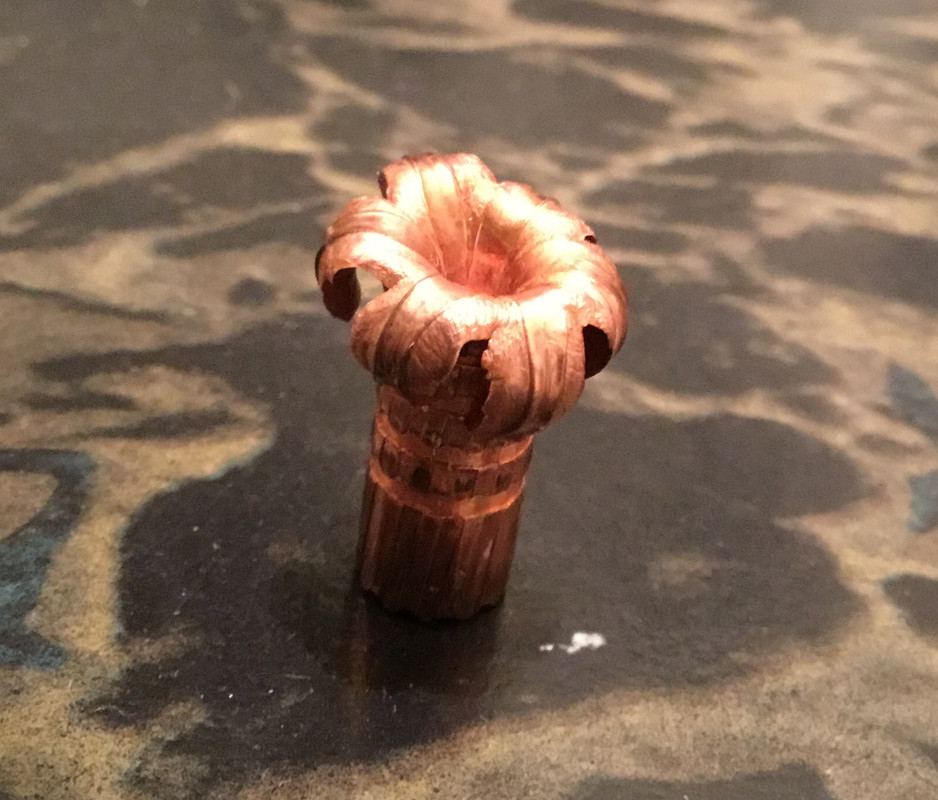

Well, I now have firsthand experience with the performance of copper, and I’m damn happy. Nice sized spike blacktail went down after one step, and one kick of the hind legs on its side and it was still. Lethal stuff. Shot placement? Yeah, it was good. Took off the top of the heart, through the lungs and recovered the bullet just under the hide behind the ribs. Shot was straight on from the front.
My only regret? That Henry doesn’t make a shorter barreled.30-30 for us tight woods guys. I was packing my 18” barreled Marlin 336 BL with Nikon 1-4x. My first deer with the Marlin, and first with copper. And since we are all being honest, my first deer ever. Being an upland guy with a pack of bird dogs, it’s not my focus, but it’s good to finally get one!
