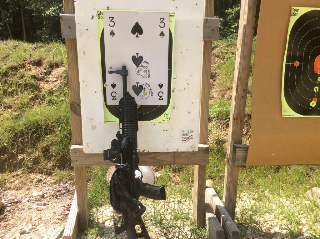

Wanted to do a test comparing Small and Large Magnum primers in .45 ACP to see if any difference in speeds or accuracy.

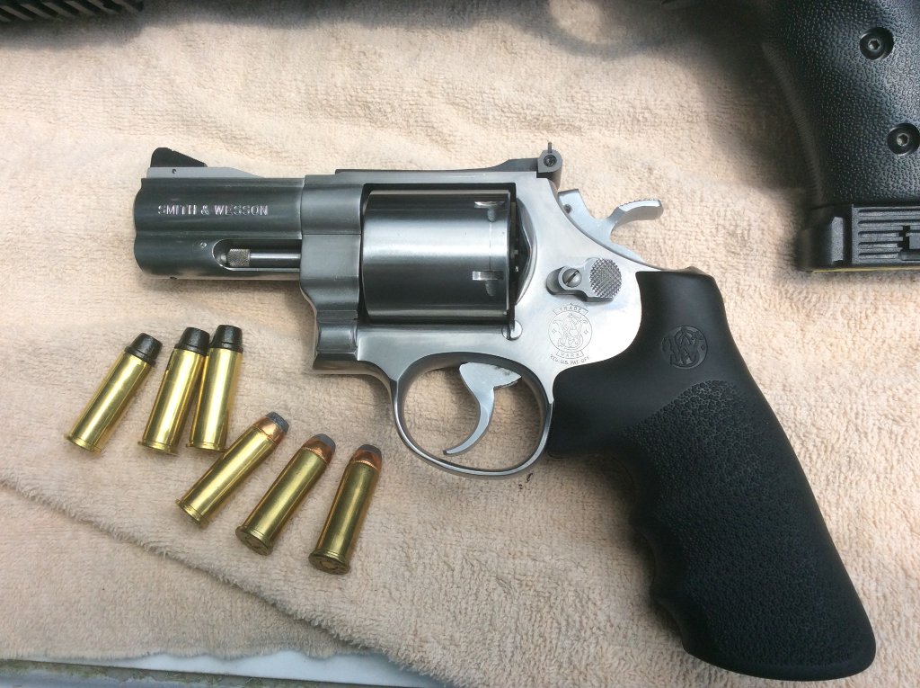

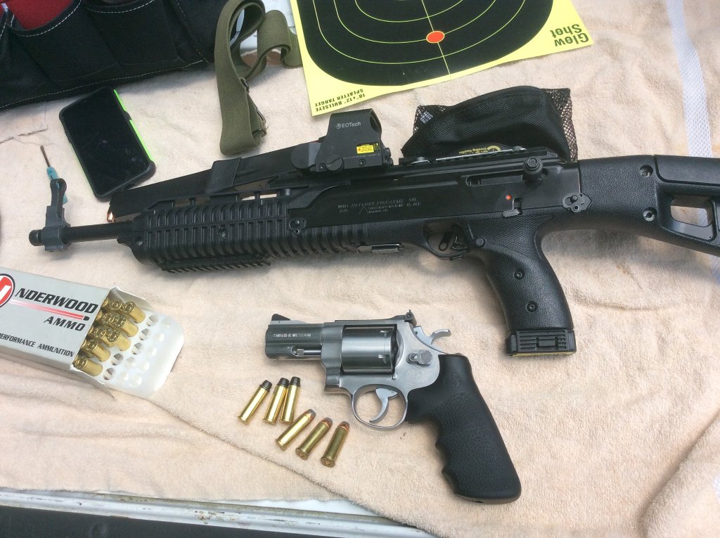

The test lead launcher would be my HiPoint 45 Carbine which I haven't shot in a while. Also dug out my S&W 629-2E 3 inch revolver which I haven't shot in a long time to try some 44 Mag loads.
The 45 ACP loads were with same Xtreme plated 230 gr. RN bullet loaded with 6.0 gr. Unique. From the test I saw little difference with speeds of 925-988 FPS with the Small primers and speeds of 954- 987 FPS with the Large primers.
Target distance was 25 yds shooting from standing position. After sitting a while in storage sometime the EoTech sight might require a slight adjustment to be dead on and most likely due to the HiPoint polymer mount. I didn't bother to adjust for bullseye hits for this test being good enough to hit the steel and close to center.
Now I can go ahead and load more 45 ACP using my Small Mag Primers which I have a lot more of.

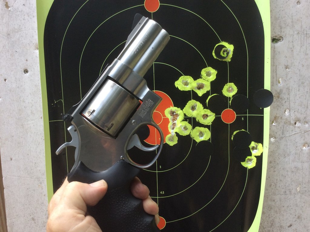

The SW 629 was a fun shooter as you can see and three different loads put nice clusters of holes in the target! Target was 10 yds and shooting double action from 2 hand standing position. Hits near top area were 240 gr. MB cast bullets with 6 gr. Red Dot. The closer to center hits were same 240 gr. bullet with 9 gr. of Unique and several rounds of Speer 240 gr. JHP with 10 gr. of Unique...I like both those loads!

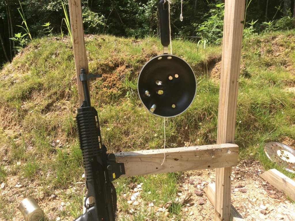

Also had an old aluminum frying pan that made a great swinging target for the HiPoint Carbine! :lol:

Fun! Liking all the targets forty, but, really like the frying pan. Love it.

Yeah...love those big 45 holes in the pan. That thing was swinging and took off behind the berm on last hit!

Good shootin Forty and a good test of the LP vs SP primers, and glad they are working for ya.

Good report Forty. Good results to know. One word of advice - don't try to cook breakfast in the pan. :lol:
