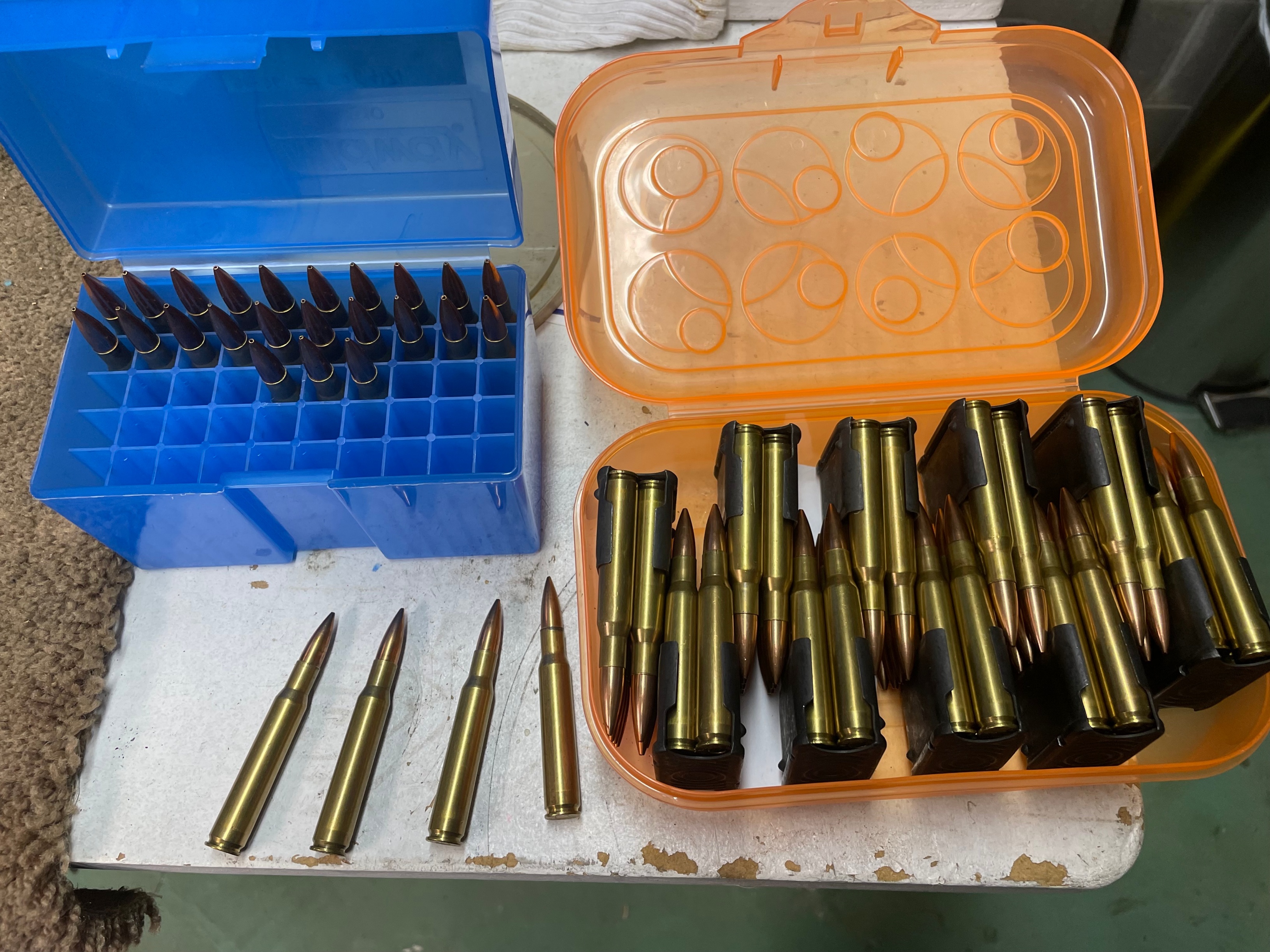

Went to the range on Tuesday and burned thru most of my 30-06 ammo with the M1 Garand. So I figured I better make up some more ammo.
Put back 80 rounds into enblocking clips and made a few extra to finish up the Sierra Match King bullets. The M1 is such a pleasure to shoot that i can burn thru 100 rounds very fast. :D

Headhog, those are some nice looking rounds. Maybe my first time seeing .30-06 with match bullets that gives them the look of an ICBM!!! :D
