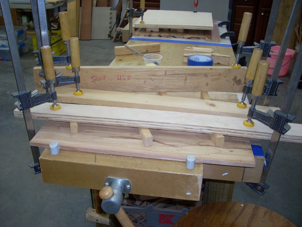

Once I was sure they fit properly, I moved them aside and covered the benchtop with wax paper, and applied glue to the proper edges. I then applied pressure to the sides of the panel, then pressure was applied with cauls to hold the panel flat on the bench to prevent bowing. The less error in the glue up, the less that has to be adjusted later. :D
08 glue ups.jpg (169.37 KiB) Viewed 5177 times
The second panel was glued up in the same manner on the opposite end of the bench.

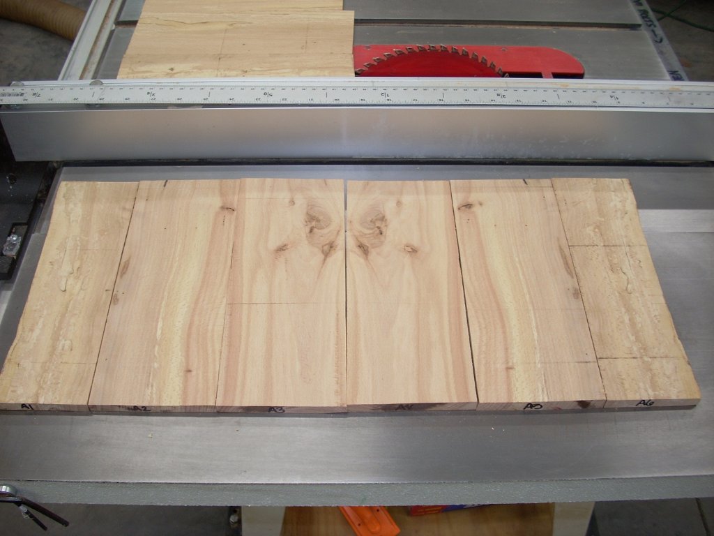

When I went out this morning and released the panels, I found that one of the four individual plates in one of the panels had creeped. :twisted: This threw off the entire effect on that panel. The glue up was very good. :roll: I lined up the joint with the edge of the workbench and clamped it solidly in place, mentally crossed my fingers, (and toes), held my tongue just so...
And... Slowly applied pressure. More... More... Then... Craaack. The panel split cleanly on the joint line. I ran the two glued edges across the jointer twicd to remove the old glue residue, then reapplied a coating of glue to one edge. Back one the bench and carefully aligned, pressure applied, cauls and clamps in place. Now we wait.
I spent the next hour cutting the blanks that will form the side rails.

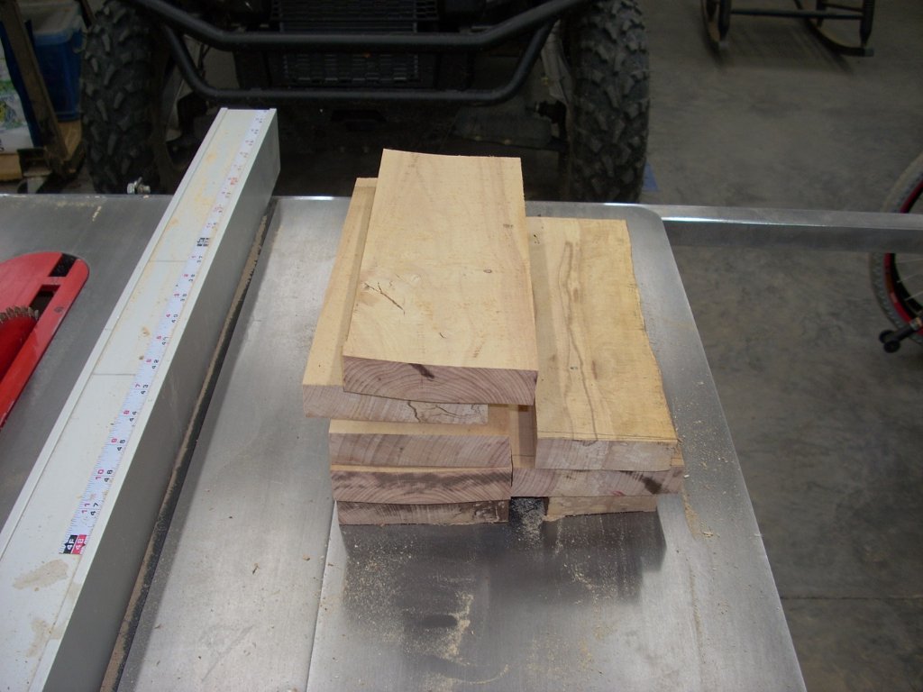

Back out for an afternoon session. Here is a peek at the roughed out side rails and support rails awaiting attention.
09 side rails and support rails.jpg (147.36 KiB) Viewed 5163 times
The side rails will get dadoes to receive the side panels a bit later, and of course the edges will be rolled. The plain faces on the edges should dress up when they take a trip thru the planer.

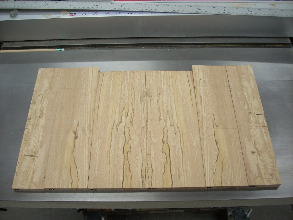

I cut a section from another maple panel and then cut it into sections for the side panels. The sections are approximately 10" by 4" and will be bookmatched. They have to go thru the planer, then across the bandsaw.
10 rough side panels.jpg (144.21 KiB) Viewed 5163 times
After a good bit of attention, this is what you get, these are the ROUGH side panels, matched up to form the two sides. This is a very rough layout, showing about 22" in length. They will be squared up and trimmed to an even 18" and 9" in height with a half in tenon top and bottom. The best use of the grain will be chosen to obtain that length. Yup, still fiddling and finagling to do. :)

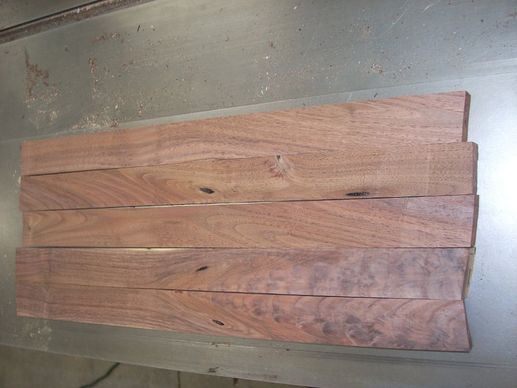

I wasn't happy with the way the maple rails turned out. Not enough grain to compliment the side panels, so walnut rails were an option. I pulled a sliced bookmatched log off the stack and spread it out. Plenty to choose from.
01 Multiple Choice.jpg (165.97 KiB) Viewed 5099 times
I chose two slices with good grain, and picked the side that would offer two matched rails with the best grain from each rail, then ran them across the table saw to get a straight edge, then across the jointer to get a "really" straight edge.
02 straight edge.jpg (178.11 KiB) Viewed 5099 times
Once that was done, I used the fence on the table saw as a guide and cut the two pairs I needed, and since there was enough left over, cut a spare rail. Always nice to have an extra part handy if there is a slip. :roll: NOT that this has ever been an issue when "I" was building a project. :twisted:

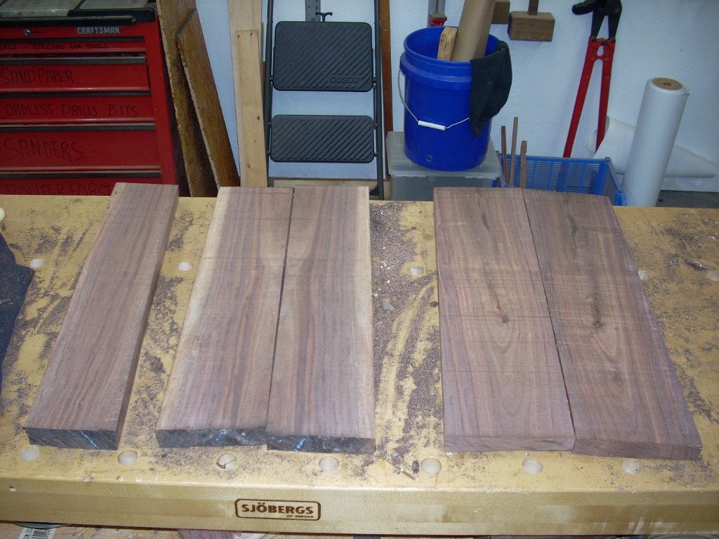

I had to set up the dado blade again and cut the dadoes in the rails to accept the panels. Then trimmed the ends of the panels with tenons so they fit in the grooves. All together.
04 A side.jpg (156.24 KiB) Viewed 5099 times
05 b side.jpg (157.61 KiB) Viewed 5099 times
I like the contrast between the walnut and maple MUCH better.

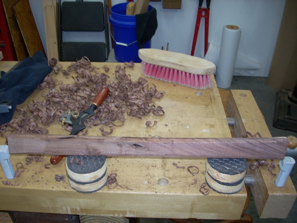

Today's work was on the EXTRA rail, which will become the handle and will reside at the top of the chest... between the ends at the top of the "coffin" as Miss T has taken to calling the shape.
I used a spokeshave to start turning the rail into a comfortable shaped to hold. Faster, and much easier with a router table, but LOTS noisier and dust everywhere. The only sound in the shop with the spokeshave is the WHISP of the blade... which I like.
01 spoke shave.jpg (245.07 KiB) Viewed 6315 times
I worked all four edges to the general shape, then the top and bottom of the handle. After I achieved the general shape I wanted I cut it to length to match the length of the sides.
I will of course sand this thru, ah... :roll: ... most likely 120 grit.

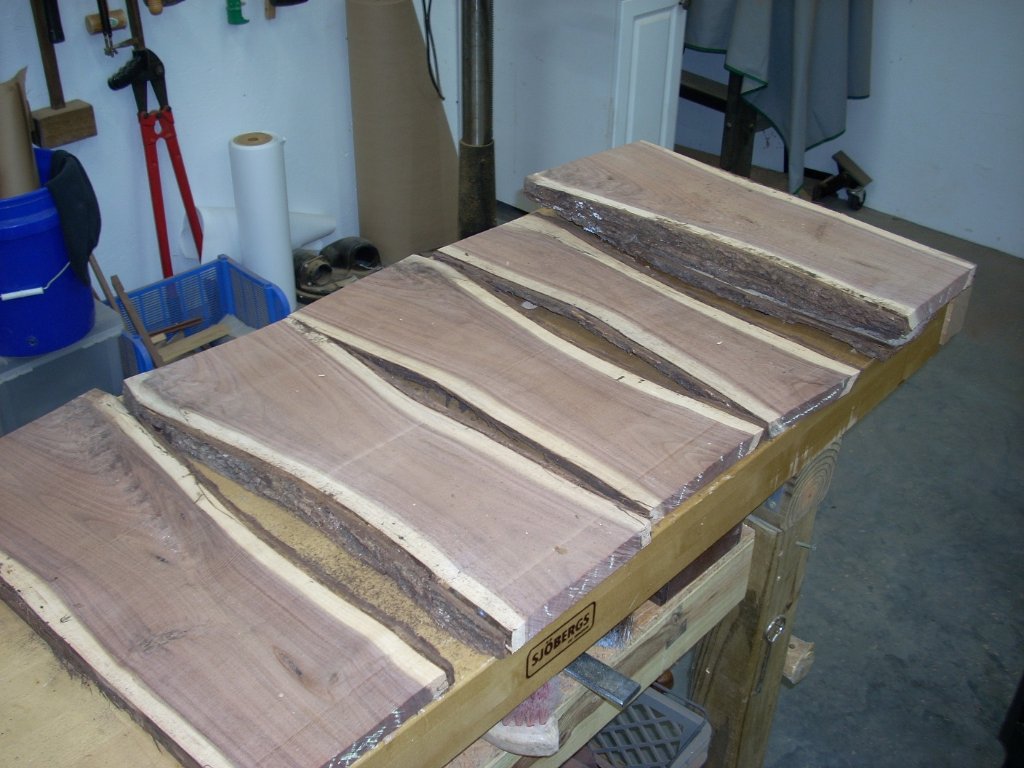

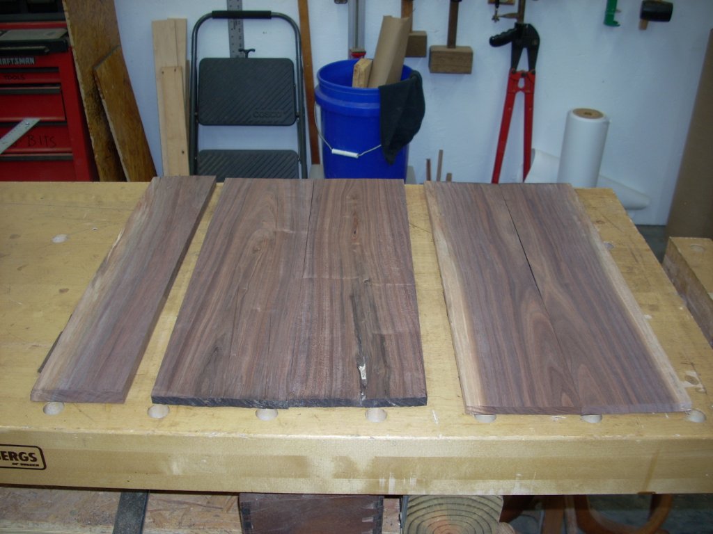

The last two days I have been working on the top crossbar and wing doors. They are being made from black walnut I have cut from logs given to me by my Mentor (Rabbi) in the LE PPC world, a Retired Marine/Police Sergeant who has looked over my shoulder for more than twenty years. Grumpy, Grouchy, and easily qualifies as all the seven dwarves. A good guy, but the Officers in the department either loved him or hated him, depending on the quality of the officer. (Good Officers loved him, I'll leave it at that.) :roll: There are those here who will know what I mean. He was the Range Sergeant, AND at times a Patrol Sergeant in a very bad part of town...
Anyway.... I digress.
I had gotten tired by the time I cut these slabs and had NOT done a very good job, so IT cost me. The grain was NICE.

BUT, you get lazy now... you pay later, as you will see. The slabs I cut six months ago... were NOT flat like the ones I started out cutting, they were "slightly" warped.
(Slightly warped like slightly pregnant.) :?

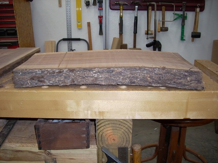

This meant a LOT of work. So, first I cut the two inch slabs into bookmatched slabs after first trimming them into squared edges... a must for bookmatching on the bandsaw.
Then I measured the center of both ends, struck a line and cut VERY carefully to the line thru the slab. THIS gave me a flat straight side.
03 bookmatched.jpg (182.83 KiB) Viewed 6267 times
BUT, I still had panels that were too thick to use as the winged edge doors I had envisioned hanging from the center panel. I measured off a half inch from the flat side and ran back across the bandsaw, staying to the outside of the 1/2 inch line. Then I ran all four panels thru the planer, getting nice smooth flat panels that would work once jointed and glued at 8" wide. Doors for the two sides. The center panel was also trimmed and planned to 5/8"
04 trimmed.jpg (148.53 KiB) Viewed 6267 times

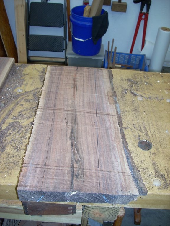

This is an idea of what I envision, but the wing doors will angle down about 45 degrees to meet the 12" sides. Following the coffin sides. ;)
05 concept.jpg (172.91 KiB) Viewed 6267 times
I may... MAY... put a maple trim piece on each end with a lip under the edge to strengthen the panels, and a maple brace under the doors at the hinge point. I'll use some of the highly figured spalted pieces I have saved, which should really pop against the walnut and serve as both supports and accents. I'll fiddle with it during the next steps, and see if:
