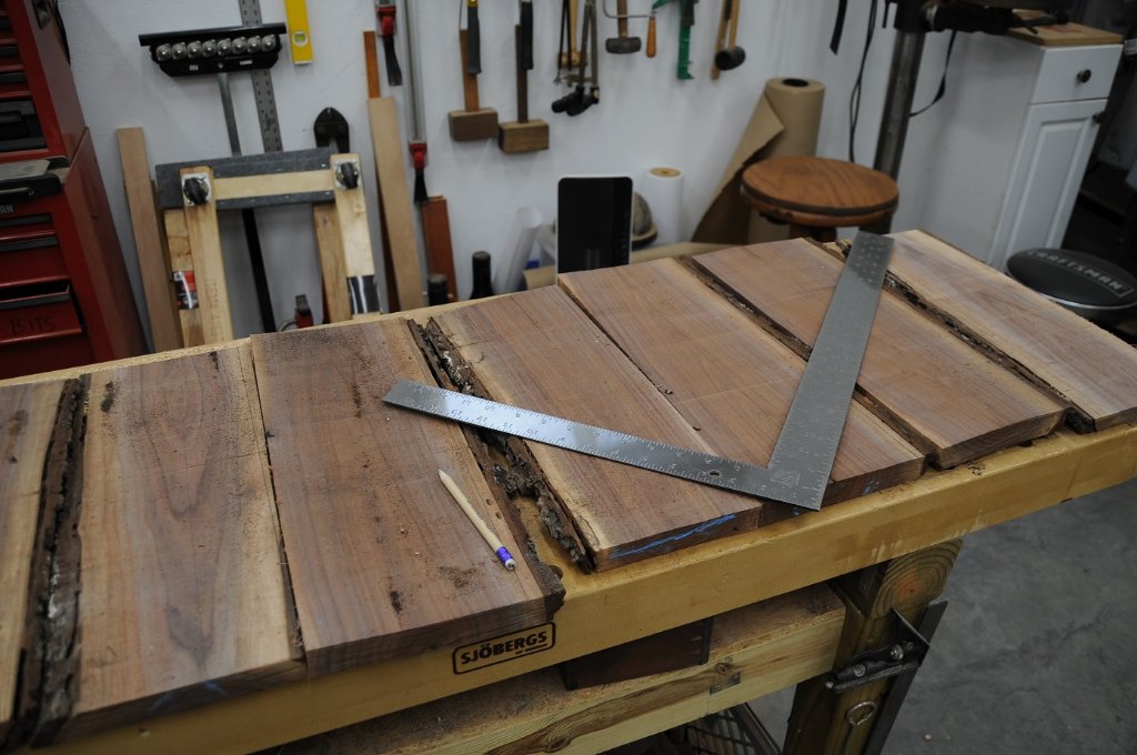

After processing the Slabs the in the earlier steps, I marked the center, then a straight edge.
20 marked the centers and edge.jpg (157.78 KiB) Viewed 4721 times

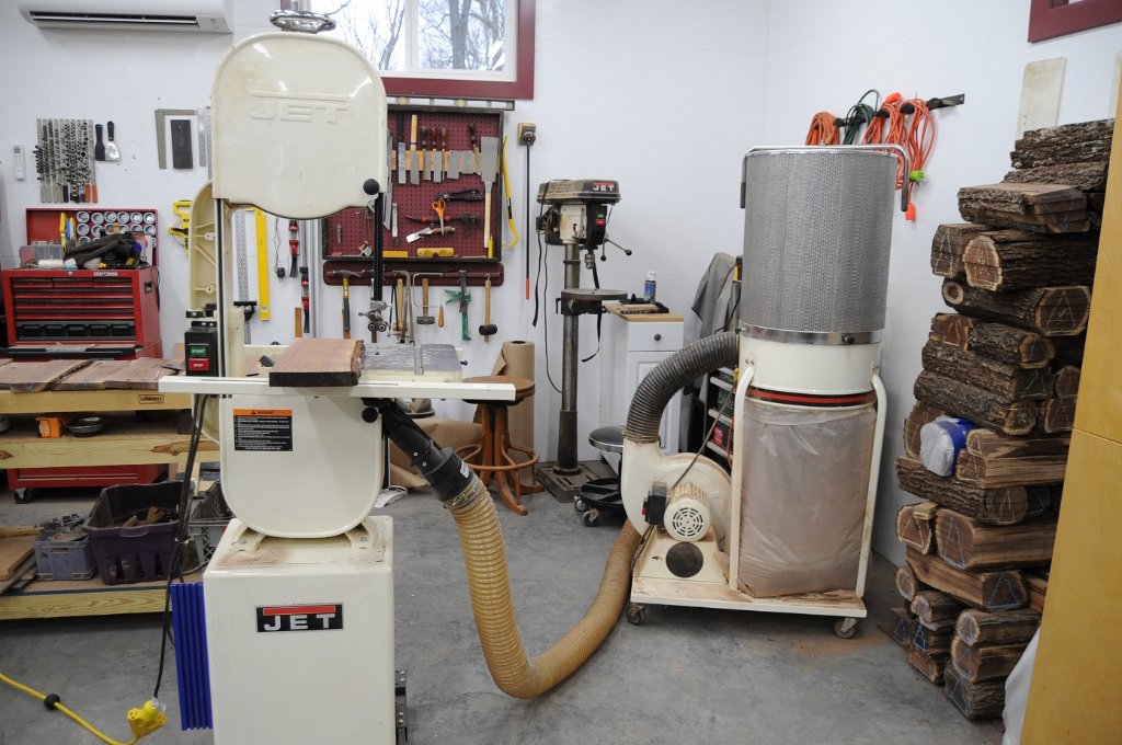

I chose the best and cut those on the bandsaw.
21 cut an edge.jpg (181.12 KiB) Viewed 4721 times

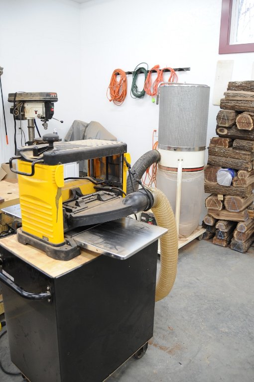

Ran them thru the power planer to take out bows and rough faces.
23 power planed.jpg (111.82 KiB) Viewed 4721 times

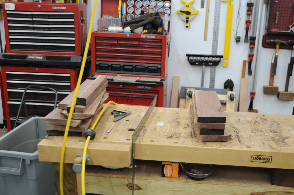

Now that I knew how I was going to deal with the drawer faces, time to trim the blocks to size.
26 drawer face to width.jpg (89.06 KiB) Viewed 4721 times

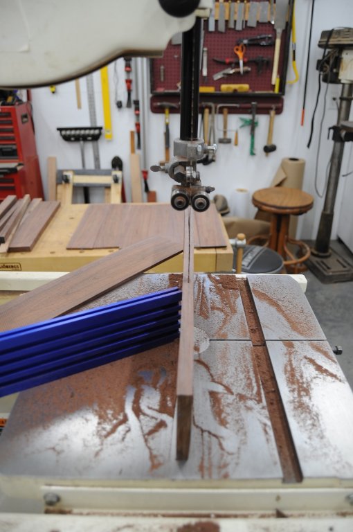

The blocks could be bookmatched to produce the faces. Each block yielded about three faces.
27 bookmatch on band saw.jpg (110.33 KiB) Viewed 4721 times
