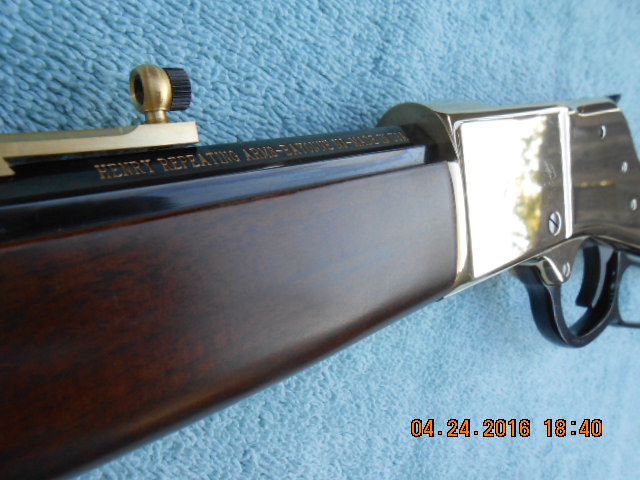

The first .357 magnum Henry I had, which is gone now, was a BBB 20" octagon barrel model. The pics I'm posting below of this rifle & peep really don't look any different for a 20" model or 16.5" Carbine model. Also here is one of the Range Reports I posted in April 2016 when I shot this BB using the peep sight. http://henryrifleforums.com/viewtopic.php?f=42&t=463 I liked it a lot, and it really worked well; easy to quickly grab the sight picture, and quite accurate.
I'll make this comment though. My current two Henrys both have receiver-mounted peep sights. The shorter distance from peep to eye does make a difference....easier to get a good sight picture, and I'd say some accuracy improvement. Either way would be a good way to mount a peep sight. Yes, the cost factor does come into play for sure.
Best on making your decision which mount style to use. Both are darn good. I really like using iron sights, so that's a plus for me.
