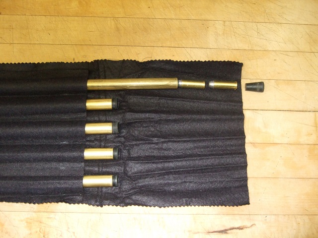

I have made 5 speed brass reloading tubes for my Henry Big Boy in 45 LC. Work great for loading and unloading. Can reload 10 rds in about 15 seconds or less. Have some photos and how I made them if anyone interested.

http://henryrifleforums.com/download/fi ... ew&id=4649
This is the simple process I did with my re-loaders. Cut at the crimp (a good tubing cutter will work) clean up the end and back bevel the inside. Install the 9/16"x3/8"x1" rubber plug and cut the end off with a razor blade. Push this cut piece into the loader tube all the way to the bottom. It prevents you from loading 11 rounds. After loading, install an uncut rubber plug.

Re: DIY Speedloader
Finished the case for carrying 5 reloaders to the range. All I have to do is fold over the end flap, roll it up and secure with Velcro straps. Used it this last weekend at the range and even once had to use it for an unloader without any problems. Over kill to some, but then I own a Henry Big Boy 45. What more can I say.

Re: DIY Speedloader
nicely done .... I really like both the speed loaders and the case

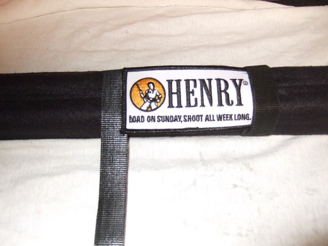

CaliforniaMike
Re: DIY Speedloader
Here is the final touch to my Henry project. Two Velcro straps 3/4" wide and sewn to a Henry patch. This secures the rolled case for the 5 loaders.
