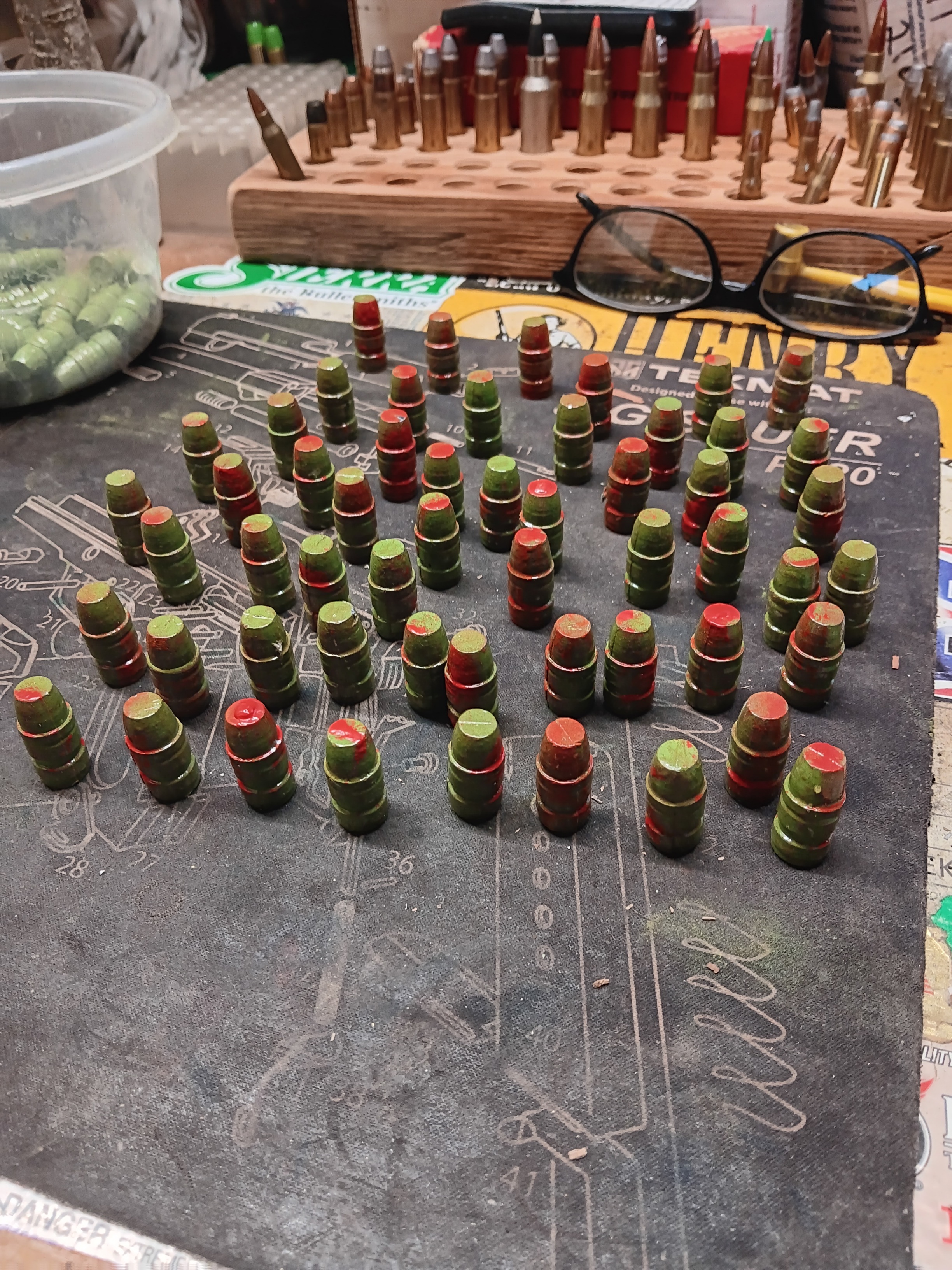

Well, I did shoot 5 of those rounds I loaded earlier, 2 from the Marlin P and 3 from the Rossi, not much difference in the way they felt.
Then warmed up the pot and went looking for the handles to the mold, it was on the Accurate 41 mag mold and I hadn't put it properly so it took a bit for I got started. Between the delay looking around and then a neighbor stopping by, I did manage to get a 180 cast up before calling it quits.
This was about half way through the session, the lowest I found was 321.6 up to 325.1.

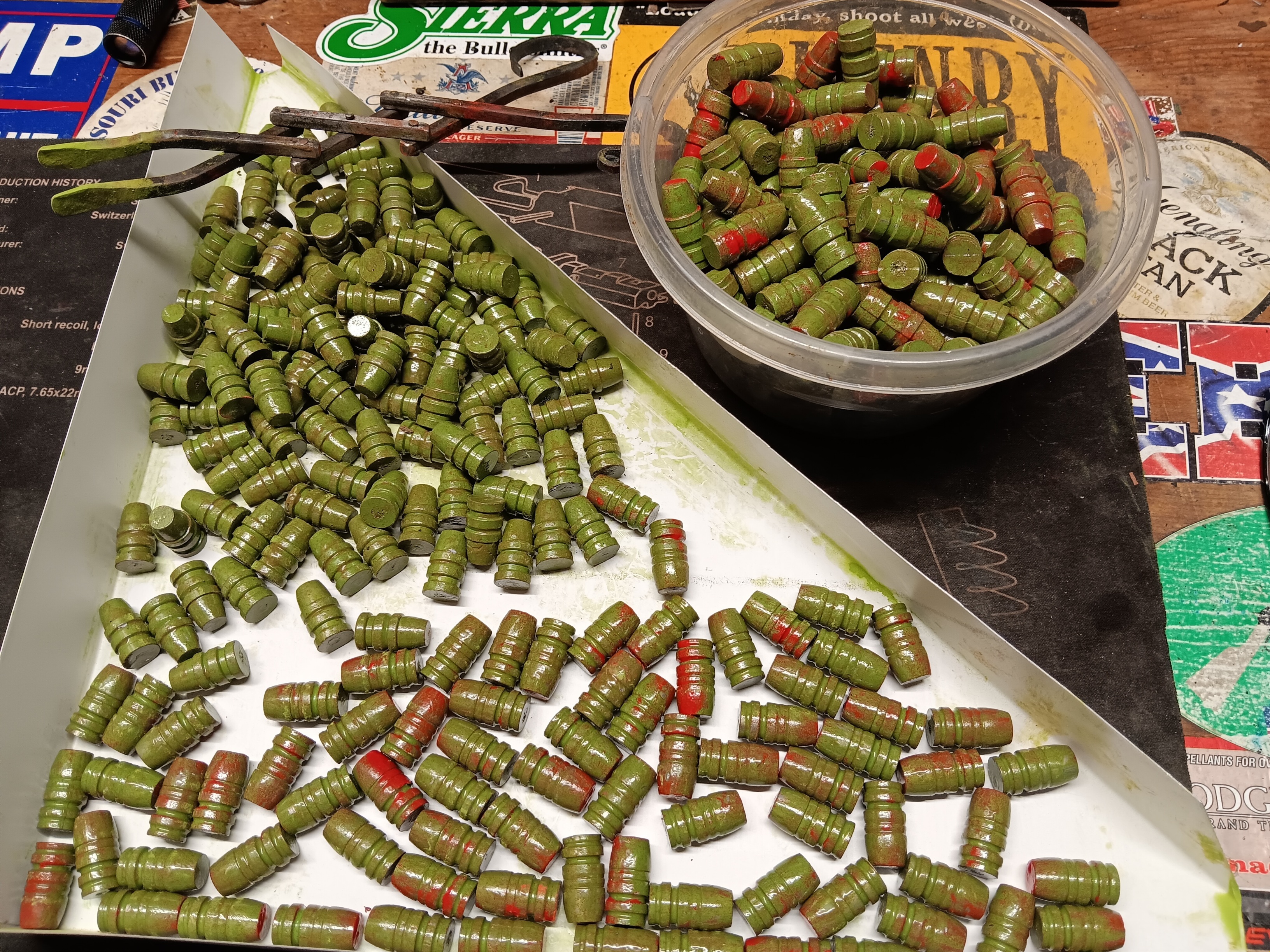

Post by Vaquero » Sun Feb 09, 2025 4:48 pm
Post by BigAl52 » Sun Feb 09, 2025 5:18 pm
Are those pure lead Randy? Do you ladle pour or bottom pour?
Posts: 12158
Post by Vaquero » Sun Feb 09, 2025 6:27 pm
Ladle pour, I do also have one with the bottom pour but I don't fool with it.
Smelted wheels weights that I bought from the SIL, I do have some near pure lead.
But for powder coating they can be a bit soft, I will add a little here and there, but those and the ones I did yesterday were with just the ww's.

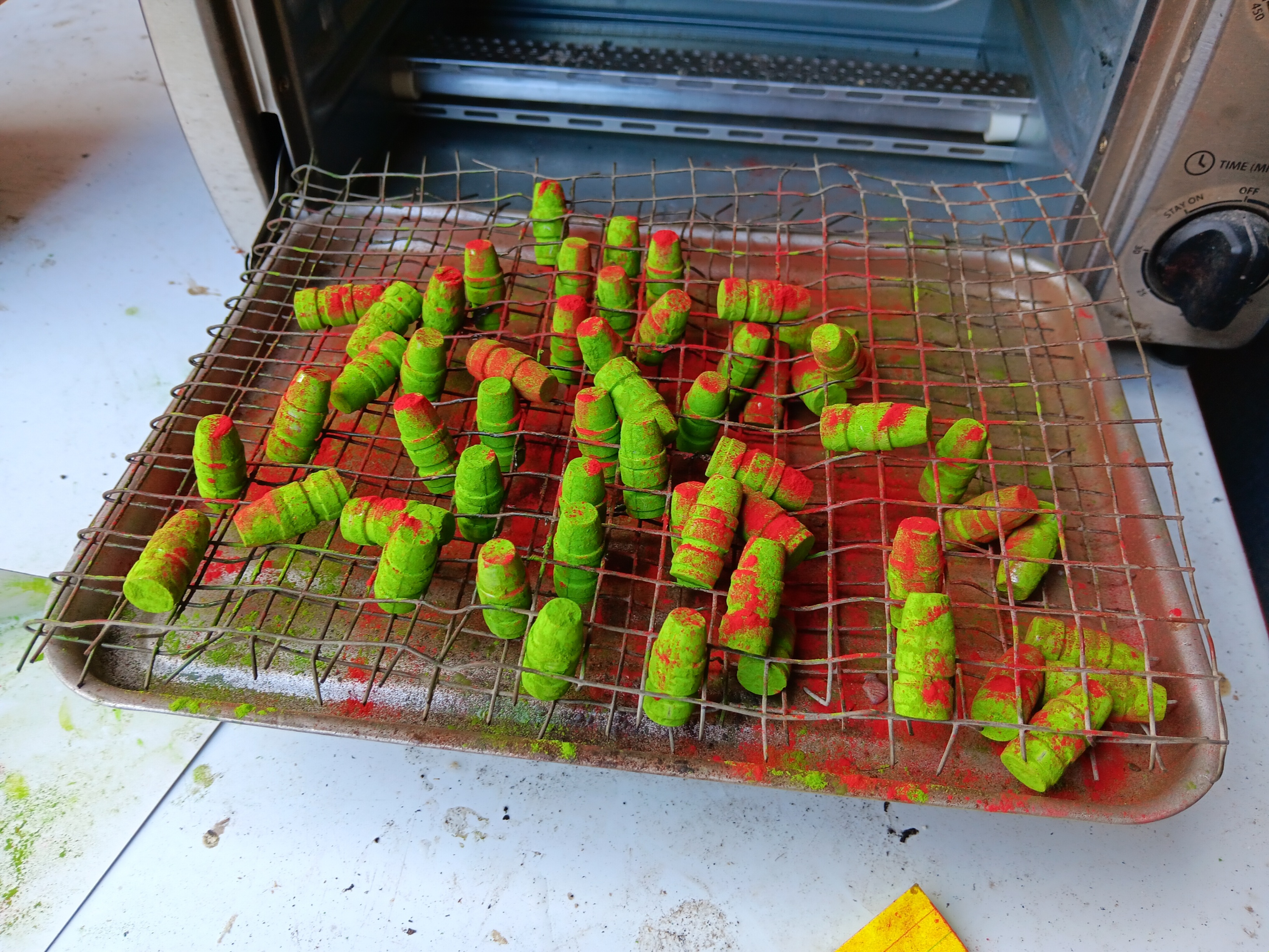

I did some powder coating this afternoon, I do the tumble method, I have a plastic one gallon container. Drop a 100 or so air-soft pellets in with a small amount of paint. I shake/swirl for a couple minutes to get the friction going then drop in a handful or so of bullets and do the same for another minute or so. Pour them on a pan and pick them up with some of hemostats, or as today these little tweezer things. Place them on the wire fence and place in oven for 20 minutes on 400°. Then pour out and do another batch.
Going in.
After they cool.
And the whole bunch.

interesting colors Randy. The green prior to baking reminds me of the Grinch. Happy shooting.
