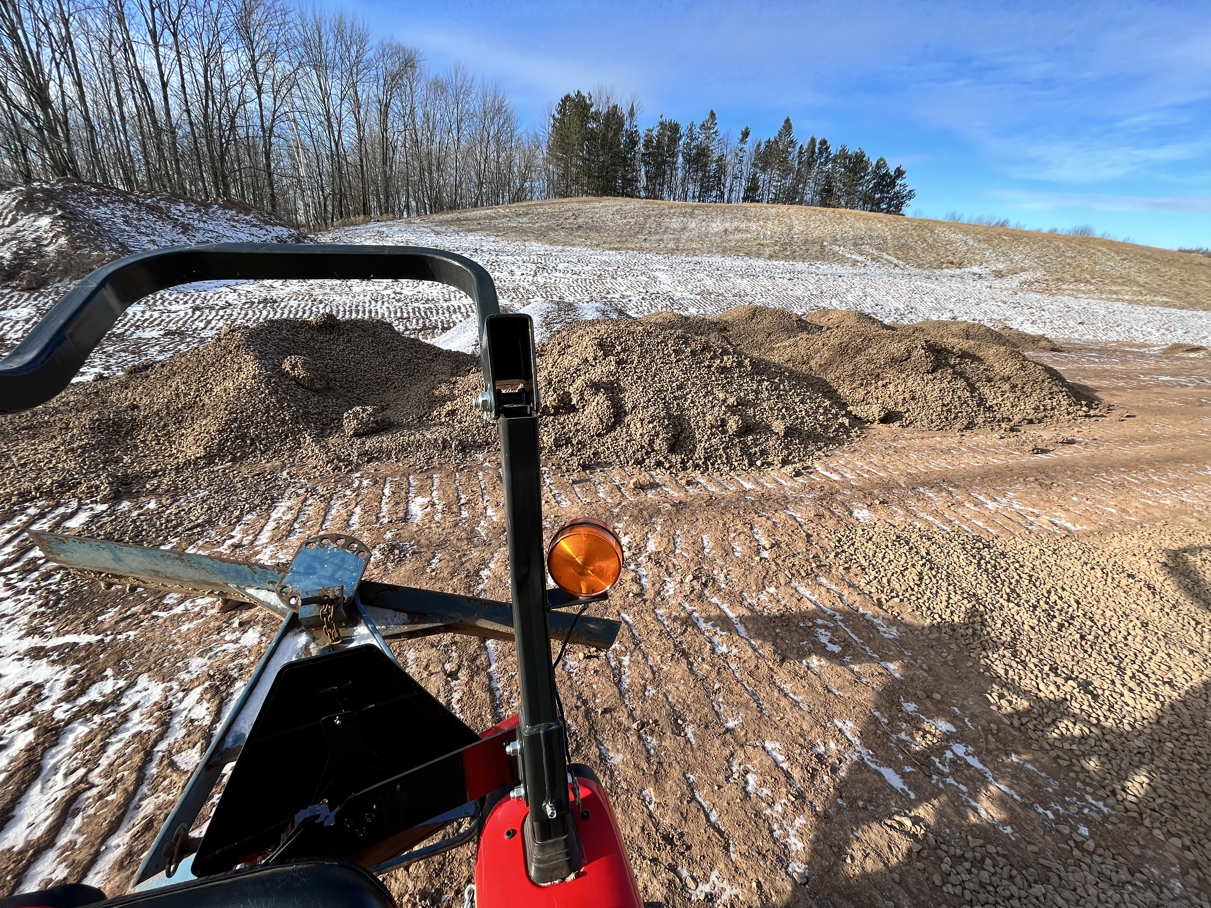

I did some work on the road today. The day started at sunrise because the ground is mushy when wet and not frozen.
I sat in the motor home for two hours waiting for the gravel.
The first 15 yards.
The second 15 yards. It was partially frozen and hard to grade.
Four hours of playing on the tractor and the 3/4” minus is spread.
The next loads will be 1” clear.

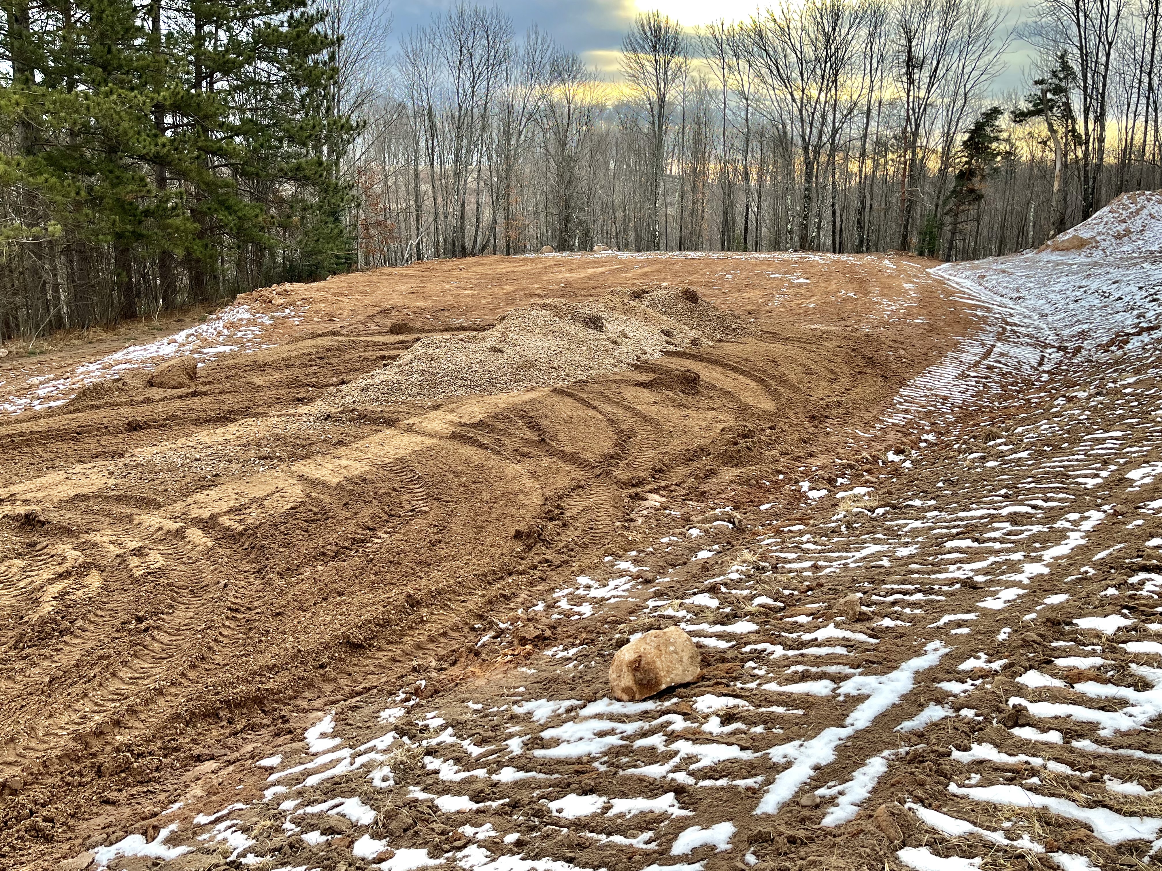

This is the first of three loads of 1” clear I’ll get delivered today.
It’s half frozen and comes out in big chunks that are like big rocks. They are very difficult to break up.

The work continues. Here is 5 of the 15 loads of 1” clear that I ordered. The metal garage is only 20% of t HD e cost of this project.

Sir Henry, do you know why this rock is called “clear”? It looks like what around here is called “river rock”.

Not Sir Henry but clear just means it doesn't have any fines, better for drainage although it won't compact as much as gravel with fines in it.

What Dave said.
