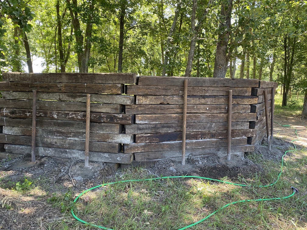

My initial investment to build MY range, not including the range house, was about $1,000 not including labor. BUT, I caught the RR ties on sale from the RR. Just under $8 each. Normally they are about $20 each at the box stores or Home Depot. I bought three 16 tie bundles, wish I had bought four to six.

BOM, I searched yesterday for your original post regarding your range build but couldn’t find it. I’ll look some more today but my question is this. I recall you used a very clever method to tie your RR ties together using rebar. Would you remind me how you did it? Even tho I have a safe backstop I would rather have a RR tie wall to collect the bullets and not have them damage live trees. My intent is mostly to shoot pistol caliber carbines and handguns but there will be the occasional bottle neck rifle cartridge fired, mostly .223 from a bolt or semi. I don’t own any big bore rifles anymore so no magnum rifle cartridges for me.
Hatch, I'll pull the pics and post them here in a few minutes, but I interlocked the legs with the back, and drilled down thru the two and drove an 18" rebar spike down thru both. Worked like a champ. Between the spike keeping them from moving and the weight of the Railroad ties, they were locked in. To brace against the great weight of the dirt to be piled in front of the wall, I put 10' steel posts behind the wall.

Post by BrokenolMarine » Thu Jul 27, 2023 11:42 am

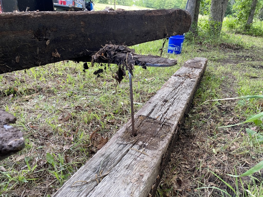

I cut the spikes at 36" squared, then cut them at 18" at a 45 degree angle to make them easier to drive in. Left some at 24" to anchor the base ties to the ground so they wouldn't slide or twist.
spikes cut 220521.jpg (741 KiB) Viewed 2631 times
I pre-drilled holes thru the Ties with a 1/2 drive hammer drill, and a LONG bit. Then used the forks to drive the spike in.
03 drive it.jpg (582.61 KiB) Viewed 2631 times

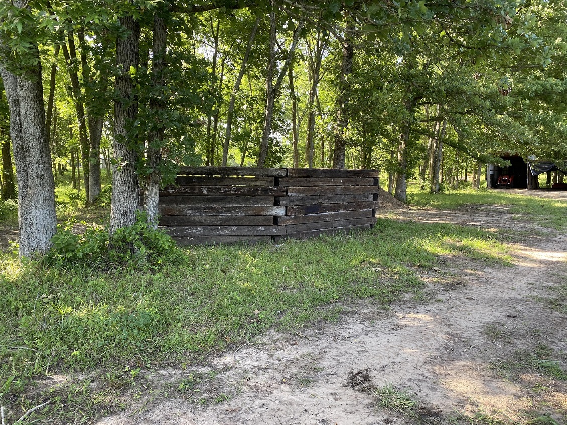

As I said, I had the legs on either side overlap the back of the wall, shifting the wall Ties left and right to interlock. As you can see here, it's like stacking lincoln logs as a kid.
still going UP.jpg (691.79 KiB) Viewed 2631 times
These are the posts in the back to support the extra weight / pressure of the dirt inside the U shape.

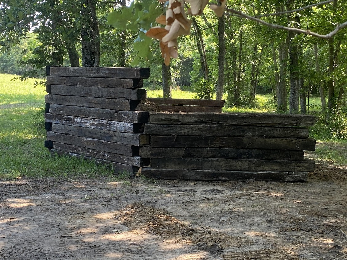

Toward the end, I had reached the end of the reach of the lift for the tractor, so we used some of the leftover ties to extend the legs of the U on either side, making them longer.
left 90 degree leg.jpg (574.31 KiB) Viewed 2631 times

Thanks BOM, that’s exactly what I was looking for in my failed search. I sent you a PM with some questions and do appreciate your help.

Thanks for taking the time to repost your pictures, it’s exactly what I was seeking. A couple of questions, did you drive the 18” rebar thru two ties and then into a third or thru one tie into a second? When you predrilled the holes I suspect that the top tie was drilled and the tie under it not drilled in order to anchor the top tie? I’m thinking with the 18” length you drilled thru two ties (7” each) and four inches of the rebar then driven into the tie below.
From BOM below.
My ties were about 9" thick, and covered in old creosote and years of dirt and gravel. Some weren't completely flat. Hence the gaps you see in the pictures.
I used an old machete to literally cut away layers of dirt and gravel where I could. A half inch hammer drill with a side handle was used to drill thru them. I drilled thru BOTH and the hole was the same size as the rebar. I wasn't worried about "nailing" the ties together, but pinning them so they couldn't slide or move. The weight of the ties kept them down.
