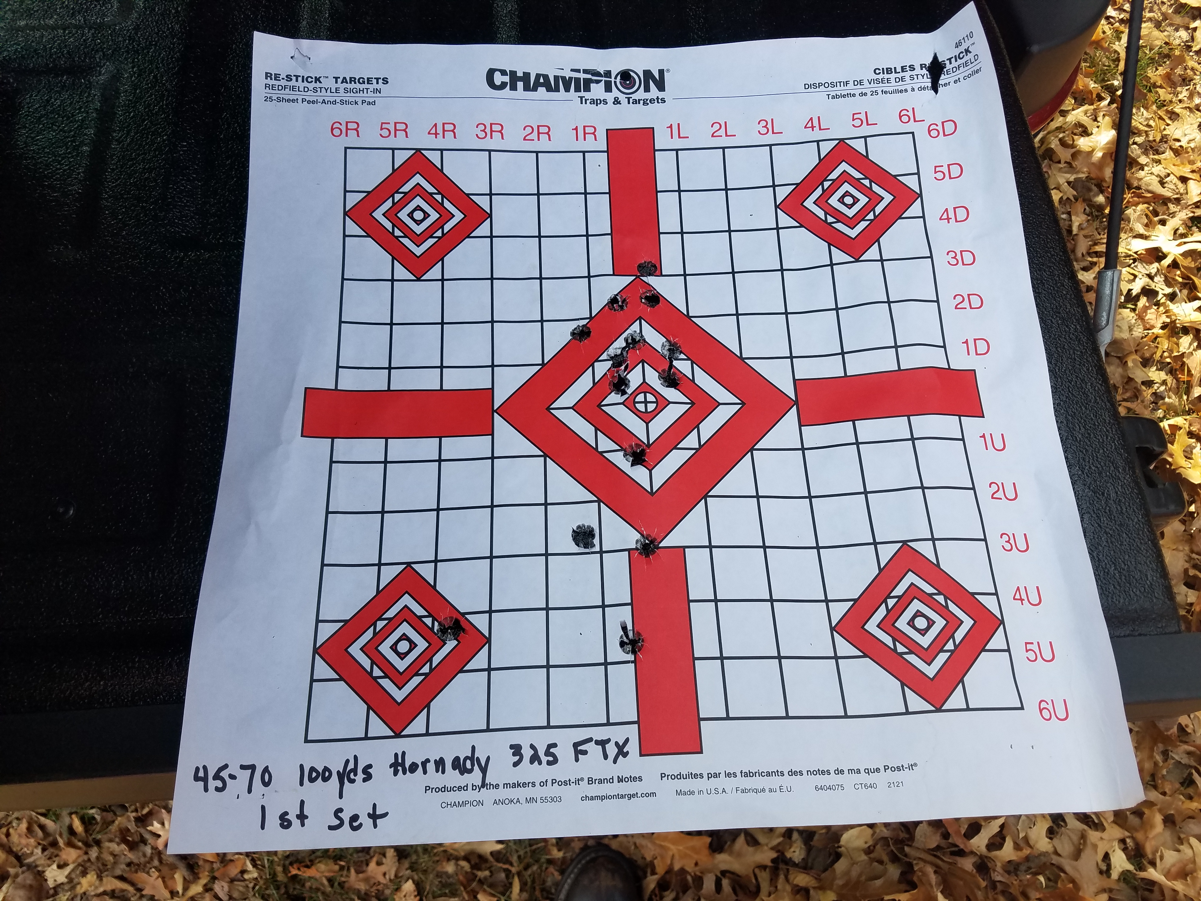

My H010 likes (but my shoulder doesn't) their 325 FTX loads. They seem to be hard to find in my area though. I think the 250gr would be fine too, see if you can find both and see what your rifle likes best. Here is my sight in target with a Leupold scope.
- Sight In Target 100 yds.jpg (3.88 MiB) Viewed 4209 times
