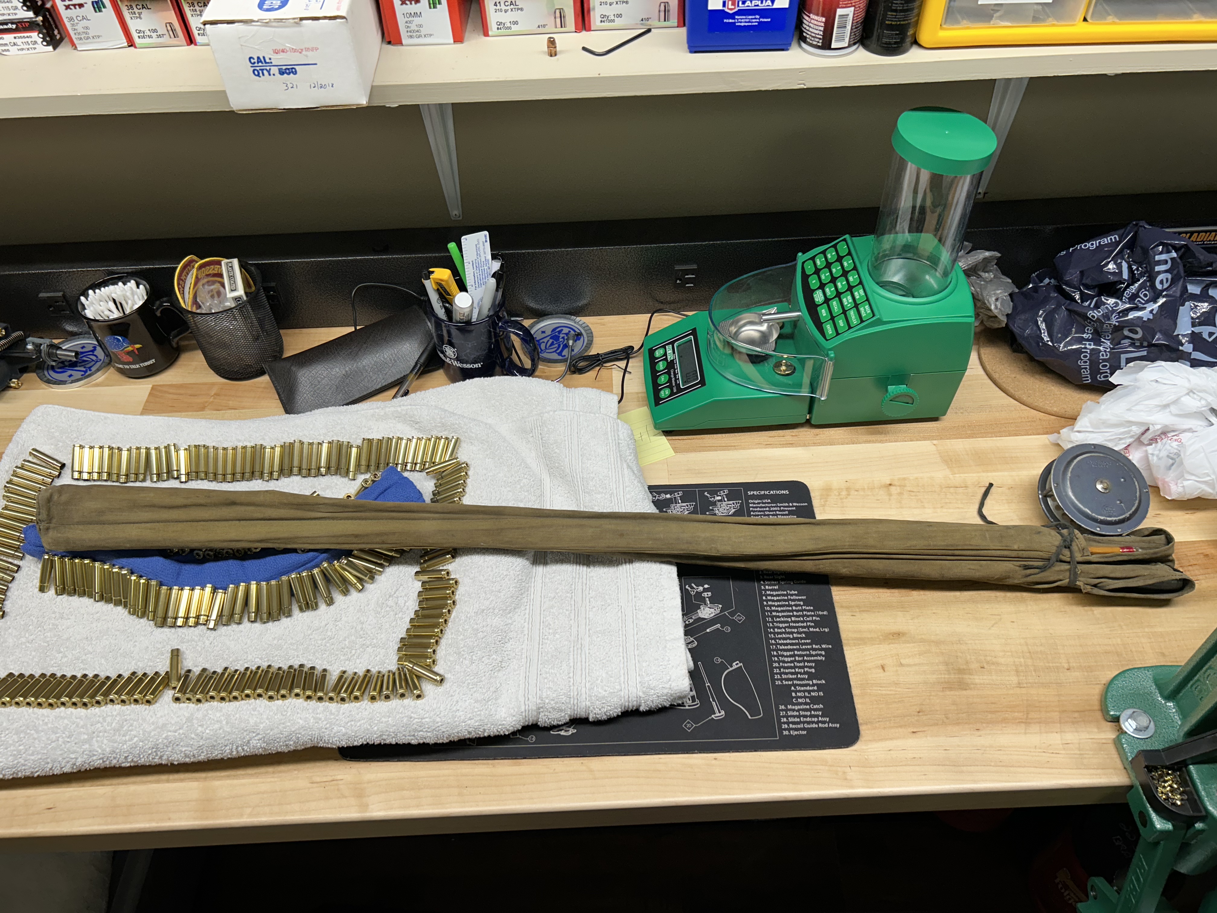

I too recently started using the RCBS Chargemaster and wonder why I didn’t many years ago. I’ve had excellent success with mine.
Yesterday I picked up a pound of 2400 from a guy I know who grabbed it from an out of town shop while traveling. Hit a store in Coeur d’alene Idaho and found the Hornady 308 155 bullet I’ve been looking for. Bullets were $42 with tax and Grafs sells this bullet in a 200 re-pack they do for $66 plus $13 shipping. Even with shipping it’s still cheaper than the Cda shop. For now just happy to have bullets and powder. Saturday is supposed to be a very ugly weather day so I may turn the components into assembled cartridges. Yippee.

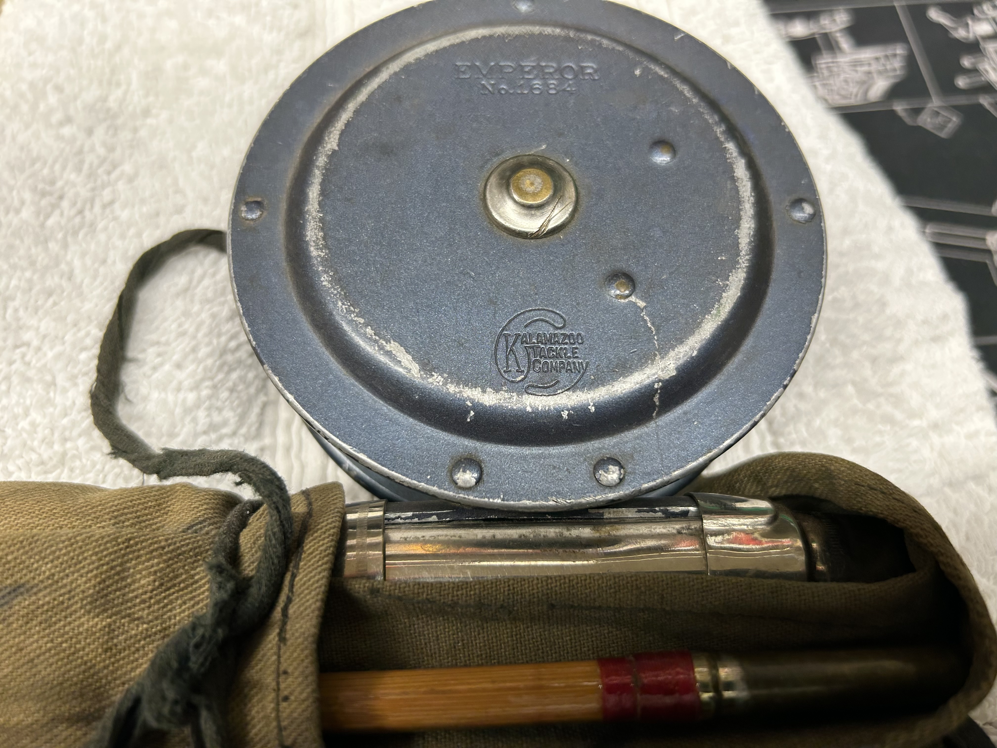

Hatch, what's the fly reel make?

I think that reel is for salmon slugs! Salmon season is only a few days away here. So. we have to load up! :D

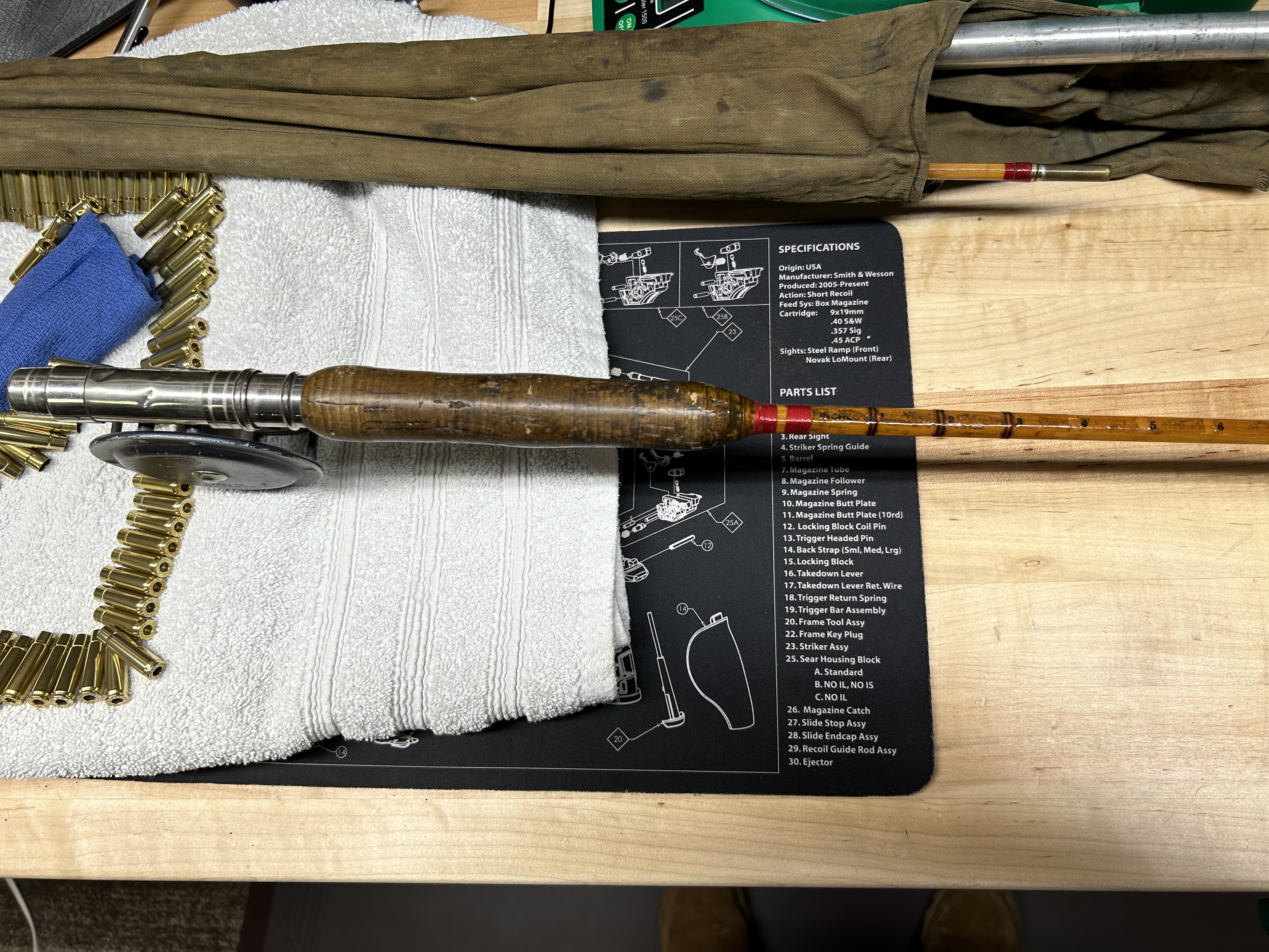

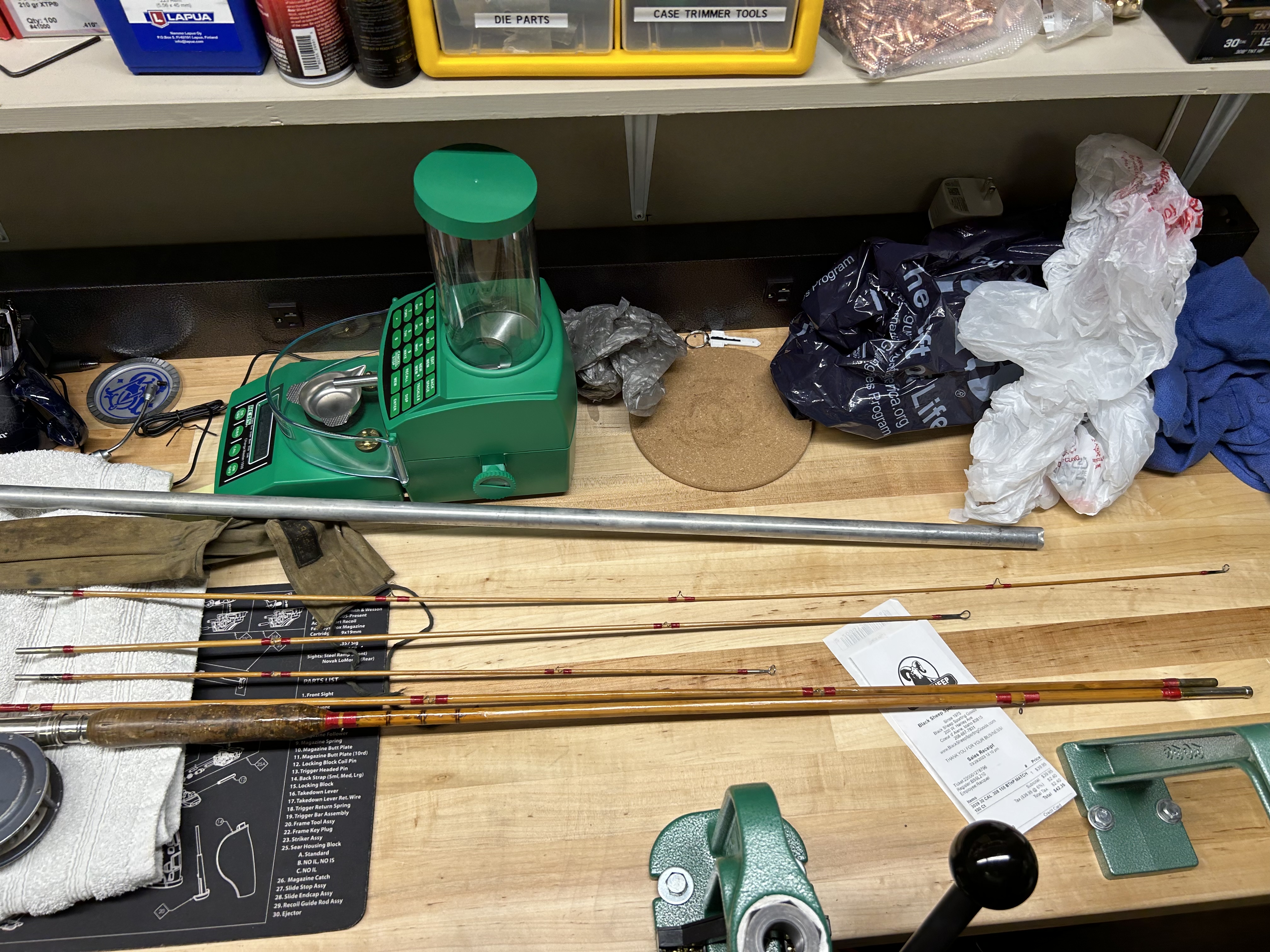

The reel is marked Kalamazoo Tackle Co and also is marked Emperor No. 1684. The rod is marked Craftsman Yellowstone. It’s a bamboo fly rod with three different length tips. The tips store in the metal tube you see and the entire set up stores in the cloth bag.
According to my Dad who I got it from it used to belong to my Great Grandma on my Grandma’s side of the family. This family immigrated from Ireland and settled in Montana. I understand my GG was a passionate fisher-person and used this rod. I’ve done a little light researching on it and there’s little info out there that I have found. For me it’s just decoration in my reloading room and usually sits in the corner of the room until I get it displayed on a wall. It was on the bench as I had the bug spray people in and I didn’t want it sprayed with the chemical.

Man, that parallels my Grandpa's fly rods. He used to import split bamboo from the Philippines and import the reels[Hardy's?] from England and custom make fly rods for doctors and such in the So-Cal area. Tie his own flies also. Like your rig, he had a metal tube for different tips and a cloth type for carrying. Sadly, I don't have one to have have as a keep sake. Did see one in a sporting goods store in the town of Bishop in the Eastern Sierra's. Display only and wasn't for sale. Beatiful work. At least you have one to admire. My Grandpa called them his "Andrew Fly Rods". Made 'em at the kitchen table.
