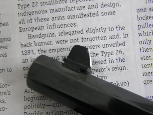

I added the Skinner front post to the rifle so I could lower the shot. Most of them before were an inch above point of aim.

Interesting that you added the Skinner front post to lower the shot. Only had to adjust the receiver peep on mine 180* up to bring in good elevation. But certain that the SGCs are not created as identical twins!

The front post versus the round front sight:
The post makes me a wider, easier to see top edge of the front sight which is supposed to be my aim point. With the stock Henry sight I could not get any of those rounds listed at and below the aim point, most were about an inch hiigh. The Henry sight measure .460 inch high, the Skinner is .500 inch high. Where you see the rounds hitting I could not get that low with the stock sight.
