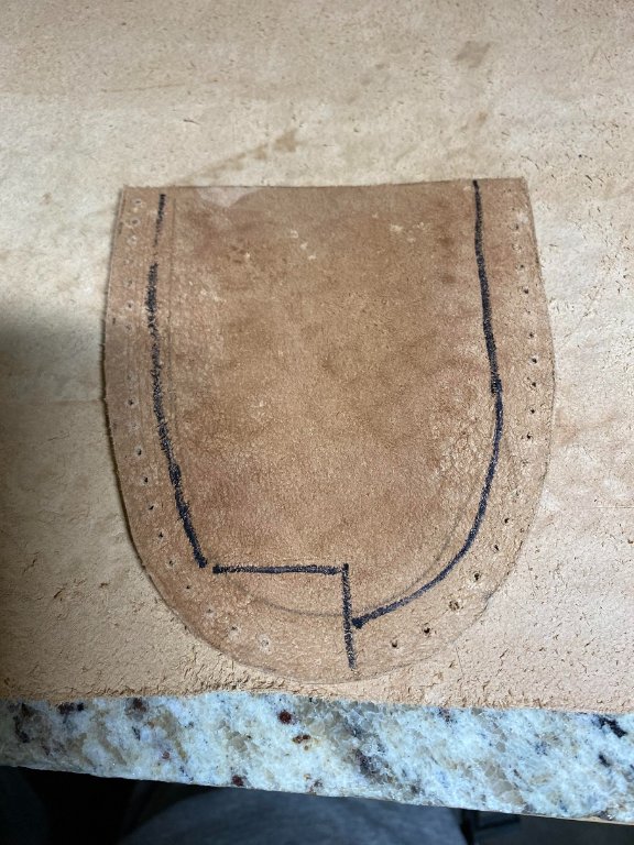

Using the welt itself, I drew the boundries for contact cement, on the off side, I just left off the extra area.
- 05 contact boundries.jpg (118.36 KiB) Viewed 2958 times
