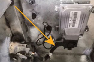

Re: Elio Type Vehicle Resurection --- AKA the BEX
Per Mark BEX .....
Ughhh, my least favorite area of any vehicle, wiring.
Have the engine computer mounted and plugged in, lower picture.
- 220315 001 wire 1 001.jpg (41.06 KiB) Viewed 1866 times

I spent all morning carefully going through the wiring loom, trying to figure what was missing or not plugged in, searching the internet for wiring diagrams and going through them, NOTHING, AGHH!
All darn morning. Then I saw it ... remember I cut 2 holes for the gearchange cables a few days ago, well the wiring loom for the engine computer was in the way of the drill, so I had unplugged it, picture below, and forgotten to plug it back in ... Some days you should just stay in bed ...
Afternoon was concentrating on clearing out the factory for the incoming goods tomorrow afternoon (some of my old projects in another factory I mentioned). Was overdue for a clean anyway. Must admit to some mild excitement seeing some of the old toys coming.
- 220331 001 wiring loom plug 001.jpg (14.97 KiB) Viewed 1899 times
