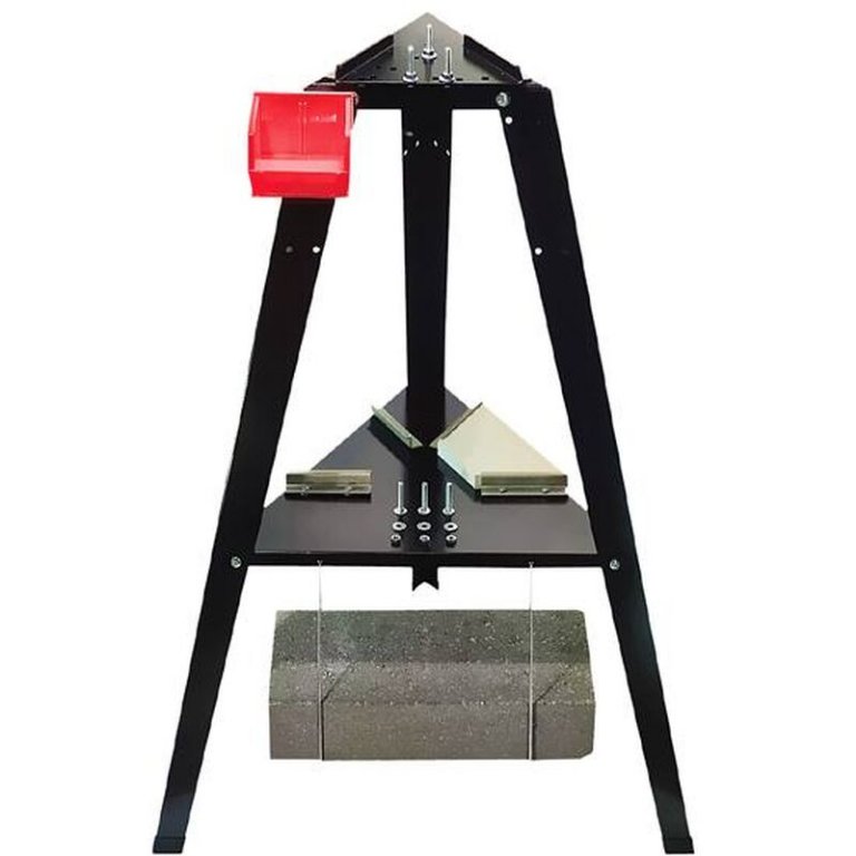

Lee has a tripod style portable press stand and that would probably work better but the bottom line is a press needs to be securely mounted with little to no movement.
That Lee tripod you mentioned, I believe that is what RR uses. Seems to work fine. Maybe RR will post a picture of it.

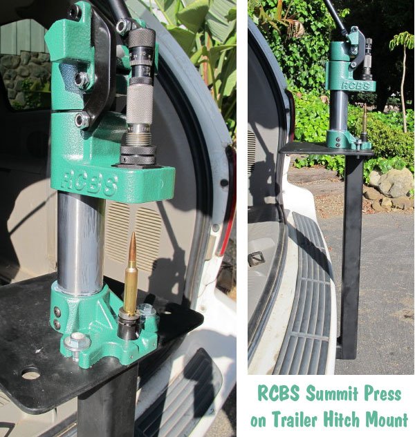

Post by Mistered » Sat Dec 21, 2019 2:20 pm
Here is what I am envisioning but maybe not this tall.
Posts: 4014
Re: New RCBS Single Stage Reloading Press
Post by Rifletom » Sat Dec 21, 2019 2:45 pm
Man, that thing looks robust!^^^
Yeah, that tripod deal is what RR uses, I believe.
I really like the concept .... do agree with it being shorter, I'd want to be able to use it while seated in a camping chair .... a loose fit between the receiver and the shaft inserted will introduce play that may or may not prove to be worrisome .... the longer the upward shaft, the more noticeable the play will be .... I would also want the plate to be removable and designed to accommodate a powder measure as well ....
thanks for posting the picture, its planted a bunch of seeds .... 8-)

Mistered
Post by Mistered » Sat Dec 21, 2019 4:03 pm
The more I think about it the less of a problem it will be.
The effort of the press will be forward and DOWN and the receiver tube will 'cant' forward and movement will most likely be negligible.
I may go 'experiment' with this and report on it later.

Mistered
Post by Mistered » Sat Dec 21, 2019 6:41 pm
looking forward to hearing what your find
I did a little 'mockup' with some receiver tube.
Conclusion is no problems and the little bit of side to side movement will never be noticed unless you actually moved the press side to side.
Using the press normally it will be nearly as solid as mounted on a bench.
