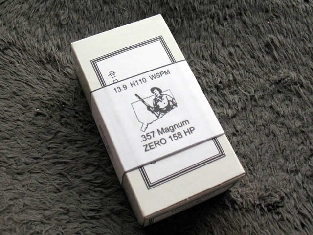

My preference is for a light load since my only shooting is at paper. I wanted a single load that would work well in both, my .357 BBB and my SAA revolver. After a bit of experimenting, I settled on 13.9 grains of H110 under ZERO 158 grain JSP/JHP bullets. It's at the lower end of the start/max range for the revolver and in the middle for the rifle.

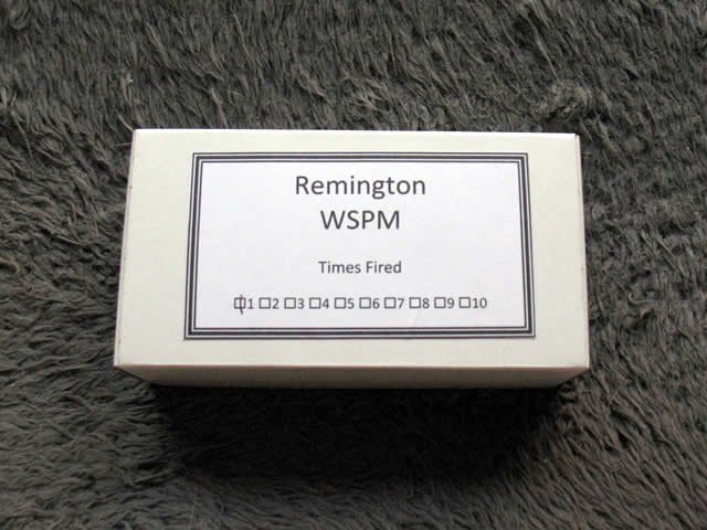

CT, I sure like that packaging you have there. You make that yourself? Nice and neat.

Thanks, Tom.
I print the labels myself just to keep myself organized. I only reload .357s (and occasionally .38s) and currently have twenty-five boxes of primed .357 brass in 50 round boxes marked with the number of times each box has been fired. I prime the brass as part of my cleaning/prep process so that reloading goes very quickly on my single-stage press; just add powder, a bullet, and crimp. Once a box is reloaded, I print a label, in the form of a cigar ring, identifying the powder charge and the bullet used. I bought the white boxes from Midway USA when I first started reloading.

Thanks CT, looks like what I am after, specific loads for rifle vs pistol. I like your ammo boxes and packaging, looks outstanding !CT_Shooter wrote: ↑Tue Nov 12, 2019 9:39 amMy preference is for a light load since my only shooting is at paper. I wanted a single load that would work well in both, my .357 BBB and my SAA revolver. After a bit of experimenting, I settled on 13.9 grains of H110 under ZERO 158 grain JSP/JHP bullets. It's at the lower end of the start/max range for the revolver and in the middle for the rifle.
