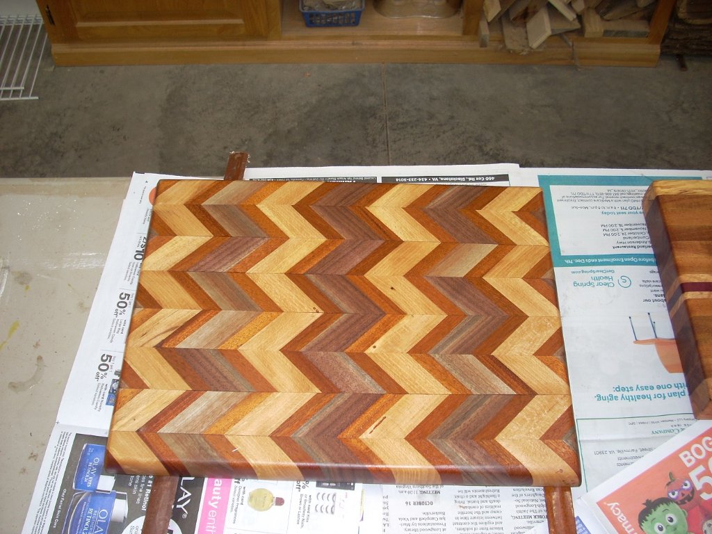

They are all good looking but I am really drawn to the chevrons.

I like them all, but the chevron is the best design.

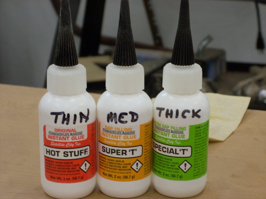

The CA glue order came in, the mini feet, and a trip to Lowes provided the replinished stock for the sandpaper. Should be back at it tomorrow. Company coming this afternoon. A day off.

Tina had to run some morning errands, and my Company isn't due until 2:30 so, I hit it for a couple hours, attacking the filling of wormholes, and stabilizing a few knots. Pics later. Got a couple passes in on each board, now they are all curing.

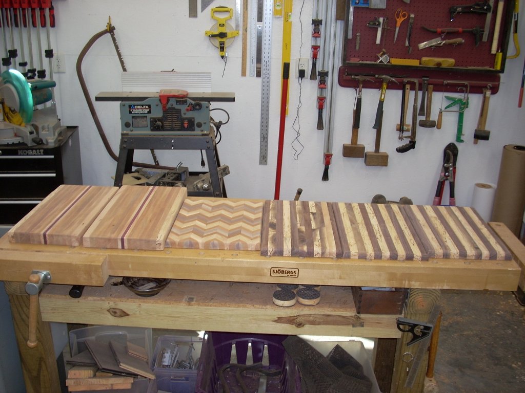

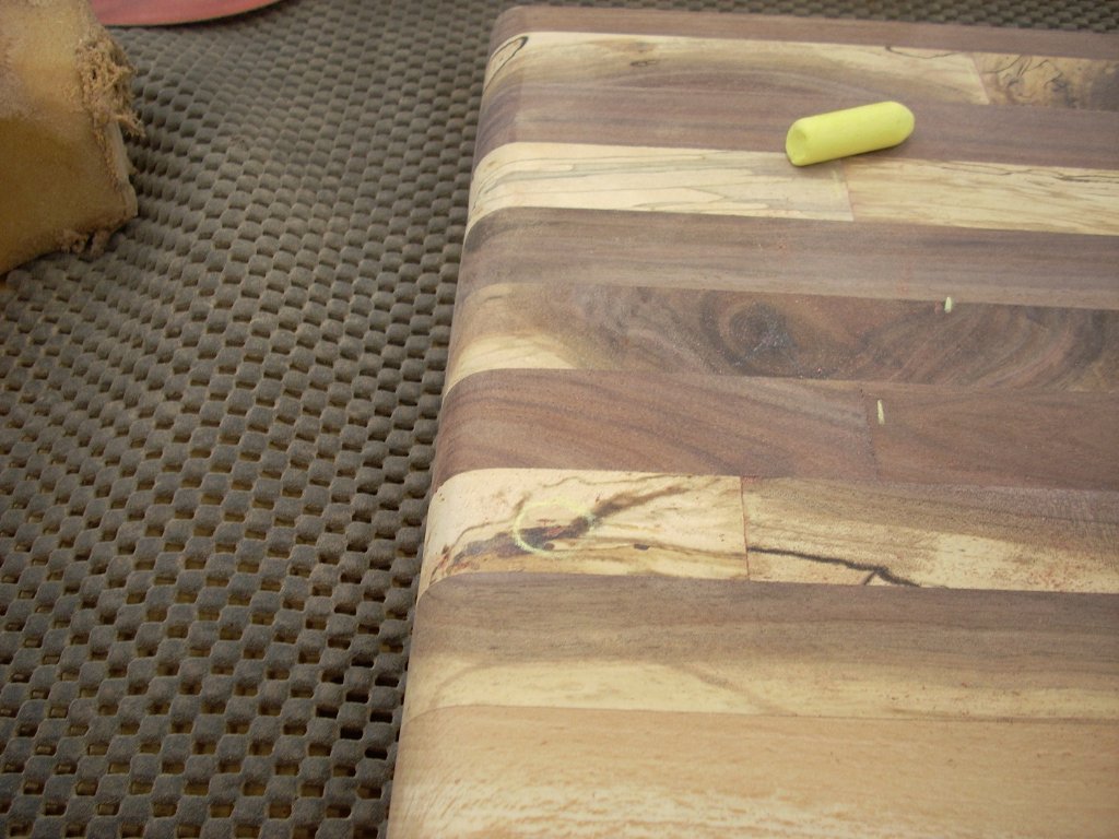

A few days more work done, and PICS!
I have been working away at all six boards, and before I started on them again this last few days, they wanted to line up for a group shot.

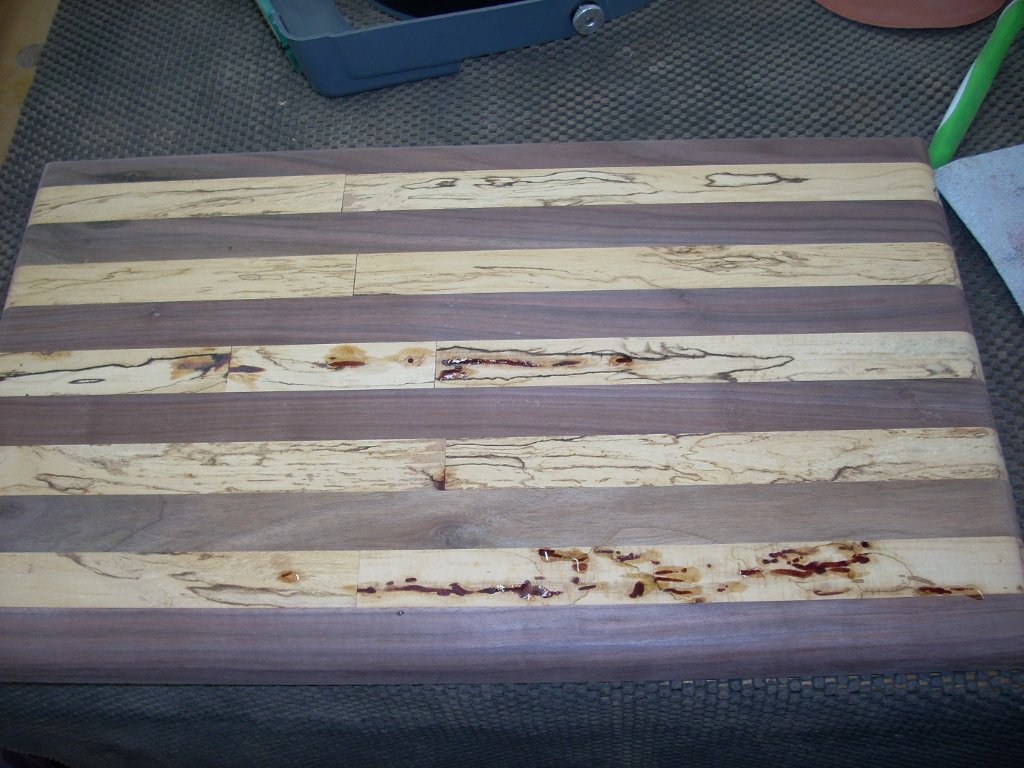

They were looking good so far, but they were only going to improve. More sanding and some infill for the minor defects that ... well only I might notice, but would allow food particles (if they were actually to get used) or water or cleaning products if they get dusted, to get down into the wood. Mostly I am talking about worm holes and chips. I start the infill by taking a scrap offcut, isolating the purple heart and rubbing it against some 60 grit sandpaper to create purple heart dust. I use this to fill the defects. Then I coat them with the CA glue of appropriate thickness.
After the glue has dried you have the first layer of the repair, and it needs to be sanded away, leaving only the repair area with any evidence you visited. The discoloration "around" the repair is no longer visible. You repeat the process again, and again, and again... until you are flush.
After three days, the Honor Boards, are done. (Boards one and two) and the Chevron Board is also ready for the finish to be applied. So they are wiped down with the first coat of mineral oil and left to soak for five minutes or so, then the residual oil is wiped away and I will allow them to dry for several hours and may apply a second coat tonight or wait until tomorrow. The feet will be applied AFTER they are waxed.
The other three are still receiving infill treatment, especially Miss Tina's, she says she will use hers a lot. If she uses it UP she knows the guy who made it and she'll have him make her another one.

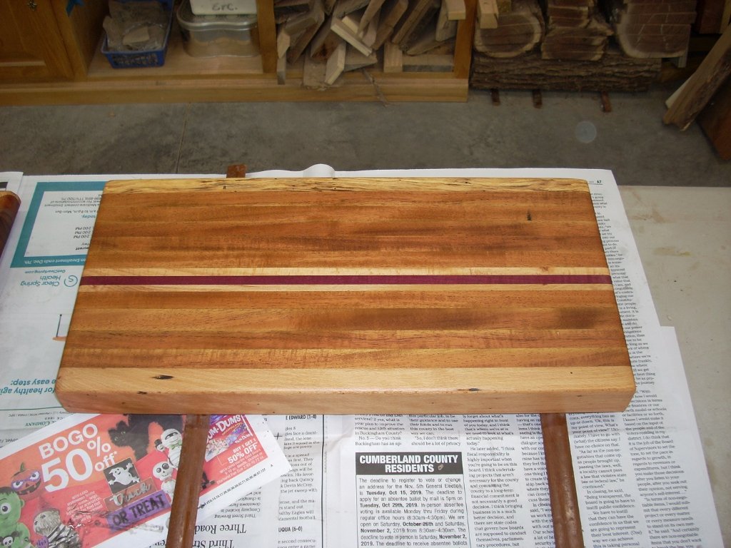

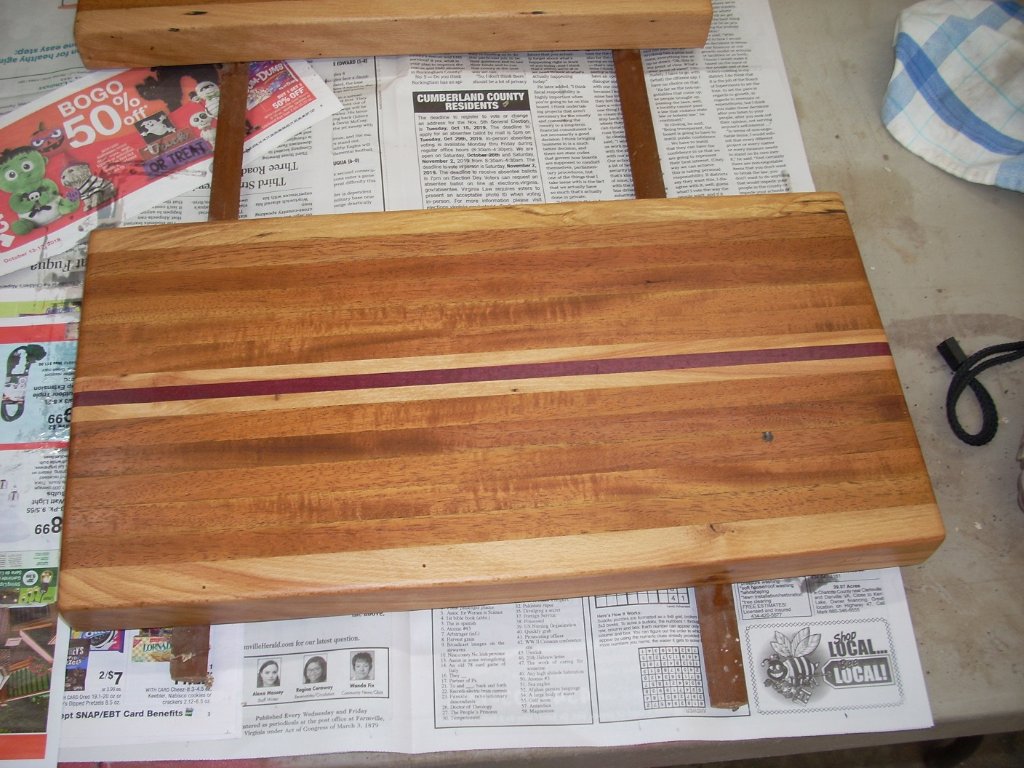

I finally got back in the shop after my visit to see my surgeon on the 11th. Short stays, an hour at most. Two new cutting boards on the bench. A day or two break at times between sessions. But, these ought to turn out nice. I try to apply lessons learned in every project to the next build.
So, more pre glue up prep for these.
