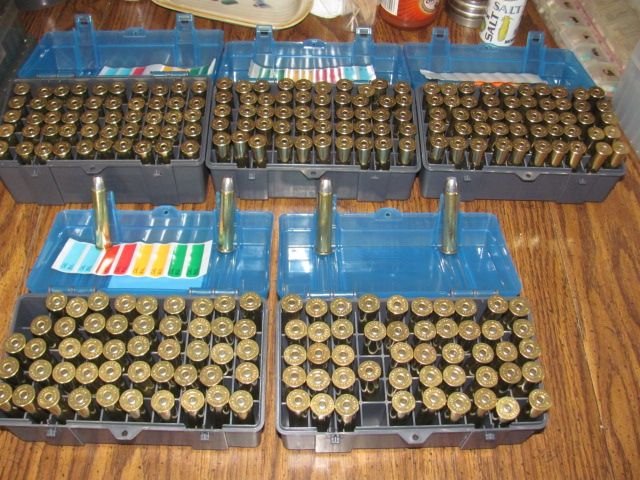

good to hear you are able to generate that level of speed without leading issues .... I tried some Missouri Bullet Company bullets in our 45-70 and they performed OK .... if I hadn't made a decision to go with jacketed bullets in all of our rifles and revolvers, I'd probably still be using them

here's a picture of 250 of them that we loaded and fired back in late 2016
160903 004 45-70 Practice 001.jpg (102.12 KiB) Viewed 2318 times
