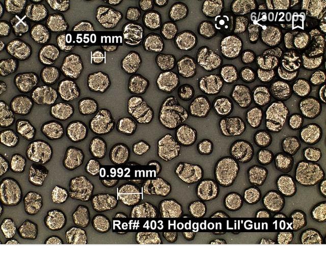

Hodgdon Lil Gun...

The following load data comes from the book "Reloading for Handgunners" by Patrick Sweeney.... note the loads using the 265 grain bullets and Lil Gun.

I'm pretty sure that load could be easily duplicated with 4100 though...

Underwood tested the velocity of their 41 ammo in a 6.5 inch Ruger...I asked them about that a while back.
Powder as slow as Lil Gun is needs a gas check on lead...4100, being a little faster burning, will likely behave better with plain base lead.

You guys might want to do a search on the use of LilGun in revolvers. It burns very hot. Lots of talk about forcing cone erosion along with other issues I have some but dont use it much and wont use it in my FA

This is true... well documented.

I haven't used Lil Gun either, but I researched it quite a bit when I first got the 41 Blackhawk...I had a pound of 296 but was looking for something less of a flamethrower.
I ended up with 4100 and have been satisfied with it...got a pound to test it, I now have 6 pounds of it.
