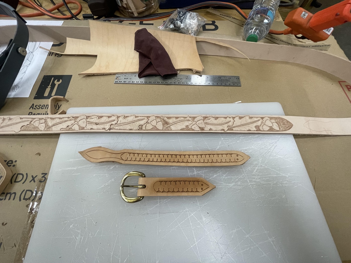

Back out this afternoon after Miss T got home with lunch. I spent some time on the belt working on the details, then worked on the buckle attachment and the strap that will have the holes in it. I'm sure those parts have names... but I don't know them. (Yet.)
After I cut them out... I (Of course) had to add some details. I went with the serpentine pattern since the straps were too narrow for much else. When I do the cartridge belt, I think I'll go with a barbed wire pattern. (Ever notice some folks think the wire was named after a guy named Bob?)

I have to drill / punch holes for the buckle attachment chicago screws, and the holes where the buckle bar will go in that strap. I need to burnish ALL the edges after I have decided on stain, or natural oil... then after everything has had it's first coat, sew it all together. I also need to make two retention loops. One for the belt to slide into, then one for the buckle strap to slide into. All fun.

I'm thinking natural will be good too Mags. I'll burnish the sides next, I drilled the holes for the Chicago screws and it looks pretty good. Getting closer...

After some last trimming and neatening, I beveled the edges that required it, then applied coats of Watco Oil in the Natural color. I left the parts and pieces to dry overnight. Looking forward to seeing the color in the morning.
In the morning I get to burnish all the edges and actually start the assembly, which includes forming those belt loops and sewing on the billets. We are really close now.

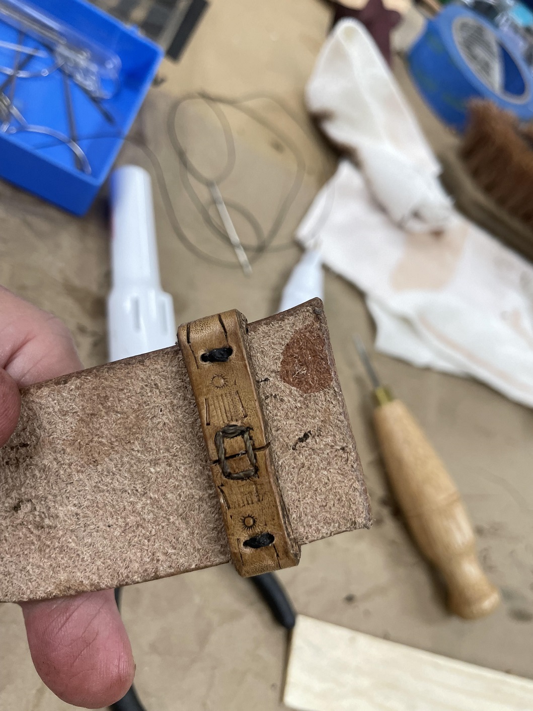

After laying out the stitching, I took the buckle billet to the bench top drill press and drilled the holes for sewing.
Before sewing on the buckle end, I decided I needed to sew on the belt loop so I drilled the holes in the loop and in the matching locations in the belt.
I sewed the loop into position with a couple heavy stitches on each side.
A couple tricks to make sewing the buckle assembly one, work well for all hand sewing. Since the holes are hard to see on the back of the leather... I take a sharpened pencil and spin it in both sides of the holes once they are drilled/punched into the leather. This accomplishes two things. It "countersinks the holes a bit, pushing down the leather so it's not puffed out. On the back side the pencil leaves a graphite ring around the hole marking it so it's easily seen for stitching.
Another trick is using positioning pins to hold the parts in place.
You can see in the picture below with the piece clamped in the Stitching pony, the positioning pins hold the buckle assembly against the belt. Once you sew to the pin, you remove it and continue to sew.
I got the buckle sewn on here and it looks good.
