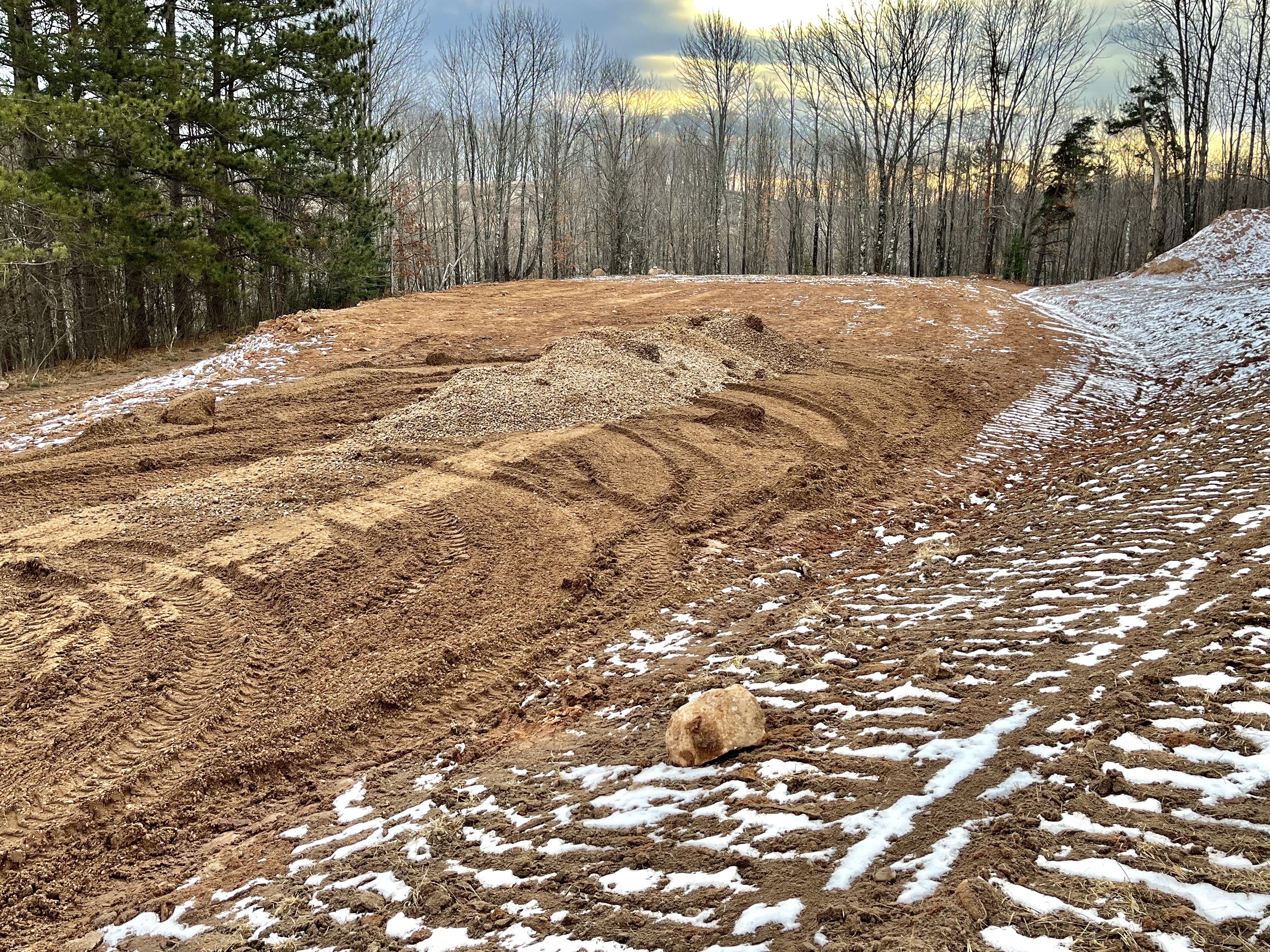

Post by Sir Henry » Wed Dec 13, 2023 4:41 pm
I just walked up the hill and think it’s frozen enough to get a truck up it. I’ll have two loads of 15 yards each of 3/4” minus delivered. Once the driveway is graved I should be able to get a truck up it even when thawed and wet.
I can’t believe I can still work on this when it’s this late in the year.

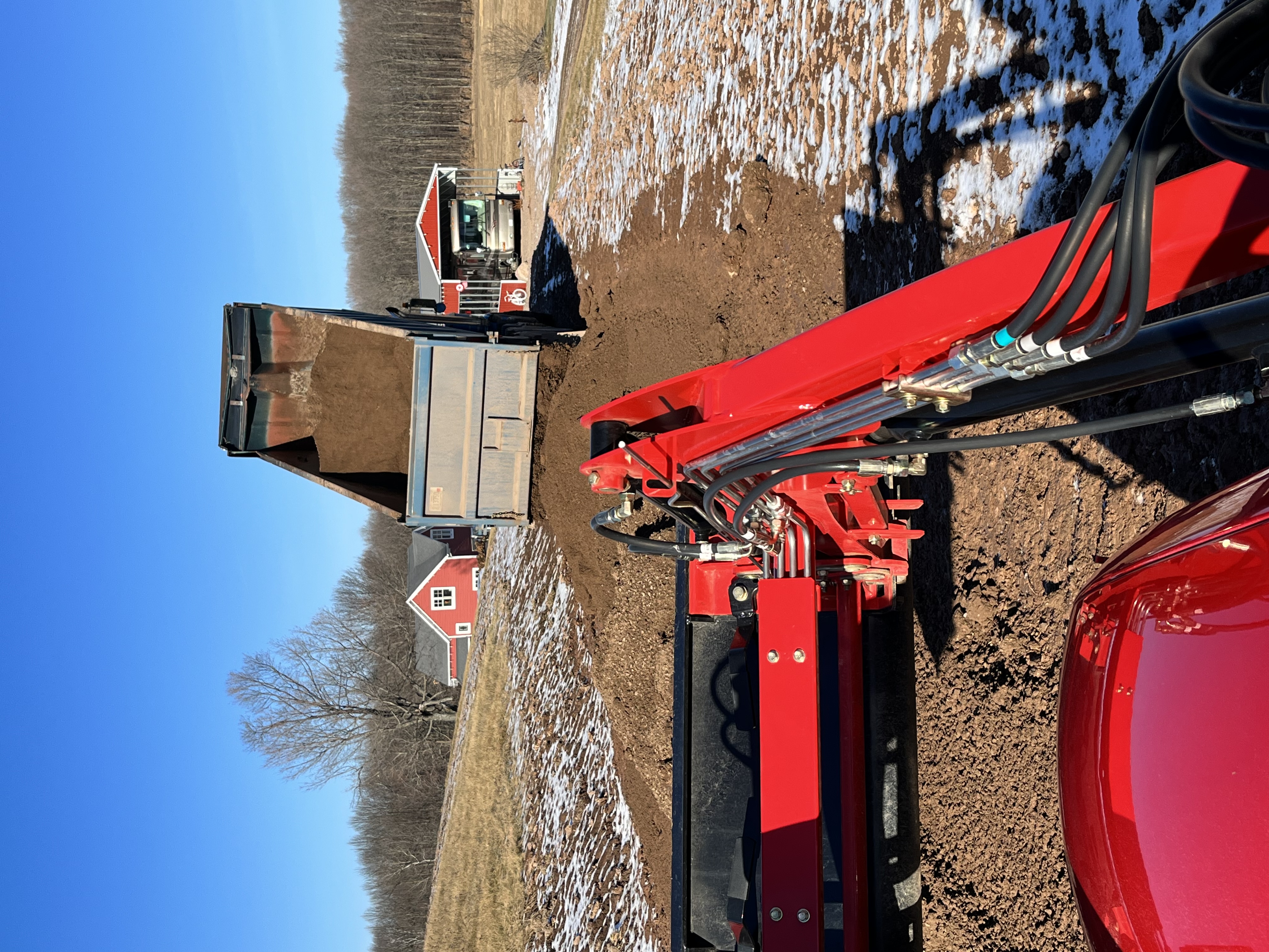

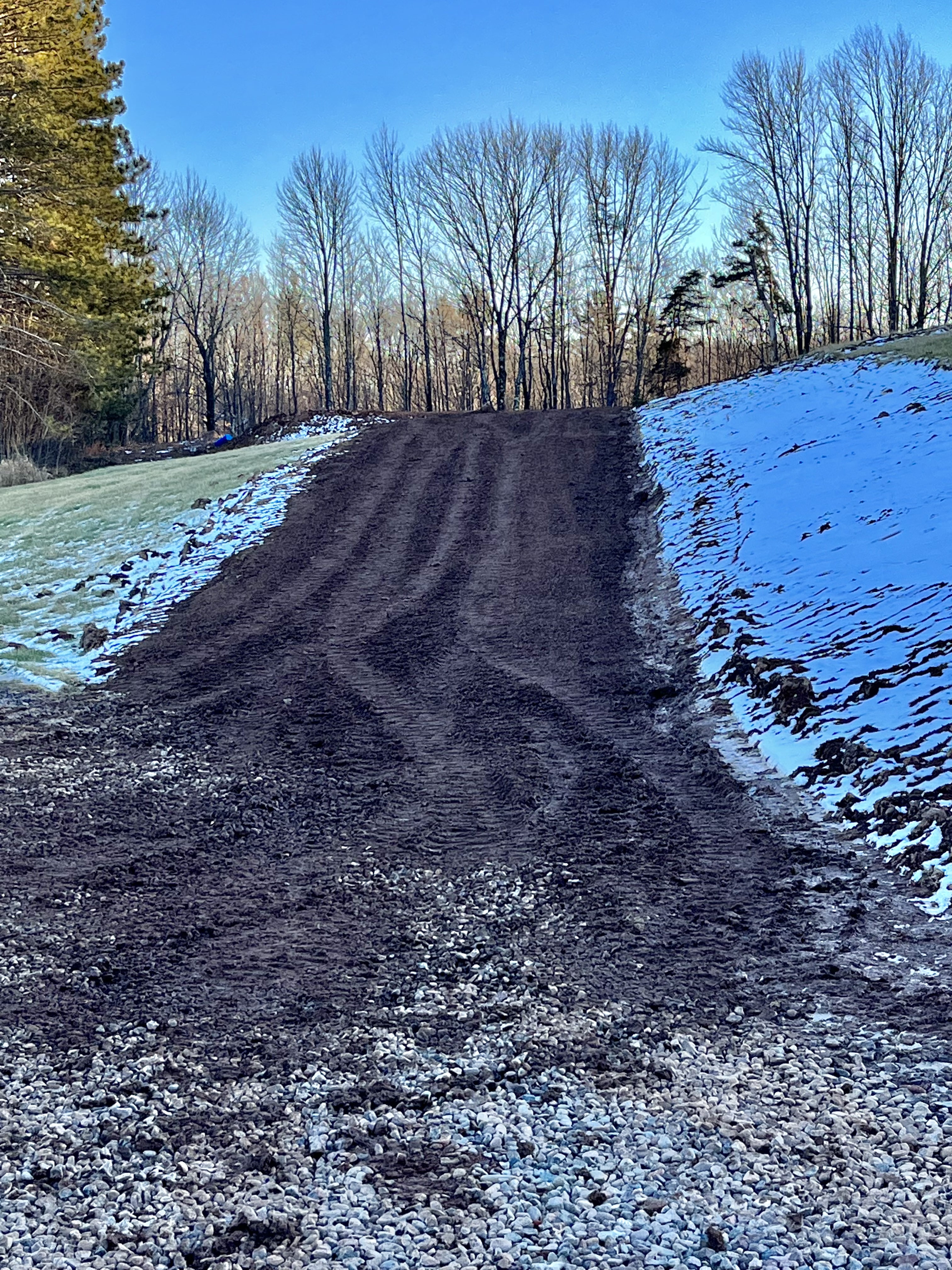

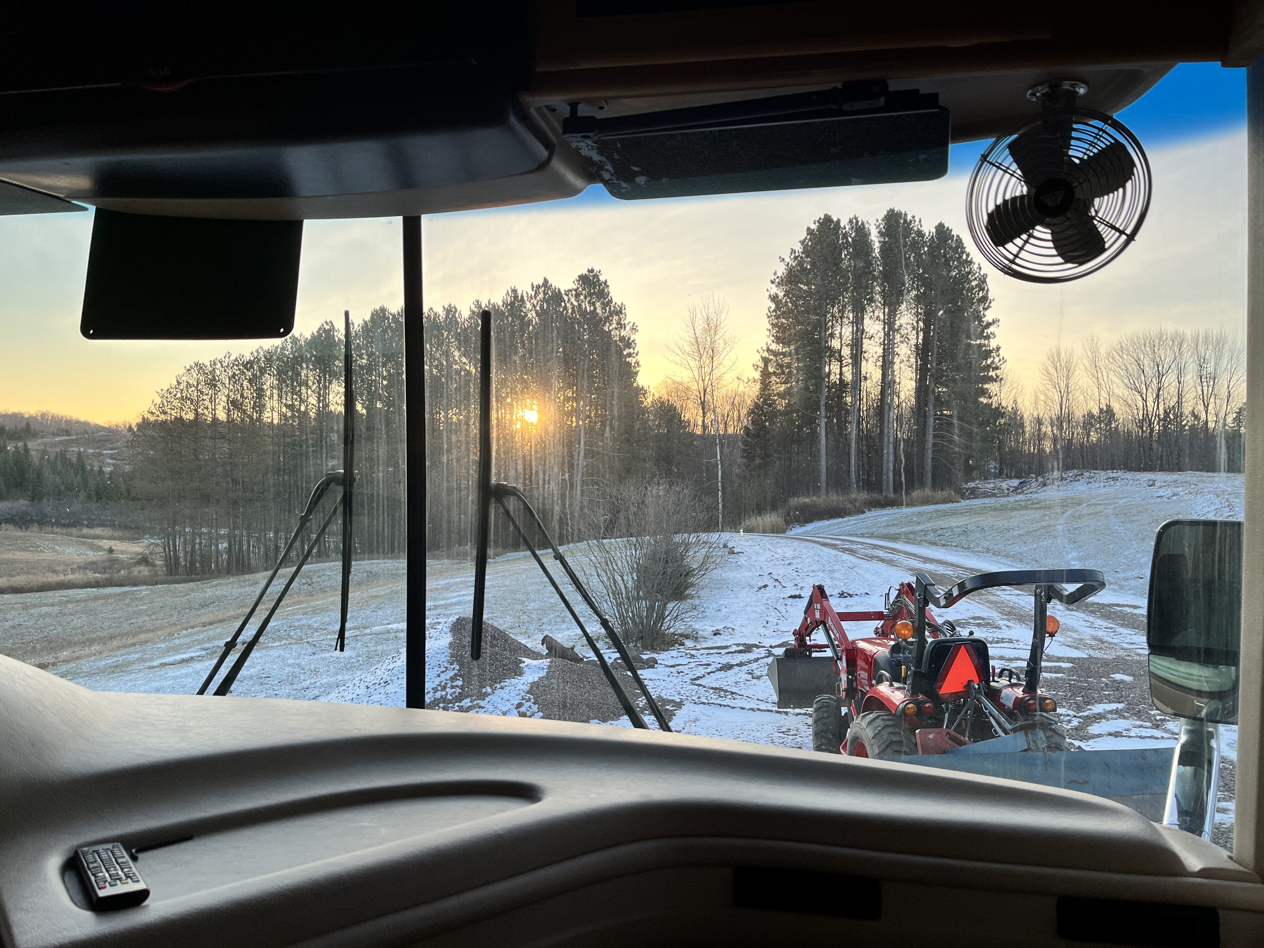

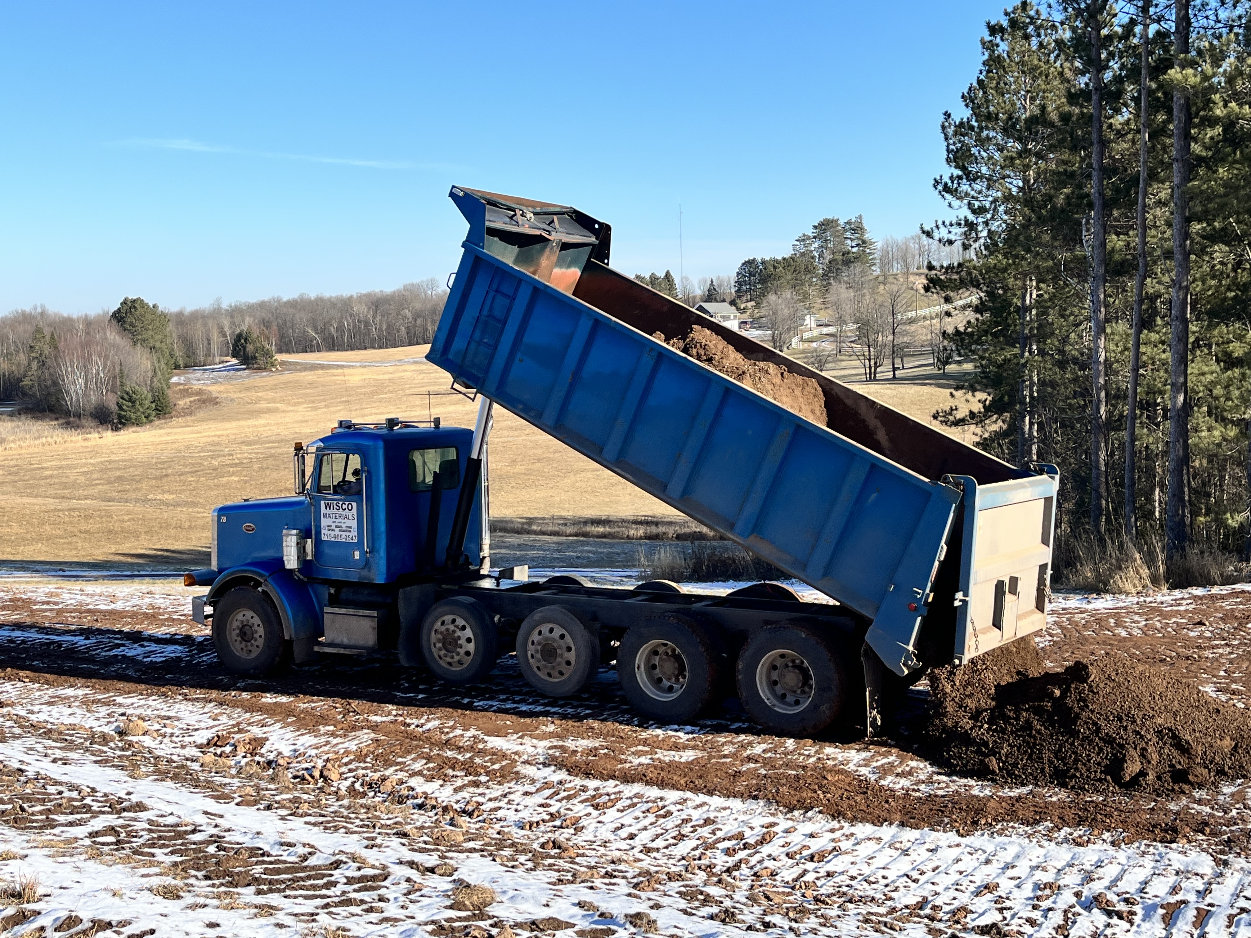

I did some work on the road today. The day started at sunrise because the ground is mushy when wet and not frozen.
I sat in the motor home for two hours waiting for the gravel.
The first 15 yards.
The second 15 yards. It was partially frozen and hard to grade.
Four hours of playing on the tractor and the 3/4” minus is spread.

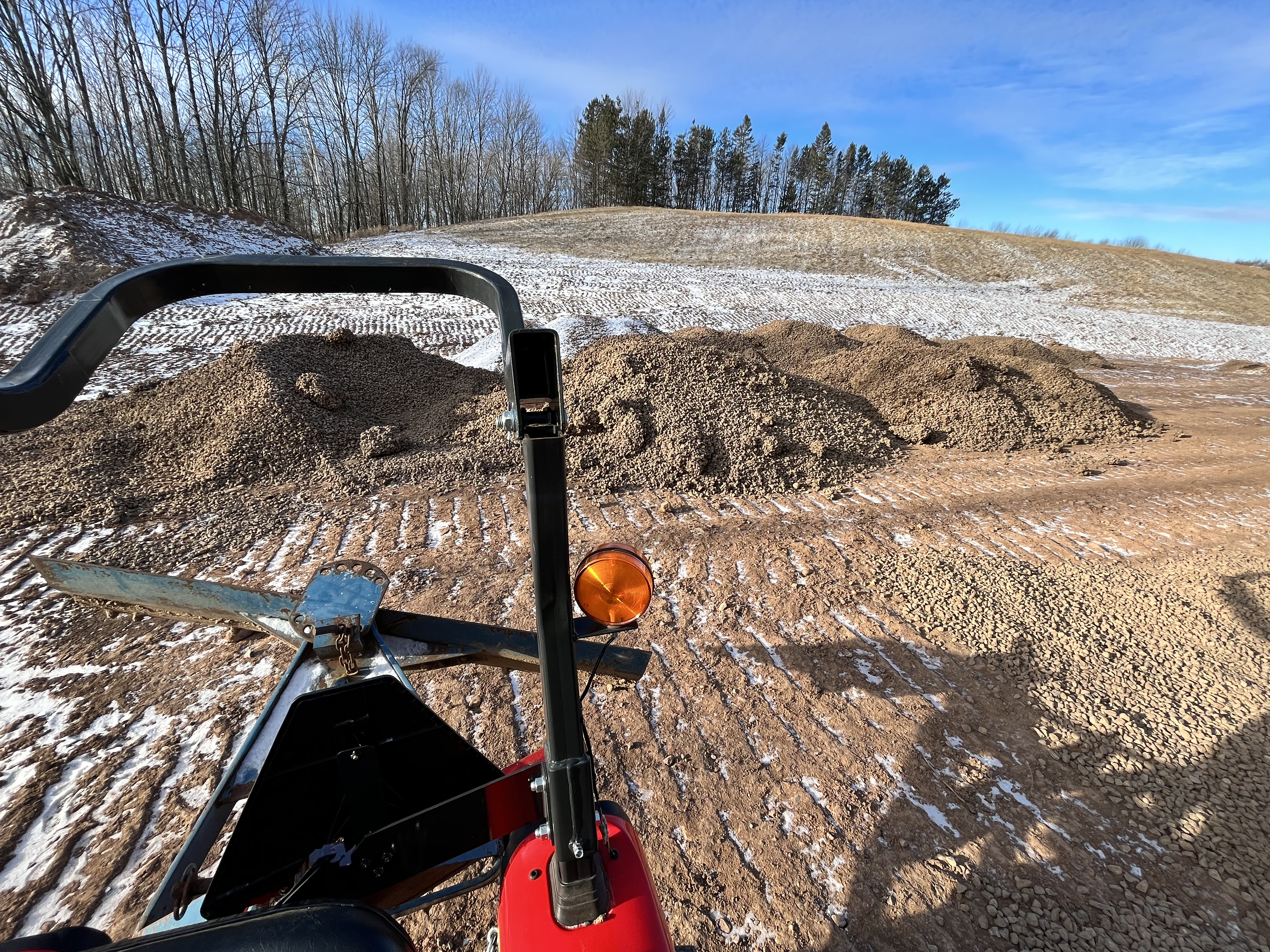

Post by Sir Henry » Fri Dec 15, 2023 10:01 am
Thu Dec 14, 2023 5:01 pm
Looking good Gene. The more you get done now before it's all covered and frozen, the more fun you'll have come spring.
I’ve accomplished far more this year than I thought possible. And with the good weather I’m starting on next spring’s projects.

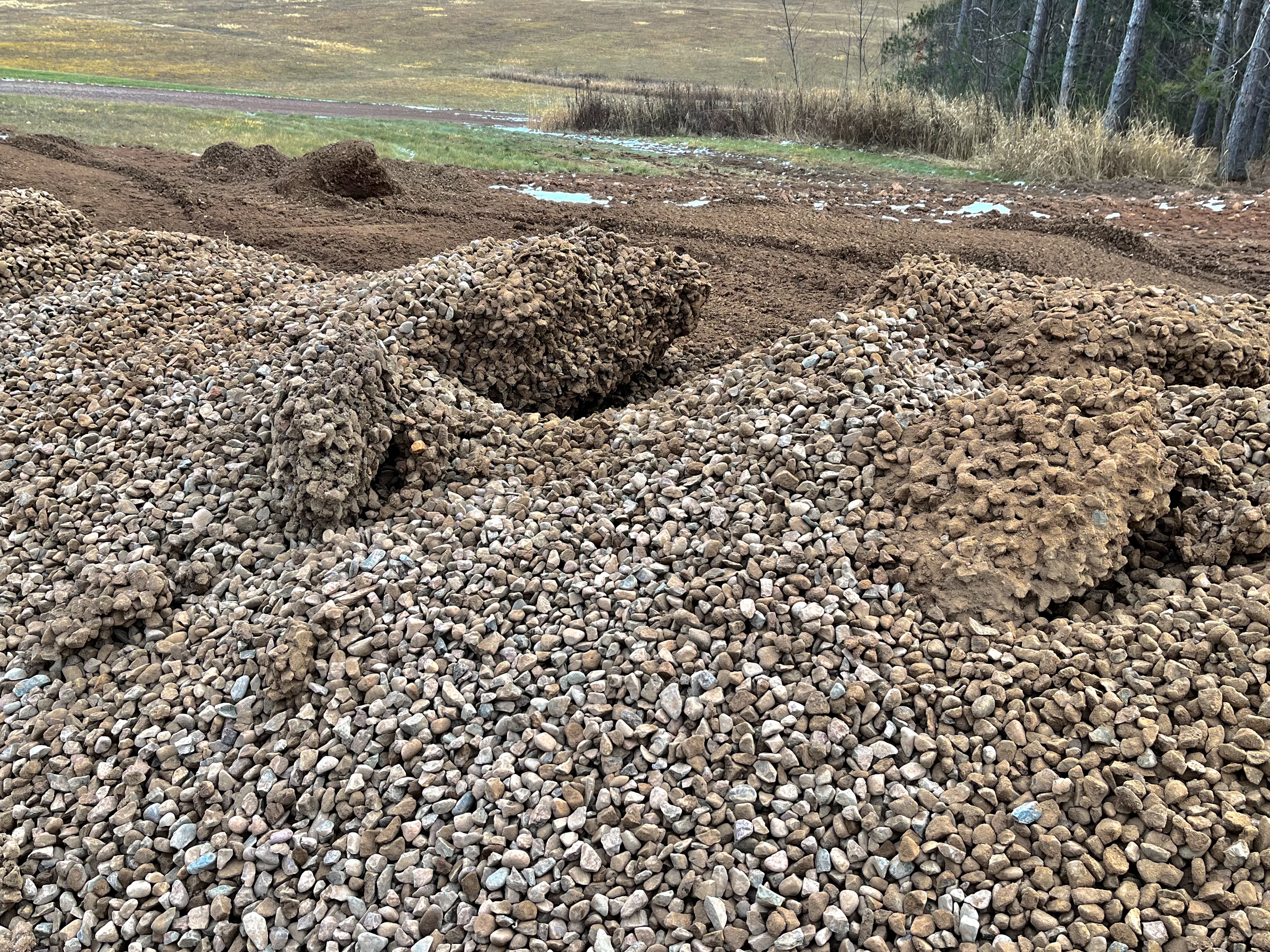

This is the first of three loads of 1” clear I’ll get delivered today.
It’s half frozen and comes out in big chunks that are like big rocks. They are very difficult to break up.

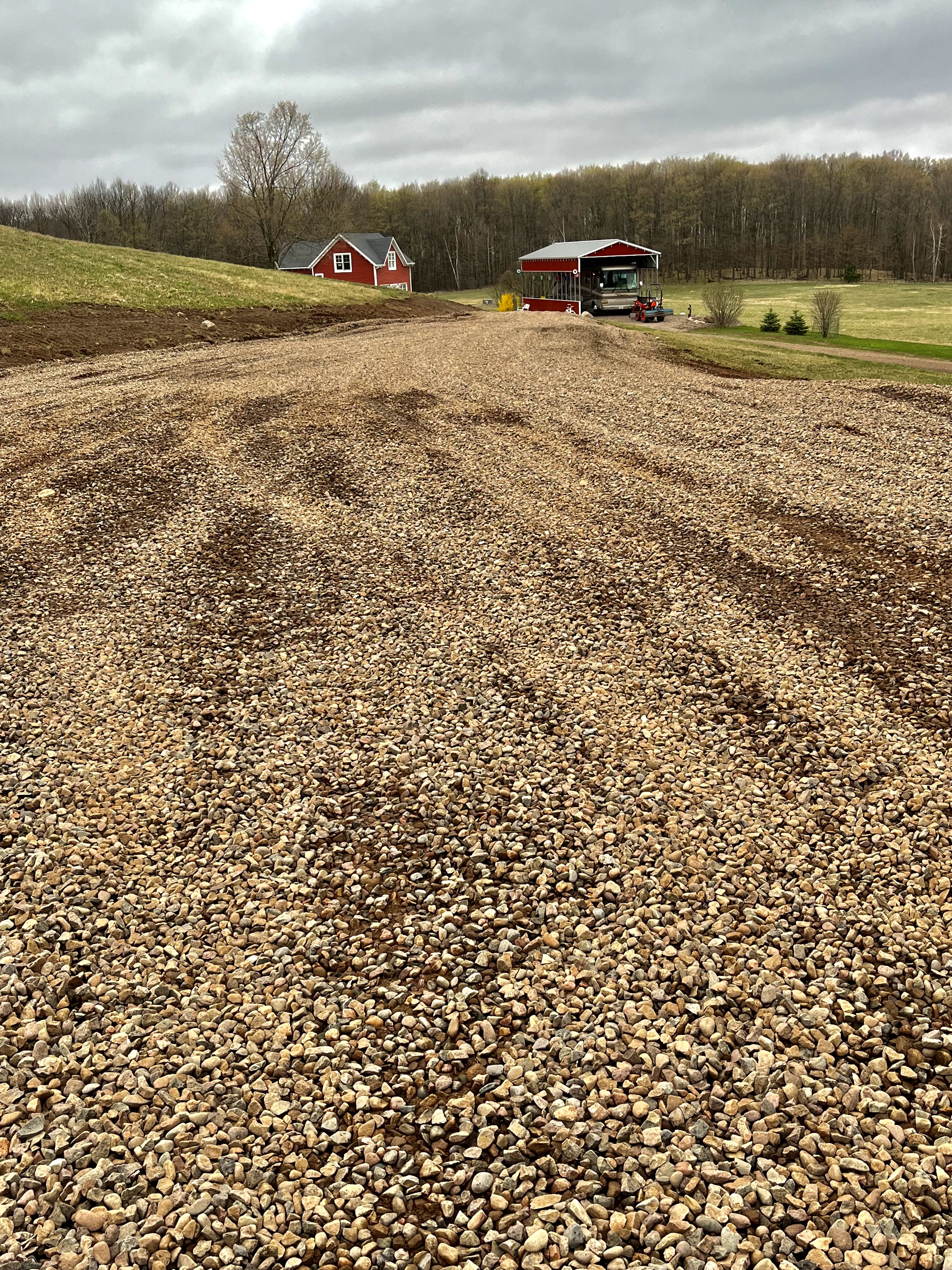

Post by Sir Henry » Tue Dec 19, 2023 12:14 pm
The work continues. Here is 5 of the 15 loads of 1” clear that I ordered. The metal garage is only 20% of t HD e cost of this project.

Sir Henry, do you know why this rock is called “clear”? It looks like what around here is called “river rock”.

Not Sir Henry but clear just means it doesn't have any fines, better for drainage although it won't compact as much as gravel with fines in it.

What Dave said.

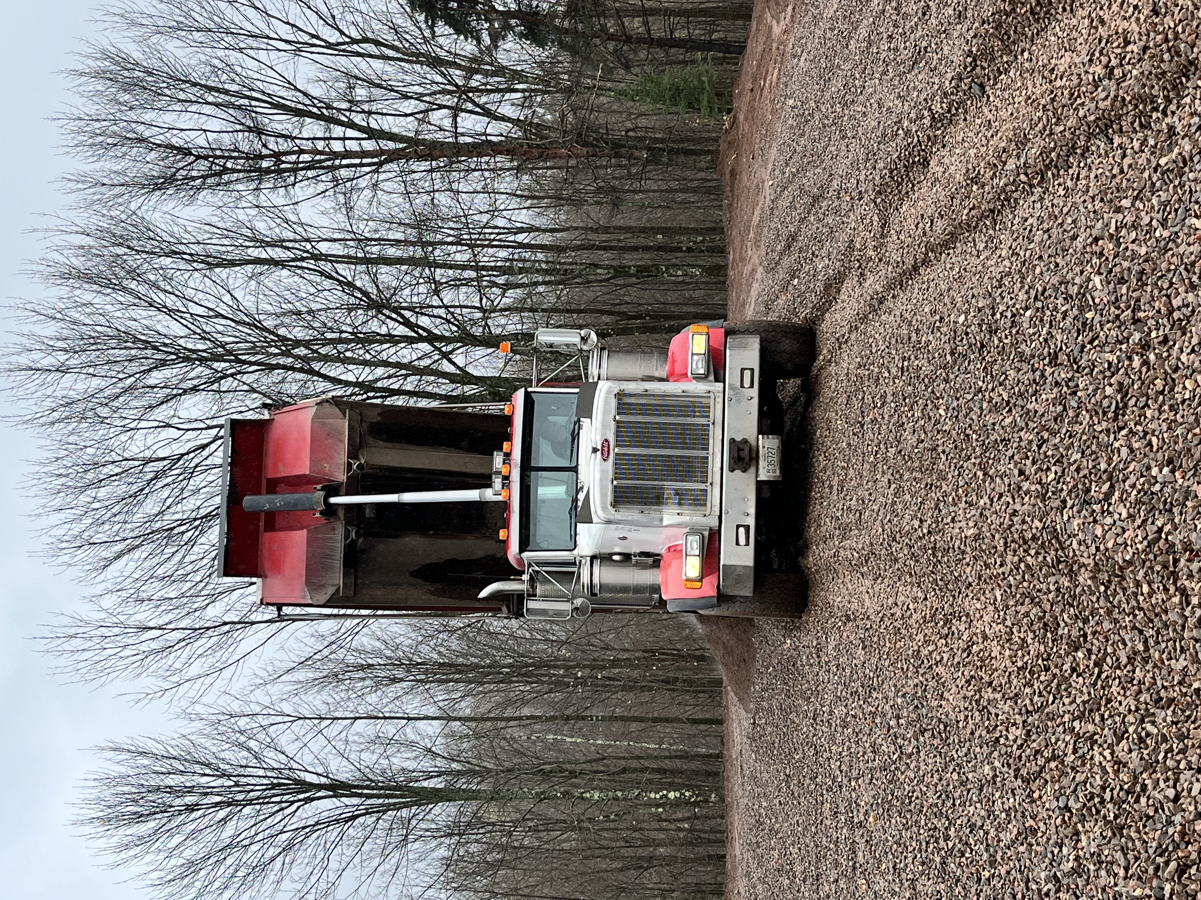

Posts: 14778
Re: Garage and road project
Post by Sir Henry » Fri Dec 22, 2023 3:38 pm

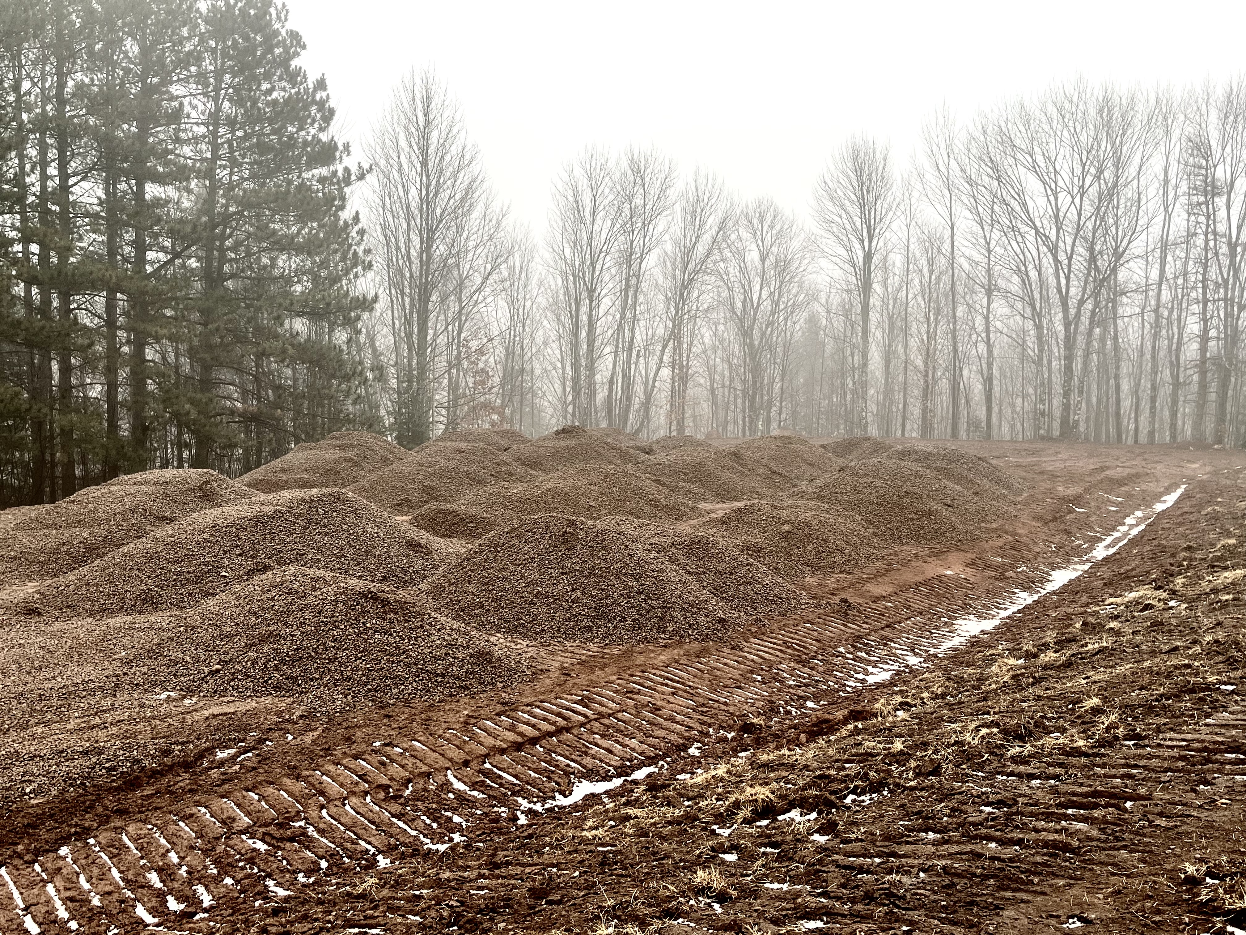

This is what 225 yards of 1” clear looks like. I will spread about 150 yards over a 45x60 foot platform for a 30x50 foot concrete pad. The rest will be spread much thinner behind the garage pad and will cover an area 100x150 feet.

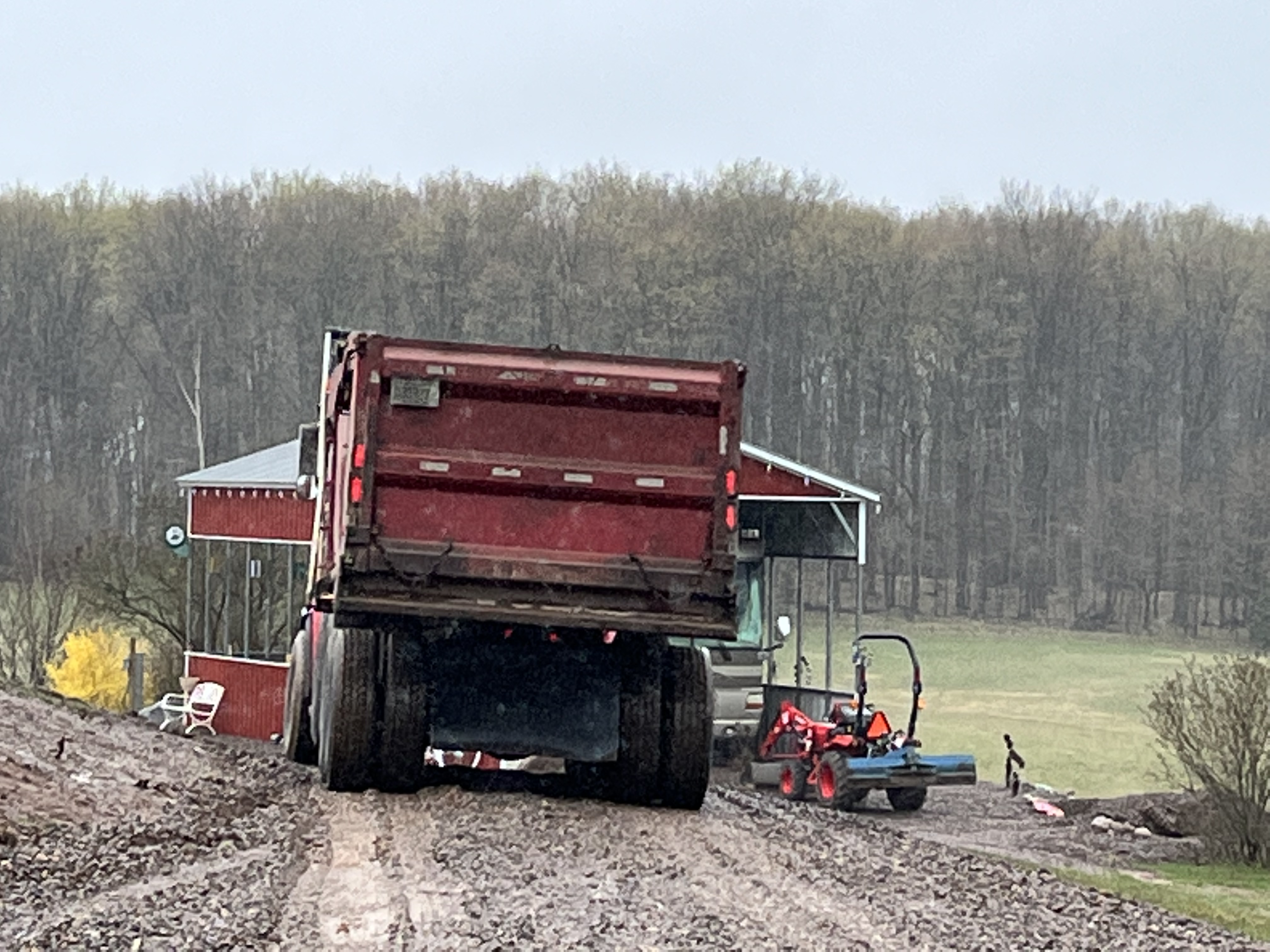

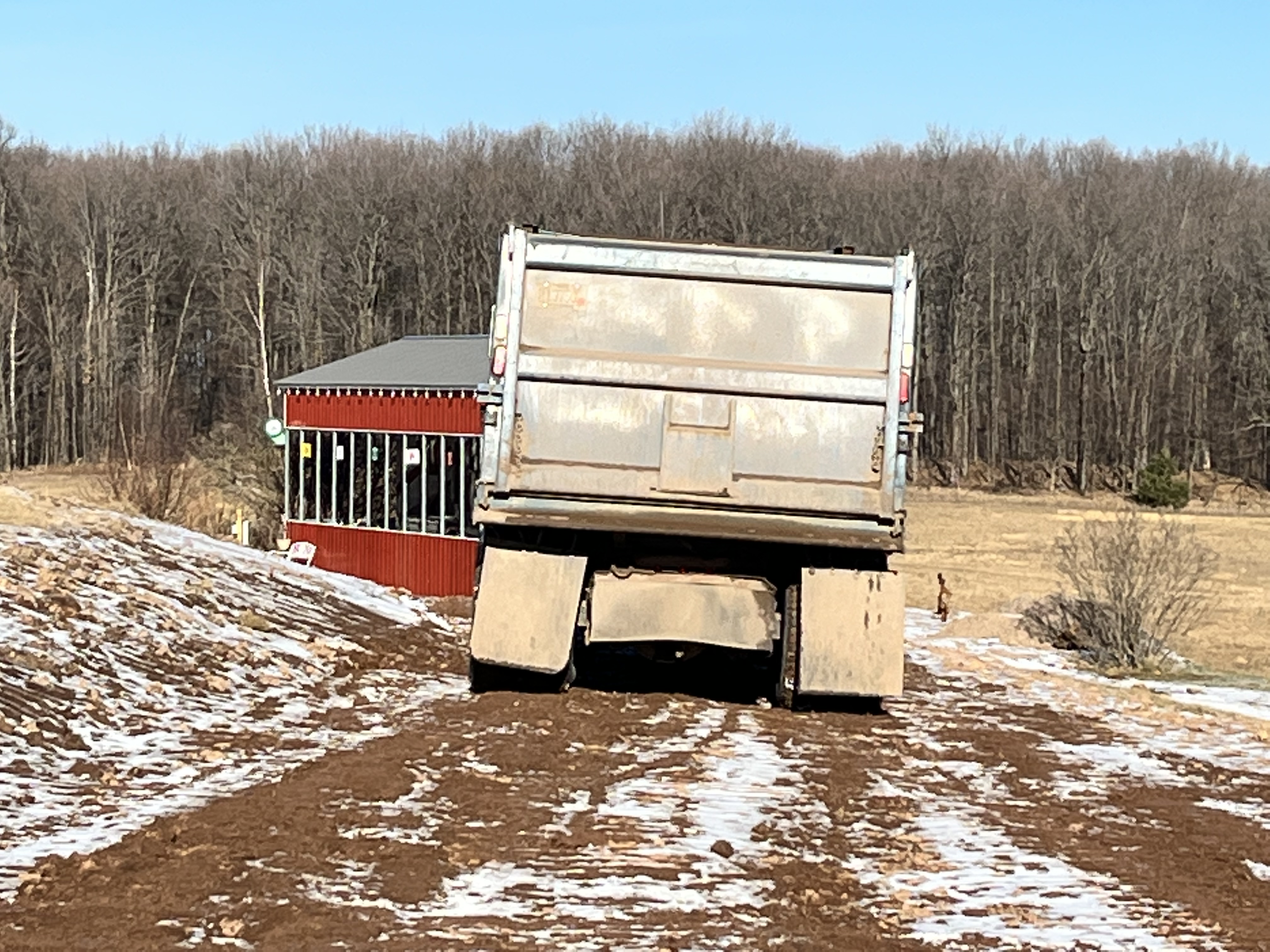

Post by Sir Henry » Mon Apr 29, 2024 3:51 pm
It’s raining and very muddy but they decided to send a truck out to test the road.
We lucked out and he didn’t get stuck.
But it was close as he sunk in almost up to the axels.
I’ll have a total of 35 loads of 15 yards.
