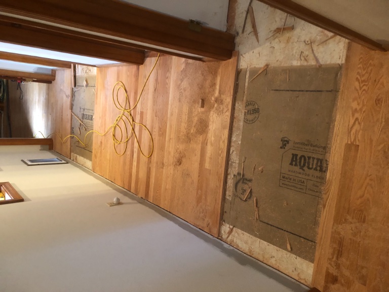

Two years ago I had wall to wall carpet torn up in the family room, back hall and master bedroom. Then a few months ago I opened a wall between the family room and the master bedroom and added a double door. When I opened the wall I noticed the floors matched up almost perfect so instead of having a cross board added I am having them laced together.
The two extra bedrooms are having new hardwood floors also and they will be laced in.
The two walk-in closets in the master bathroom will be hardwood.
The bathroom had carpet in it which will be replaced with heated tile. But that will be in about three months.

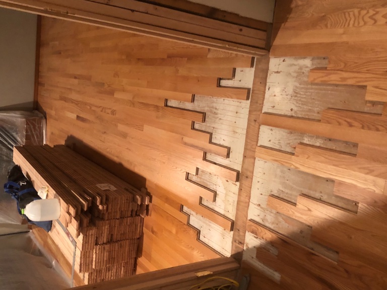

The before picture of how they are lacing the two rooms together.
It still needs to be sanded and stained but it is really looking great. I watched him do one piece and it took him forever. He could have put down twenty other pieces in the same time.

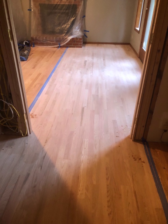

The wood is all down and sanded and ready for the first coat of finish. All coats should be down by Monday and then it’s just a matter of waiting for the acidic fumes to dissipate.

Looks nice.
Before I retired I refinished the hardwood gym floor every Summer at the school I worked at. Didn't sand it down to bare wood but wet screened it with a rotary scrubber, rinsed it very well and then put down a coat of varnish, next day would rough it up with a pad, tack it several times, and put down the final coat of varnish. Took about 15 gallons of urethane varnish per coat so you can imagine how long it took for the smell to go away. Big job, took the most part of a full week. Don't miss doing it but it was nice to see how shiny and beautiful it looked after all that work.

This is how they laced the two rooms together. It is amazing that the two rooms aligned perfectly. They were done with a wall in place. When I knocked the wall out I was surprised.
