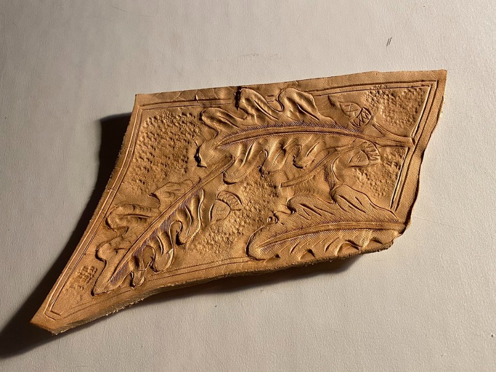

I have decided to make a couple .22 pouches you can either wear on your belt or attach to a lanyard and hang over your shoulder that would contain a box or two of .22 ammo. You walk the trail and plink, drive around the farm doing your chores, or checking a fence line... your ammo isn't exposed like a belt sleeve or gun belt loops, but you have plenty. You get a few minutes and targets of opportunity... dirt clods, vermin or varmints... you have ammo on hand.
Meh... it may work, may not. But, TIME I have. ;)
First, one of the pouches goes to a friend who offered ME a favor, so a favor I pay in return. I asked them what them they wanted on the pouch. I don't do just plain that often. I offered some options and Oak Leaves and Acorns was the choice. ;) I haven't carved those in a while, so I thought I'd better get in some practice. A first shot, without watching any refresher videos. Yeah, where did I save those videos. :P The acorns need work and the leaves are hacked. I'll get out my backlit tracing panel, find a good sample and give it another shot before I try to carve into an actual project piece. :|
Practice First.jpg (234.83 KiB) Viewed 11956 times
The pouches should turn out nice. I'll do one with a belt loop on the back and one with D-rings. One with Oak Leaves and one with Basket Weave or maybe something else. :roll: Watch this space, it might get interesting... at least for me.

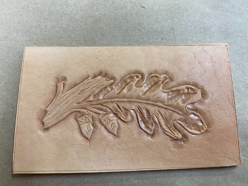

Second shot at practice. :evil: Better, but I know there will be a third. ;)
03 second practice.jpg (246.6 KiB) Viewed 11940 times
This is how I see the weak spots and the areas I need to work on. I just keep hacking at it, and eventually I get to where I don't "hate it."

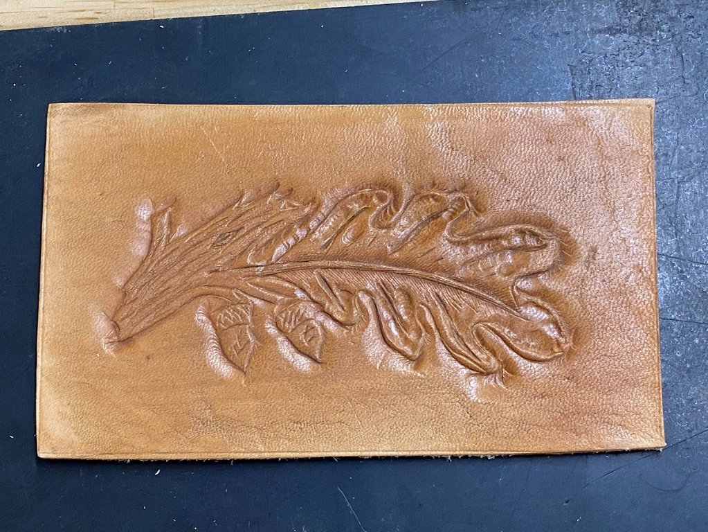

Back out for more practice. Third time is (almost) a charm. :)
I am much happier with this try. I redrew the trace, and transferred it to the leather and tried much harder to bevel neatly. I did a much better job with that. (Still a slip here and there.) I still need to rewatch the pear shading videos again. :?
04 3rd practice.jpg (227.25 KiB) Viewed 11932 times
The swivel knife skills need a bit of work on this small scale. The acorns need to be rounder and the curves on the leaves could be smoother, that comes with time and skill. ;) Skill, I looked for a package of skill on Amazon. Out of Stock. :evil:
Went all out. Oiled and waxed this one to see the finished product. Not bad.
05 oiled and waxed.jpg (224.6 KiB) Viewed 11932 times

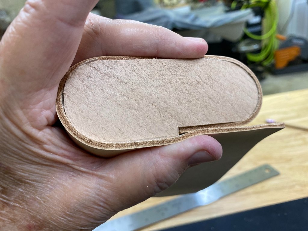

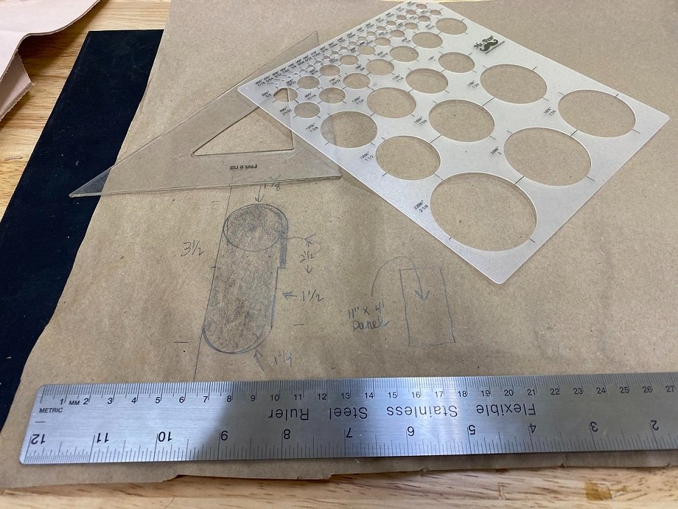

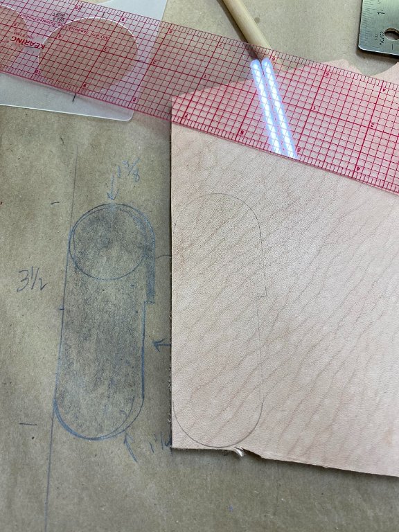

First, I laid out the design I had modified in my mind on the drive. I tossed the original plan as the testing after cutting it out just didn't please me. The new layout feels like it will work.

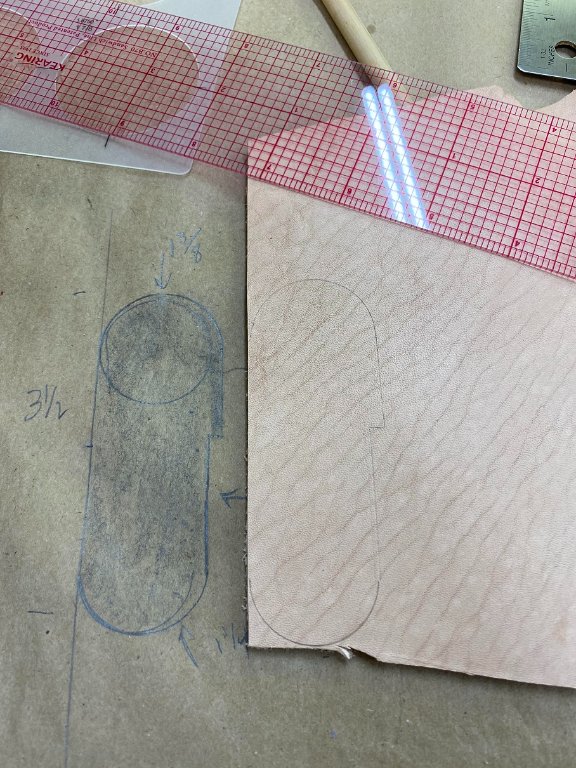

I designed, in my mind, an oval side panel with a notch, so the overlapping flap will lay evenly on the lower pouch when closed. I came home and went out to the shop and began drawing the side panel. The first drawing didn't work out... too tight in the interior. The second drawing looked promising.
06 layout side panel.jpg (157.53 KiB) Viewed 10760 times

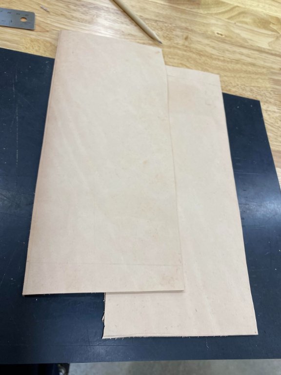

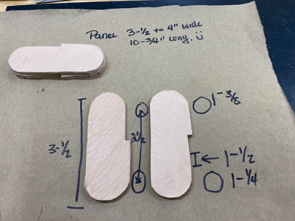

With that, I transferred the drawing to a bit heavier leather for stiffness, and then cut out the first piece.
07 transfer.jpg (128.95 KiB) Viewed 10761 times

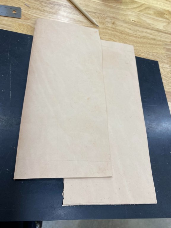

I tested it with the existing panel from the failed first attempt. This let me know about the length I would need. I cut out the other three side panels and made notes on the design parameters.
08 design.jpg (174.33 KiB) Viewed 10761 times

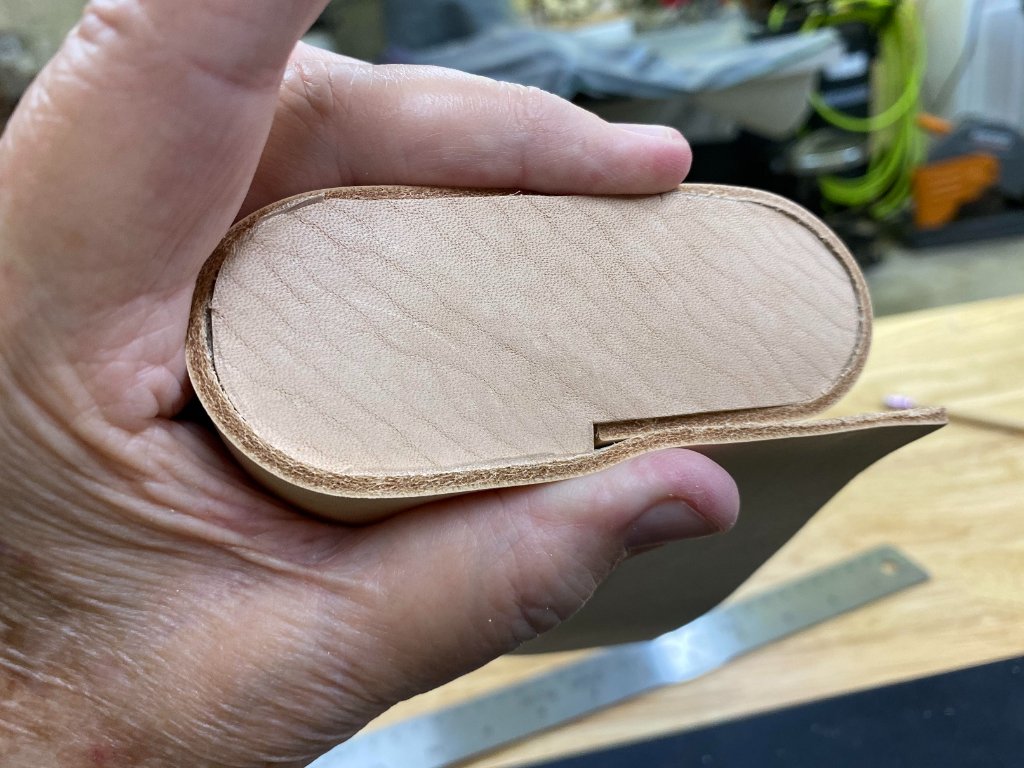

With a panel in hand, I tested the application. It is a tentative success. If the panel is properly tooled and will be sewn to the side pieces, I will slightly trim the edge to fit exactly before adding the holes for sewing.
09 application.jpg (135.39 KiB) Viewed 10761 times

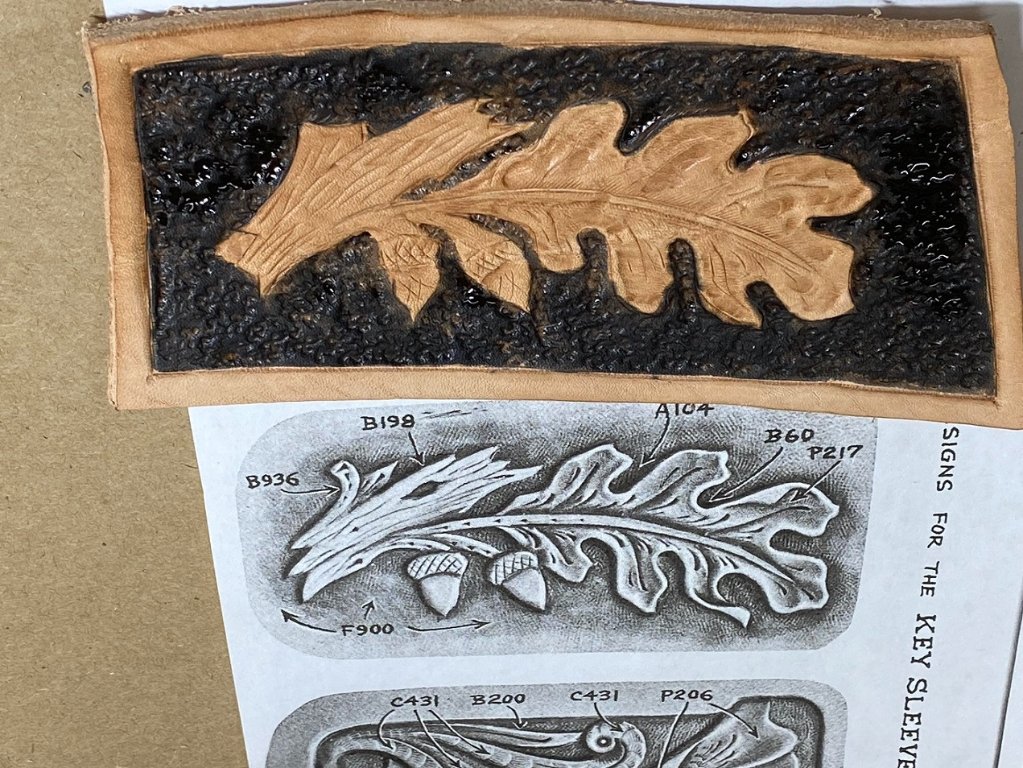

Back at the job this morning. Started by using a small square to cut and shape the first panel to 4 x 10-3/4 inches. Want it square and even edges to present a good appearance when the project is sewn together.
11 1st panel sized and shaped.jpg (60.63 KiB) Viewed 10752 times
After the panel was cut and the shape was matched against the notched side panel, I marked the areas that would be the face of the front, and the flap area to determine the areas where carvings would be appropriate. Then where stitching would take place, then marked and grooved for the stitch lines on the panel and the side plates. Next I transferred the design to be cut for the tooling and carving, then the borders.
Once all that was done, I started by cutting in (Carving) the Flap design in with the swivel knife.
12 carved flap.jpg (179.1 KiB) Viewed 10752 times
I also cut in the front panel design.
13 carved front panel.jpg (136.67 KiB) Viewed 10752 times
Then I went over the border lines with the swivel knife to make them pop as well. The panel is beginning to take shape.
14 carved panel.jpg (112.56 KiB) Viewed 10752 times
