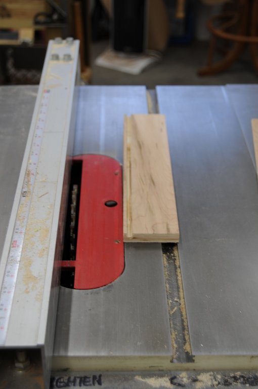

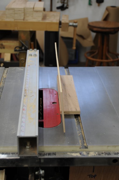

More shop time. Swapped the blades on the table saw... Installed the stacked dado, set up for 1/4 inch cut, set about 1/4 inch depth. Ran a test pass on a scrap, and test fit a piece of the 1/4 inch hardwood ply I use for drawer bottoms. Good to go. Miss T came out for a few minutes to catch and stack and I ran all thirty two pieces across the dado blade.
Swapped the blades back and trimmed the side pieces to the new length, then calculated the size of the bottom panels, allowing the extra length and width for the dadoes. Made that mistake Once....
Got it all cut out, time for a break, caffine is low. I took pics, I will get them up in a bit.

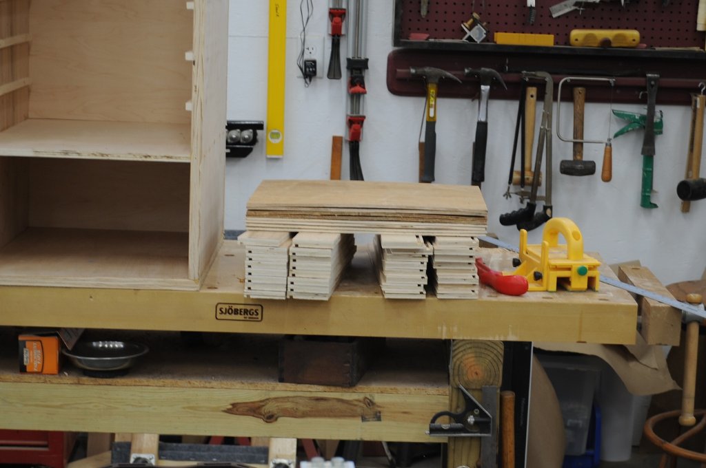

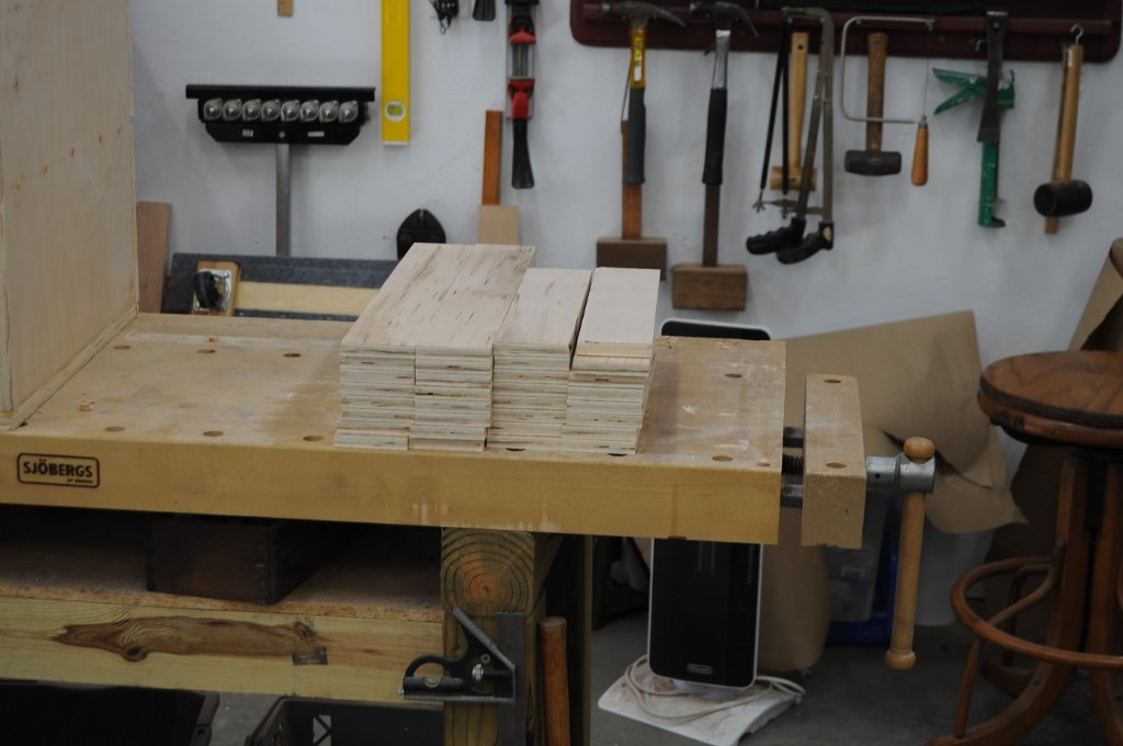

Here are the latest pics:
A drawer kit, 32 pieces cut, 16 sides, and the front and back pieces. Set up the dado and run a test piece. Then check the fit of the material for the bottom... When that works, run all 32 components and then cut out the eight bottom panels. Will get out and work on the assembly in a bit.

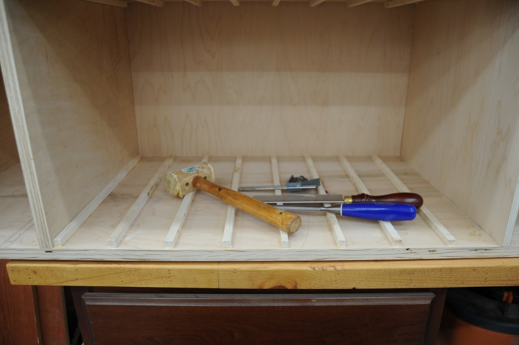

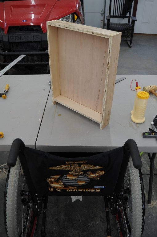

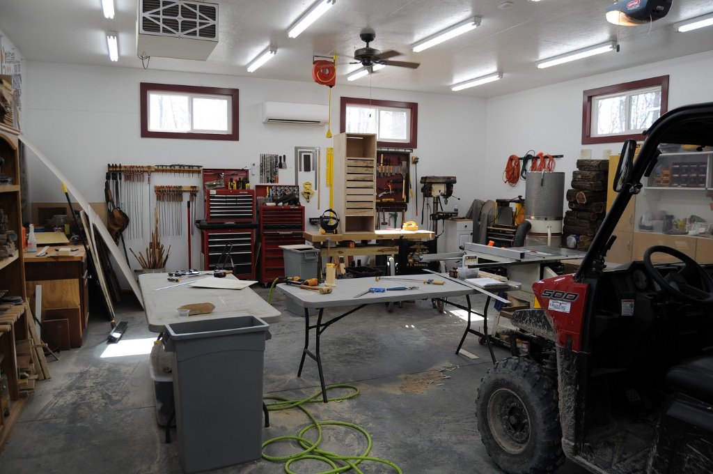

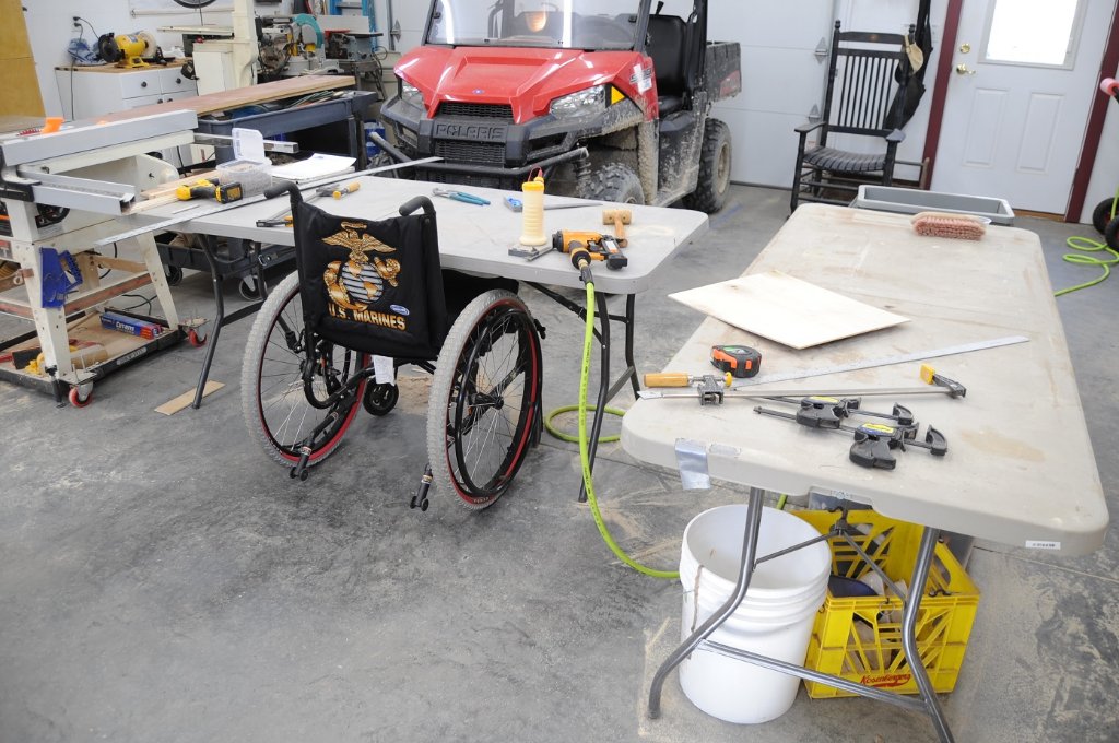

Back in the shop. I normally keep it clean, but when I am working on a project, I keep the shop neat enough to keep it safe, but leave the tools OUT that I am using... don't waste time putting away the stuff I will use again the next day and don't sweep at the end of every day. Just keep the hazards off the floor.
So, to some folks, the shop would look a mess.
The last session for today, set up to assemble drawers.
So, did the assembled drawers match your image of what I described?

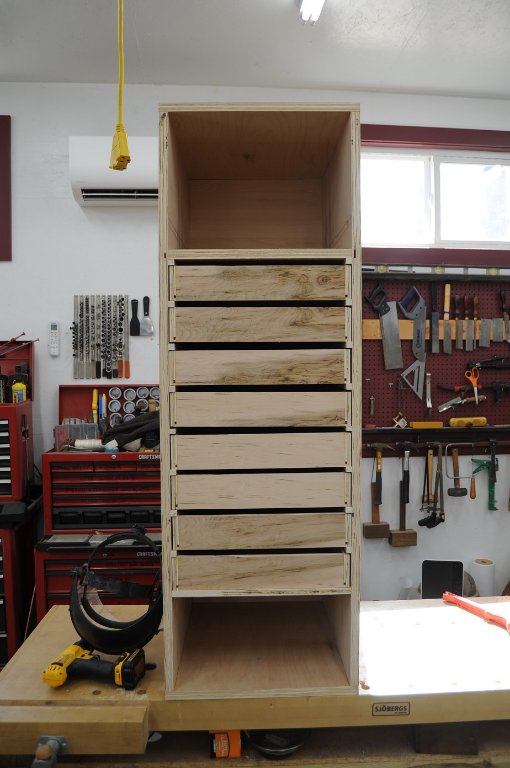

Cabinet with eight drawers in place. They still need the drawer fronts and pulls, and I need to put the trim in place and do the finish work.
The cabinet would WORK as it is now.
It just wouldn't be pretty.

Yes, given your detailed description through the process so far, looks great, as I expected! Can't wait to see the finished product.
BTW, your shop is spic n span compared to my small shop.

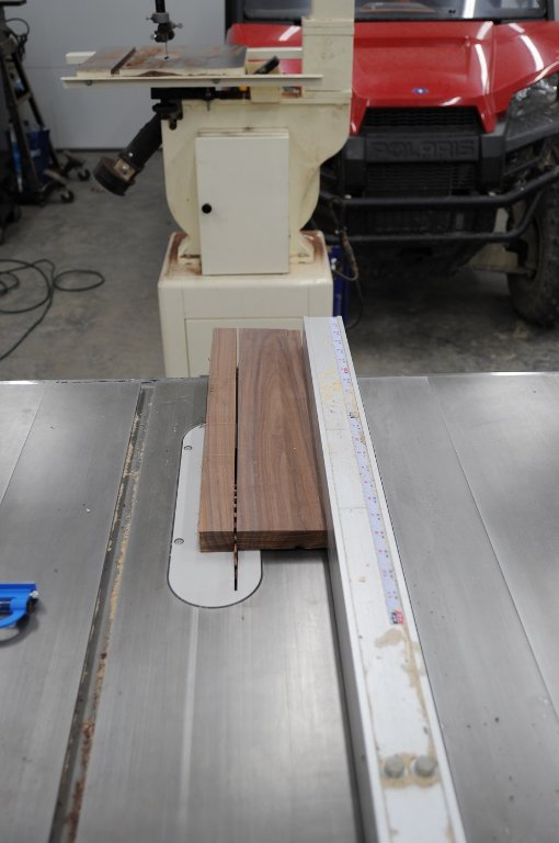

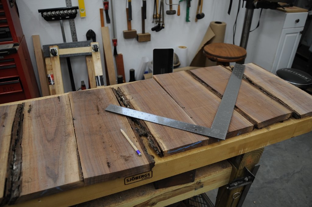

Worked a second session, chose some slabs, marked a centerline on ten slabs. Got an edge marked for reference. Went thru those ten and after making my calculations, chose four. Set up the band saw and cut that straight edge. Next came the power planer to flatten one surface on each of tye four. Break time. Back to the table saw next. I'll be cutting 1/4 drawer fronts, and then trim from the extra.

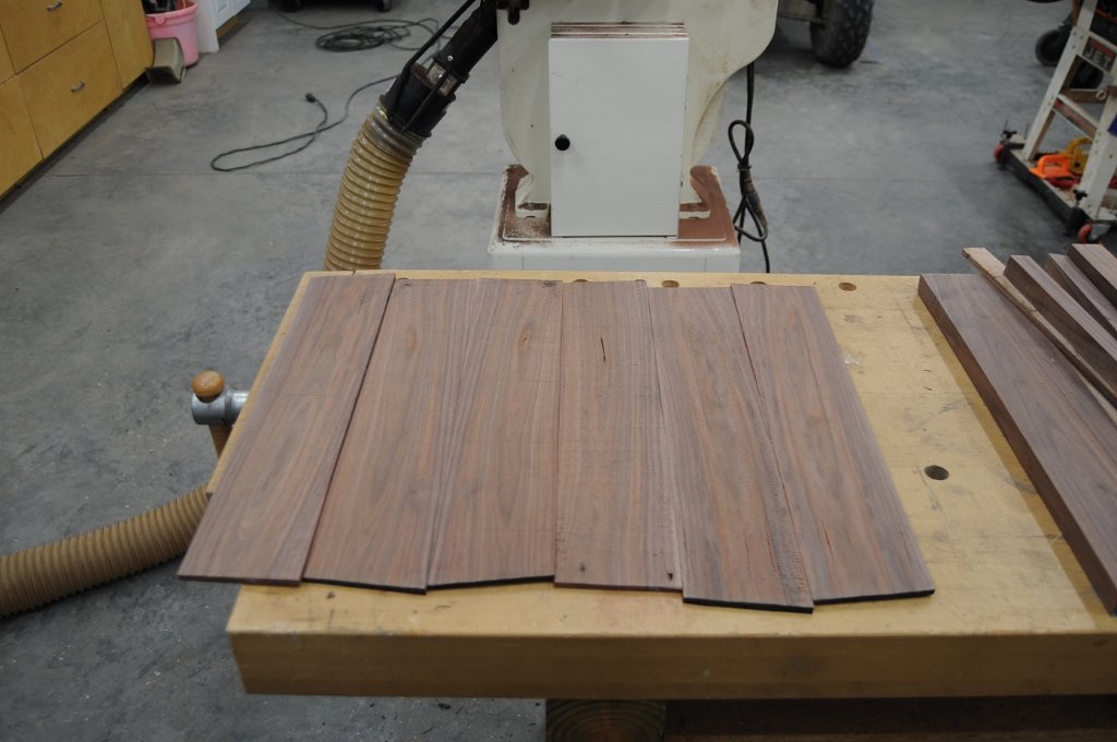

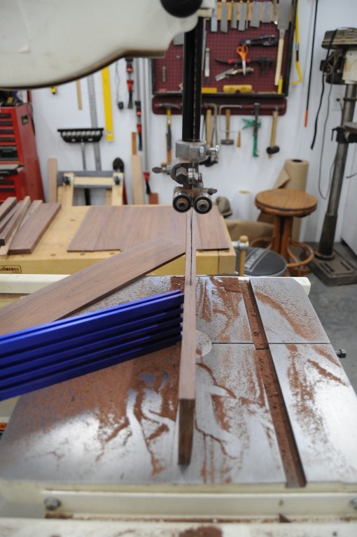

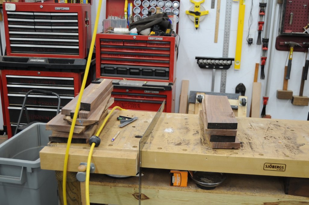

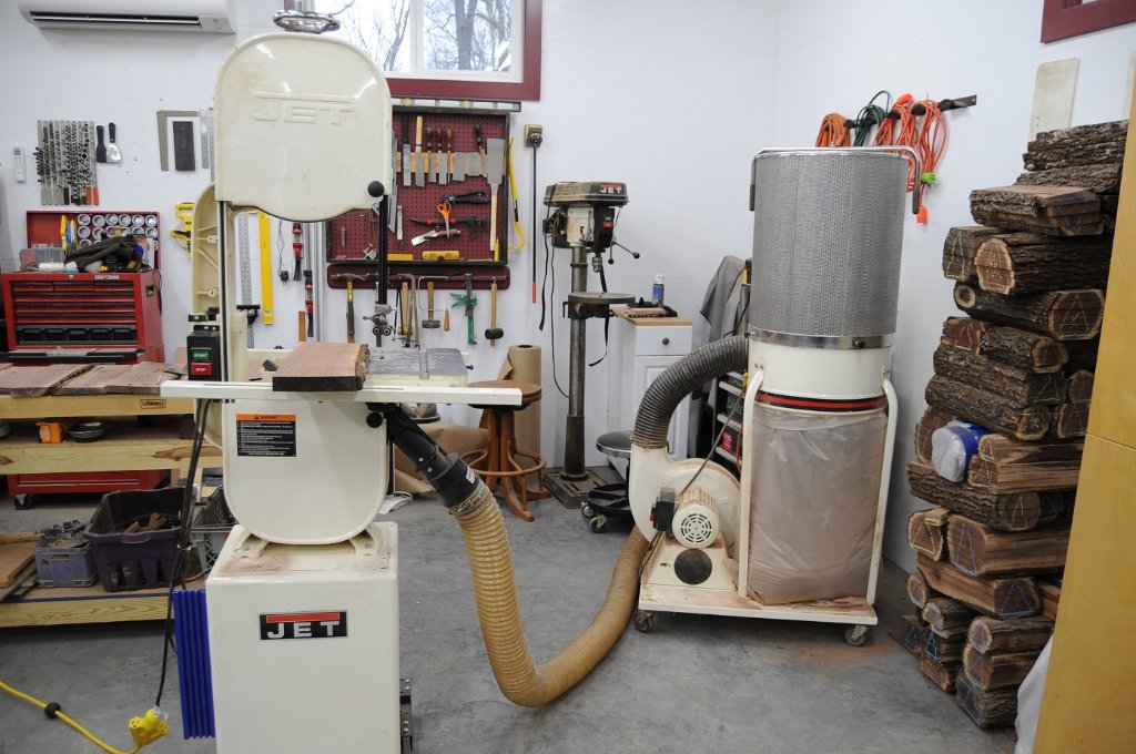

PICS as promised.
After processing the Slabs the in the earlier steps, I marked the center, then a straight edge. I chose the best and cut those on the bandsaw. The best four were squared up and shaped. Ran them thru the power planer to take out bows and rough faces. A warm day let me work with the shop door open, a long view from outside the roll up door. As discussed in an earlier post, the design is fluid. I changed the way I was going to deal with hiding the rails, so I needed to trim them back 1/4" Now that I knew how I was going to deal with the drawer faces, time to trim the blocks to size. The blocks could be bookmatched to produce the faces. Each block yielded about three faces. I also ran the cutoffs thru the bandsaw to produce the trim for the cabinet. All the bandsawed items were run thru the planer to take away the rough faces, but will still need to be carded to smooth them out.
Next up? Sanding and fitting, then finishing and mounting hardware and we are done.
(I may also make a standing rack to fill the dead space between the off side of the cabinet and the safe wall, to store files and other items.) This would be an hour ... unfinished as it will be hidden from view.

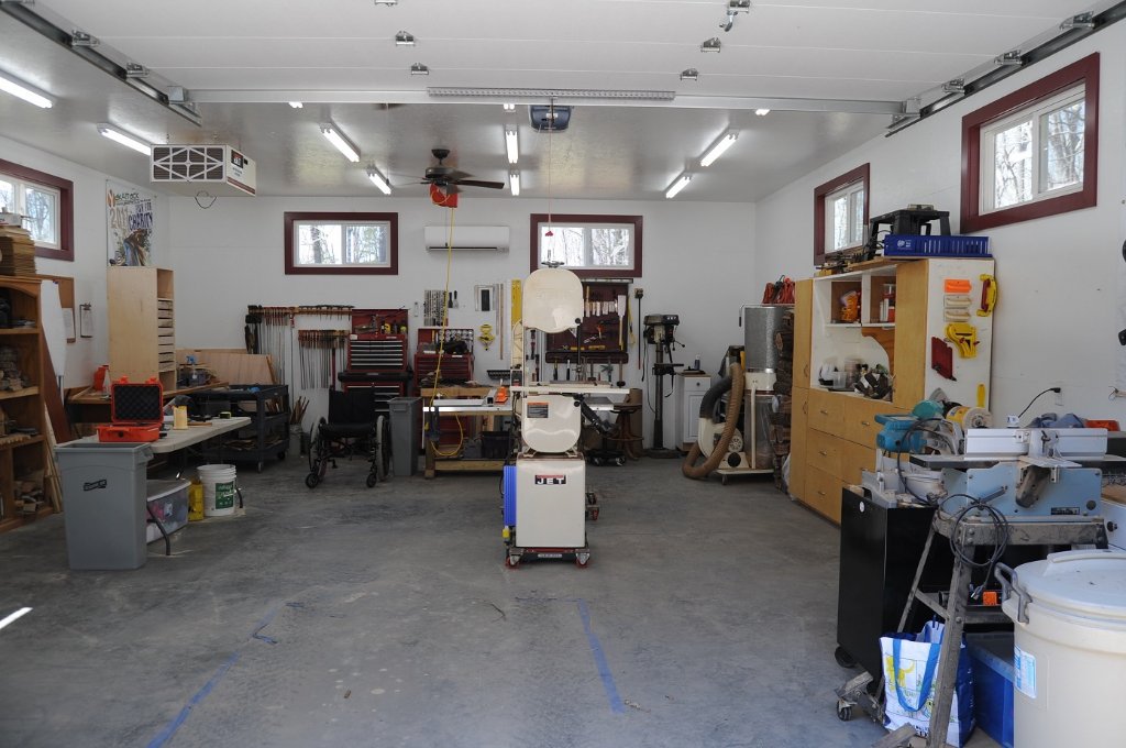

When I did that fantasia hippo move in 2017? and we didn't know if I would walk again, Miss T had our guy waiting when i came home from the hospital. We knew that I needed access for my chair either way, and the 12 x 20 Amish building I had used for twenty years wasn't going to do. We moved it aside, to become Miss Ts work shop, and built this one.RanchRoper wrote:What a nice shop.
With the lower interest rates at the time, and the small amount remaining on our balance, we refinanced the house for ten years, added the funds for the shop, and the payment stayed the same.

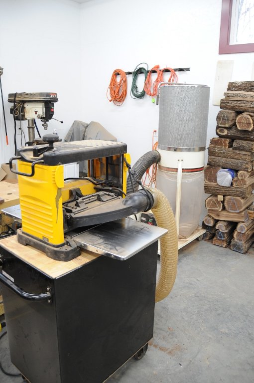

Again, Marine, great progress , what a nice shop. Mine is too small to have some of those great tools you have. Looks like you have dust collection issues covered as well. Very frustrating for me with just a large shop vac. Keep up the good work! Can't wait for completion.

Years ago, when we were first married, l was in an 8x10 building l built myself, and using a small black and decker shop vac for dust collection. I didn't start to really build up the tools until the kids started to graduate and move on...markiver54 wrote:Again, Marine, great progress , what a nice shop. Mine is too small to have some of those great tools you have. Looks like you have dust collection issues covered as well. Very frustrating for me with just a large shop vac. Keep up the good work! Can't wait for completion.
Most of the large tools you see are more than fifteen years old... Still running. Some have been upgraded or rebuilt, but... Still going.
Wait... So am I... Upgraded, rebuilt.
