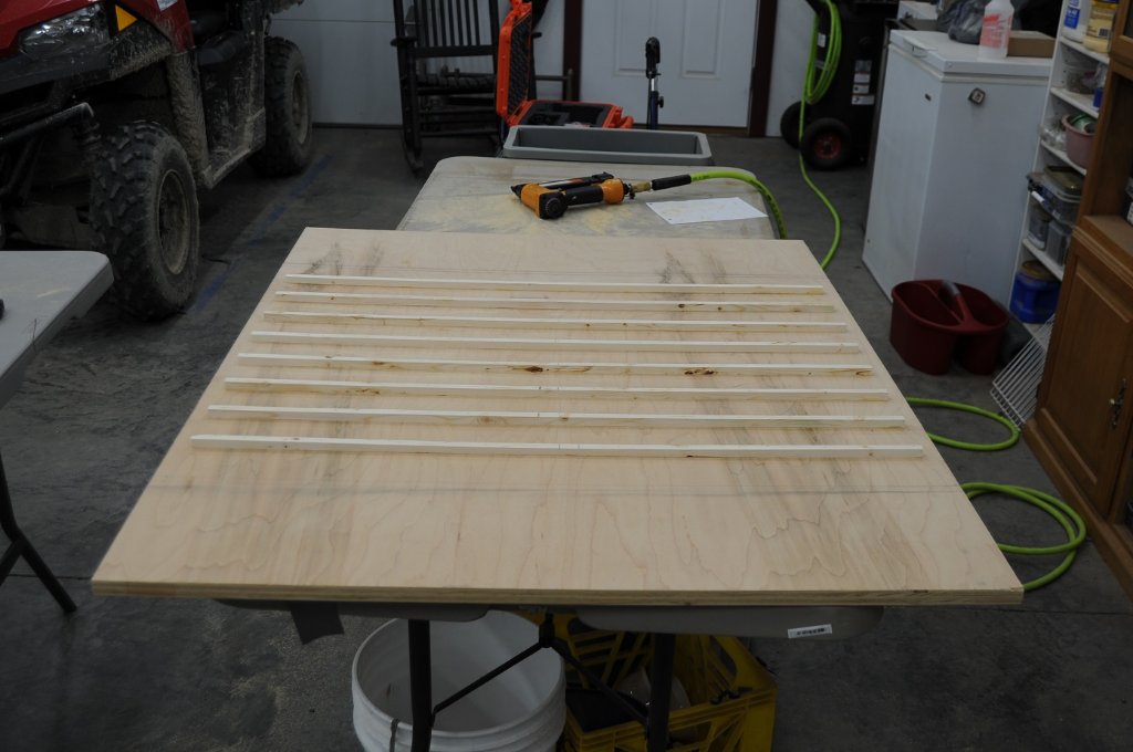

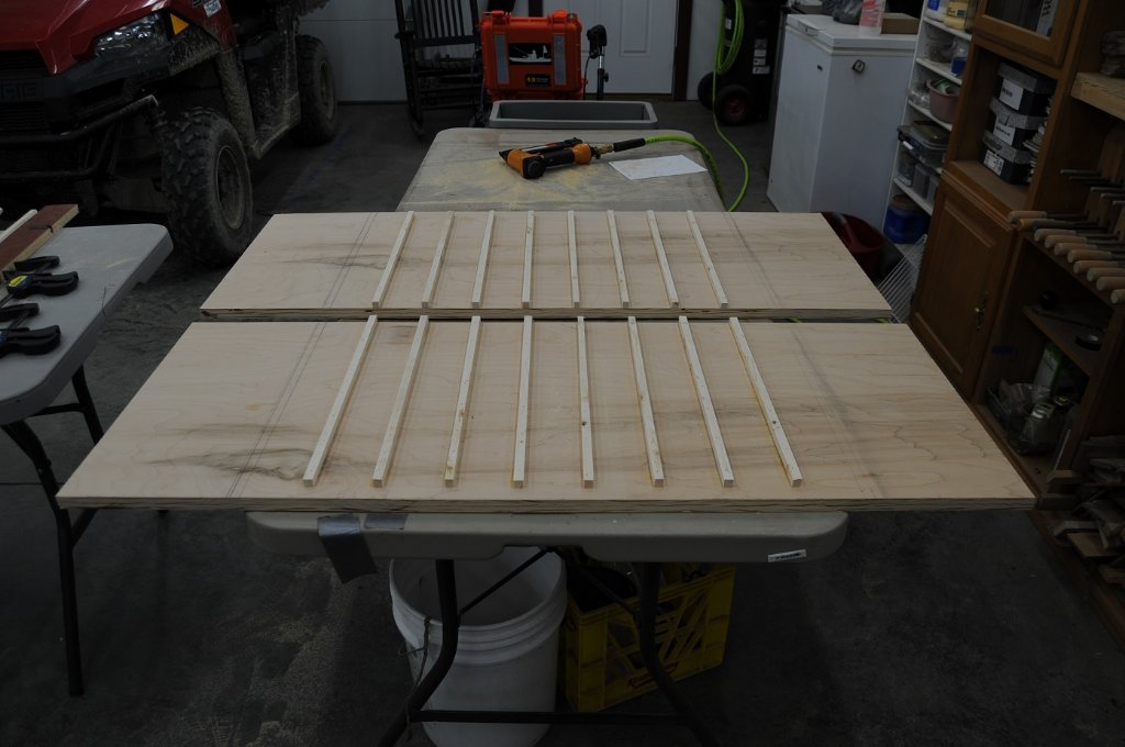

First, the pics of the side panel with the runners, (rails) under construction.
full side panel with rails.jpg (132.9 KiB) Viewed 4174 times

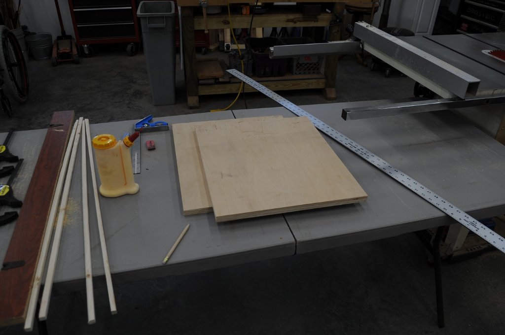

After all the measurements and the buildup, ran 'er across the tablesaw and ended up with two matched side panels.
cut into two panels.jpg (129.51 KiB) Viewed 4174 times

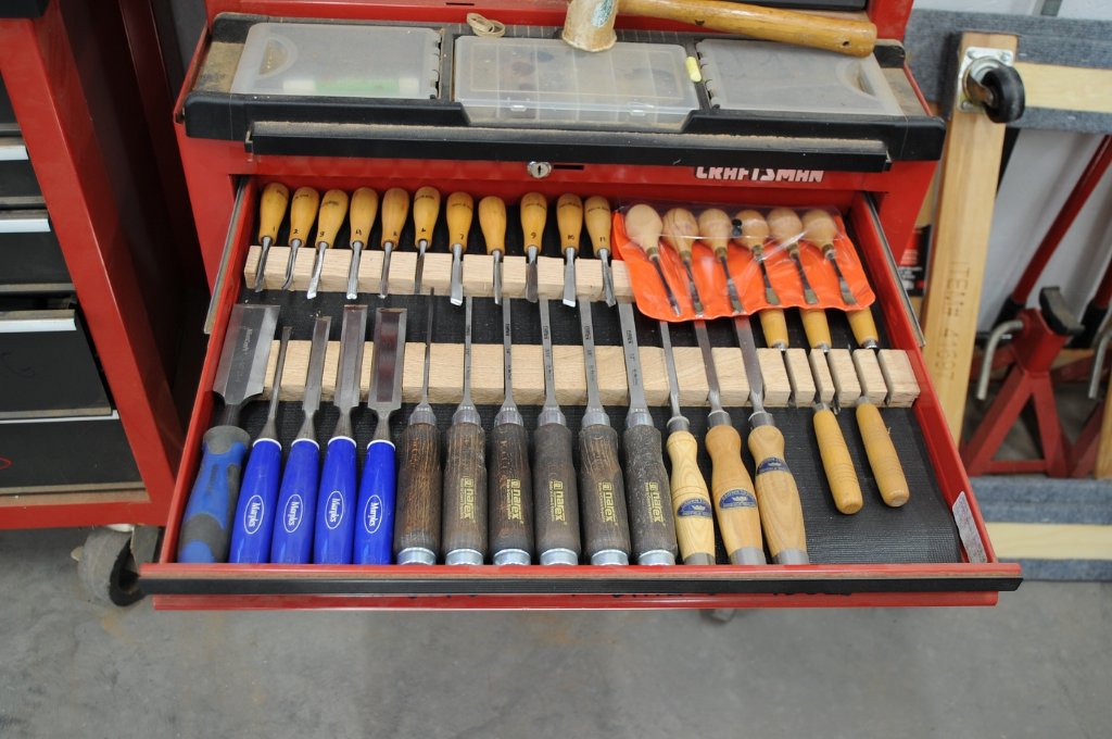

Of course, good chisel work requires good chisels, this drawer contains the good sharp chisels. I have another drawer with duty chisels I would use on utility jobs like cutting a door mortise or a slot in the field for a fence rail.
[attachment=2]chisel or two.jpg[/attachmen

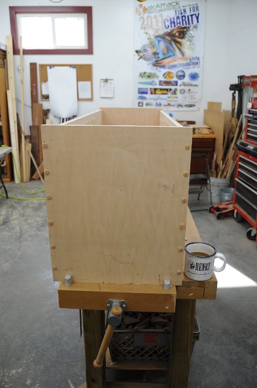

I had to add one more pic...
You'll note the oak plugs sticking out of the countersunk holes about a half inch, waiting to be trimmed....
Wait, what's that next to the box on the bench? How did that sneak into the pic?
:D
Posts: 7520
Re: Cabinet for gun safe interior
Post by BrokenolMarine » Sat Mar 30, 2019 8:33 am
Also note the base and top are 1/2" proud of the sides. This tells you the box is face down on the bench. The back will match up to these panels to prevent racking, as well as the proud shelves when they are installed.

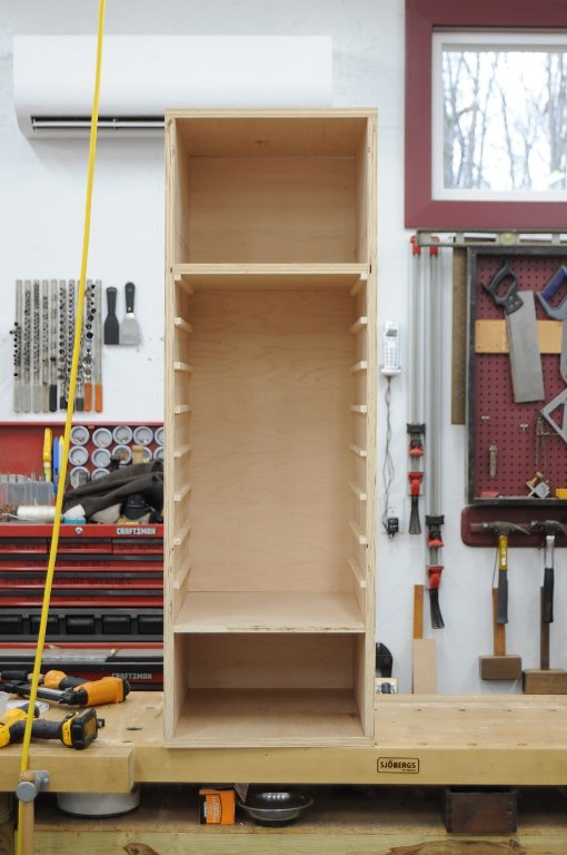

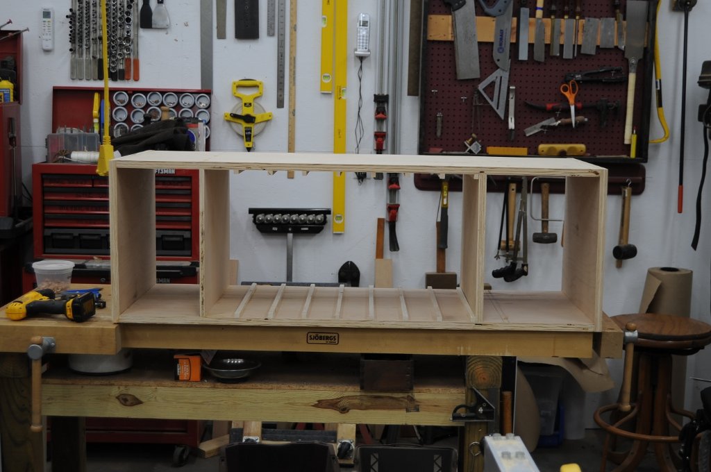

Got out into the shop again, finally. No errands to run, nothing to keep me out. So... back to work. I cut the shelves again, and this time they went in as planned originally. I used the original spacer to install the bottom shelf, cutting it in half and using it to insure the shelf was properly spaced from the bottom. NO 1/16 error this time. square and properly aligned.
I took the opportunity while driving around to think about the top shelf. I had originally wanted to use a small box containing storage drawers on that top shelf, but it was going to come up short, so what I decided to do was eliminate one drawer and lower that top shelf to give me the room I need. Besides, that box is sweet. :) Now a bigger upper cubbie, and eight drawers.
The shelves are done, square, and secure.
shelves redone.jpg (154.25 KiB) Viewed 4155 times

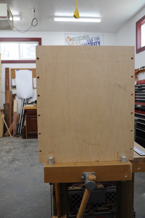

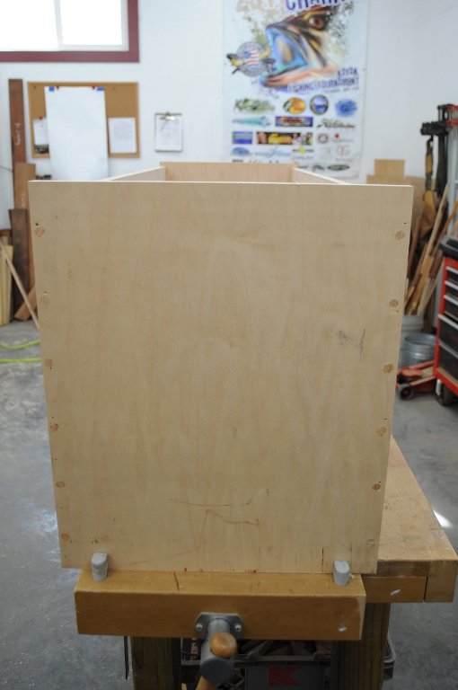

Then I cut a 16 inch strip off the 1/2 panel, then cut the proper length for each back panel and installed that. The back panels are installed and secure and the box is square.
back panels installed.jpg (103.31 KiB) Viewed 4155 times

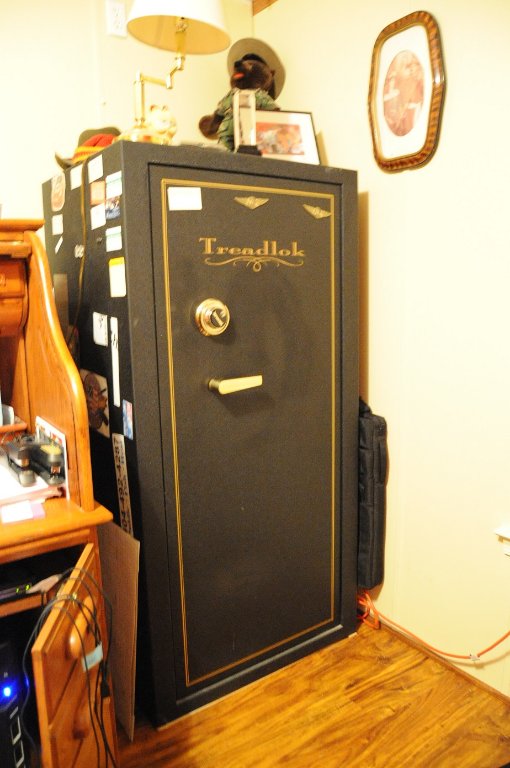

The cabinet, when complete, will go in here:
into this safe.jpg (106.04 KiB) Viewed 4155 times
This is the safe someone asked about earlier. It's pretty big, and the room it sits in is at the back of the house. After all my time in the last career, it's covered. Door alarm to the room, glass break alarm, and motion. :? Plus, it's bolted to the floor and won't fit through the fit thru the door without removing the door and the frame. Too much time with the alarm horn screaming.
