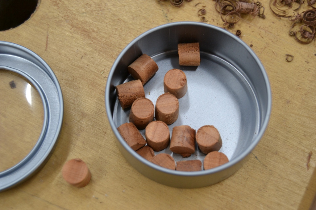

I use a 3/8ths forstner bit to cut the previously drilled extractor holes to a consistent size
I inspect my collection of wooden plugs
- 10 collection of plugs.jpg (340.24 KiB) Viewed 5731 times
Choose mahogany, you won't really see them anyway, and they worked when I screwed the hinge on the box.
- 11 mahogany.jpg (298.61 KiB) Viewed 5731 times
