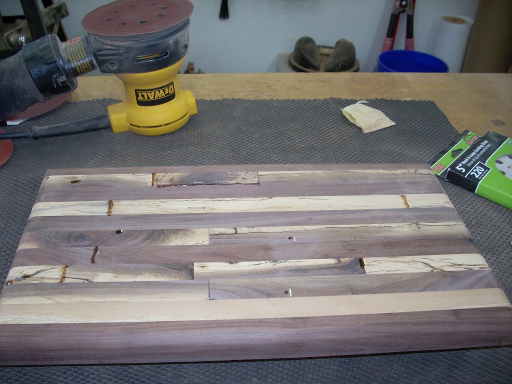

They were looking good so far, but they were only going to improve. More sanding and some infill for the minor defects that ... well only I might notice, but would allow food particles (if they were actually to get used) or water or cleaning products if they get dusted, to get down into the wood. Mostly I am talking about worm holes and chips. I start the infill by taking a scrap offcut, isolating the purple heart and rubbing it against some 60 grit sandpaper to create purple heart dust. I use this to fill the defects. Then I coat them with the CA glue of appropriate thickness.

After the glue has dried you have the first layer of the repair, and it needs to be sanded away, leaving only the repair area with any evidence you visited. The discoloration "around" the repair is no longer visible. You repeat the process again, and again, and again... until you are flush.

I finally got back in the shop after my visit to see my surgeon on the 11th. Short stays, an hour at most. Two new cutting boards on the bench. A day or two break at times between sessions. But, these ought to turn out nice. I try to apply lessons learned in every project to the next build. ;)
So, more pre glue up prep for these. :D
