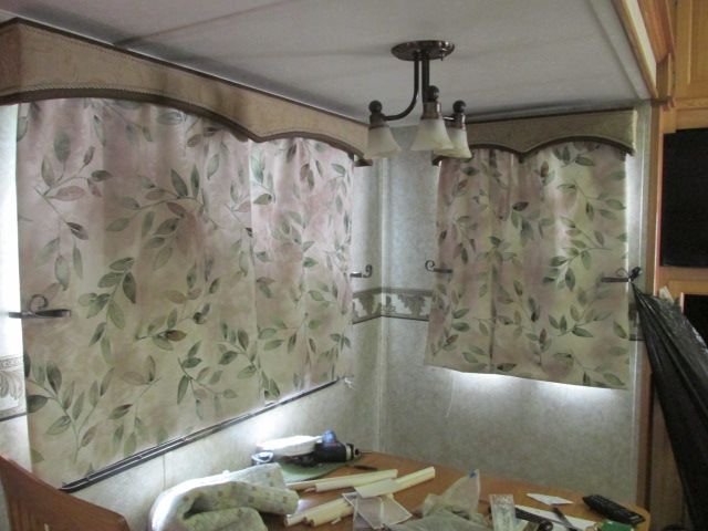

the first curtain in the living area has been replaced ... we hope to get 2 more completed today

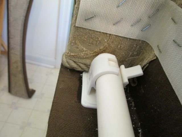

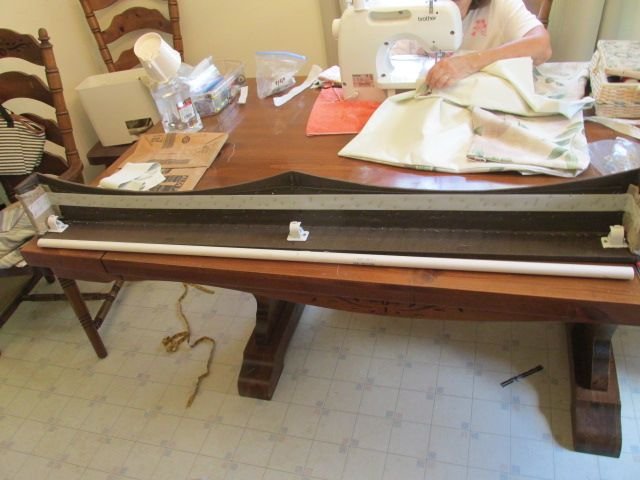

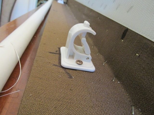

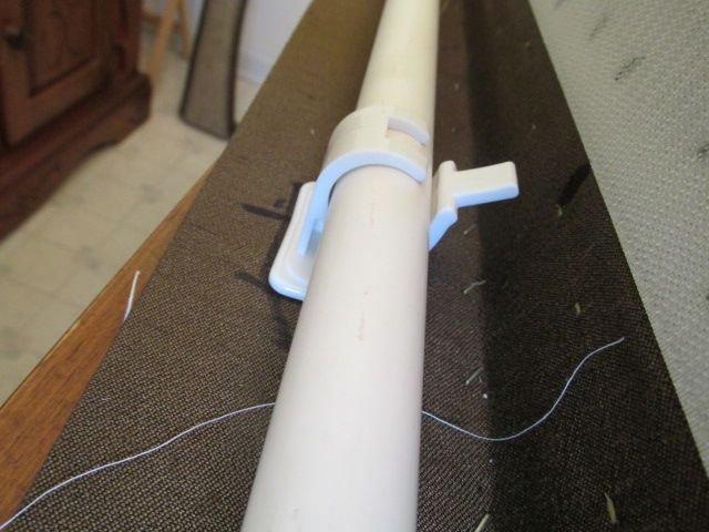

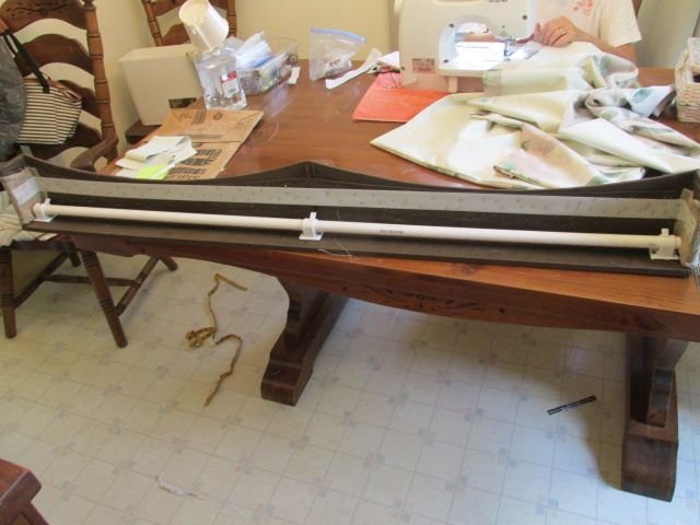

the curtain replacement is going well .... the cornice sits on two brackets that are mounted to the wall .... they weren't designed or built to be easily removed .... the best way I've found to get to the brackets is to cut the OEM day/night shades right below the cornice .... you can then get a #2 square head screwdriver to the screws .... when I started this project I wanted to use 3/4" wood dowels on the spans that are 36 or fewer inches wide .... for the longer spans we went with 3/4" PVC pipe which is much cheaper than wood .... one such application is shown below .... the center rod holder provides plenty of support and keeps the pipe surprisingly rigid ....

Post by BigAl52 » Thu May 27, 2021 4:46 pm
Looks good Jim. Ive never seen those type of rod holding brackets. I guess.

Self Adhesive Curtain Rod Bracket Holder ===> https://www.amazon.com/gp/product/B08VJ ... UTF8&psc=1 .... as can be seen in the pictures above, I do drill the base of the bracket, peel the cover off of the adhesive base and stick the bracket in place .... then use screws to make sure it stays there
