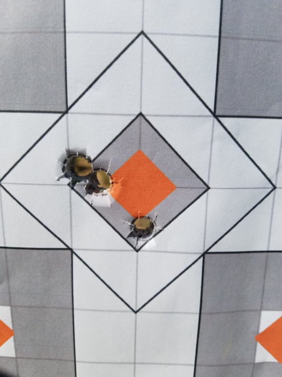

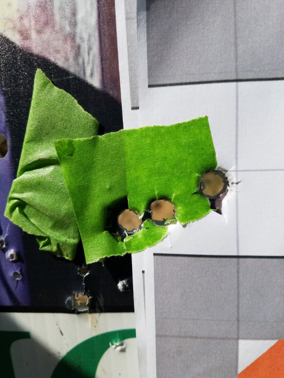

Went out to do a little shooting the other morning. Included in the mix was my 45 Colt Henry.
Shot these 2 groups at 100 yards. I sighted in with a different load, so this load was hitting several inches to the left of POA. For the second group, I just gave it some Kentucky windage (since I'm in Kentucky, lol). Three holes are visible, but there are actually 4 shots in there, unless I had a wild flyer clear off the paper (seems unlikely).

well done .... well done indeed .... you clearly have on heck of a hunter

Not to shabby, my friend

It's taken me a good while to find the accuracy I want, but I now have several loads developed for different bullets. Some I push fairly hard, like the XTP and XTP Mag, some suffer in accuracy when you push too much. These were 240gr Sierra JHP over 20.5gr AA #9. About 1525 fps, if my memory is correct.

That is some good shooting! I have the same Henry you shot. Very accurate. That is a fine load.

Nice groups. Well done.
