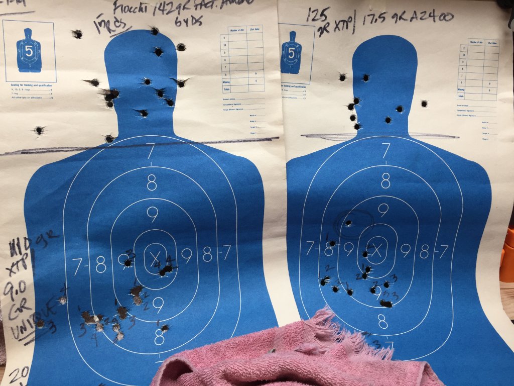

This was one of those trips where I had no idea what to expect. A platform (revolvers) I'm not that familiar with. A manual of arms (SAA) I have almost zero experience with. Brand new gun, so new sight picture and grips to figure out. Throw in 3 different reload recipes that were originally loaded up with only the Big Boy Steel 357 in mind, and you get what you see below.
Target on the left is where I started out with some factory Fiocchi 142 gr flat-points, just to try to get my bearings from 6 yds, standing, two handed hold. Okay, but, man, even with a 2.3 lb + gun, this is a fun handful. Sight picture is somewhat different than my 45 Colt Uberti, which just wants to see the very top of the front blade. Tried that here and ended up landing low on almost all the loads. The "low/left" phenomenon is just me trying to get this gun NOT to twist in my hands.
Went from the factory load to the 110 gr XTP/9.0 gr of Unique. The muzzle blast and flames shooting outward from the cylinder is considerably different from the Fiocchi. A LOT different. Same issue: low, left, and this trigger, by the way, is tuned almost exactly like the 45, which is to say light enough for the flyers you see. Another learning curve...
Ended up with the target on the right, where the head shots are 125 gr XTP/17.5 gr of Alliant 2400 and the body shots are 125 gr XTP/19.0 gr of 2400. As noted above, both were loaded a few weeks ago as part of my "anything but a 158 gr XTP" testing. As before, the firestorm coming out of the front of this revolver was a hoot, but a hoot to be treated in a very respectful way. More wrangling with grip, sight picture, the "holy crap" factor, stuff like that. Not very happy with it, but at least my deficiencies are of a consistent nature.
Uberti 357 El Paton 1st Range Trip 3-1-19 003.JPG (170.15 KiB) Viewed 2851 times

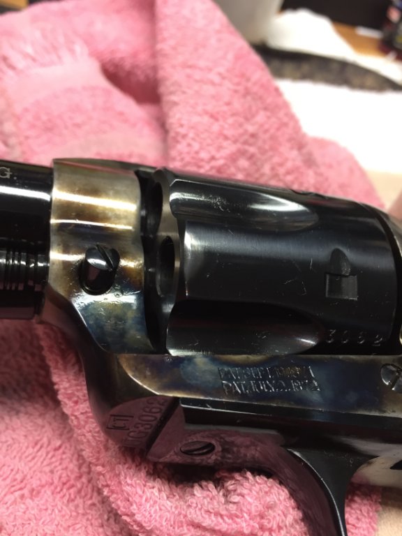

The pic below is of the cylinder, post-cleaning, where you can see an example of where the aforementioned blasts (mostly from the Unique and 2400 loads) have taken the bluing off of the front edge of the cylinder (in the same spot in every chamber) in a sort of half-moon shape. Much more of that, and they cylinder will match the CCH look of the frame!
Uberti 357 El Paton 1st Range Trip 3-1-19 011.JPG (90.19 KiB) Viewed 2851 times
Anyway, my takeaway is that I need to research some good "cowboy" loads for this gun. It's not going to be a HD or carry piece, obviously, so I need to figure out a softer shooting, easier to handle load. To that end, I'm all ears from my reloading compadres here on the forum.
All in all, however, I'm very glad I ventured back into the revolver world, just have a few things to figure out.

Thanks for the range report and the photos, E^2. I'm sure you'll find a .357 load that you like soon enough. For all of the reasons you site, I prefer to use the low end of the reloading data, no matter what bullet I reload. I'm not really interested in beating up my guns or my hands with full house loads. Even so, I have those same half moon shaped markings on my cylinder.

I had the low/left thing going on today too. After reading your post I took a look at my cylinder and I see the beginnings of the half moon too on mine.
As prior you do a good write-up on your experiences. Thanks for well written thought out sharing!
ESquared wrote:... ended up landing low on almost all the loads. The "low/left" phenomenon is just me trying to get this gun NOT to twist in my hands.
... have taken the bluing off of the front edge of the cylinder (in the same spot in every chamber) in a sort of half-moon shape...

Interesting to hear that all of you are seeing the "half moon" burning of the end of the cylinder. I've never owned a blued revolver, so I'm guessing it's been there on my stainless cylinders in my past 357s. I'll consider them character markings.

Low and left? Did you try shooting with your left hand assuming you shoot right handed and see where the bullet hits?
Sometimes a hard pull on the trigger could bring the barrel down and left a bit.
Don't bother with loading .38 Special unless you had that brass handy. You can load the .357 to same levels.

I'm having alternate ideas on the source of the half mooning. I'm thinking its caused initially by abrasion while in the box (no padding) it came in. Then gets added to when taking it in and out of the box and during transport in the box to the range. That the burn covers it up during shooting and then the mooning gets noticed during cleaning.

To my eye, it's not an abrasion type of issue. And, it if were a shipping-related thing, it wouldn't explain how it's so visible on all cylinders and is so uniform on all cylinders.
No, this strikes me as heat-induced. Since mine didn't come through Taylor's, I'll try to figure out who I might send a picture to. If any of you other UB owners have a thought, please let me know.
I"m not worried about it, and, given the number of us who are seeing it, seems like it would be hard not to call it "normal," but it would be nice to know how normal, wouldn't it?

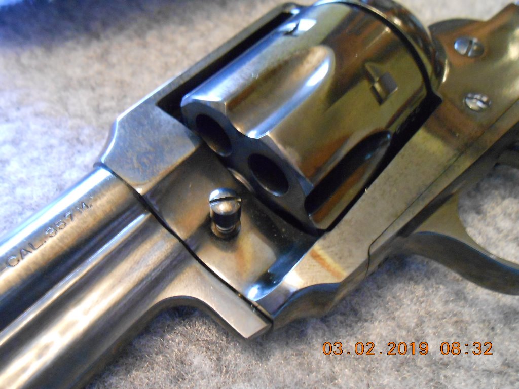

ESquared wrote:The pic below is of the cylinder, post-cleaning, where you can see an example of where the aforementioned blasts have taken the bluing off of the front edge of the cylinder (in the same spot in every chamber) in a sort of half-moon shape.
This pic is of my .357 Police revolver. This spot shows the "worst" chamber on the cylinder. The other chambers have much less, one is close to nothing but a thin, straight line at the very front of cylinder. Have shot 125 rounds so far, exclusively Cowboy loads.
I've called Stoeger Industries Service Department a couple of times with some technical questions about this revolver. The tech was very helpful, and explained things well to me. Actually, you'd call the CS of whichever company your revolver came from: Stoeger or Taylor & Co.
Not sure what causes it. But since it will probably happen regularly, I'm not going to have my cylinder re-blued anytime soon because of this issue.
BTW, on my blued Russian .45 Colt there are some similar markings, not blossoming into the "moon shape;" rather they run only in a thin, straight line at edge of cylinder for each chamber. Interesting.

Do NOT stress about that half moon markings on the cylinder. It is common to many revolvers, both double action and single action. I get it on most of my revolvers, in fact. Not a big deal and not something to waste time on with calls to the manufacturer. It's simply a by-product of gas escaping from the cylinder gap. As long as the gun is not excessively spitting lead or fouling up, abnormally, at the forcing cone, just clean it and go on.
Shooting low and left is most commonly caused by squeezing your hand while pulling the trigger. You must NOT change the pressure with your grip in any way as you squeeze the trigger. Only your trigger finger must move, never the entire hand. Dry fire your gun, exaggerating the squeeze in your grip hand and watch the sights as you do it. One helpful hint for getting accuracy out of plow handle single actions, is to place your pinky finger under the bottom of the grip. This puts your hand in the same position for every shot and it actually makes it more difficult to squeeze that grip hand. Give it a try.

There has got to be some gun wear & tear since we "explode" that much pressure with each round fired. The cylinder on my Russian is particularly nicely marred and scarred from shooting. My next range visit will bring me well over 300 rounds out of that revolver. Also dis-assembly/re-assembly of the cylinder and frame writes its own history. The very first time I dis-assembled it for cleaning I ran a scratch from the front to rear of the cylinder....and that wasn't the only time I did that! Took me a while to learn how to move the retaining plate sufficiently out of the way to mitigate doing this. Taylor & Co. said they can re-blue my cylinder for around $20. Almost sent it in, but realized I would probably repeat the scratches fairly quickly. So it remains as is.
One final comment on this Russian. Of all the revolvers I've cleaned, this one has the least dirty and easiest to clean forcing cone of all others. Kind of have tried to figure that, but don't know enough about how a forcing cone and cylinder are built and may impact each other. I do always pay close attention to how it shoots, so that's at least taking care of the revolver.

Adding to what has already been shared...
http://www.peacemakerspecialists.com/Co ... orner.html
On some Peacemakers that have been shot a lot you will see what looks like areas on the front corners of the cylinder right where the chambers are, places where it looks like the blue has come off. They will appear gray color and are on the front end of the cylinder. This discoloration is really just lead deposits that seem to have wrapped around the corner and extend on to the outside of the cylinder. These deposits are difficult to remove without actually rubbing through the blue finish.
