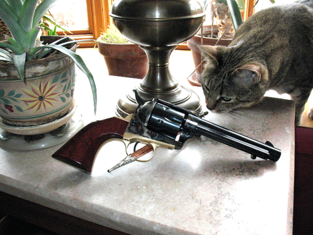

Paige has to inspect everything that's in her house.
Cat and Cattleman.jpg (393.64 KiB) Viewed 1816 times

CT_Shooter wrote:Paige has to inspect everything that's in her house.

PT7 wrote: BTW, did Paige give her approval? ;)
I think Paige just likes the smell of Ballistol, but she generally approves of pretty much everything anyway-- with the exception of the application of her monthly flea/tick/heartworm medication and the vacuum cleaner! :o

Nice job splatting up that target. Like mine, I love the brass, CCH, blued combination look. Oh, and it looks like Paige is CCH too :lol:

This Cat likes it too!! :D
