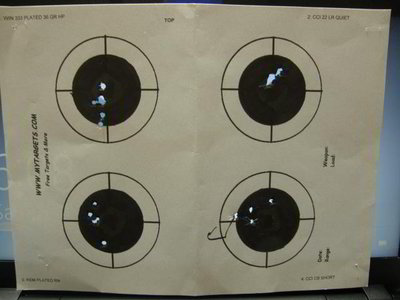

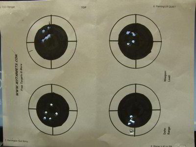

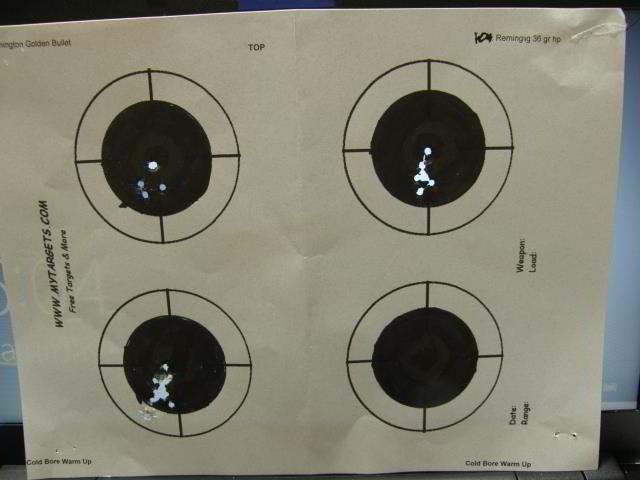

I got out to shoot with my daughter yesterday, we had a great time, had to lean on the bench not to get blown away though.
I shot comparison loads with the Small Game Carbine. My purpose was to see which of the loads shot close to others so I could interchange loads and still know where it is shooting. I plan on doing most of the shooting with the SGC at 25 yards or less.
The wind was blowing and I only shot from 20 yards. Was pretty steady from the bench.

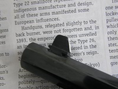

I added the Skinner front post to the rifle so I could lower the shot. Most of them before were an inch above point of aim.
The ammunition I will use from this target comparison is below.
Usual ammunition to feed .22cal “Small Game Carbine”.
CCI Mini-Mag 36 gr HP
Remington Golden Bullet LR
Winchester 333 plated 36 gr HP
Blazer 40 gr RN
Other choices for “Small Game Carbine”.
CCI Stinger = 1 inch high at 20 yd = Larger Varmint to 100 yards
Remington Sub Sonic = bigger group 1-1/4 @ 20 yd
CCI Quiet 22 LR = 1 inch high at 20 yd
CCI CB SHORT 29 gr = 1 inch high 20 yards
Remington plated RN short = 1 inch high @ 20 yards
Remington CBee 22 Low Noise 22 LR HP = 1 inch high 20 yards

Seems most ammo is shooting around an inch high at 20 yards. I zero mine to 1/2" high at 25 yards. For standard velocity that will put it dead center at 50 yards. Which ammo shoot the tight group in the second picture?

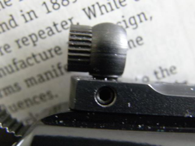

Interesting that you added the Skinner front post to lower the shot. Only had to adjust the receiver peep on mine 180* up to bring in good elevation. But certain that the SGCs are not created as identical twins!

Second target tight group, top right = CCI Quiet 22 LR (not much power)
The one that shows the promise on that sheet is the top left with the stacked up group. That variance probably came from my shoulder pressure. They are Winchester 333 plated 36 gr HP.

I'm not surprised the slower ammo is shooting better for the most part. That close windage but loose elevation target of Winchester doesn't surprise me either. The elevation difference could be a variance of velocity.

The front post versus the round front sight:
The post makes me a wider, easier to see top edge of the front sight which is supposed to be my aim point. With the stock Henry sight I could not get any of those rounds listed at and below the aim point, most were about an inch hiigh. The Henry sight measure .460 inch high, the Skinner is .500 inch high. Where you see the rounds hitting I could not get that low with the stock sight.
