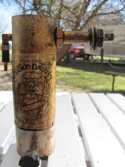

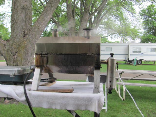

as one can tell from the first picture, we have been using a Smoke Daddy smoke generator ===> https://smokedaddyinc.com/product/8-inc ... generator/ <=== with our Holland Companion grill for a long time ..... until receiving a heads-up from a long time friend, I didn't realize they offer tube smokers ===> https://smokedaddyinc.com/product/12-bb ... be-smoker/ <=== or a smoke ring cold smoker ===> [urlhttps://smokedaddyinc.com/product/the-pellet-pro-smoke-ring-cold-smoker/][/url] <=== based on years of use of their products, if/when I am in the market for such items, I'd be hard pressed not to order their smokers
160212 001 Smoke Daddy Mod 001.jpg (55.13 KiB) Viewed 6991 times
150619 005 reverse view 001.jpg (70.47 KiB) Viewed 6991 times
150619 007 after hot smoking 1hr 001.jpg (61.7 KiB) Viewed 6991 times

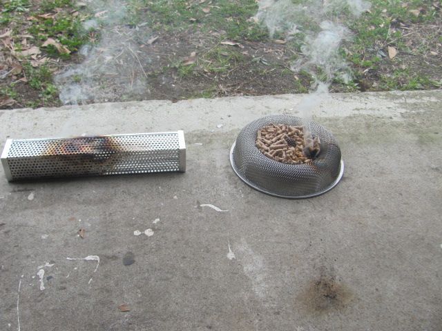

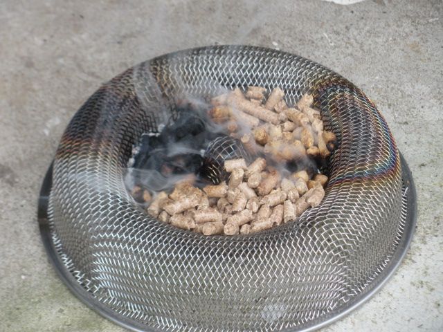

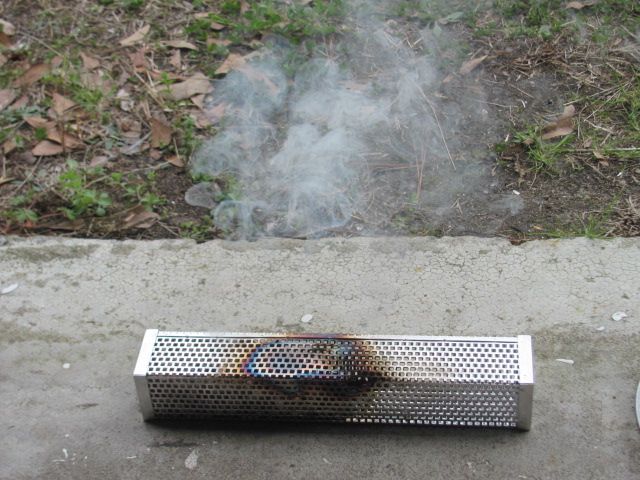

I spent several hours today testing a 12" BBQ Tube Smoker from Smoke Daddy ===> https://www.amazon.com/Smoker-Smoke-Dad ... moke+daddy <=== and their New Smoke Ring ===> https://www.amazon.com/Pellet-Smoke-Smo ... moke+daddy <=== .... having dealt with Smoke Daddy for many years, it came as no surprise that they both perform as advertised ....
bottom line #1 === if it will work with the grill/smoker I'm using, my first choice would be the ring .... it can go longer on a load of pellets .... it the ashes stay in the ring
bottom line #2 === neither can be placed near the smoker/grill's burner .... doing so will set the pellets on fire which burns the pellets without much smoke .... if placed where fat drippings fall on the generator, a flame up can result
the ring takes up less space so I will use it with smaller grills .... exactly how they will be used with our various smokers and grills has yet to be determined
180324 006 smoke daddy tube 002.jpg (77.69 KiB) Viewed 6915 times
180324 005 smoke daddy ring 002.jpg (86.38 KiB) Viewed 6915 times
180324 007 tube & ring 004.jpg (75 KiB) Viewed 6915 times

well, I still have confidence in Smoke Daddy's cold smokers but have lost all faith in their BBQ Tube and Smoke Ring .... guess I have been spoiled by the performance of their cold smoker used with our Holland Companion (shown below) .... the Tube and Ring simply do not produce the volume of smoke, are inconsistent in burning pellets, and have to be relighted way too often .... for me, they have been money wasted and after several attempts, they simply don't live up to their billing

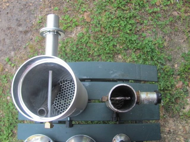

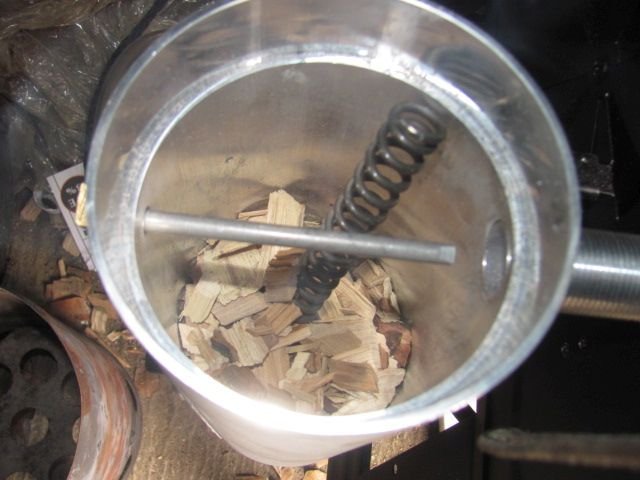

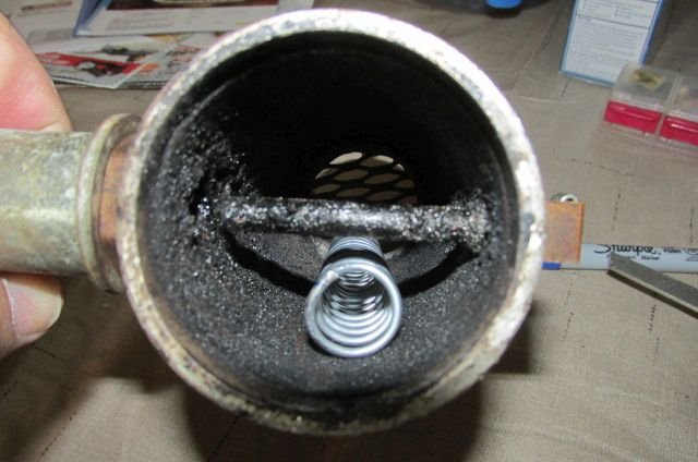

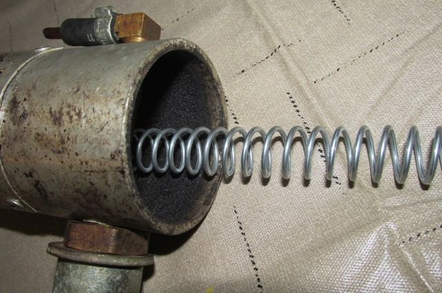

our large Smoke Daddy came with a spring that aids air flow (first picture) .... our original smaller Smoke Daddy didn't .... as a test, I picked up a spring at Ace and cut it to fit our smaller one (rest of the pictures) .... I'm looking forward to seeing how well it works
180503 001 smoke daddy 003.jpg (81.45 KiB) Viewed 5501 times
180506 003 chips 002.jpg (58.22 KiB) Viewed 5501 times
190520 001 spring mod 001.jpg (59 KiB) Viewed 5502 times
190520 001 spring mod 002.jpg (65.71 KiB) Viewed 5502 times
190520 001 spring mod 003.jpg (81.09 KiB) Viewed 5502 times
190520 001 spring mod 004s.jpg (66.18 KiB) Viewed 5502 times
