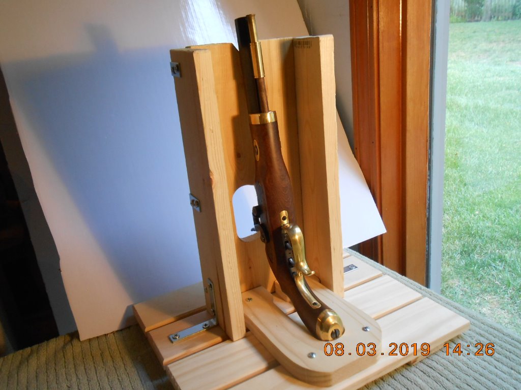

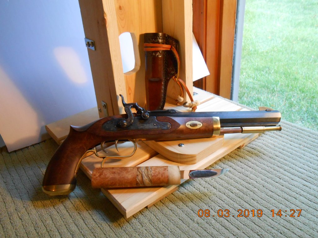

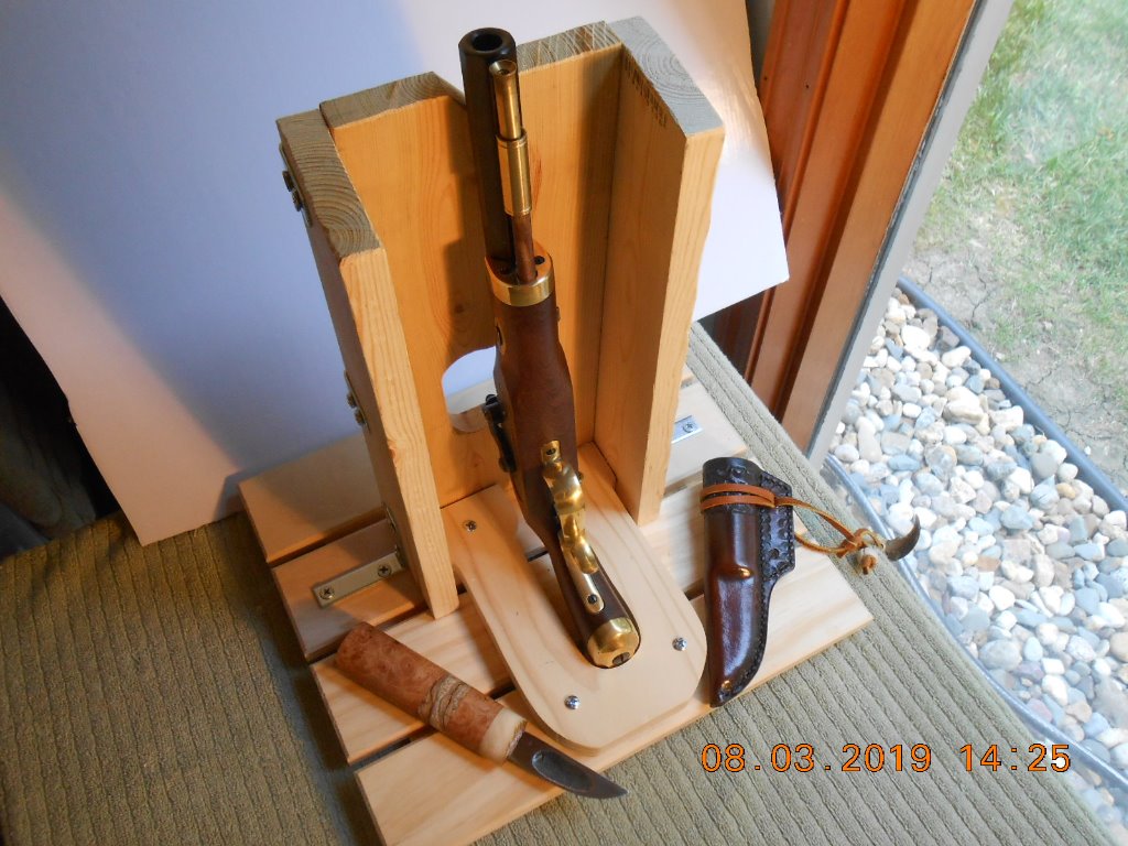

I posted this a couple of days ago as a DIY woodworking project. http://henryrifleforums.com/viewtopic.php?f=56&t=7309 Here is the finished BP pistol loading stand I just built. Thought this tool would fit okay under forum "Black Powder Guns."
When I went to my first BP range shoot, I had no idea this loading equipment was needed. I'm definitely more prepared for my next range time! ~~~PT7

Excellent job, PT7! That project was well considered and executed. Love it. And thanks for once again showing us your way too cool, hand made Siberian knife, as a bonus. Great photos!

I also posted a similar thread with photos on the Muzzleloaders Forum, just in case I didn't get it all together. I had no "blueprints," so had to build it from recalling what the one stand looked like I saw at the BP shoot. One member did let me know of a potential problem I could have.
He said there is no support to the pistol grip (back of it near the small "crook" at the top. The force of the ramrod from whenever I load a patch and round ball could possibly break the grip. So the suggestion was to add another padded block of wood to let the pistol rest on the back of the grip. I think I can do that, but it's simply back to the drawing board!!
Yeah, I'd like to shoot again, sooner rather than later. So as soon as I get this stand ready, and the weather is mostly clear of rain, I'll go for it. ;)

HURRAH! COMPLETED MY "MOD" today and added a grip support wood block. Check out the photos. Should protect the grip in case I get carried away with the ramrod! ;)
Ready to saddle up and get to the range again. Not only to try out the loading stand, but to shoot BP. Fun-Fun. :)
