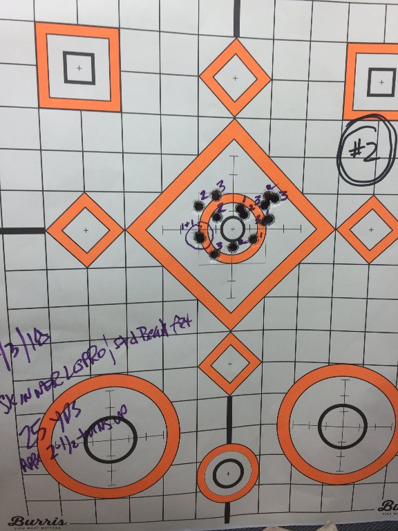

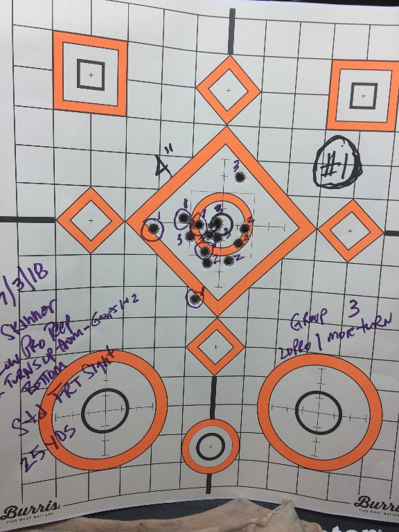

Attached are four target pics.
The first ("#1") is the setting described above, from 25 yards, seated with a sandbag rest. There are three ea. 5-shot groups on this target.
Groups 1 and 2 are with the Low Pro bottomed out, then backed out/raised about a turn-and-a-half turns (based on where I ended up in the bottomed-out state).
Group 3 is a 5 shot group with the Low Pro raised up one more turn.
Target #2 is at the same setting, same distance, just a new target to "unclutter" the groupings.
Target #3 is at the same setting, but at 35 Yards. 3 ea. 5-shot groups.
Target #4 is at the same setting, but at 50 yards. 3 ea. 5-shot groups.

And, speaking of triggers, I've gotta say, this trigger is FANTASTIC! No creep whatsoever and it must break at 3 lbs (?); certainly no more than 4 lbs. And the action/loading was fine, except for another operator error on Round #1 a couple of times. I'm learning!
What do you all think?? Would that Lyman Globe front sight that TractorTad suggests make this any better at 50 yds?

Those groups look pretty good for the first time shooting a new BigBoy. That #3 group at 50 yds is keeper now matter what sights are on your Henry - nice shooting.
A couple of thoughts:
First, if the front bead is covering the target (and it usually will over 25yds), you might want to try the "six o'clock" hold position. That's where you basically hold the target directly above the bead in your sight picture. Hopefully, NCG will chime in here because she can explain this technique better than anyone on this forum. You may have to readjust the elevation on the low-pro to sight-in the rifle using this technique.
Second, I think a Lyman globe would probably tighten up your groups. It's easier to see the target thru a rear peep and line it up in the center of the globe (for me, anyway) than it is to line the target up with a bead sight. If you use some of the fine globe inserts made by Lee Shaver, you can use a crosshairs or a small circle in the front globe and the sight picture looks similar to a scope - which again makes it much easier to hold the front sight on the target while looking thru the rear peep.

Good for you, ES. You did fine with that setup.
A six o'clock hold is a sight picture used for bullseye target work, with the sights touching the bottom edge of the bullseye (six o'clock position on the face of a clock) and the rear sight set to shoot just high enough to hit the center a bullseye of a given size at a given distance. This allows a much more precise sight picture than covering a bullseye with the front sight. That, in turn, improves scores.
The problem with a six o'clock hold is it locks you in to a specific bullseye size at a specific distance. Change either one and you need to re-zero you sights. That's still okay for most types of formal competition when shooting at known standardized distances and known standardized size targets. When shooting silhouette, for instance, it's pretty easy, via experimenting, to have your sights preset via clicks needed for each size target at each distance.
For field shooting and hunting when you are basically guessing distances and need to shoot in a hurry, doing the math with a six o'clock hold and that extra height you used to hit the center of the bull gets too tricky to be practical for me. For this type of shooting, I go back to a dead on hold (also called a point-blank hold) with my elevation set to coincide with the tip of my front sight for a given load at a given distance. I then either use hold over or hold under as needed. I also use another system called maximum point-blank range (MPR). This allows you to use the same hold on the target - no hold over or hold under - and still hit the vitals or the target of a given size as long as you shoot within a given span of distance.
Let us know what ammo you'll be using and what distances you'll be expecting to shoot, but, for now, you're off to a good start. Congrats.
